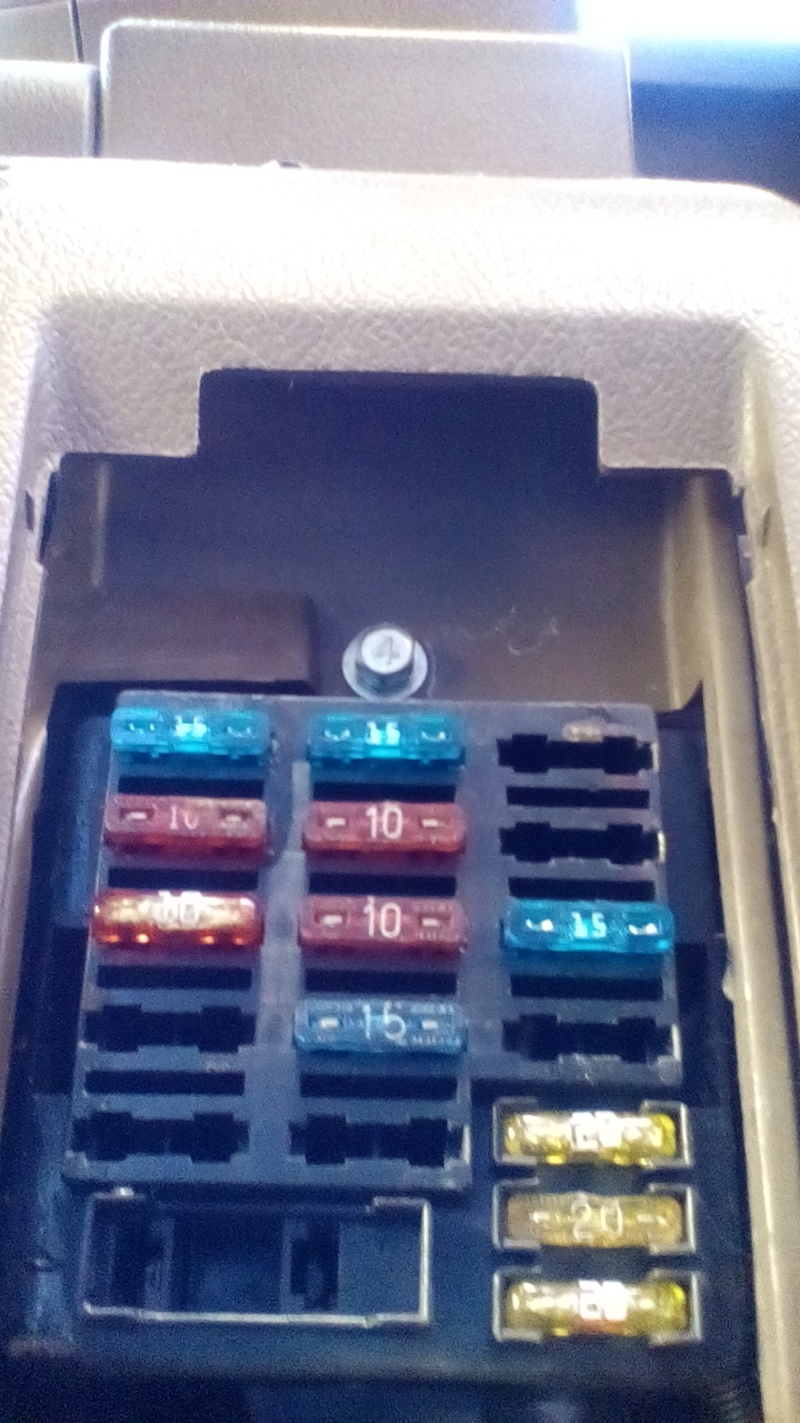

Cover to fuse box located on driver side just under the dash is gone and I need to know what size fuses, what it is for and amp. I need the diagram.

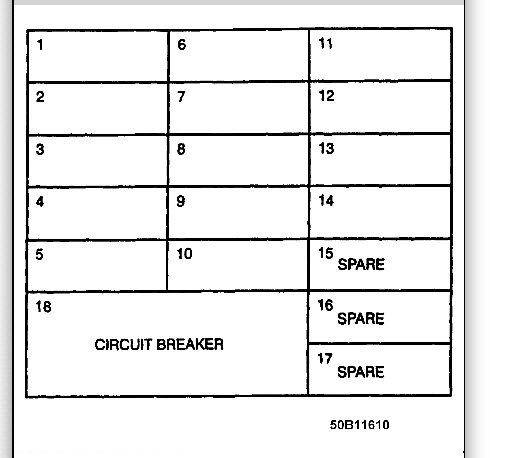

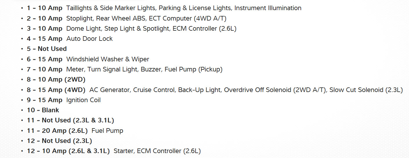

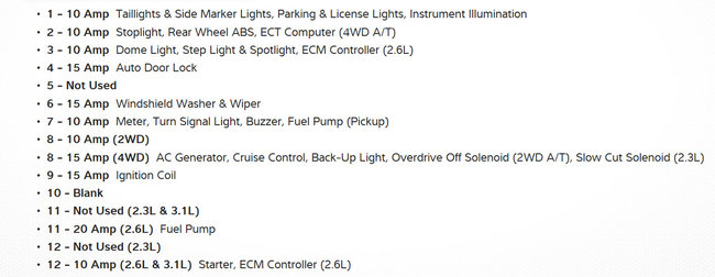

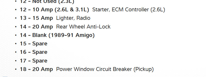

This is for a pickup which you did not say a model.
