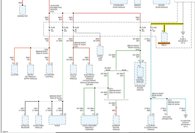

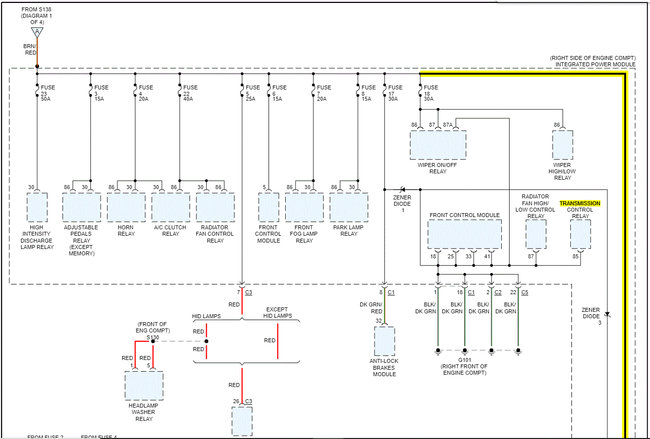

Transmission fuse and relay burnt in rear fuse box.
Apr 6, 2022 at 1:19 PM
  • 110,248 POSTS

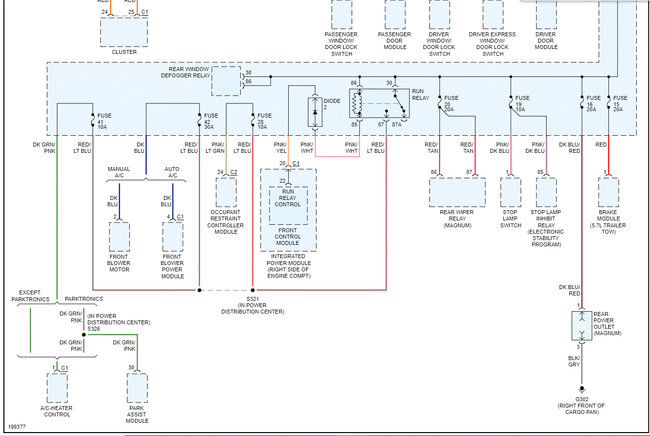

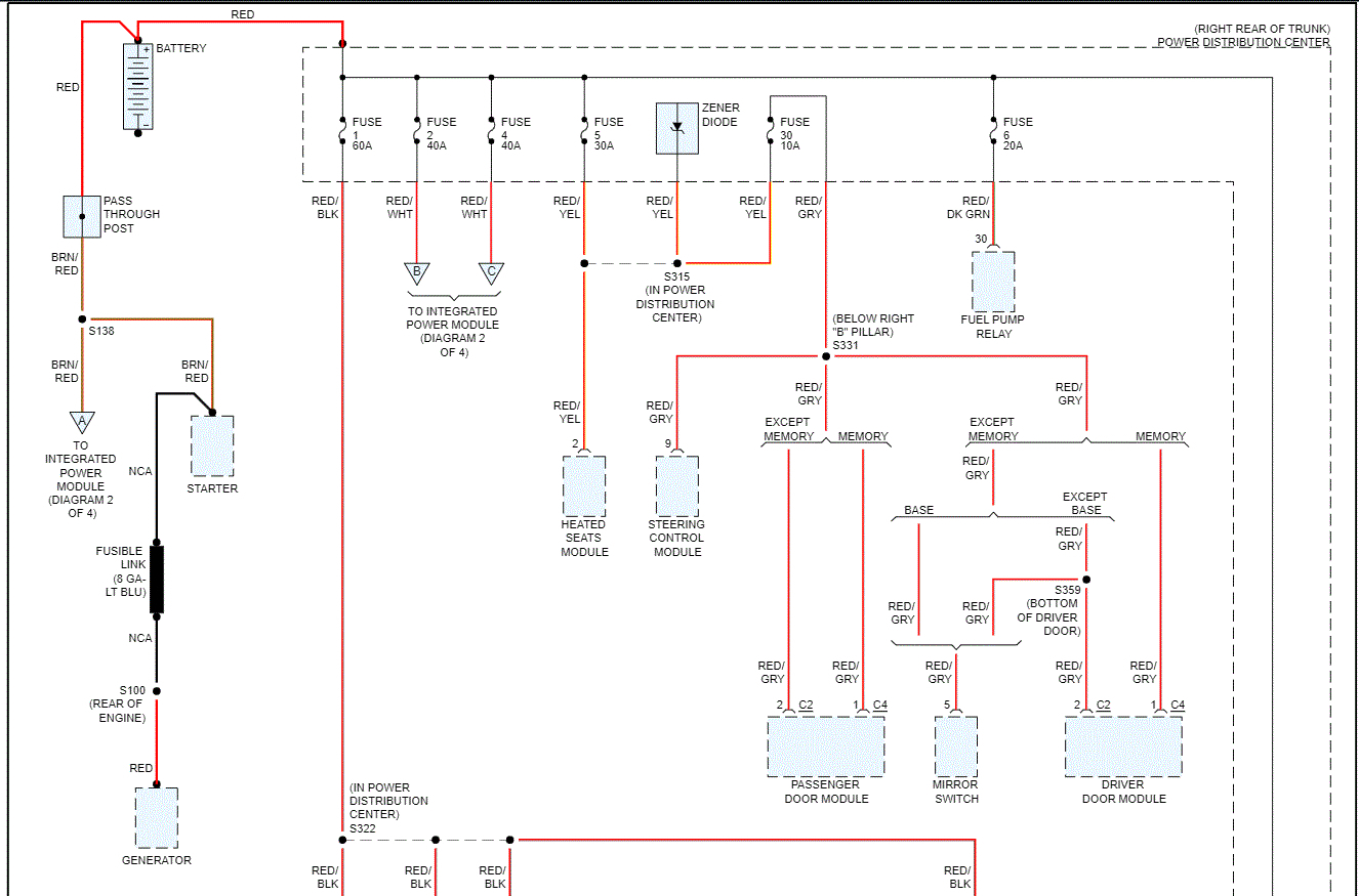

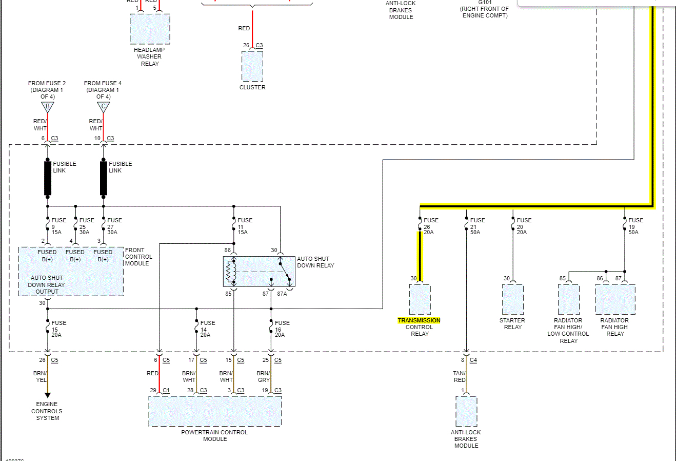

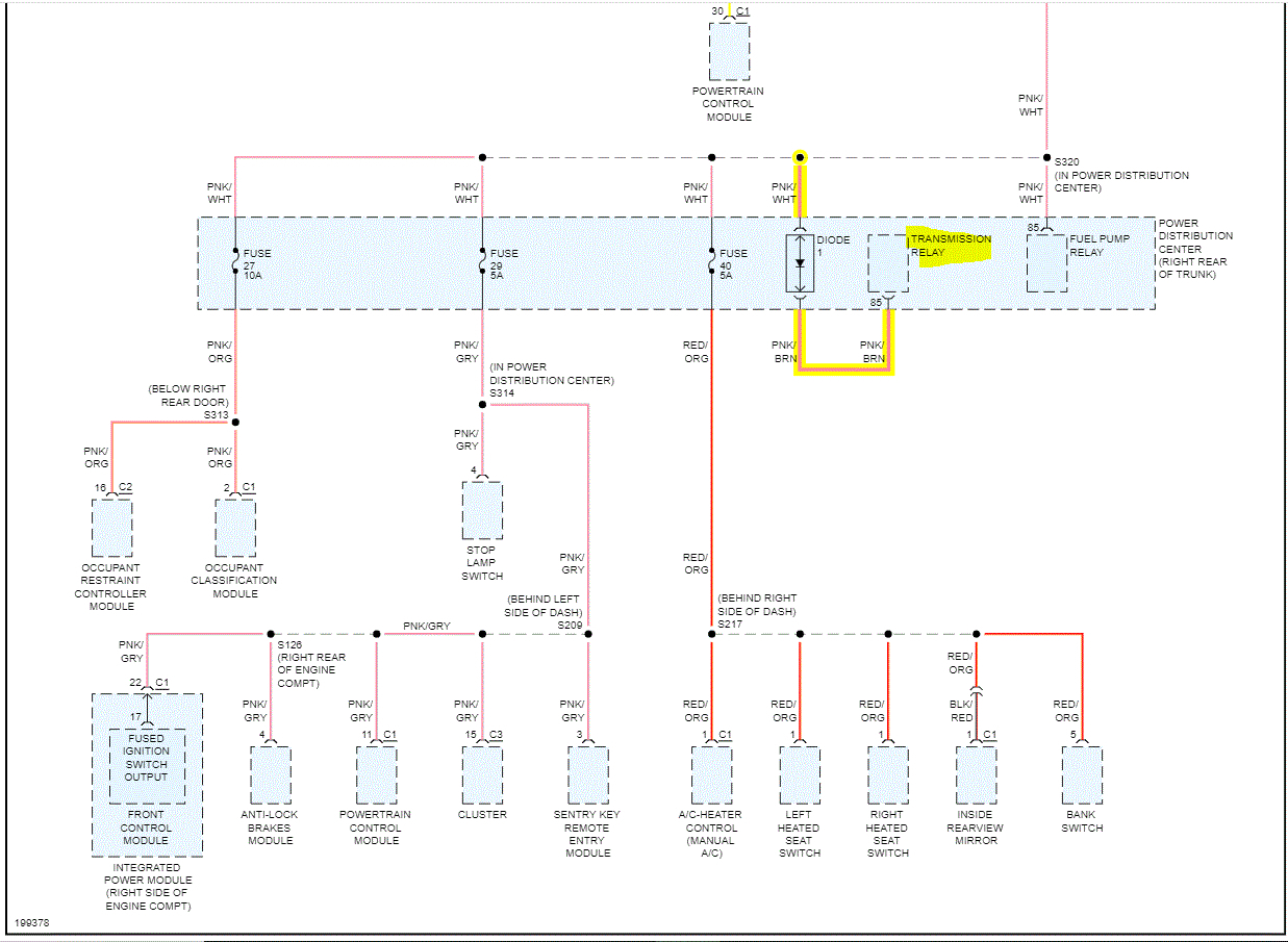

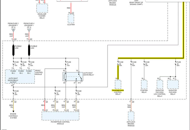

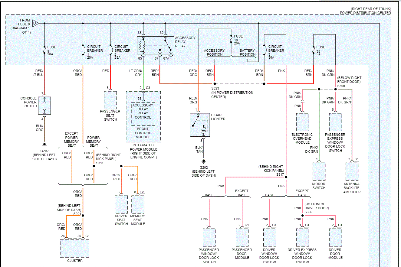

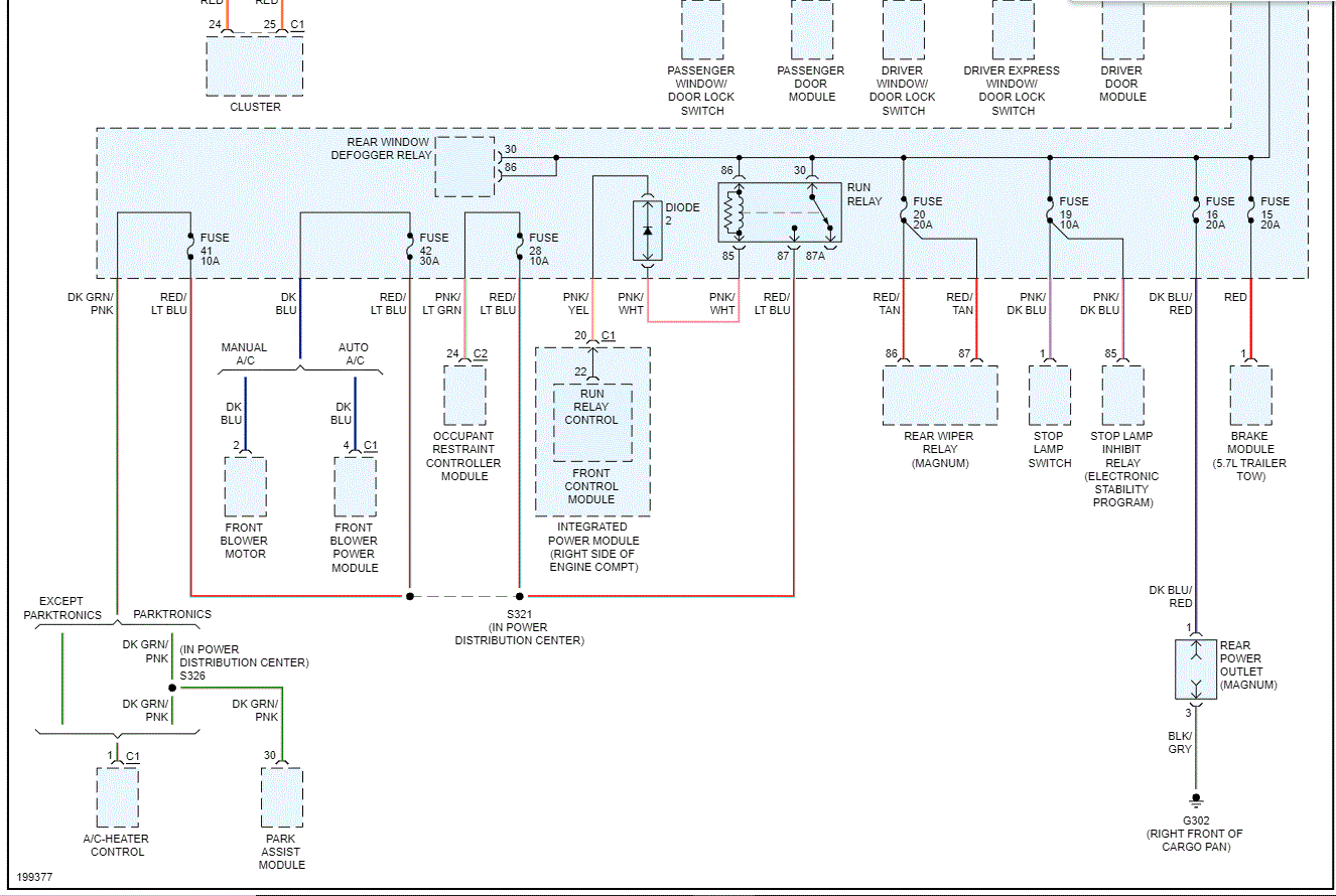

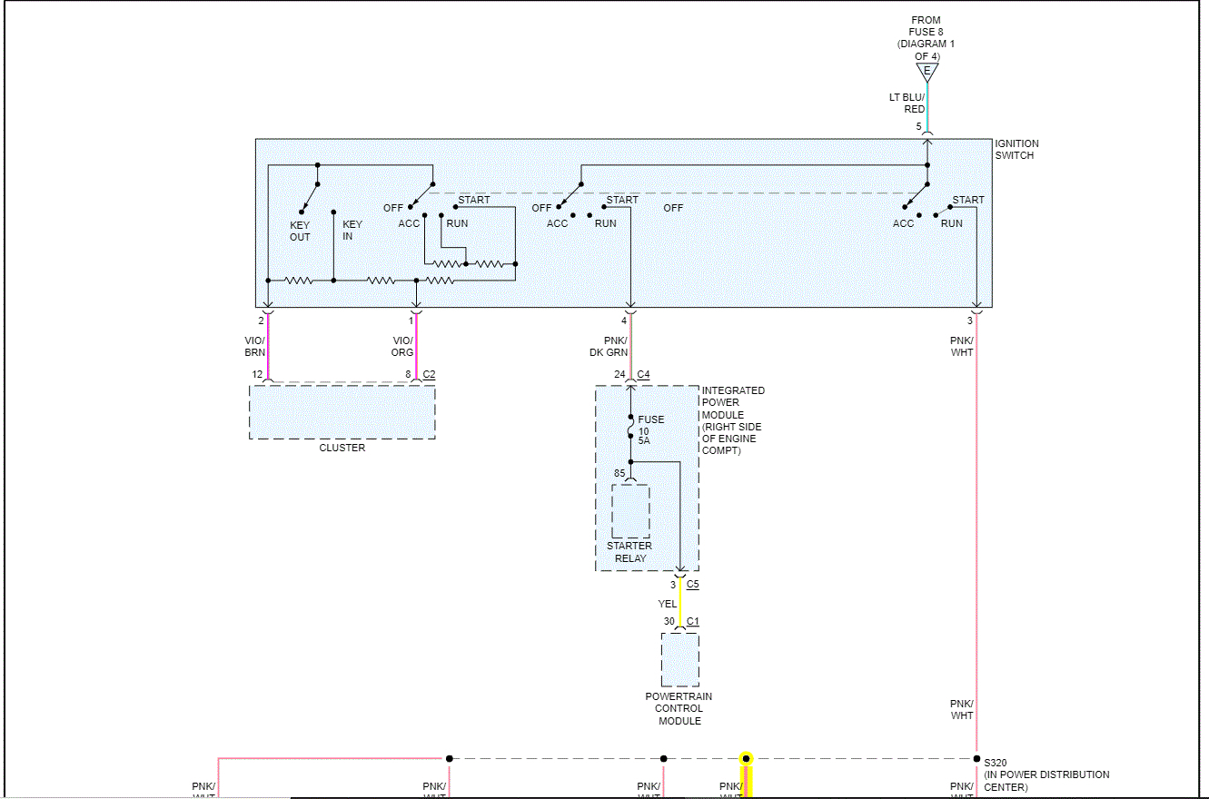

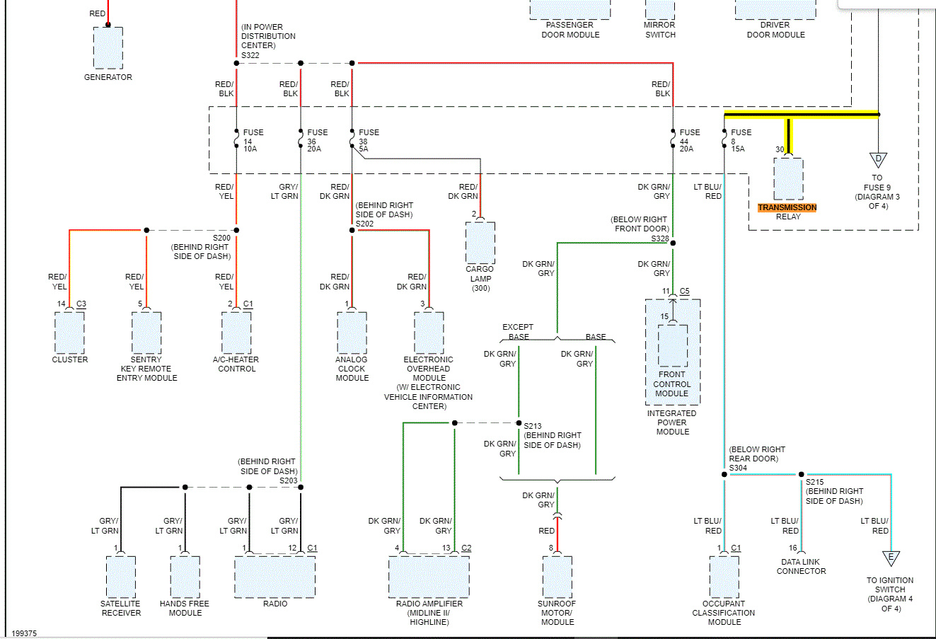

I'm not sure exactly what is needed. I attached the entire power distribution wiring schematics below. I highlighted everything related to the transmission. Let me know if this is what you needed.
Also, here is a link you may find helpful when working on automotive wiring:
See pics below. Note: Each page of the schematic had to be cut in half to make them readable for you. I did overlap them so you can follow from one to the next.
