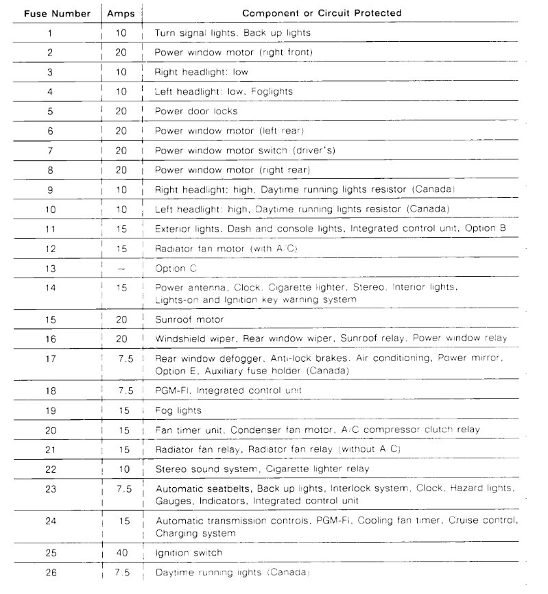

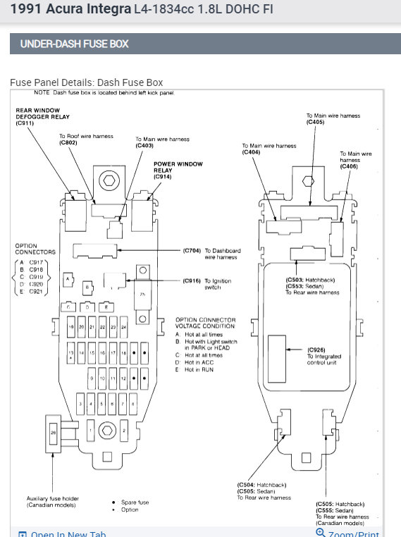

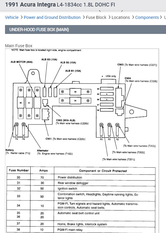

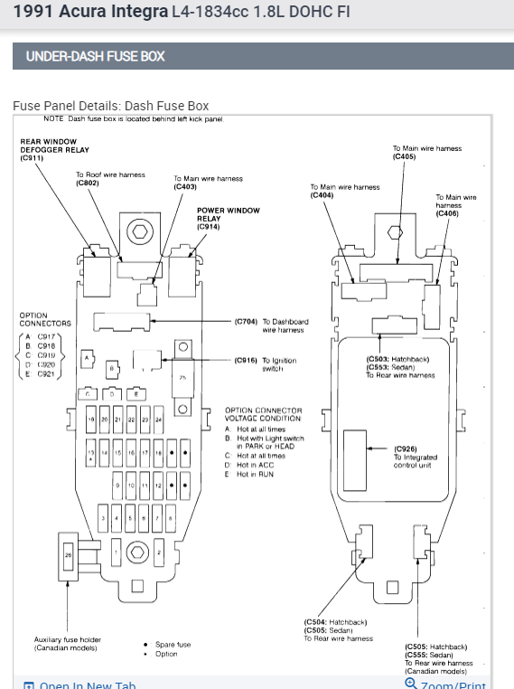

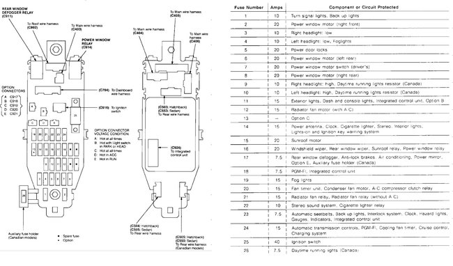

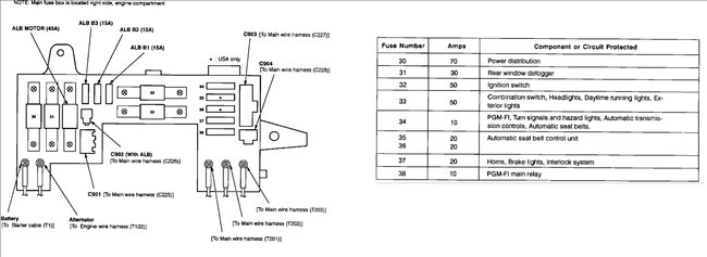

I need a detailed breakdown of the fuse box diagram both under the hood and kick side panel.

See attached for both fuse box diagram.
Let me know of any questions.
