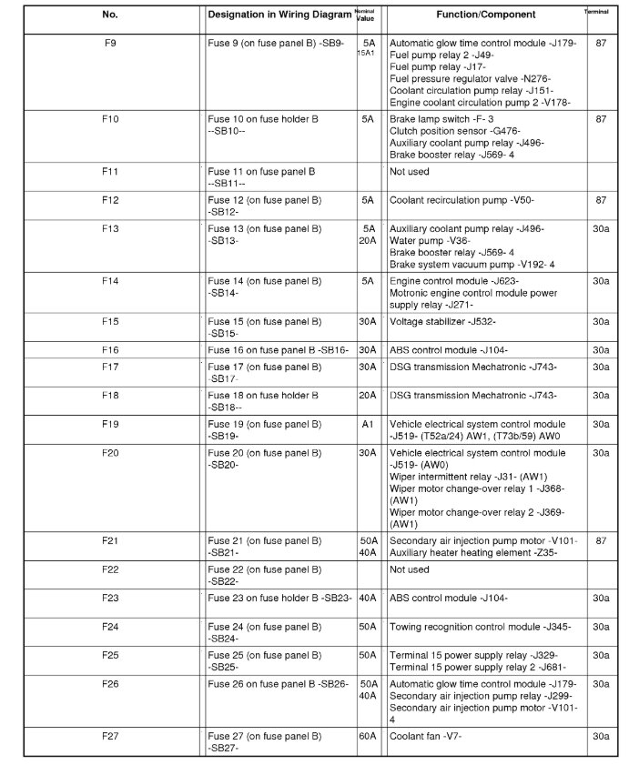

Where is the fuse box located and can I get a diagram?
2012 VOLKSWAGEN JETTA
106,000 MILES • 2.5L
LAXGOD45
MEMBER
2 POSTS

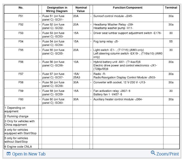

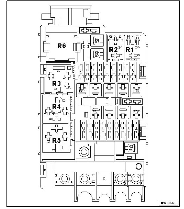

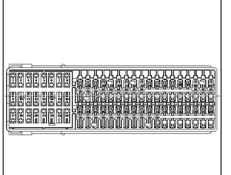

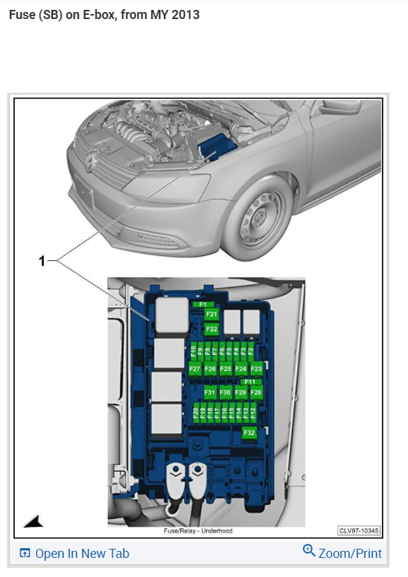

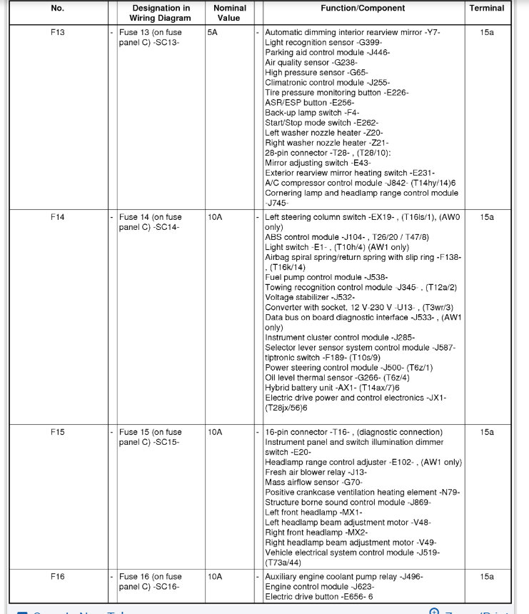

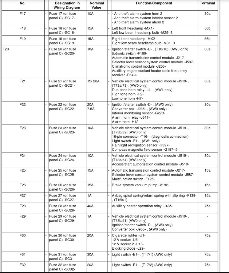

I can’t find a fuse box diagram and location for my vehicle listed above.
Oct 31, 2022 at 1:16 AM
Experienced Mechanic
55,721 POSTS

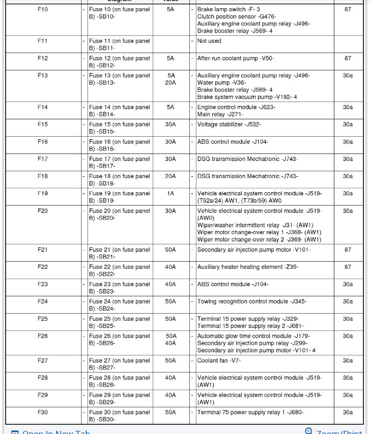

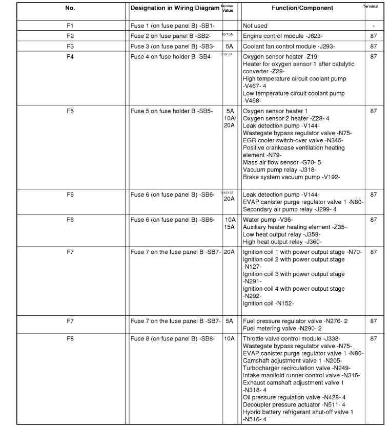

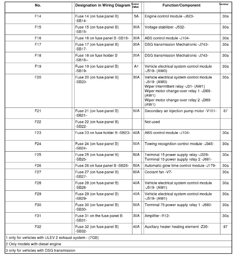

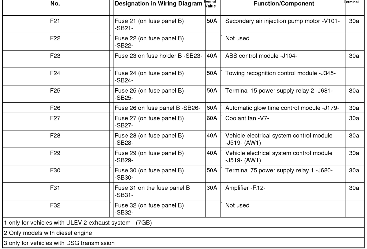

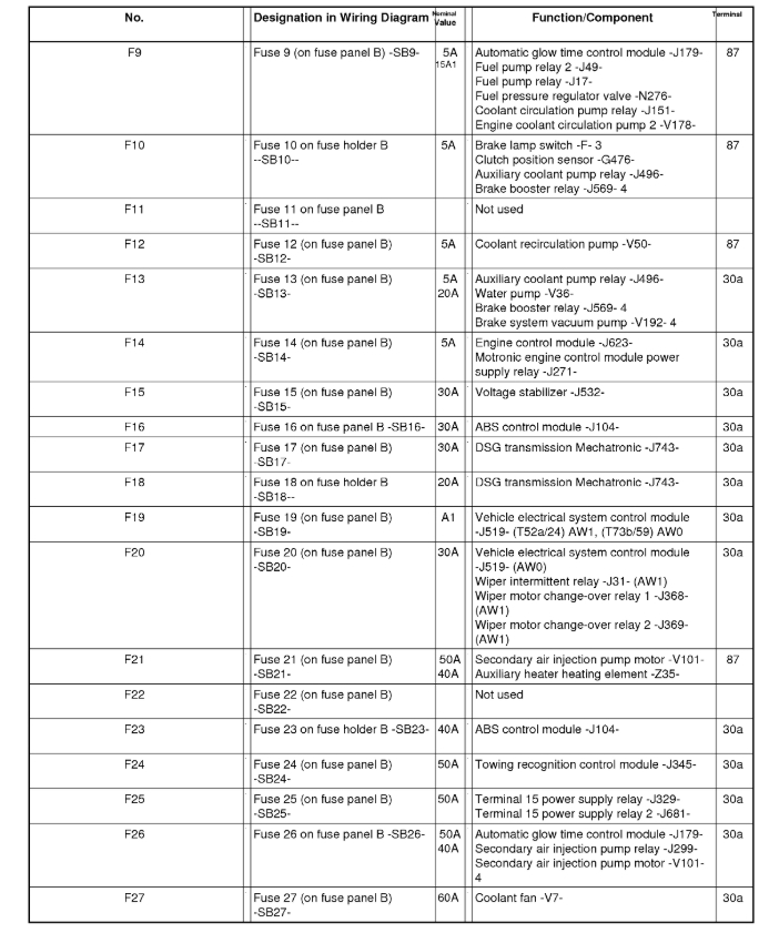

Sure, here is the fuse box diagram and a guide to help you test the fuses:
Check out the images (below). Please let us know if you need anything else to get the problem fixed.
