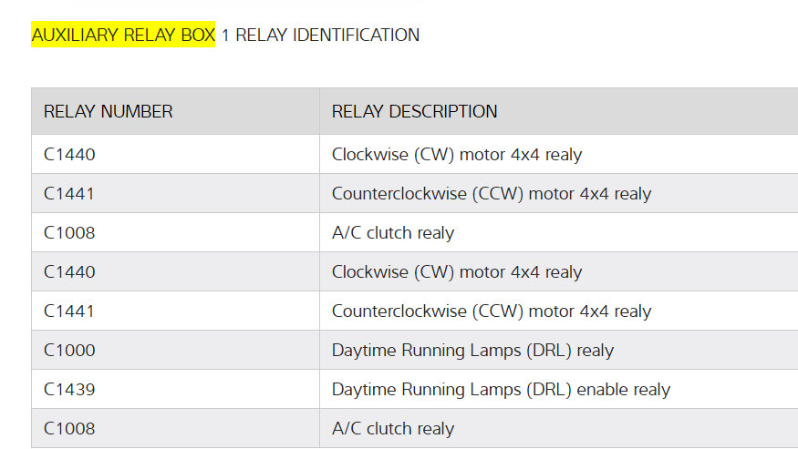

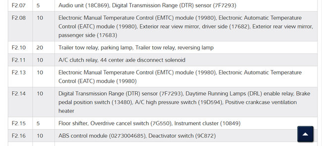

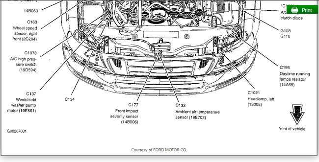

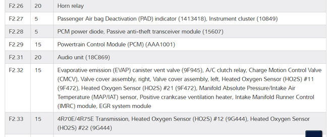

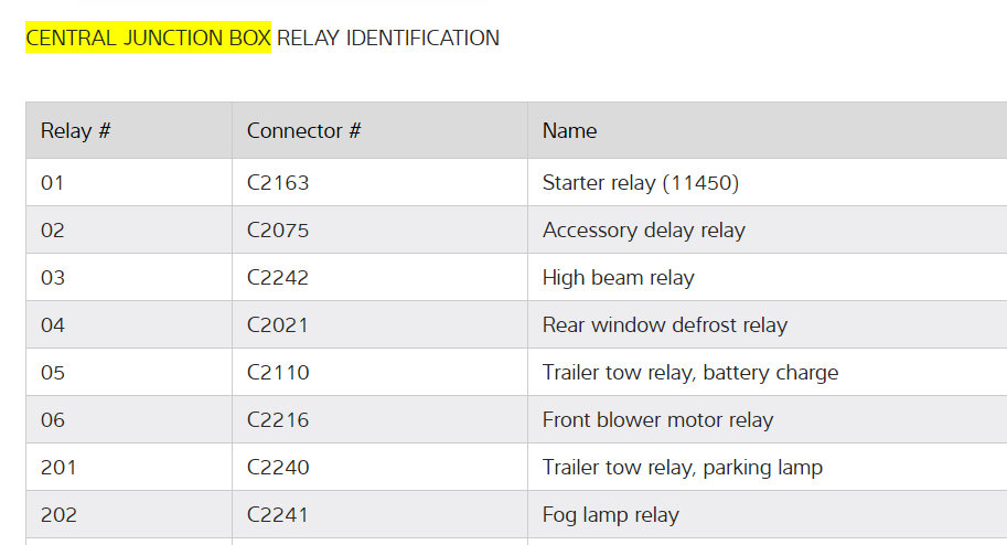

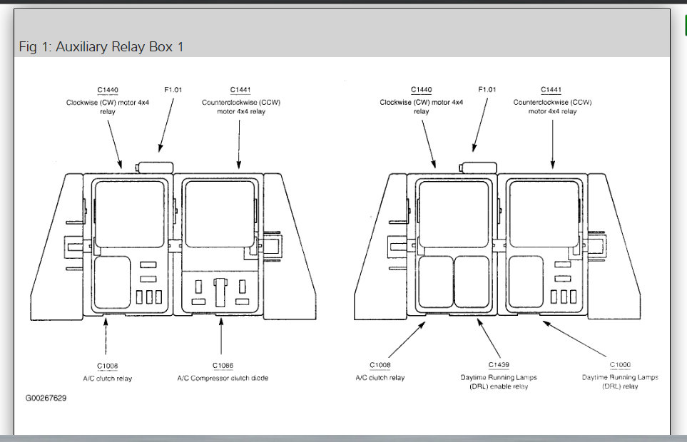

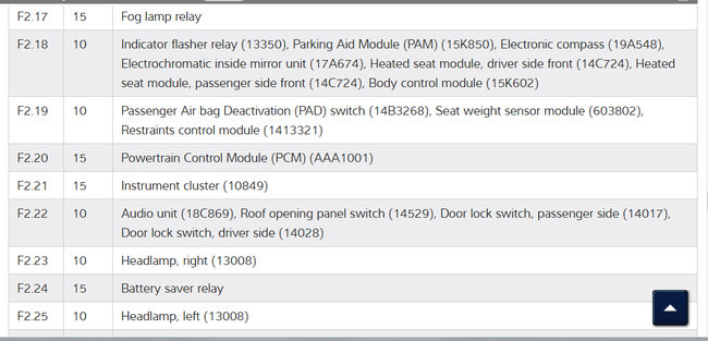

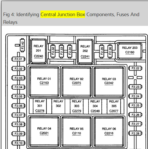

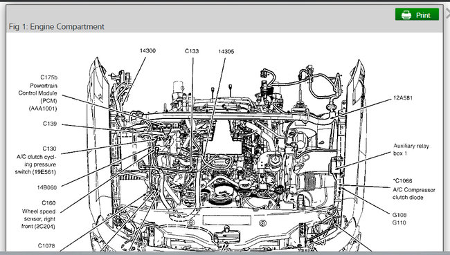

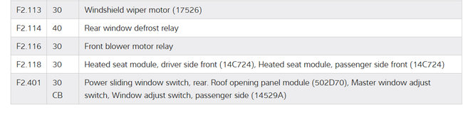

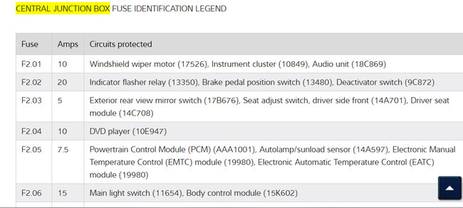

I need to know what fuses go to air conditioning and heating components, blower motor, buttons.
Apr 12, 2019 at 5:51 AM
SCGRANTURISMO
  • 4,897 POSTS

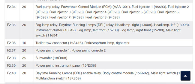

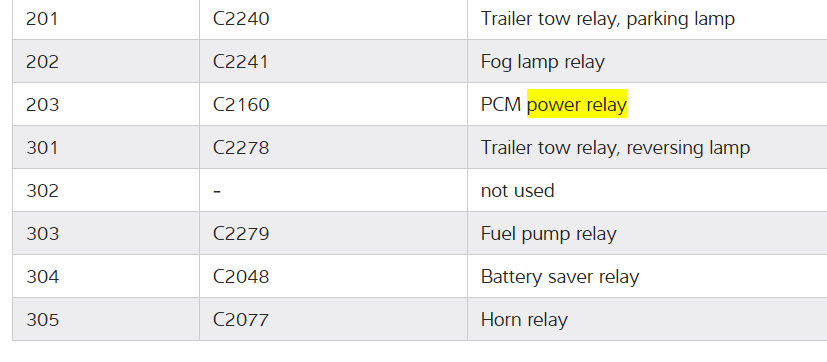

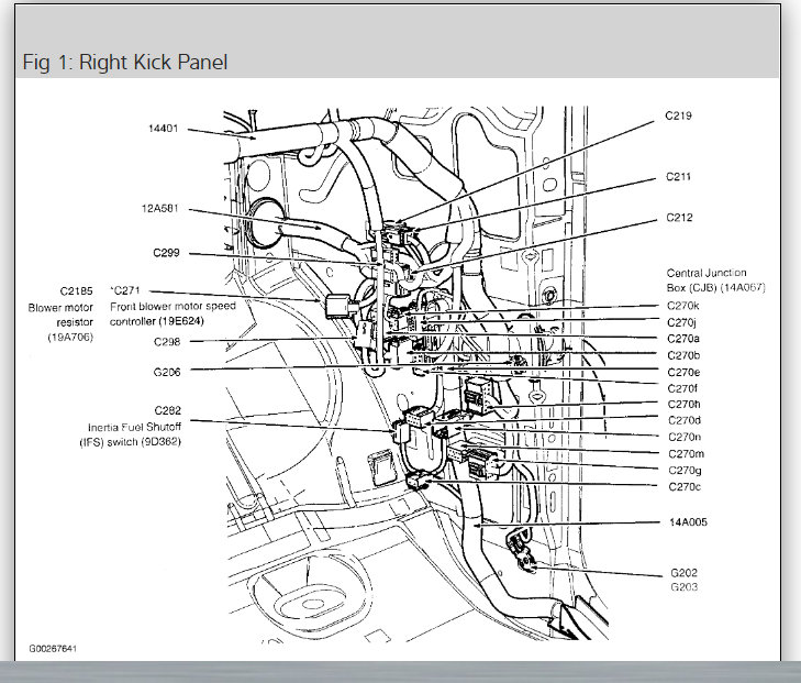

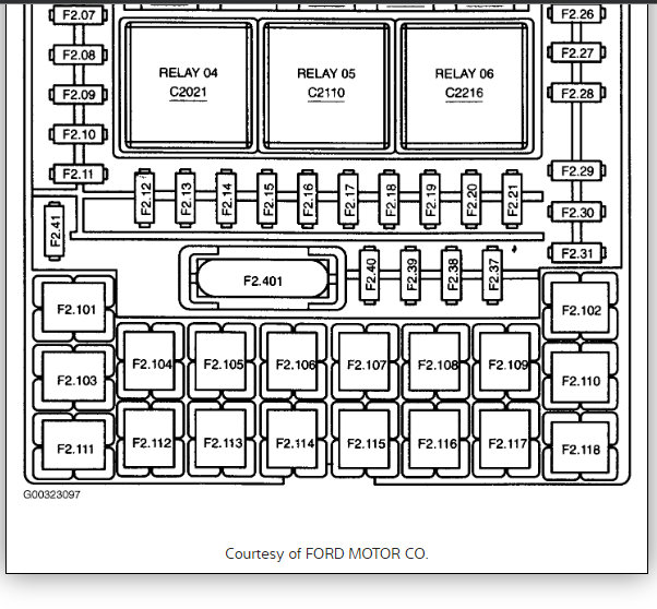

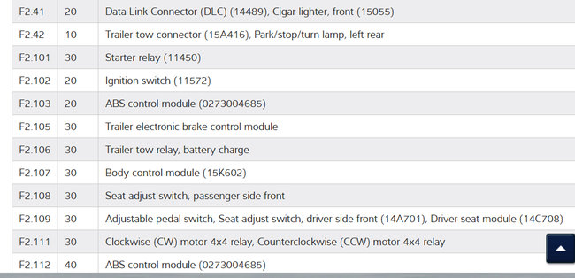

I have included in the diagrams down below the information that you requested. There are junction box diagrams with fuse and relay descriptions. If you should have any other vehicle related questions, please, feel free to ask. That is what we are here for.
