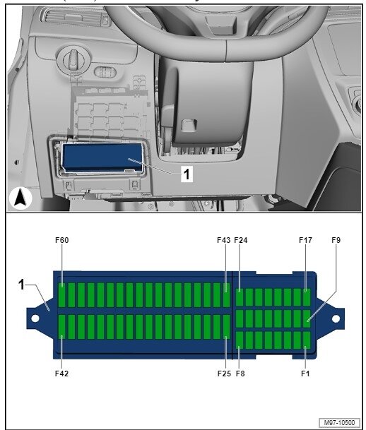

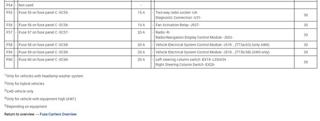

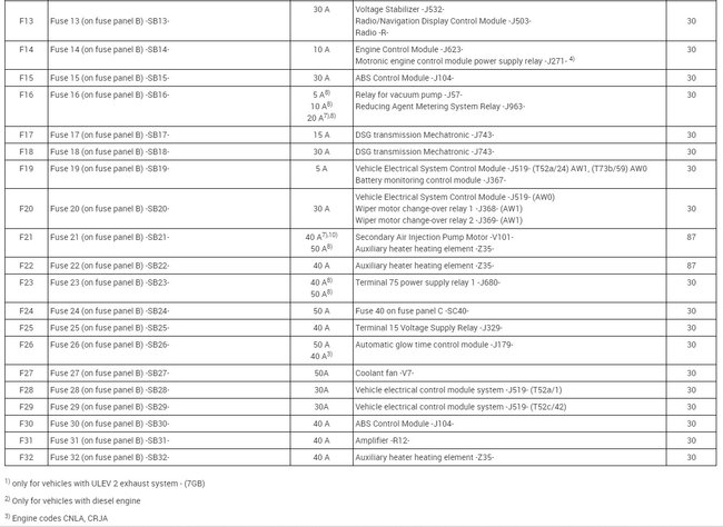

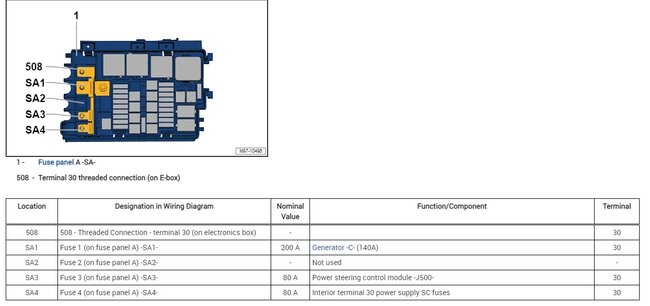

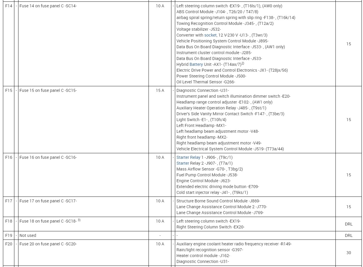

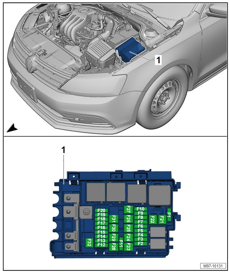

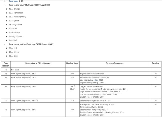

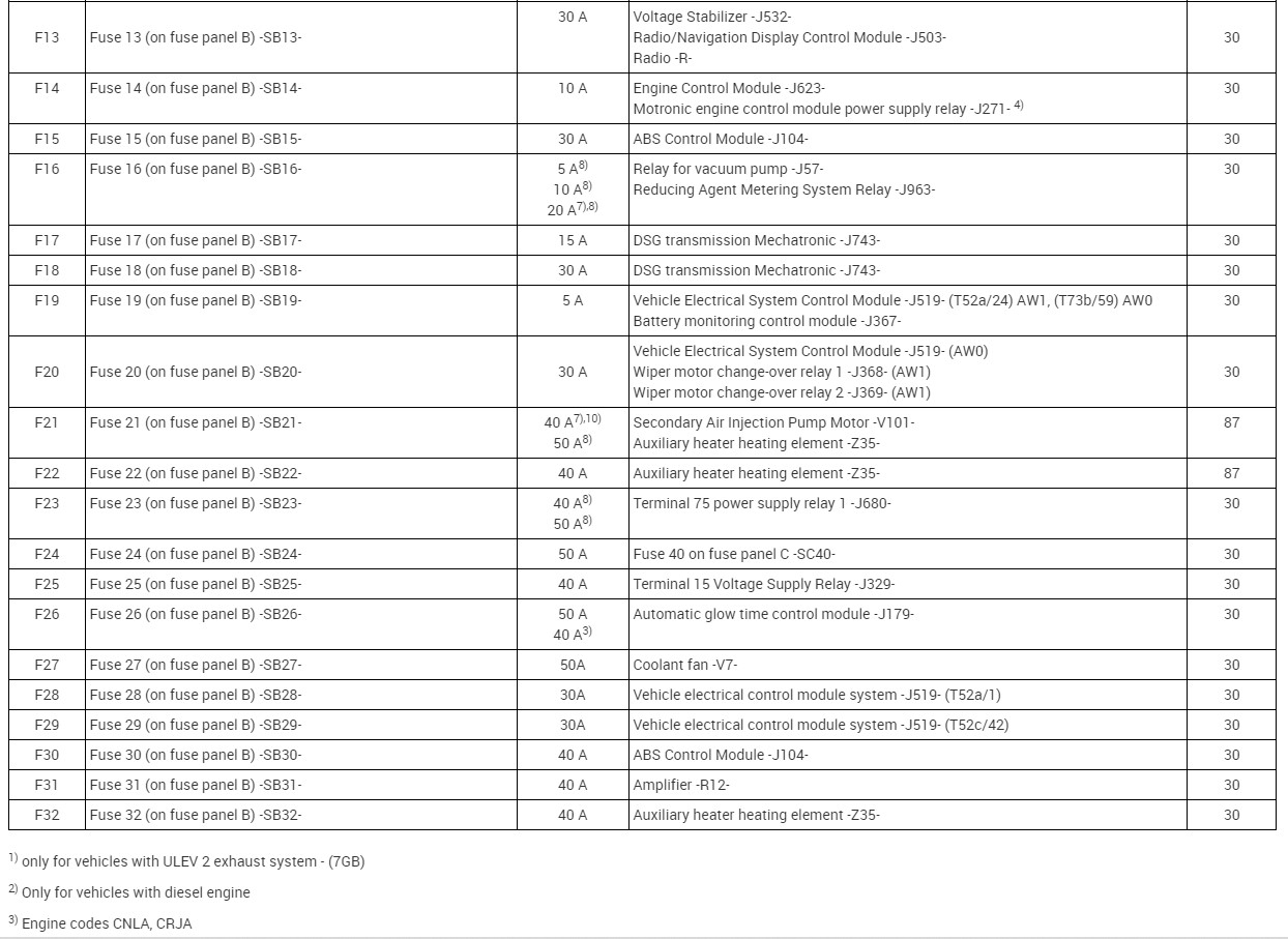

Some fuses are missing in the fuse box. I could not find diagram in owner's manual. looking for diagram for under the hood and under the dashboard.
May 14, 2023 at 9:42 AM
STEVE W.
  • 15,413 POSTS

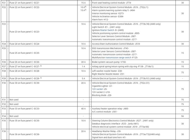

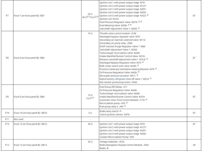

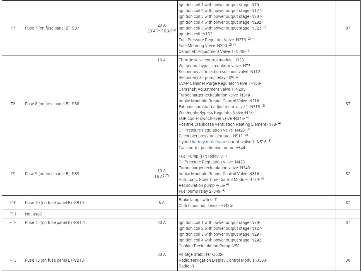

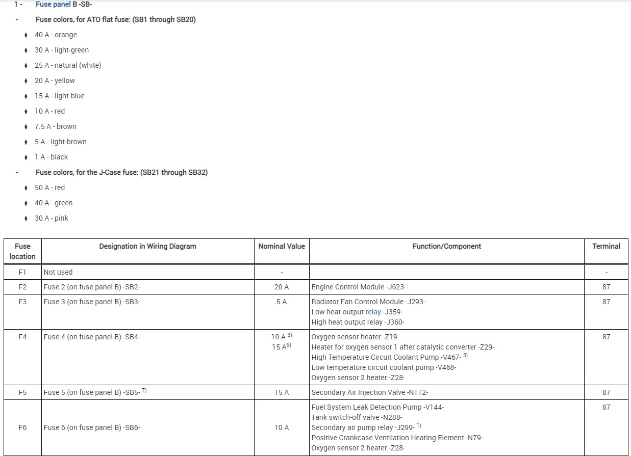

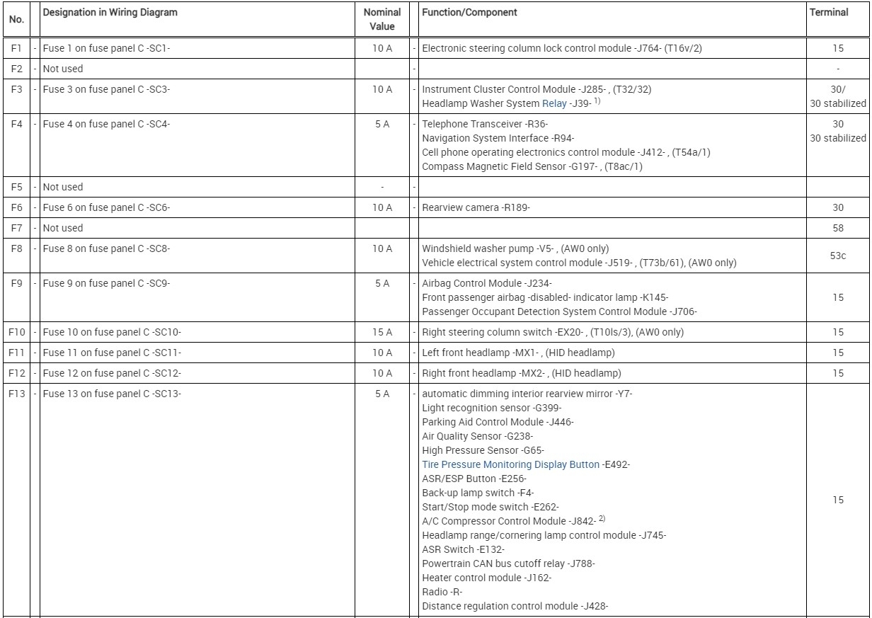

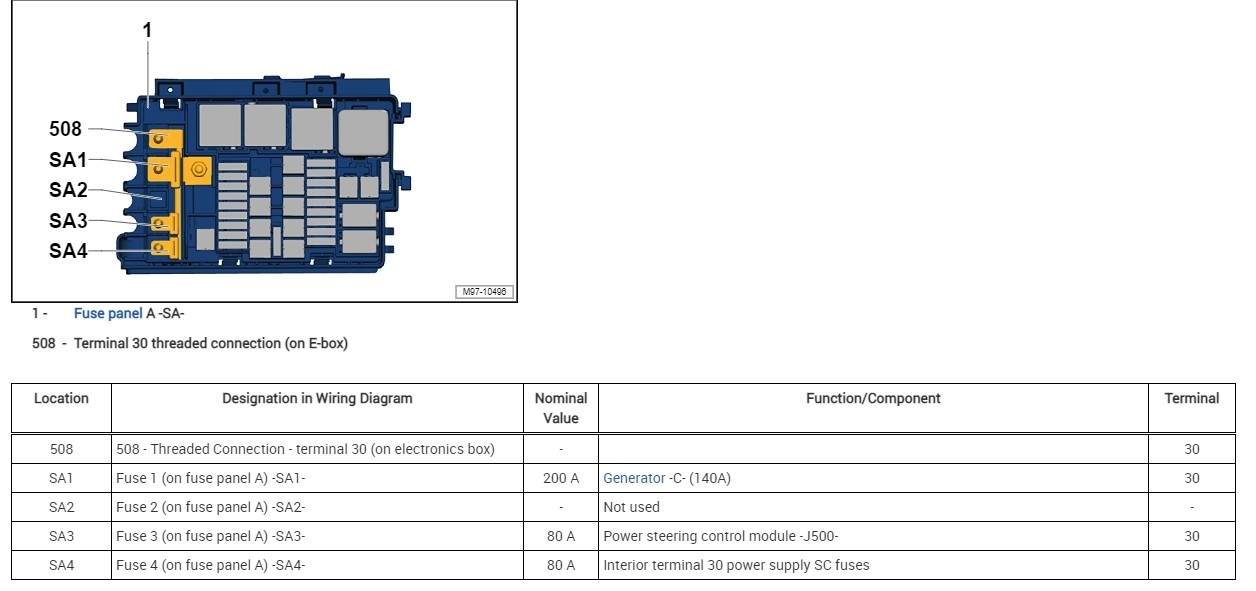

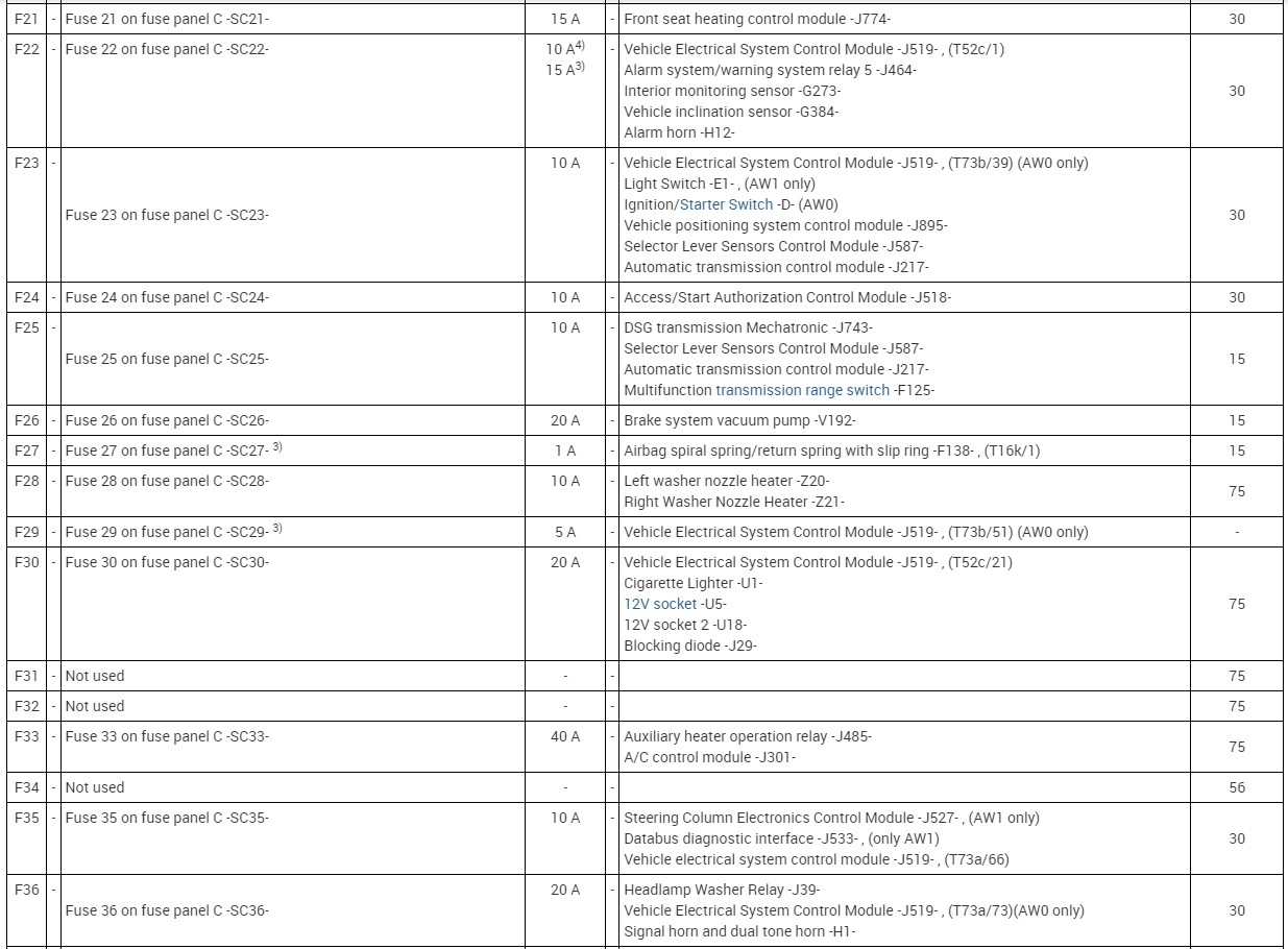

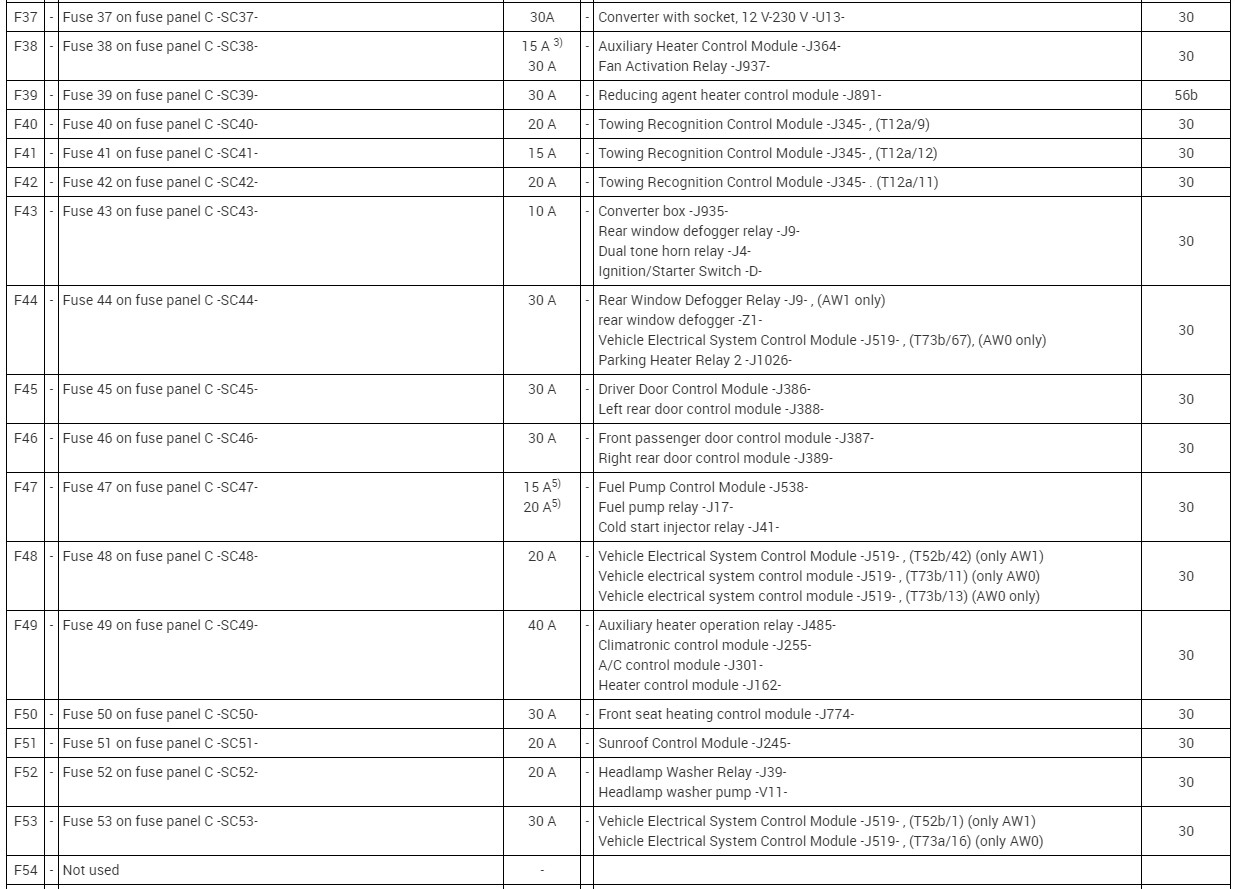

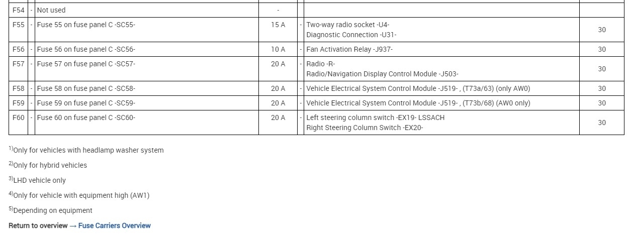

These images are the fuses used in that car. Be advised it's normal for there to be empty fuse slots as they use a common fuse block but not all the option fuses get installed. Are you having an issue?
