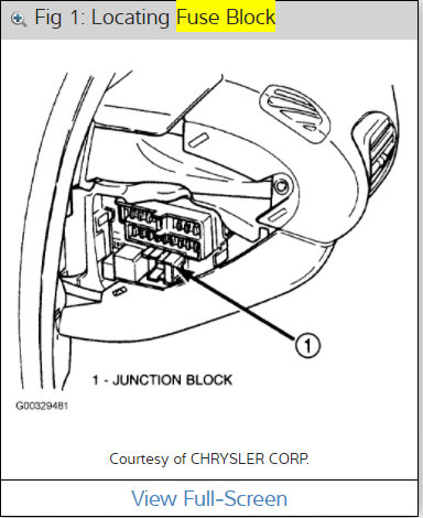

I need to get a diagram of the fuse box so I can find the ECU and rest the codes. I have found that this is the only way to do it correctly. Can anyone help me?
Aug 5, 2016 at 6:29 AM
CARADIODOC
  • 34,413 POSTS

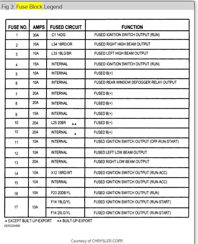

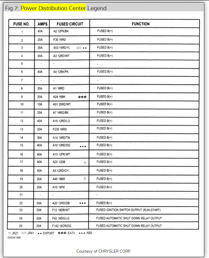

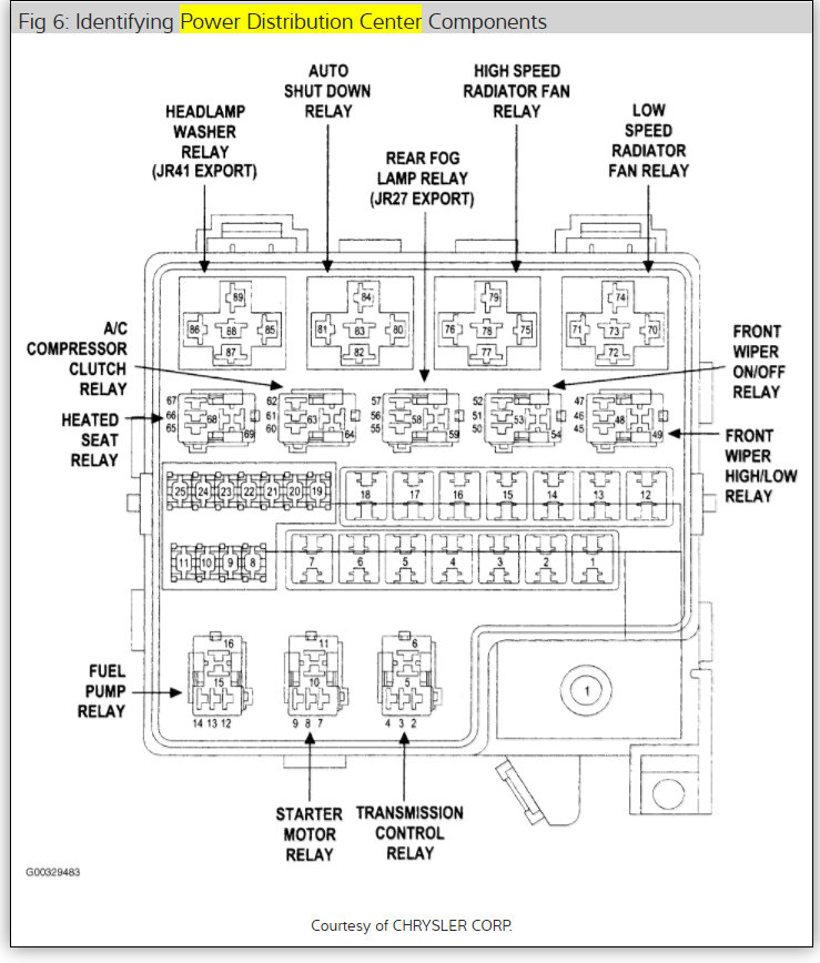

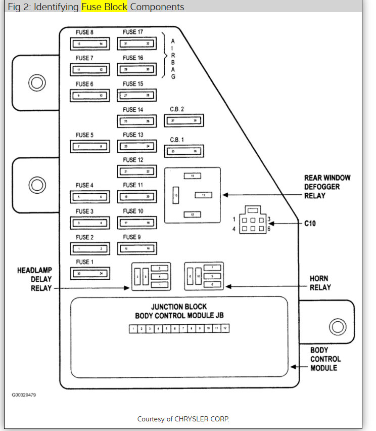

here is the fuse box location and ID with a guide to help you as well.
May 8, 2021 at 10:00 AM
DEBRA WATERS
I want to remove the ECU fuse so I can reset it, because I just replaced my 02 sensor.
RIVERMIKERAT
  • 6,106 POSTS
Pulling the battery positive will do the same thing. But you should use a scanner to reset it.
