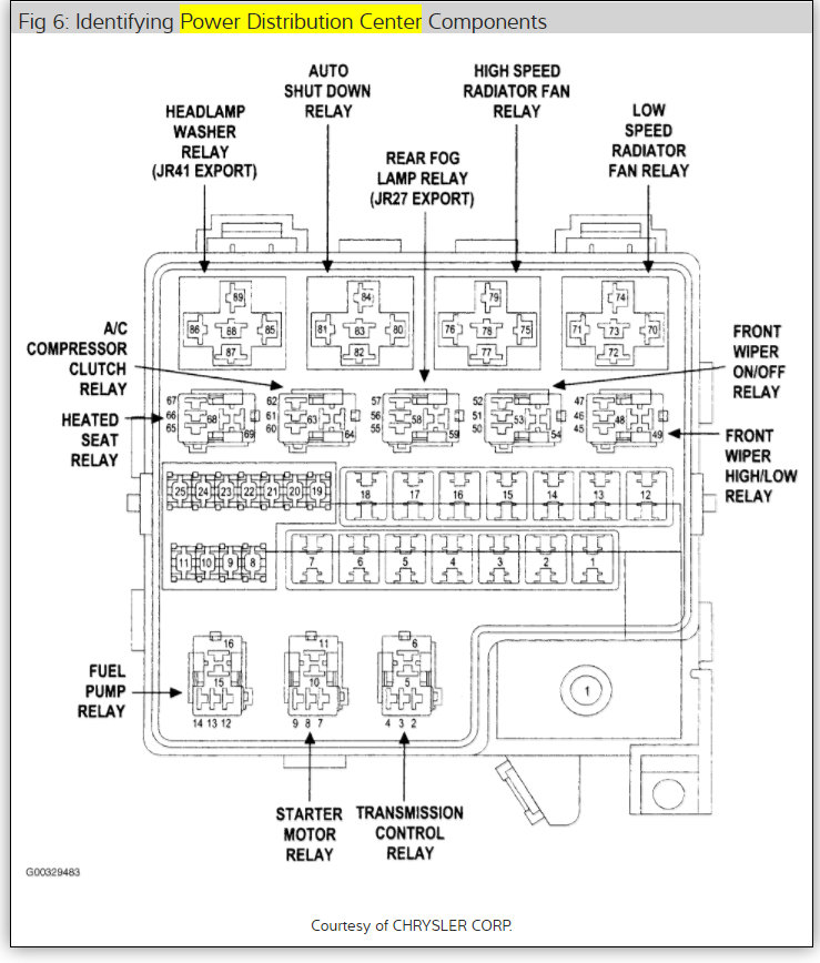

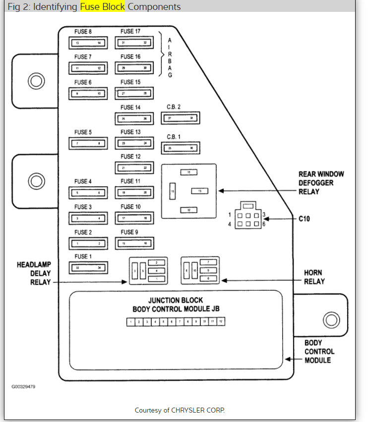

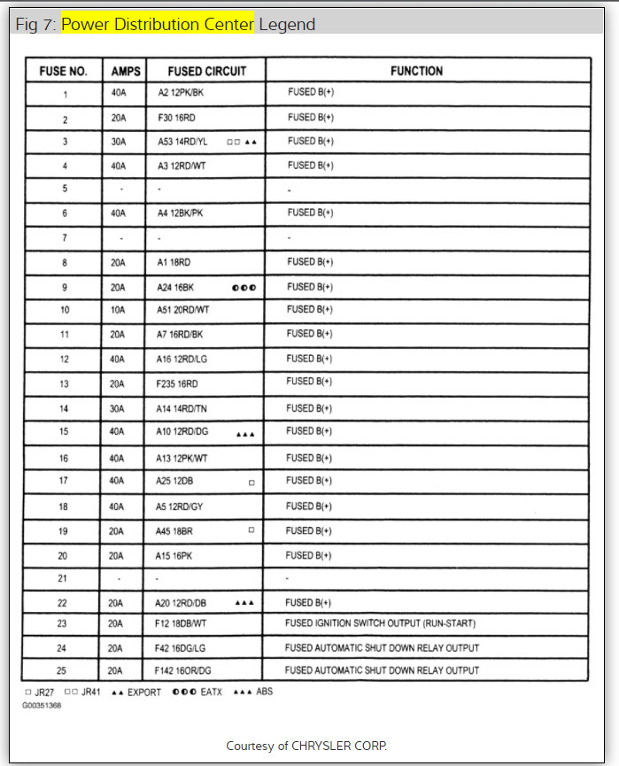

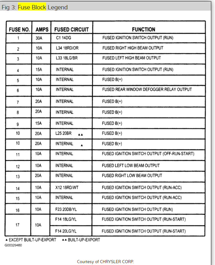

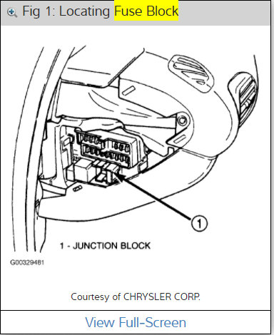

I need to get a diagram of the fuse box so I can find the ECU and rest the codes. I have found that this is the only way to do it correctly. Can anyone help me?

here is the fuse box location and ID with a guide to help you as well.

I want to remove the ECU fuse so I can reset it, because I just replaced my 02 sensor.

Pulling the battery positive will do the same thing. But you should use a scanner to reset it.
