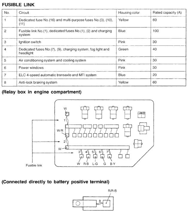

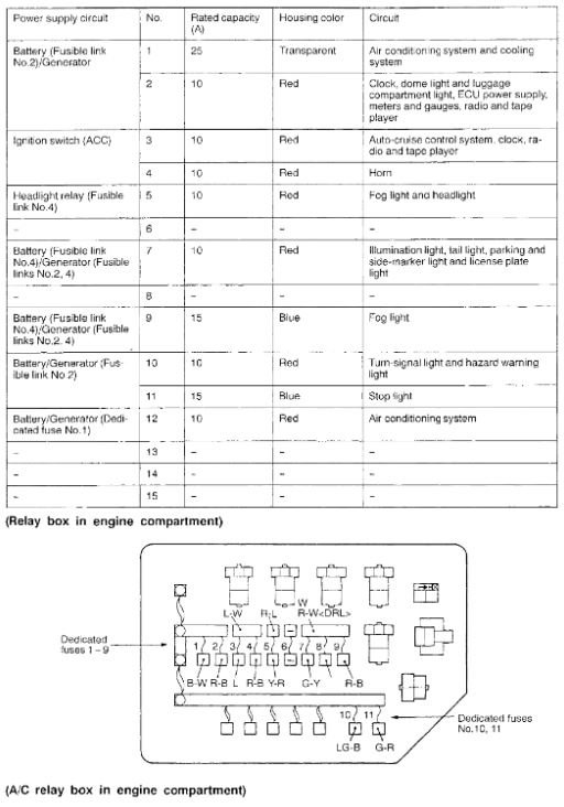

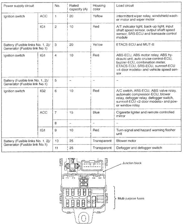

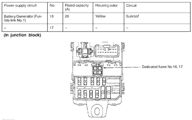

Hi! Both of my fuse box covers are gone and don't know what fuse is what. I need to replace some fuses and I'm scare I put the wrong fuse in the wrong spot. can you please help?
Nov 1, 2019 at 11:17 PM
MASTERWRENCH
  • 258 POSTS
Here you go. Let us know if you need anything else!
Nov 3, 2019 at 6:37 AM
BEBO131313
  • 7 POSTS
Very, very, i mean very helpful! I appreciate it man. With those diagrams i could see where my problem was. God bless and thank you.
