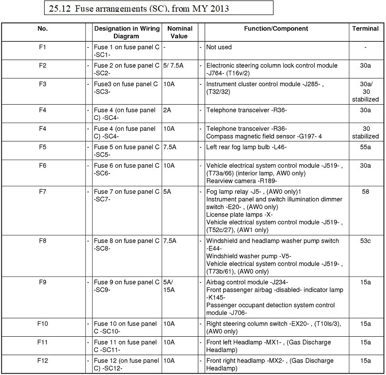

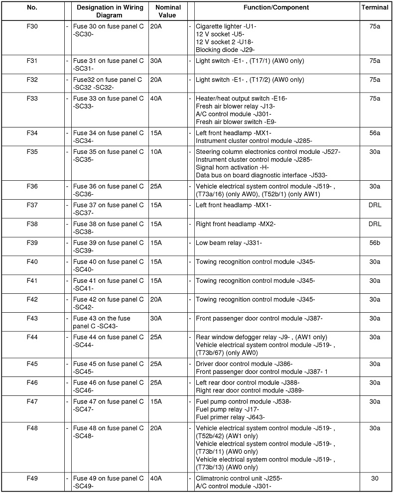

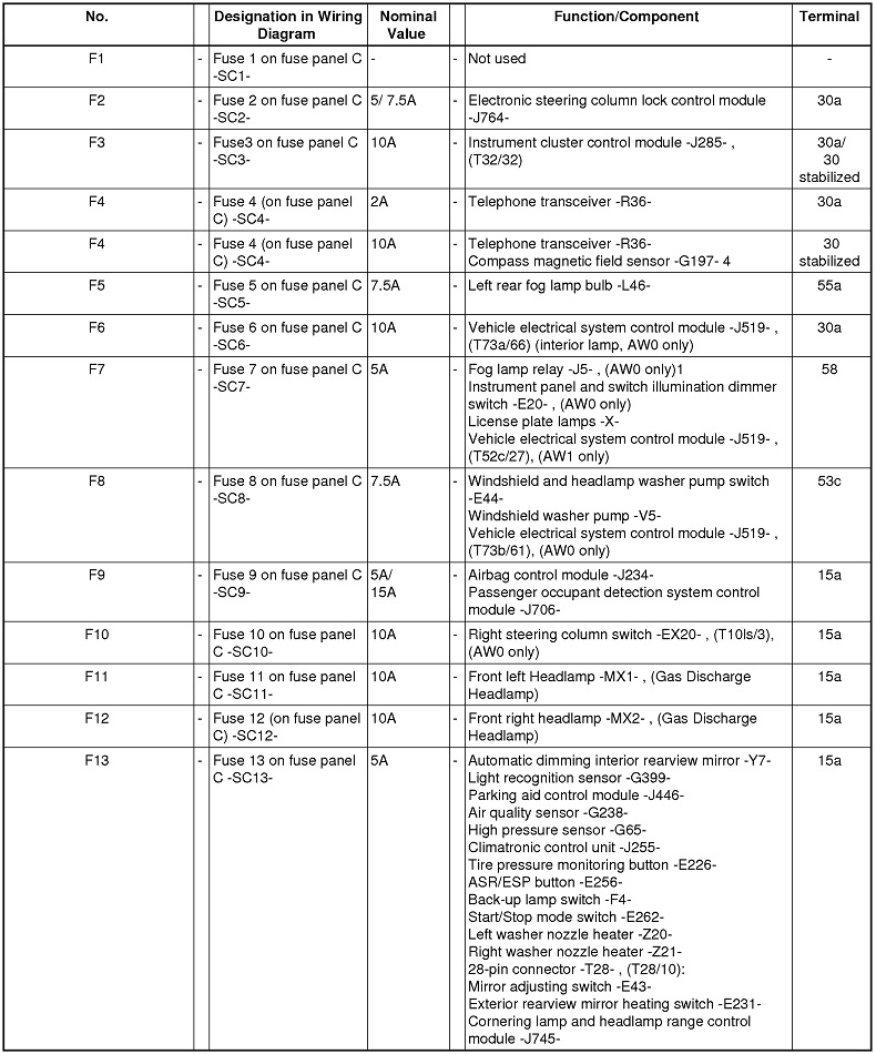

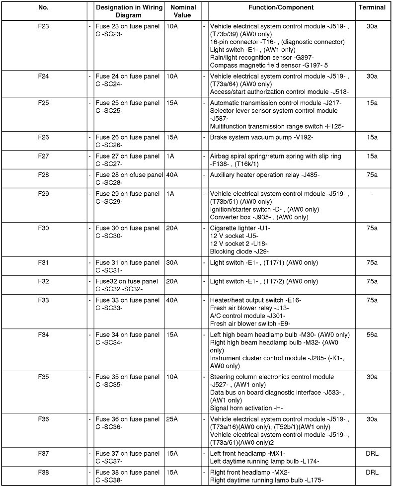

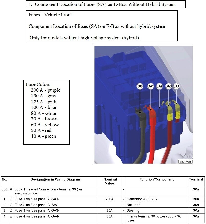

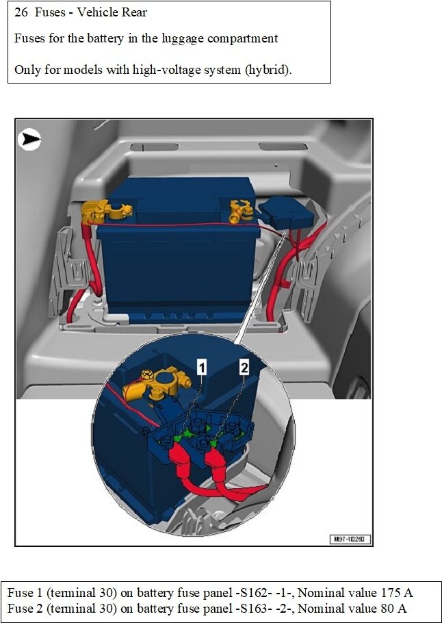

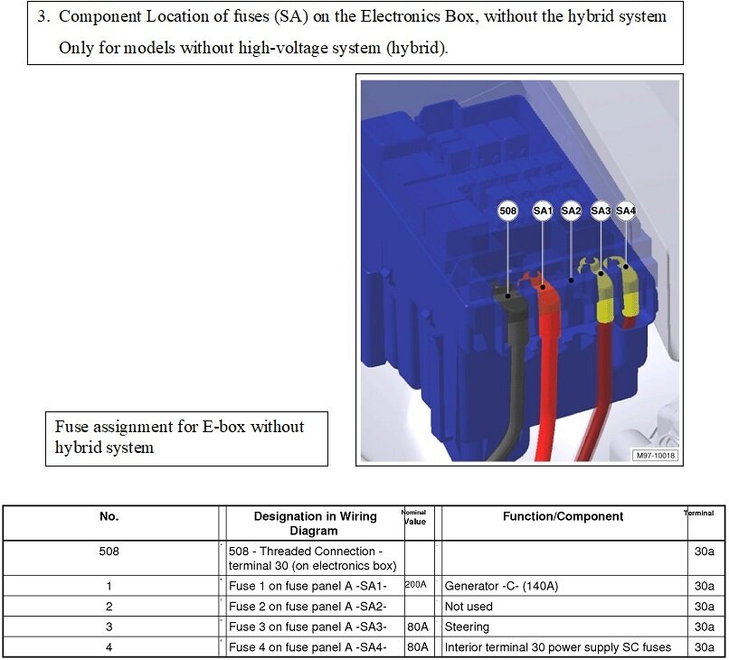

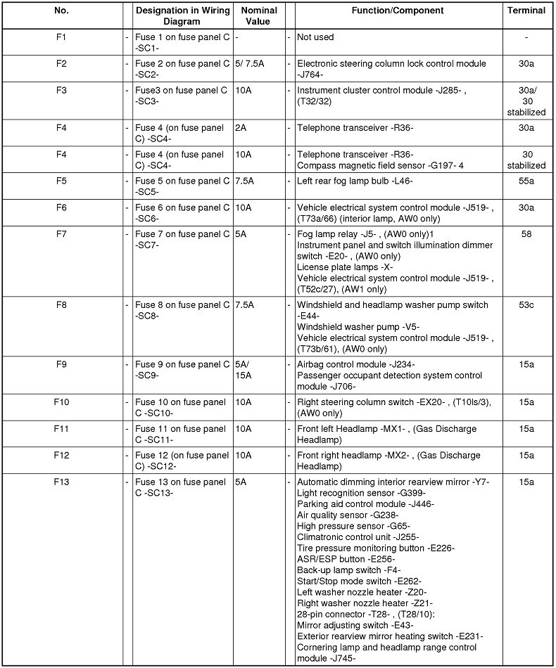

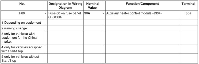

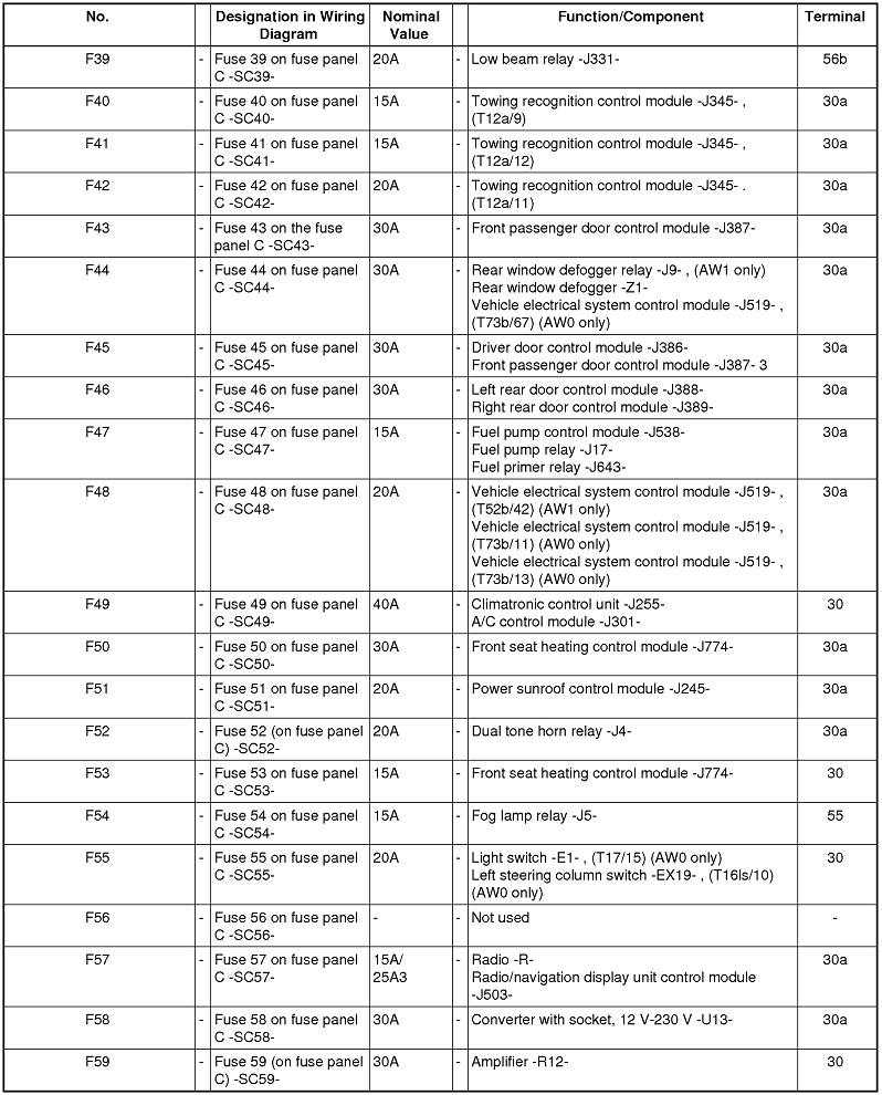

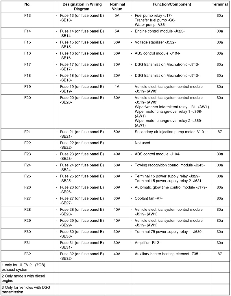

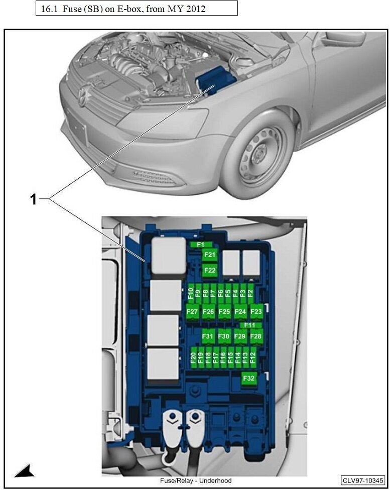

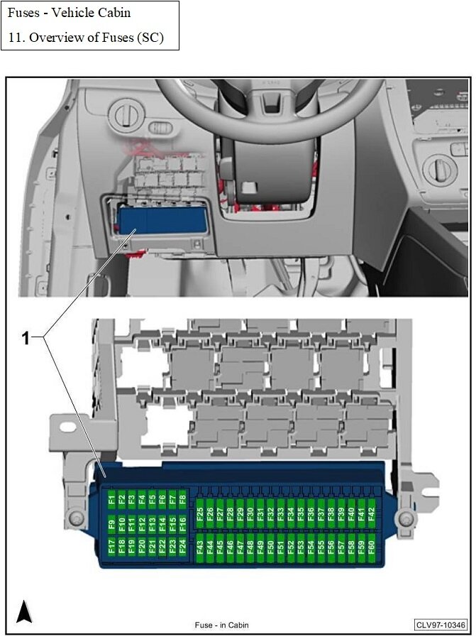

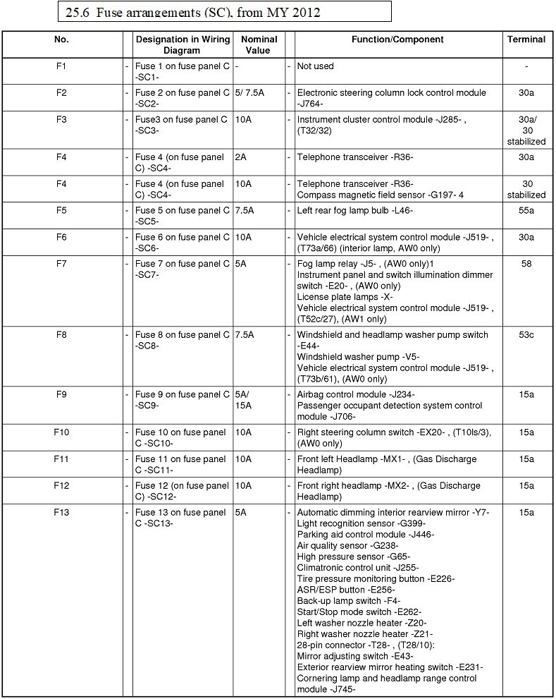

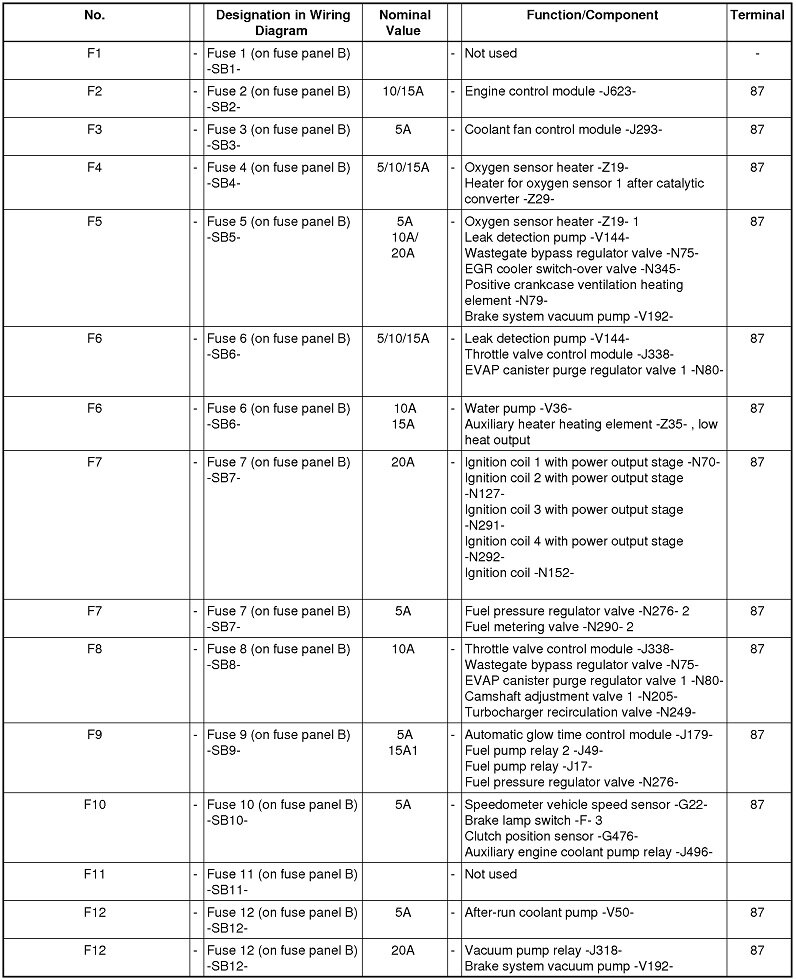

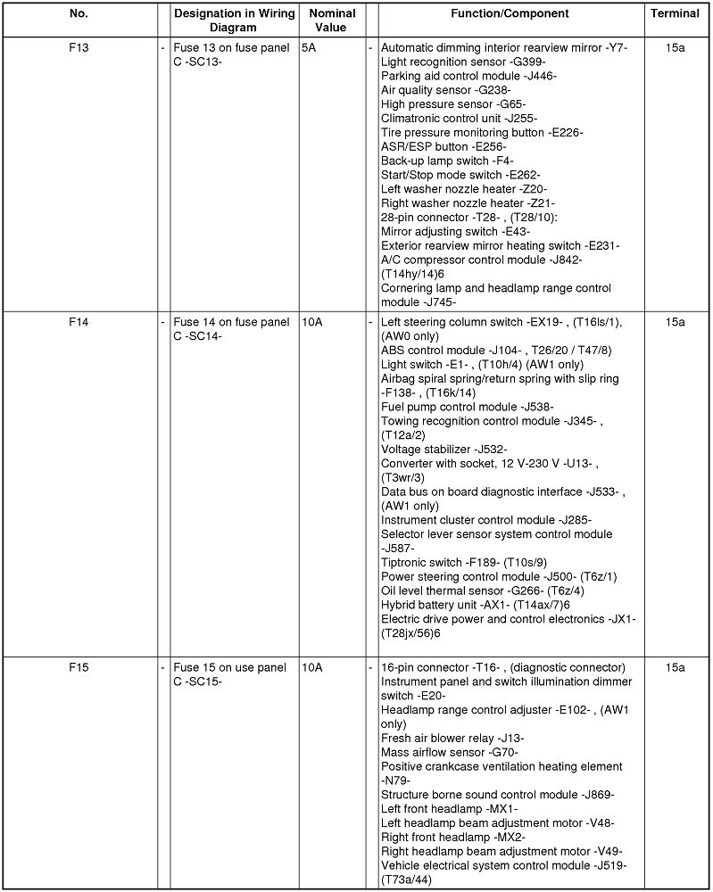

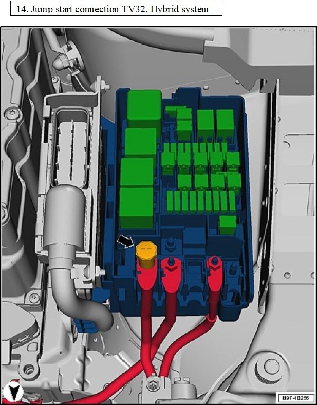

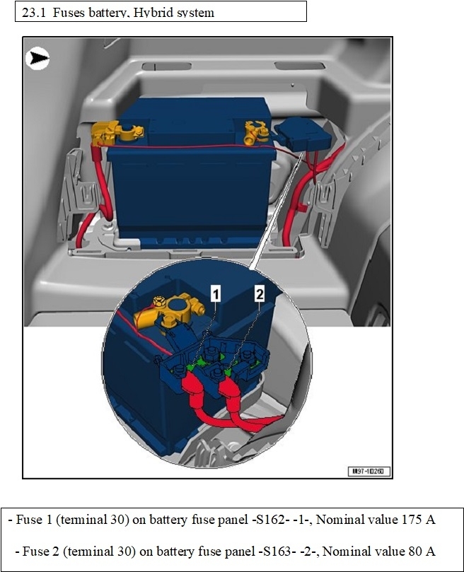

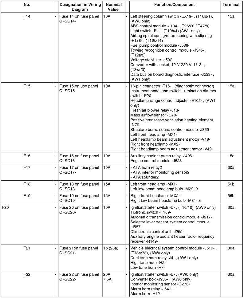

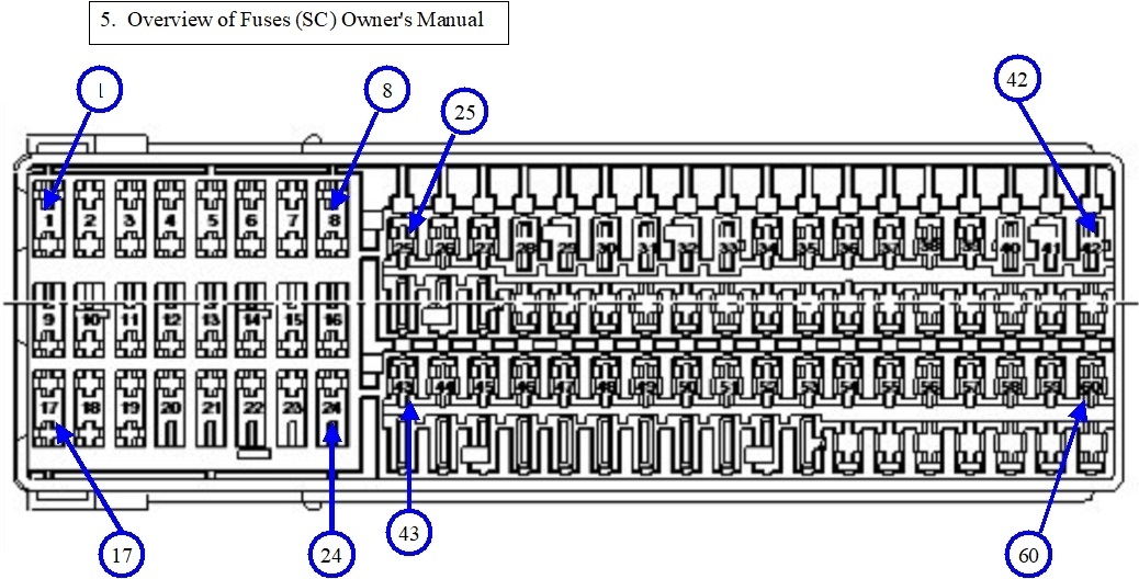

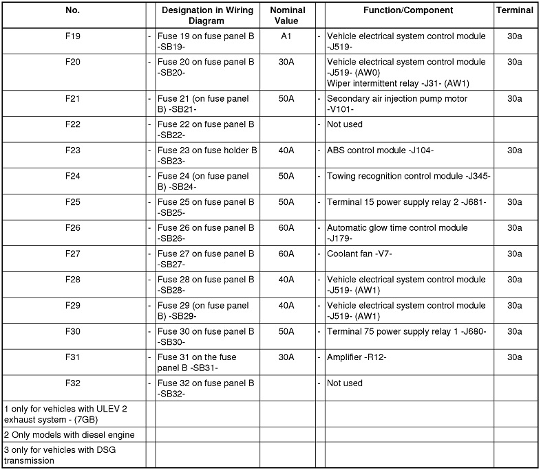

I need a diagram and labels for my car listed above.

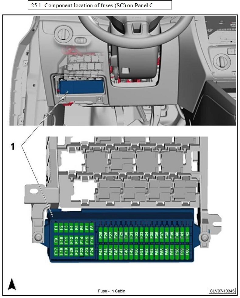

There's way too many options to format for posting. Also, I only have a listing for a 2.0L turbo engine. Use this list and drawing to choose which diagrams apply to your car. It will take a little time for me to post them. My service literature doesn't specifically list a hybrid model, but that is an option on this fuse list, so you'll need to specify that too. There's also multiple model years on this list. We shouldn't need those unless your car was built early or late in the model year.

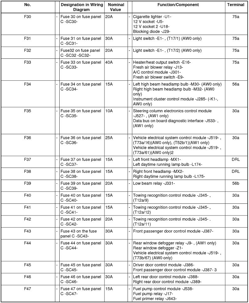

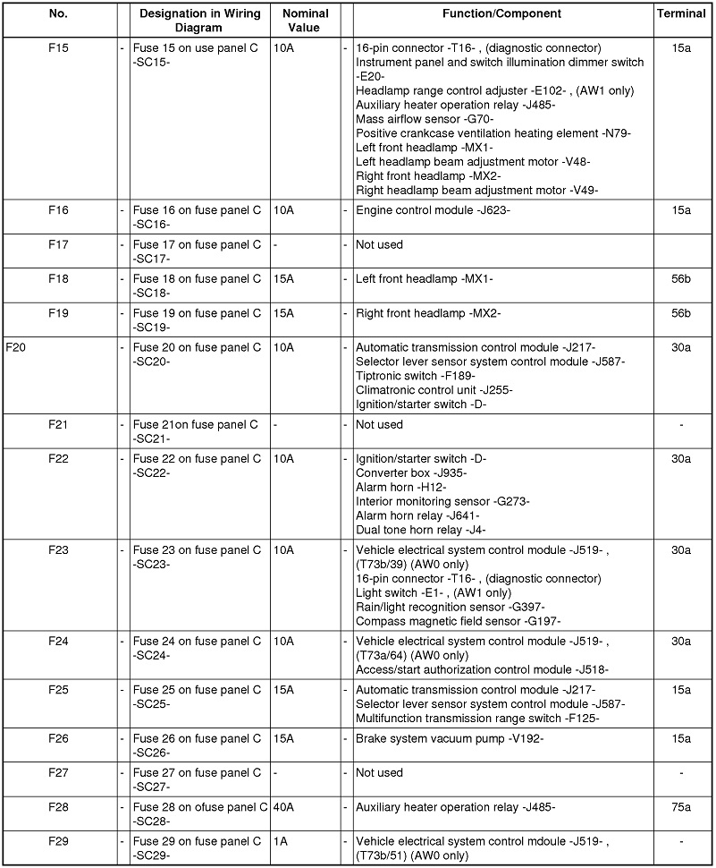

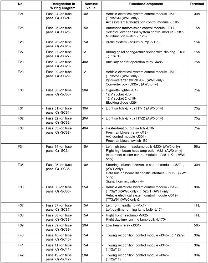

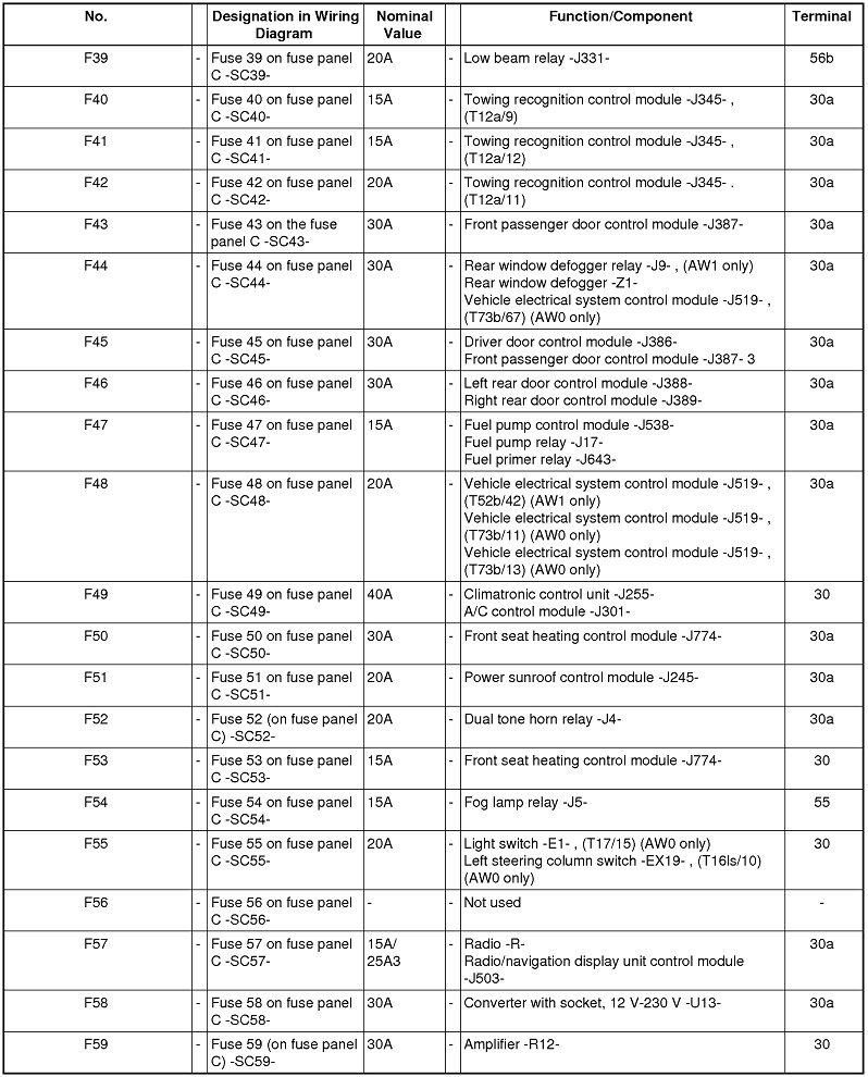

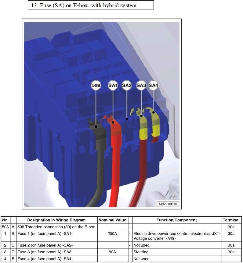

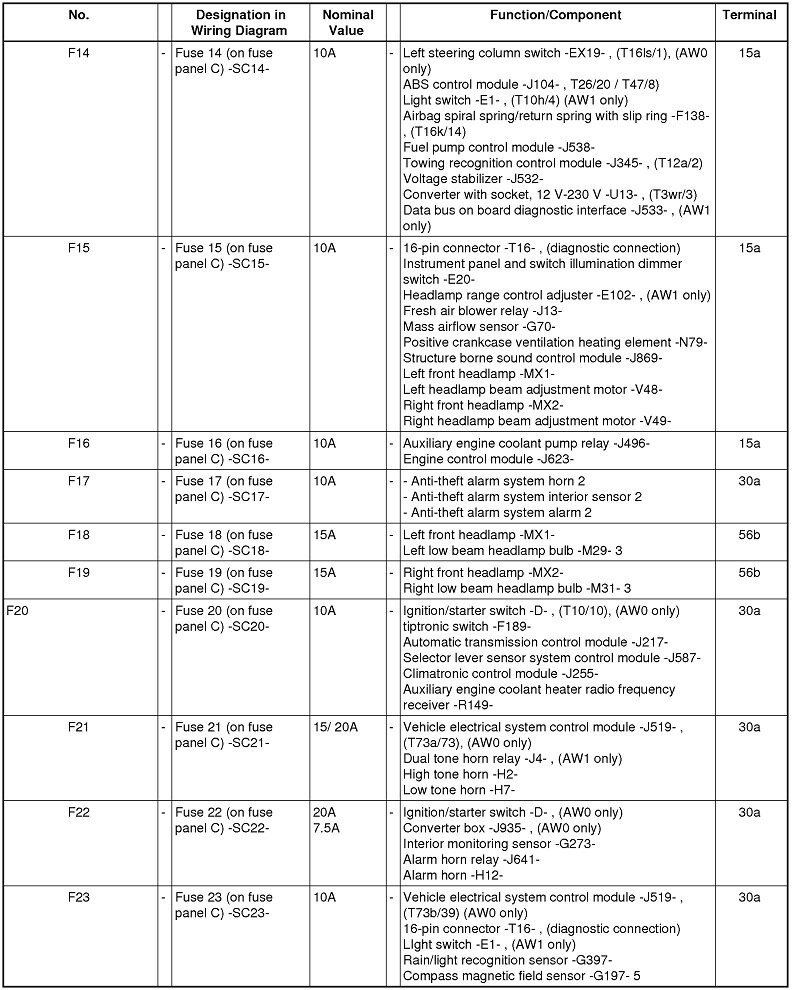

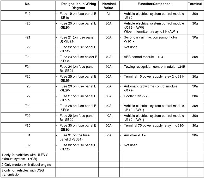

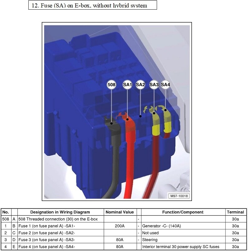

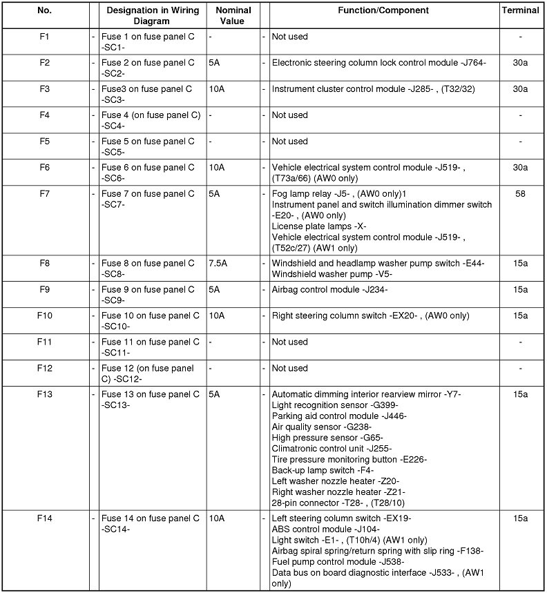

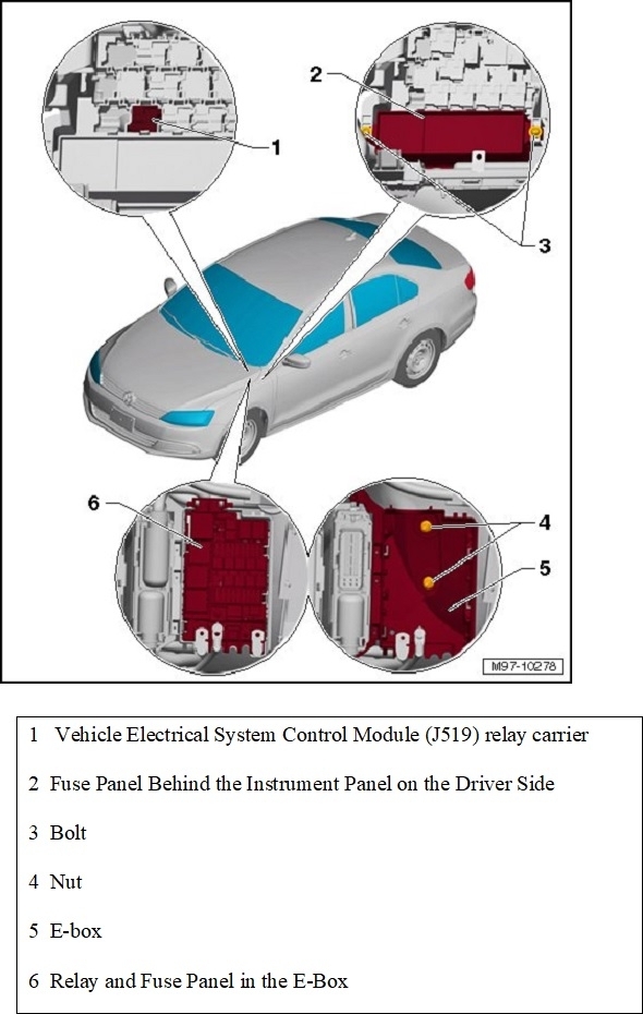

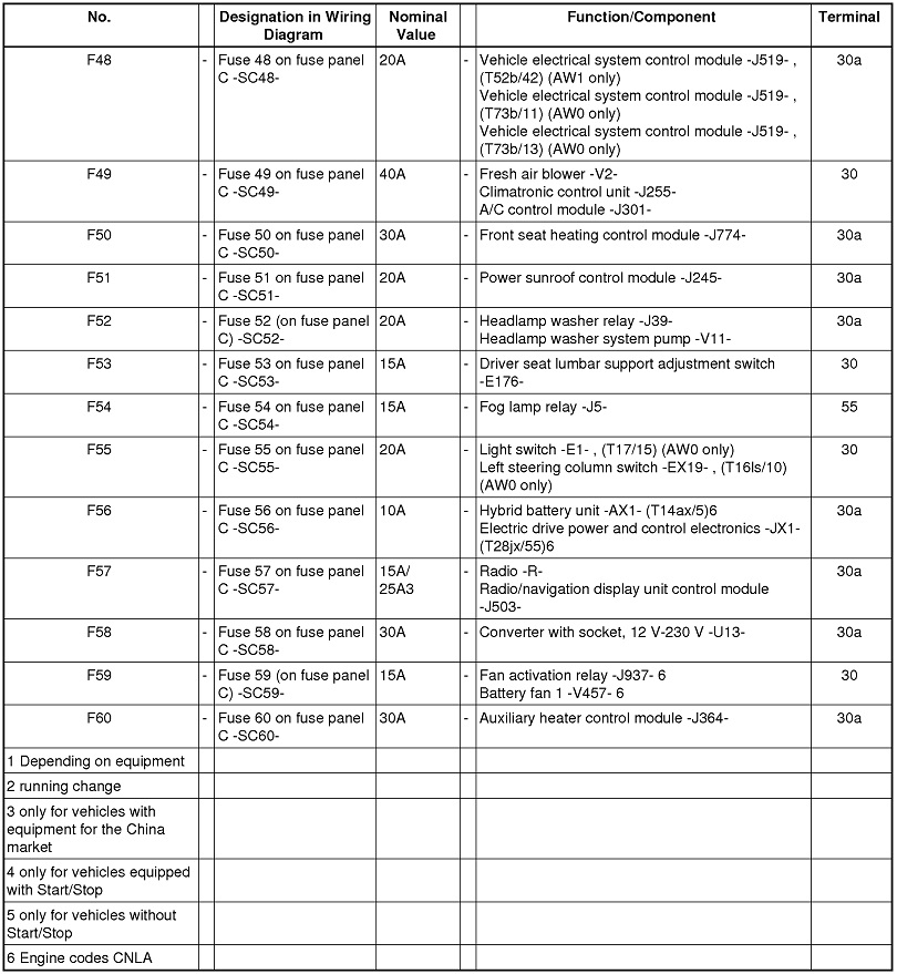

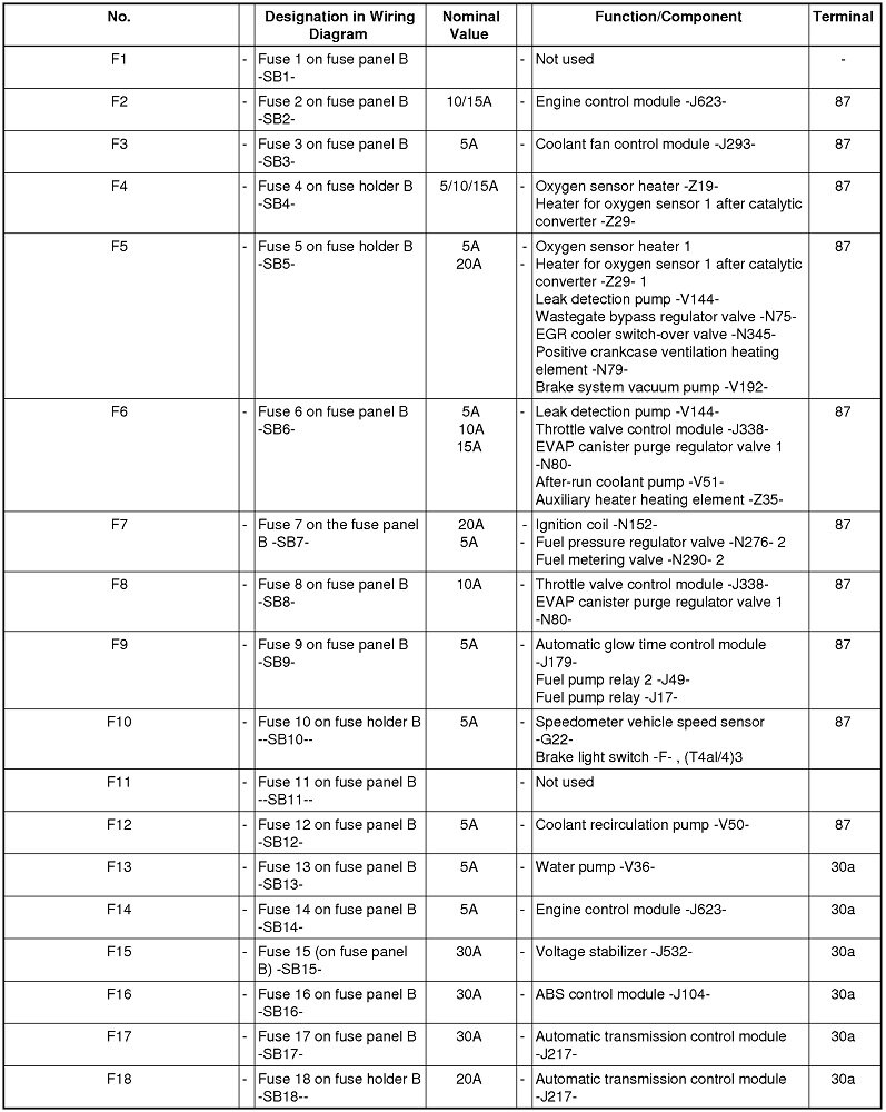

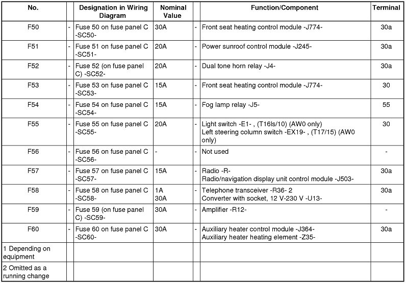

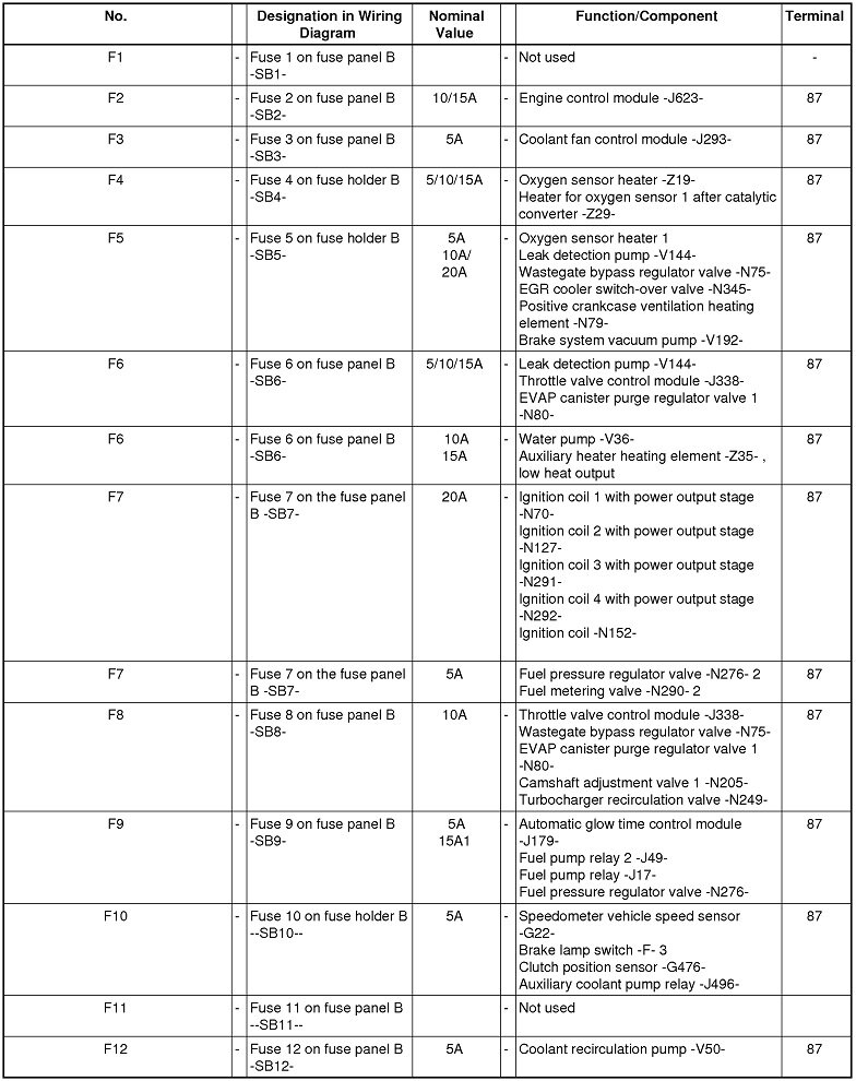

Okay, here's what it takes to work on a VW. This is only half of what I downloaded for you. The other pages pertain to other model years. There will likely be some pages here too that don't apply. You'll have to look at the photos to figure out which fuse box you're working with, then look at the appropriate lists.
I expanded the lists as much as possible, but they can still be hard to read. You can copy and paste them into a typing program, then enlarge them. I use MS Word to resize and format them, then I copy them into MS Paint to format them in a way web sites like.
