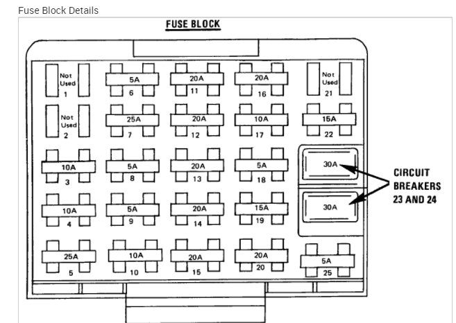

This car is missing a wire diagram to the fuse box under the driver side and all the fuse have been remove while it was park. I need direction for installing new one and what they are for what part.
Mar 28, 2017 at 8:03 PM

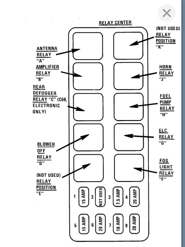

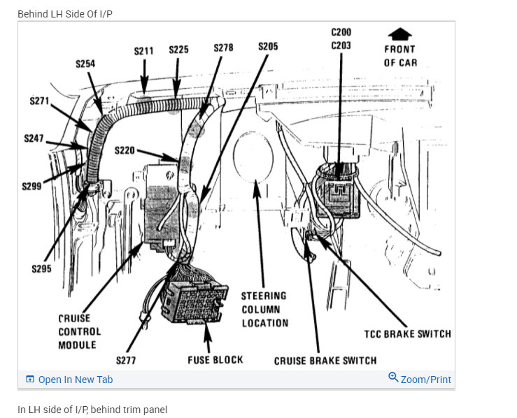

I am attaching the layout of the fuse blocks with amp ratings so that you can reinstall each of the fuses.
