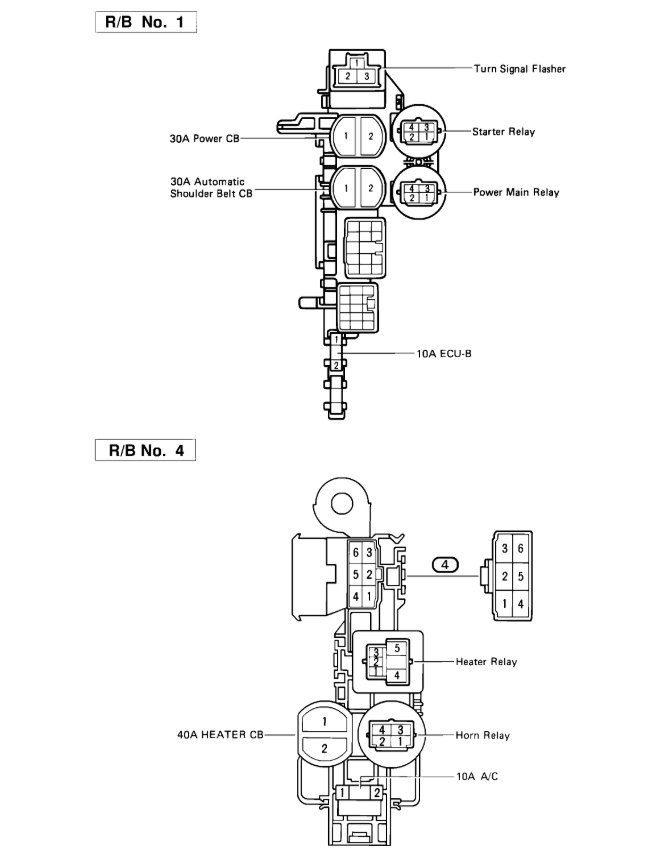

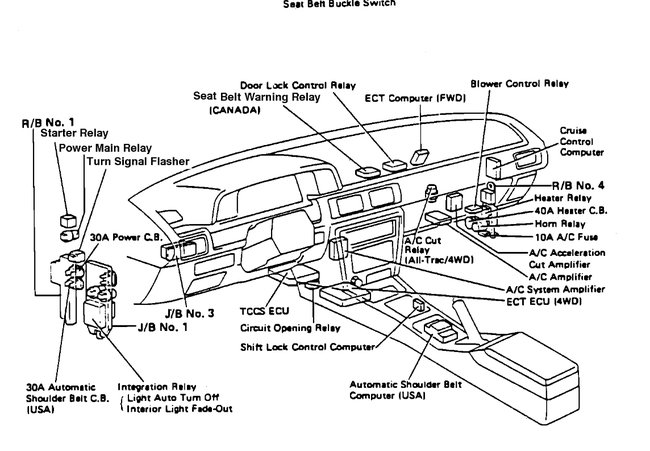

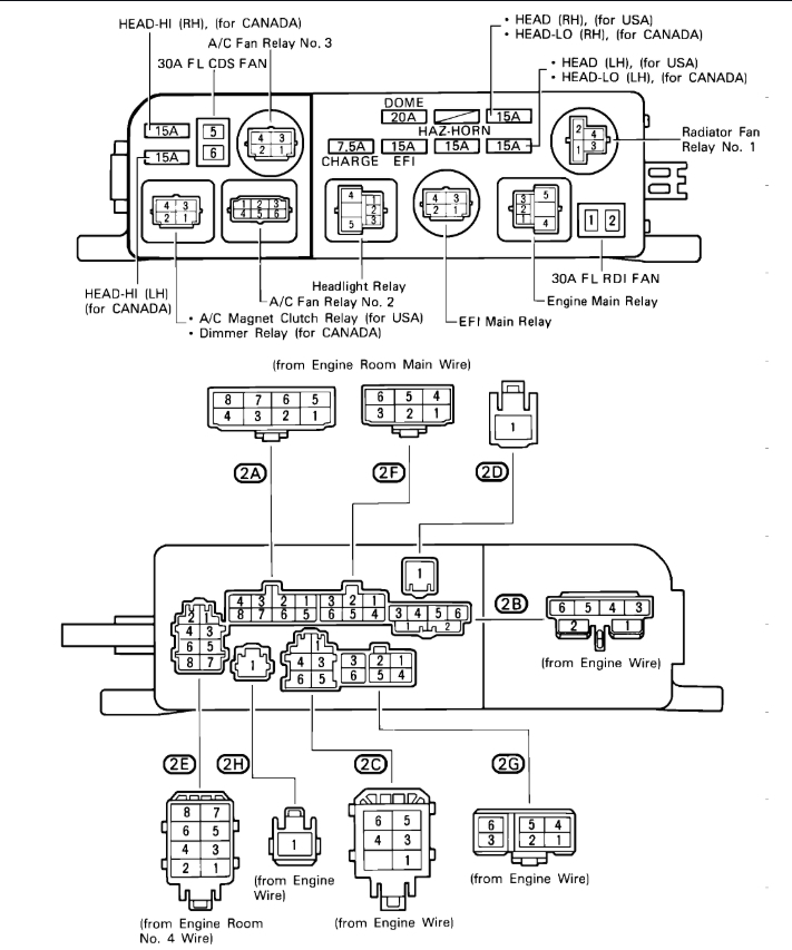

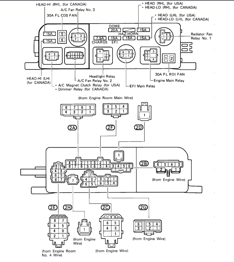

Can I get the fuse box diagram, please?
1990 TOYOTA CAMRY
200,000 MILES • 2.0L • 4 CYL • AUTOMATIC
ARNOLD TZUL
MEMBER
2 POSTS

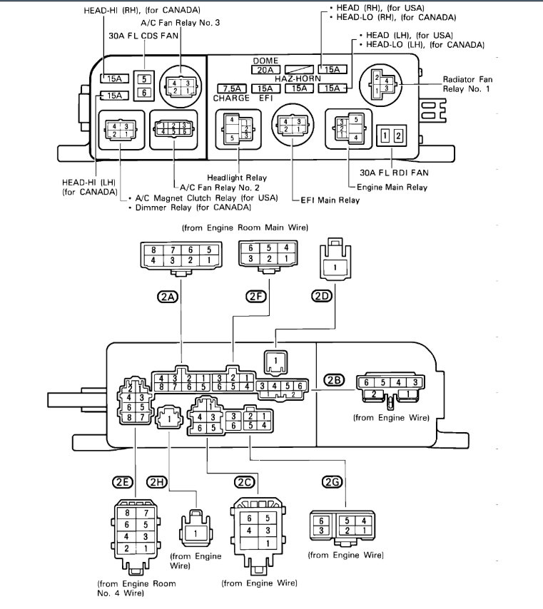

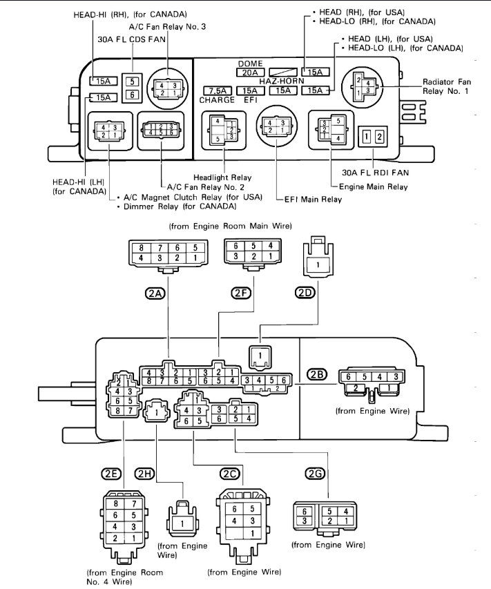

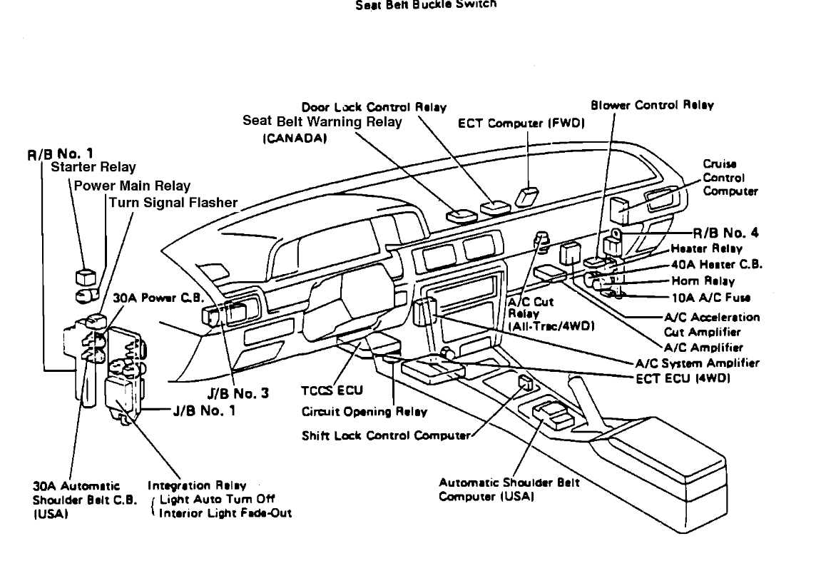

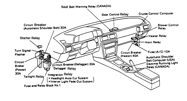

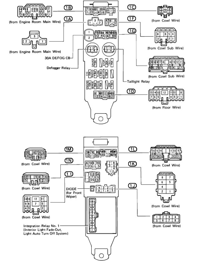

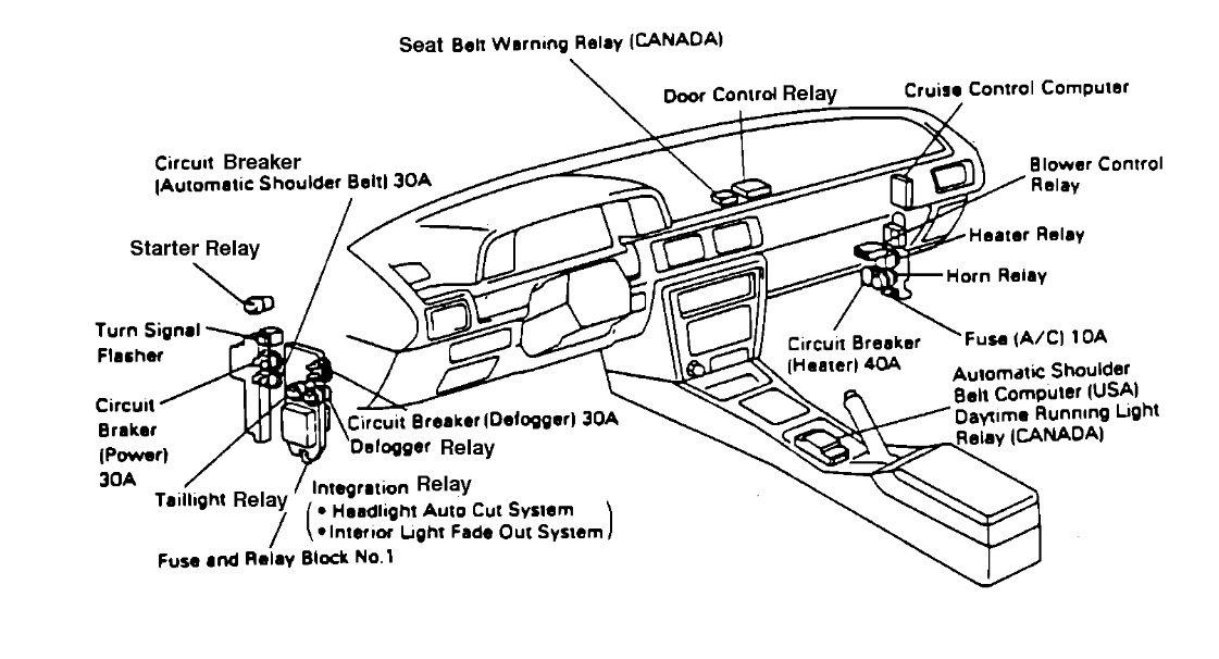

I need I fuse box diagram, please?
Jul 30, 2022 at 3:27 PM
Experienced Mechanic
55,500 POSTS
Sure, here are the fuse panel locations and diagrams for your car with a guide to help you test the fuses:
Images (Click to enlarge)
