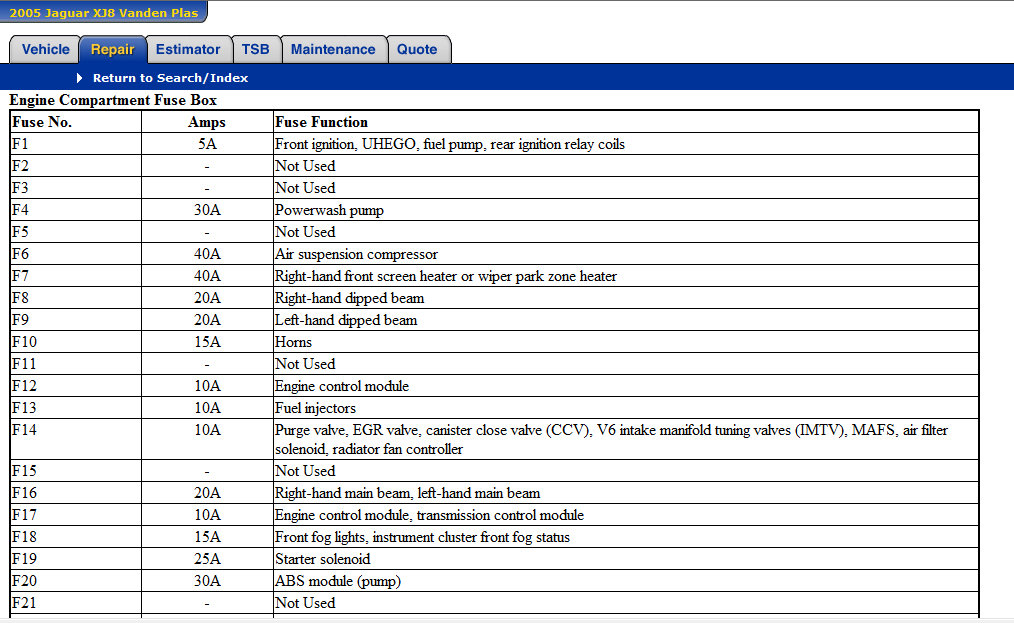

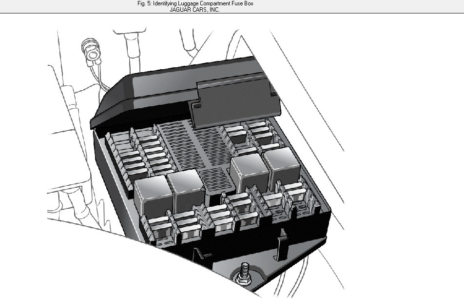

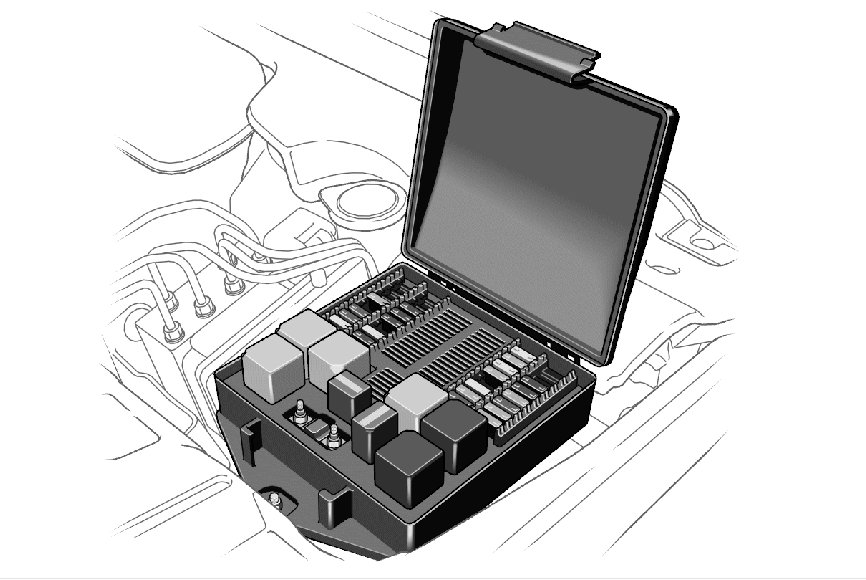

I just bought a this car and it didn’t come with the manual. My headlight fuse is blown but i don't know which one is the right fuse.

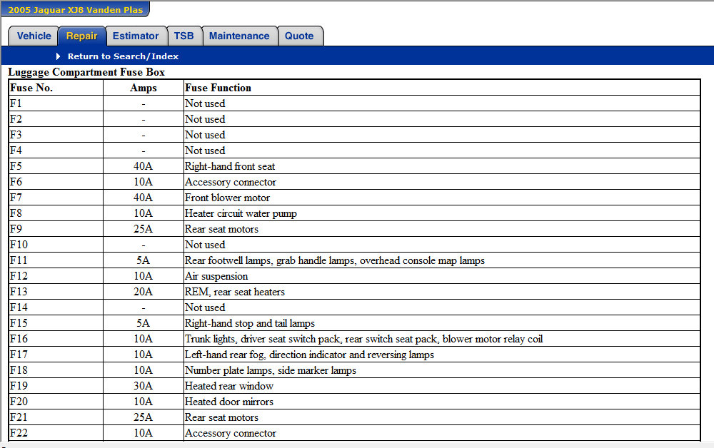

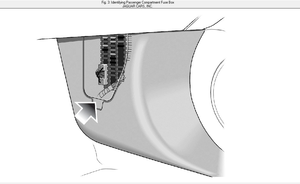

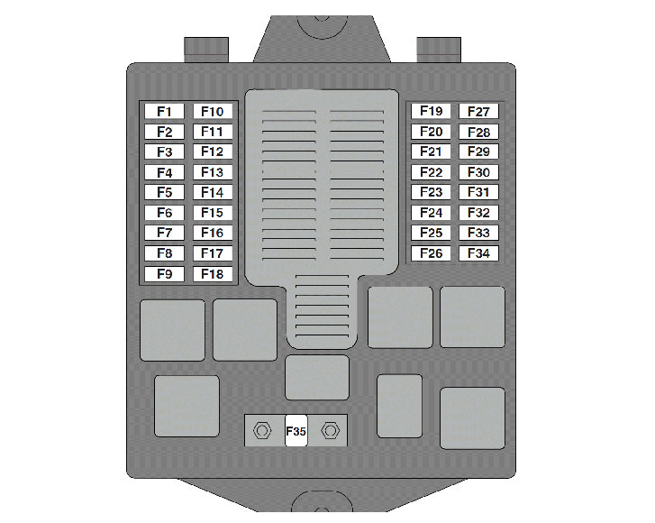

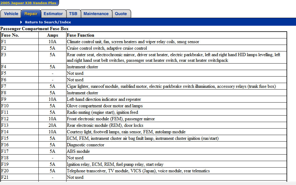

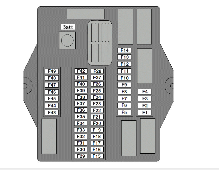

Your car has three main fuse boxes one inside the engine compartment check (figure,1,2,3),the other at the passenger compartment check (figure,4,5,6)and the last one inside luggage compartment check (figure 7,8).
The fuse for headlight that you are looking for at the engine compartment, fuse number 16(f 16) 20 a ,for main beams,and the fuses for dipped beam f8, f9,both 20a.
Let us know if you need more help.
