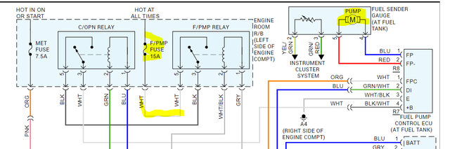

Fuse box, which wire is for the fuel pump?

Hello, the fuse box is located under the hood. Do you know the color of the wire that’s for the fuel pump 15 amp? Thanks

I attached a pic below showing what I believe you are looking for. If I'm correct, the wire should be white.
Take a look at the picture and let me know if it helps.
