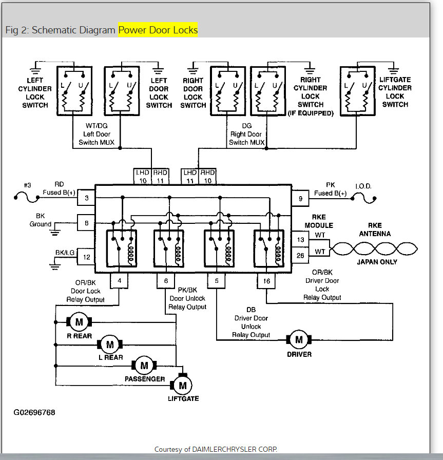

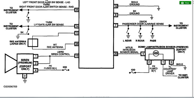

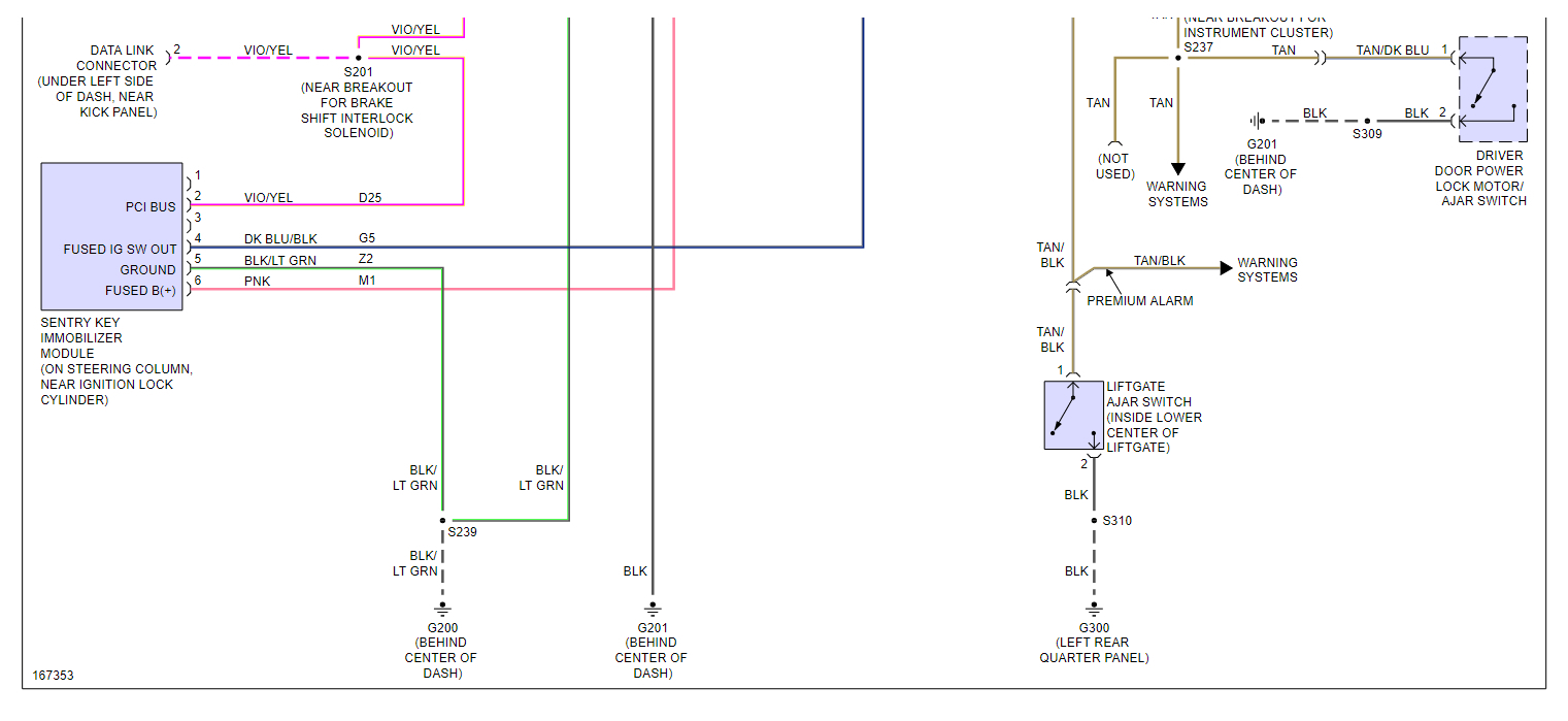

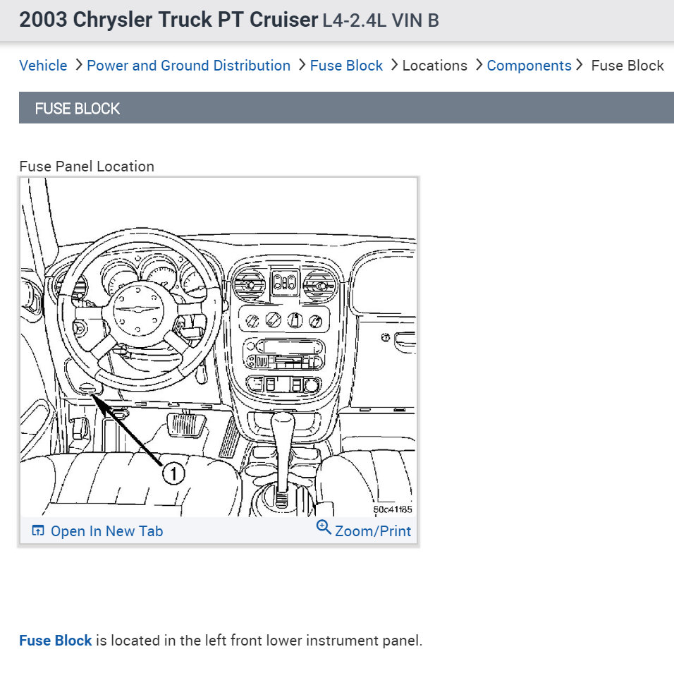

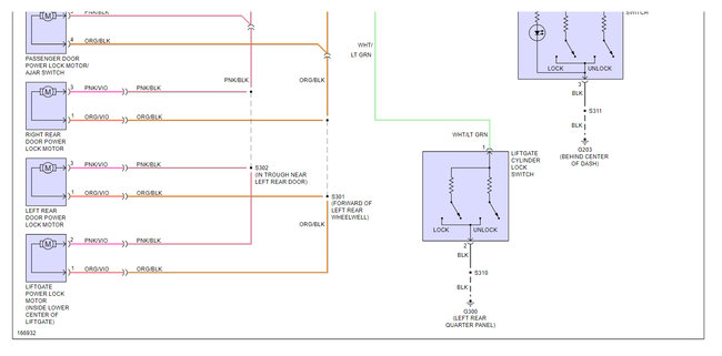

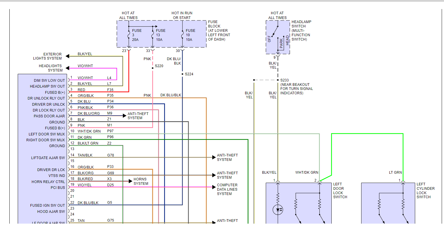

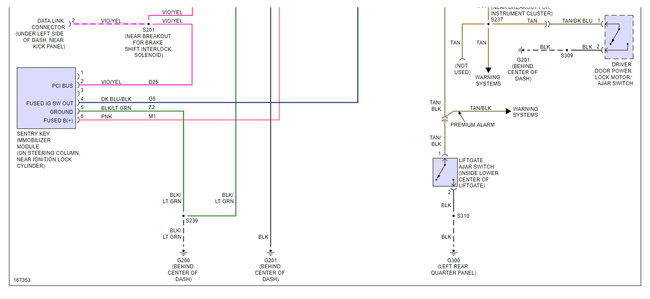

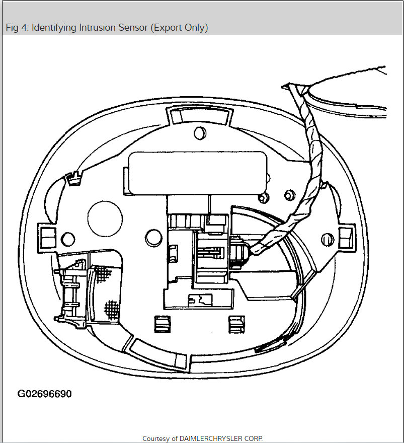

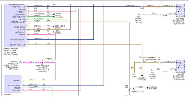

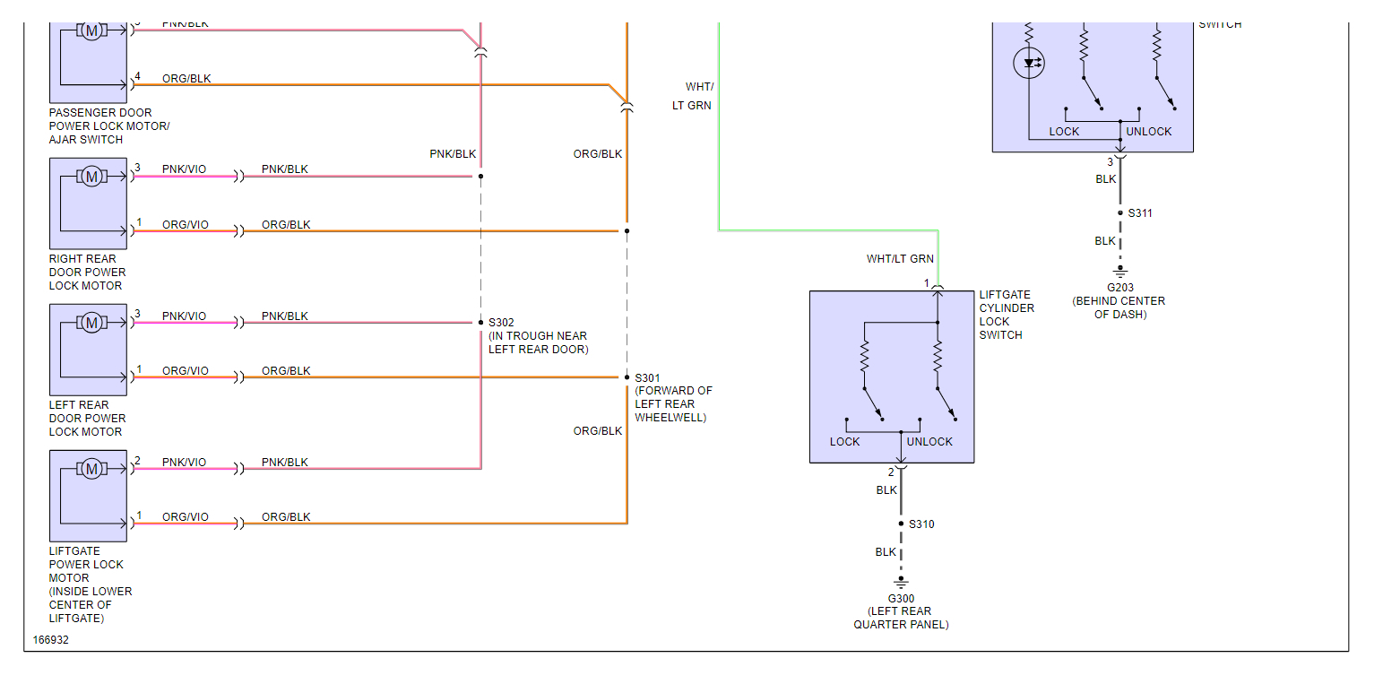

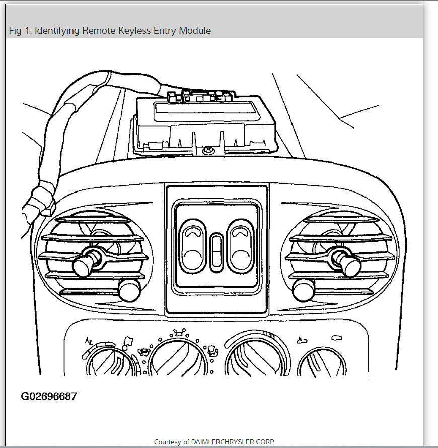

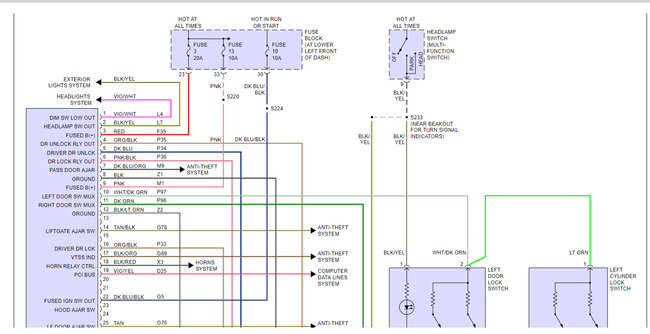

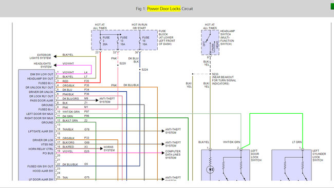

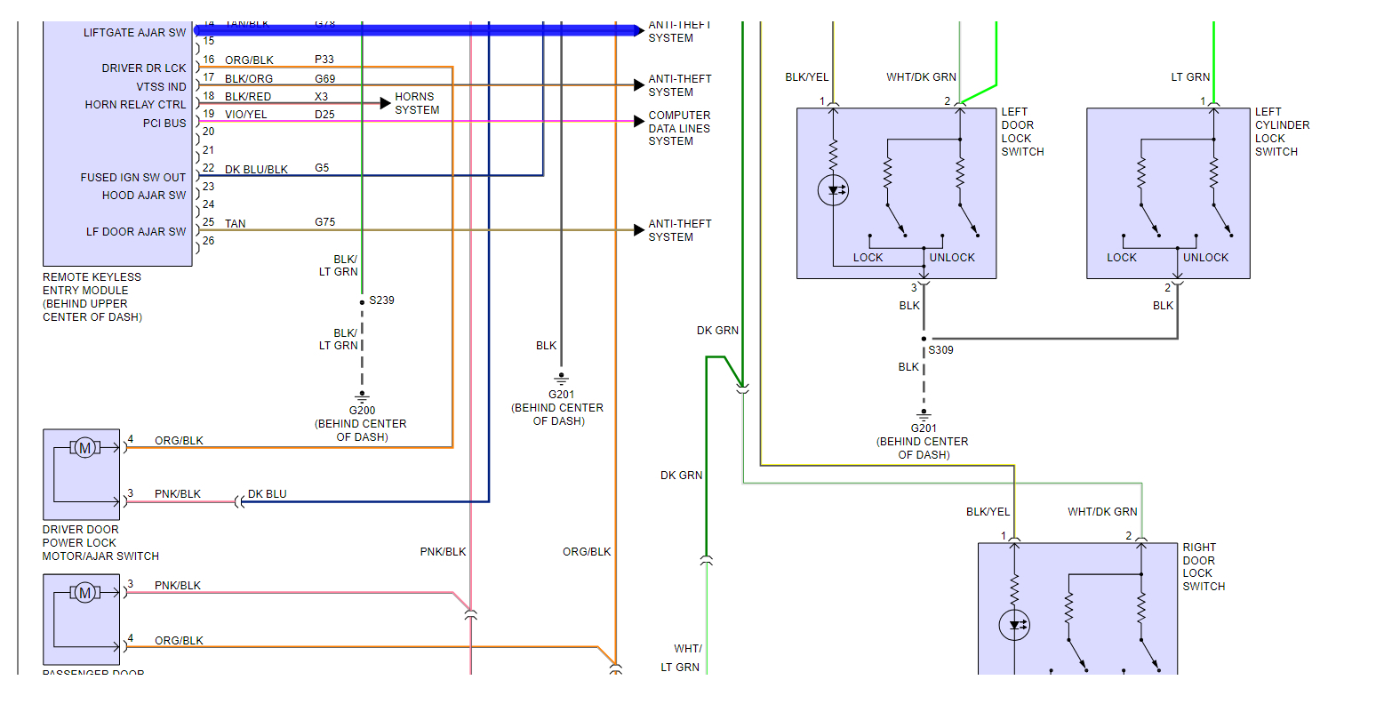

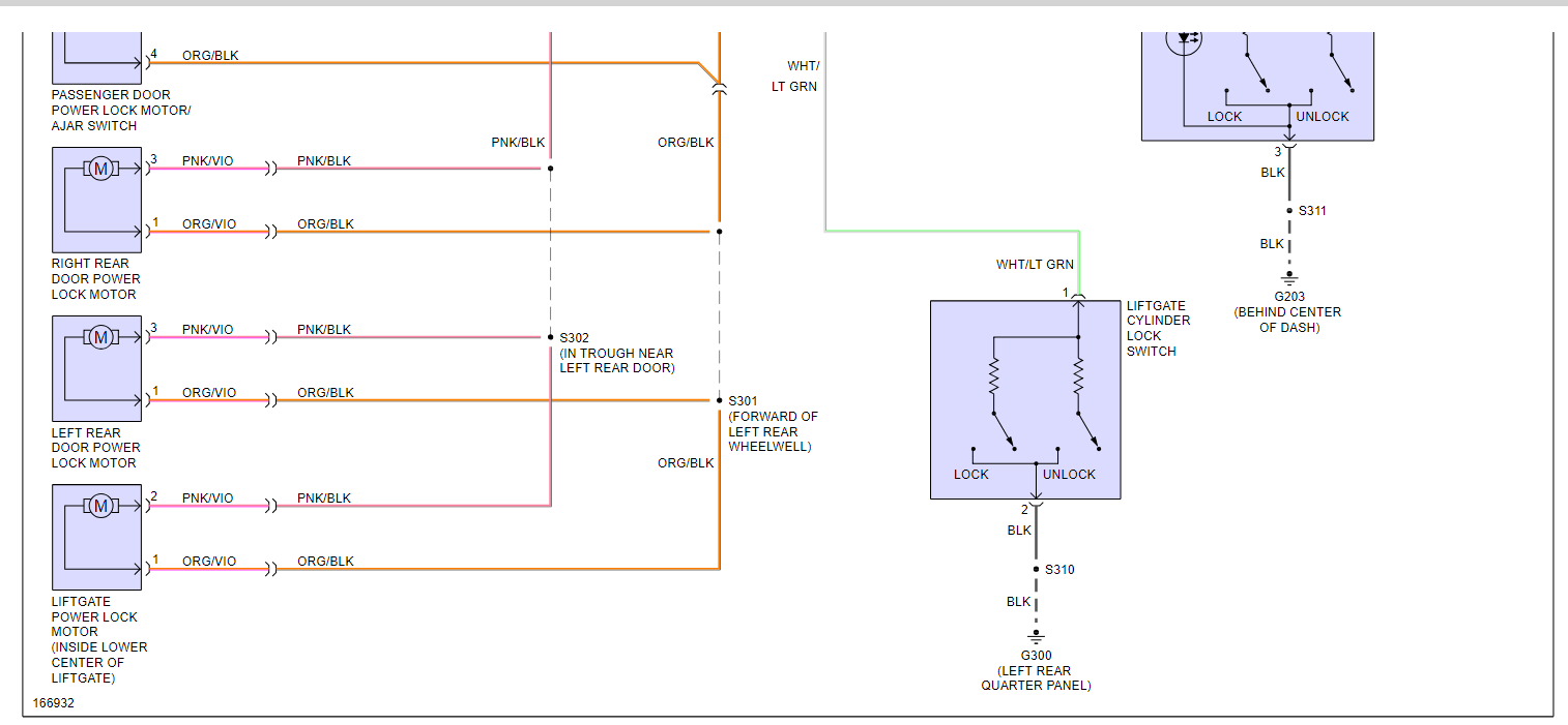

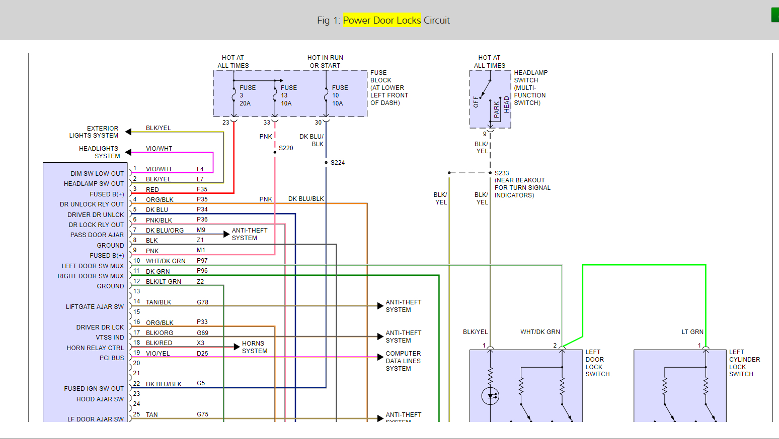

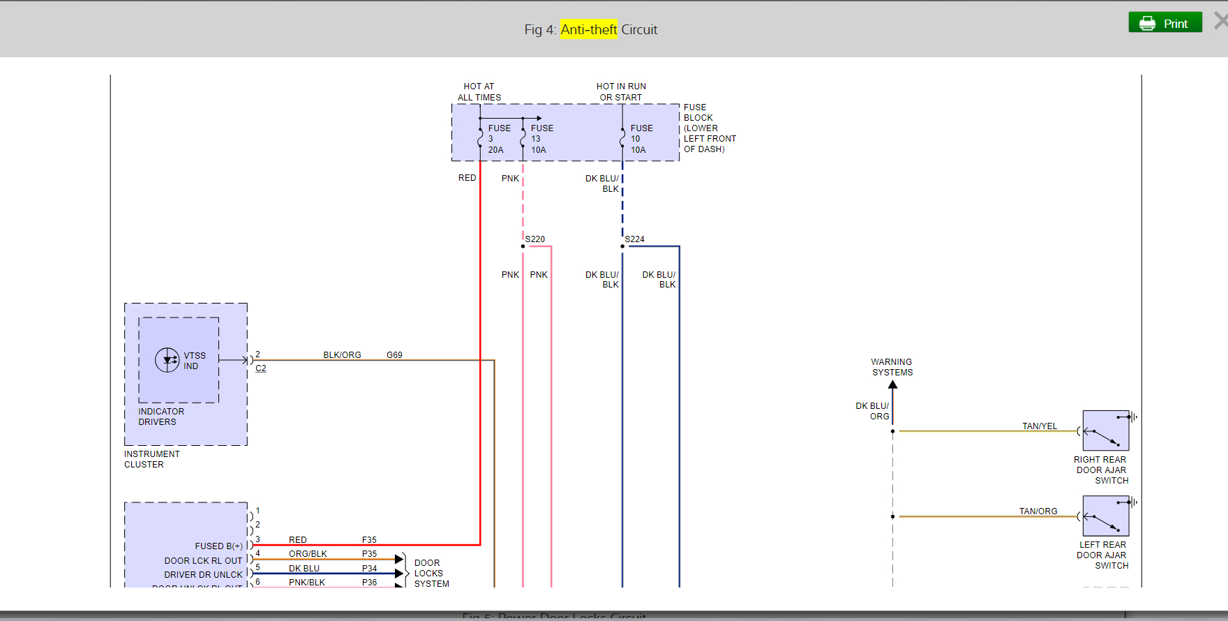

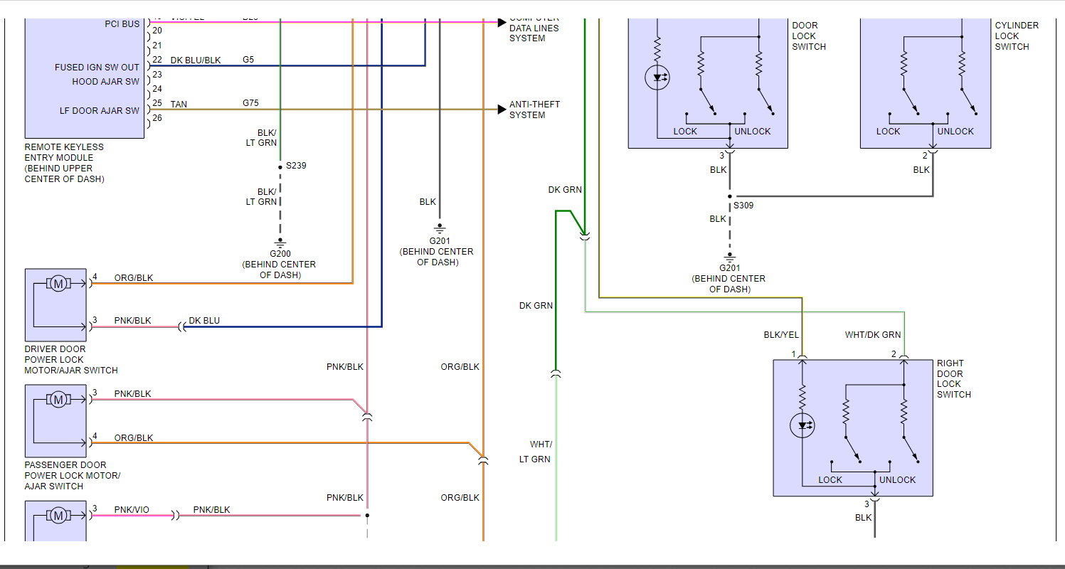

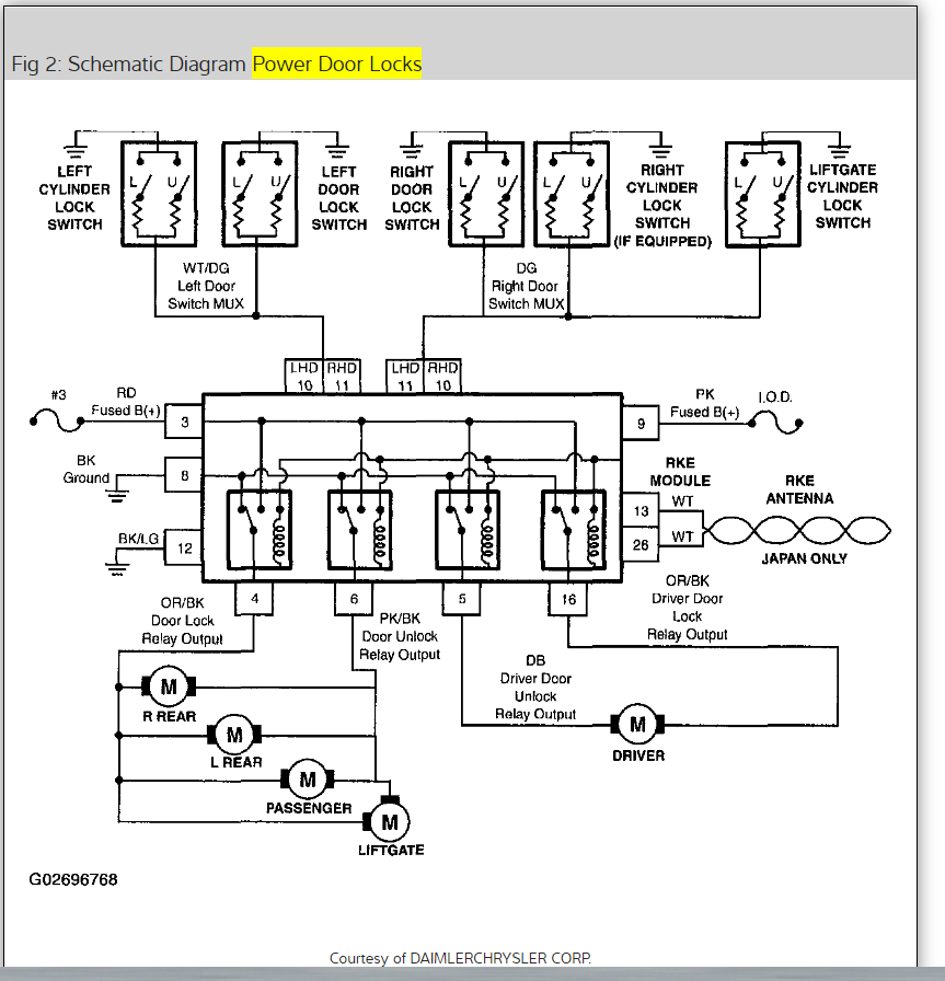

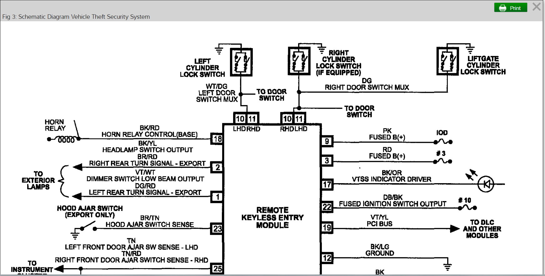

I need the location of the automatic door lock fuse.
Feb 28, 2019 at 2:50 PM
SCGRANTURISMO
  • 4,897 POSTS
I have included a list of fuse block diagrams, fuse block locations, schematics of door lock operation, and wiring diagrams for your vehicles door lock/anti theft system in the diagrams down below. I hope this helps.
Thanks,
Alex
