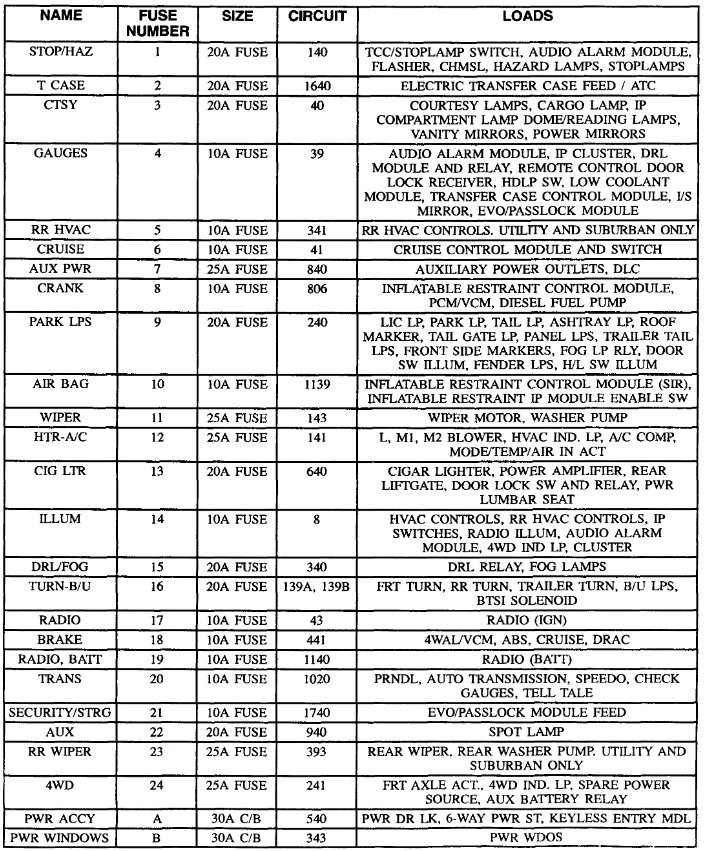

I'm trying to figure out the diagram for the fuse box above my driver's feet i can't find the cove.

See attached for the fuse diagram with the fuse list.
Let me know of any questions.

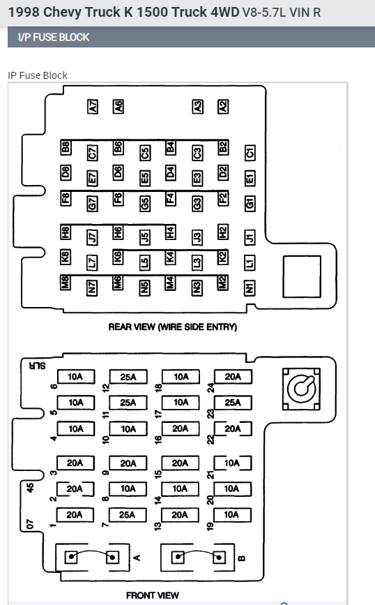

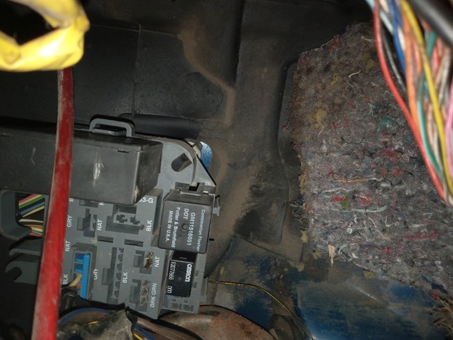

I have 3 fuse boxes one underneath the hood one in the door and one above the driver's feet I'm trying to figure out the one that is above the driver's feet and how important it is.

Every fuse or relay panel is critical and controls different functions.
Can you tell me what you are trying to diagnose?
