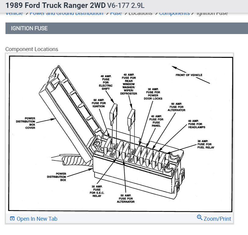

I am trying to locate the fuse box under the hood to see if a fuse is what's keeping my truck from starting.
Jul 2, 2022 at 10:36 AM
Experienced Mechanic
55,732 POSTS

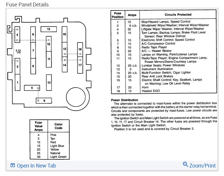

Sure, here is a guide to help you test the fuses and the fuse panel location under the dash and identification:
