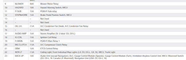

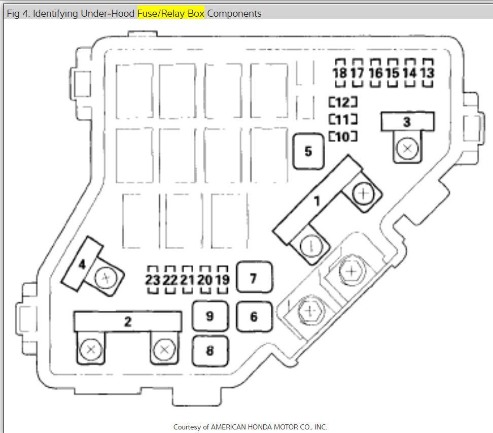

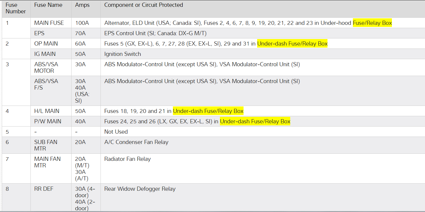

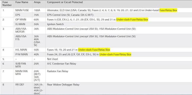

I have no power to some of my fuse panel.
Apr 28, 2018 at 7:04 AM
Experienced Mechanic
55,688 POSTS
This is because you have a fusible link that is out which powers part of the fuse panel Here is a diagram to help you see what to check:
