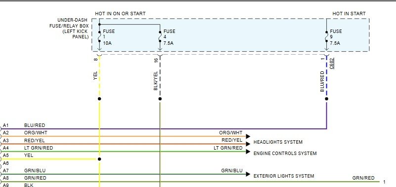

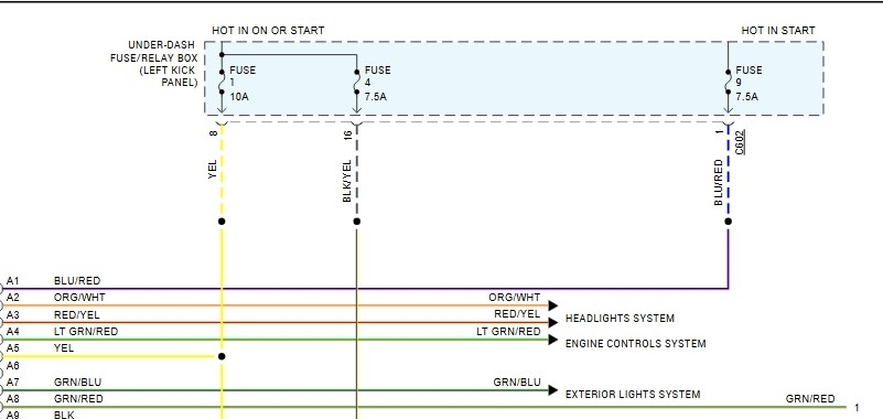

Okay, I suspect it may be a result of some poor wiring that was used to install the aftermarket radio, however the first thing will be to check the fuses, 1, 4 and 9 all provide power to the dash assembly. Fuse 32 in the under hood box is also involved. The issue there is that most also provide power to other systems that seem to be working. For the DLC and lighter sockets I would check fuse 36 in the under hood box. The only real item that shares anything between them is the radio, it gets some power and lighting from each side that is having a problem. I would suggest removing the radio and checking the wiring and how it was done, I have seen pretty much everything from an OE level install to ones where they used a bare metal crimp without any insulation, with a lot in between.
