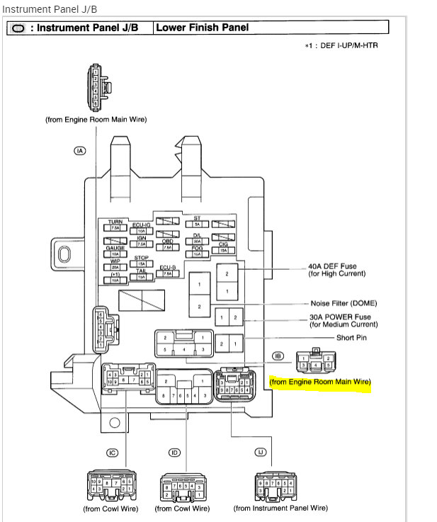

My fuses inside the car donesn't read with a circuit tester but the outside fuses in the box can be read and light up. How do I fix this issue? Thanks!

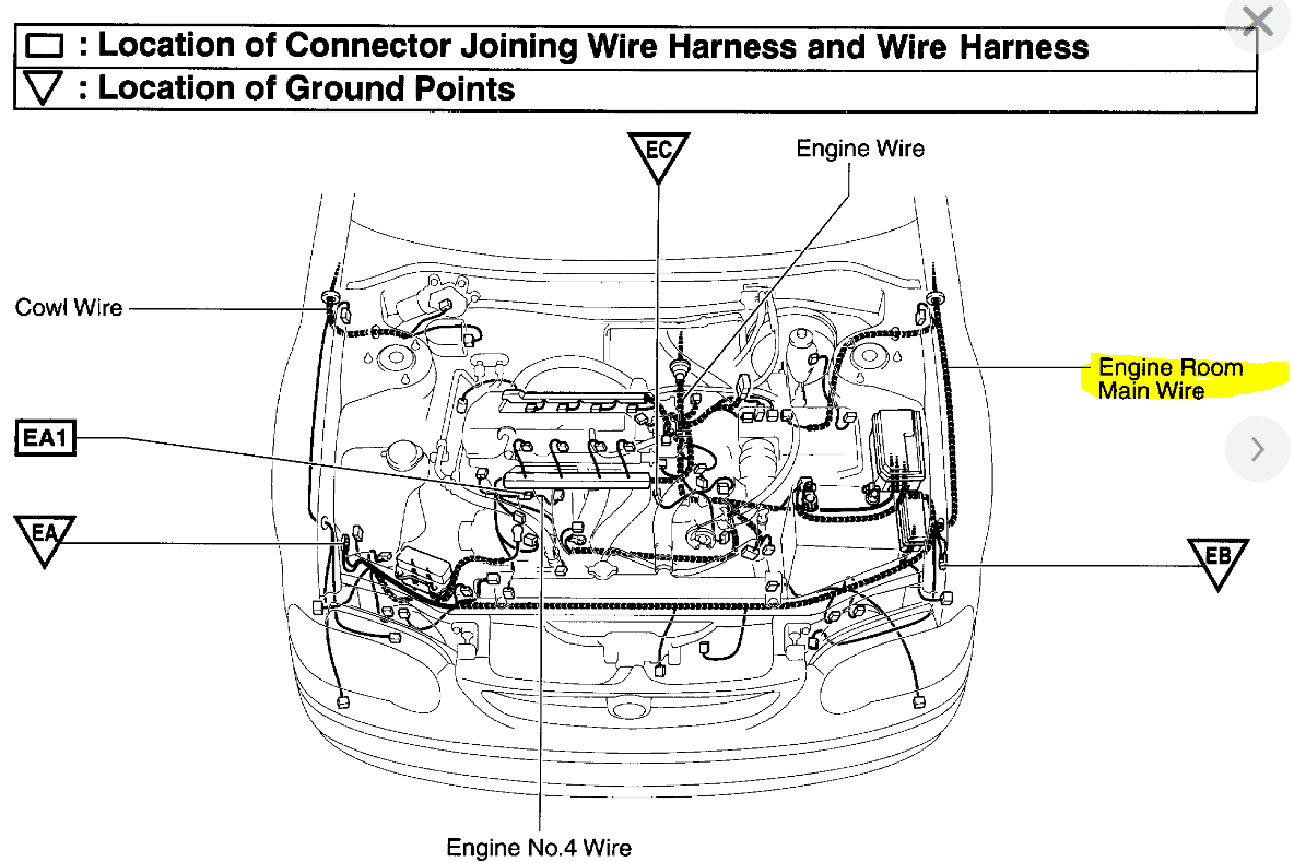

One thing to keep in mind, if you are unable to find a good ground, you won't be able to test the fuses. Try a different spot for ground or maybe the same spot that you used to test the under-hood fuses.

Have you pulled out the fuses to see if they are blown?
Also not being able to shift out of park could be due to a faulty shift interlock solenoid, which removes the lock when the brake pedal gets depressed. Also could be due to not getting power to the solenoid due to bad fuse.
May 13, 2022 at 8:00 AM
CARDUMMY93
I have, they aren't blown. All of them in the inside fuse box can't be read but they're not blown, is there a fuse that brings power to the inside fuse box?
Or a main fuse that powers the fuses inside.

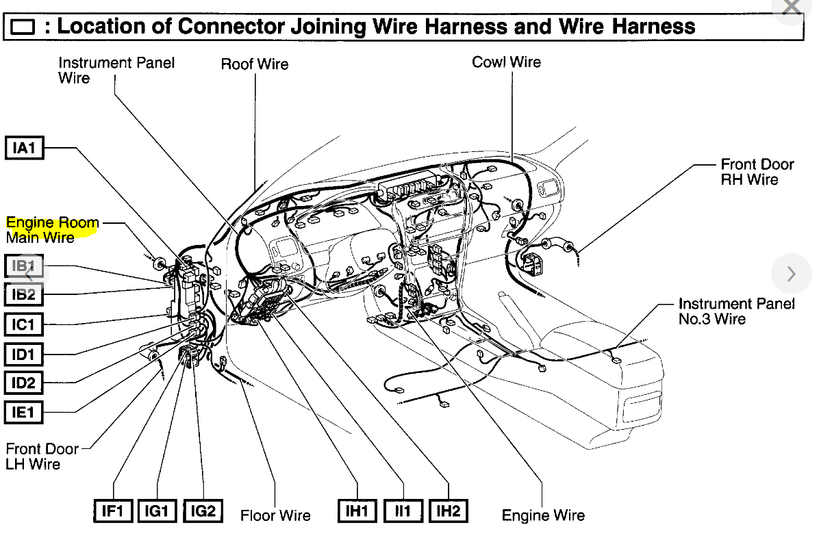

It is possible to have a short in the main harness for the fuse box.
Check for continuity on the harness for the fuse box. Take a look at the diagrams below for the harness location.
