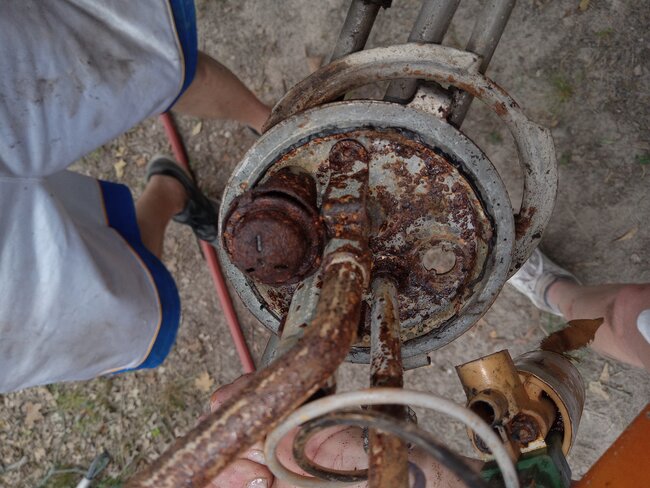

So pretty sure this was the problem..
Jun 22, 2023 at 5:31 AM
VANMANG20
  • 7 POSTS
Sending unit and pump/filter fell apart as I was pulling it out. Now that it's out, any ideas on how to clean the tank out? The van sat for years. It's pretty nasty in there.

Good find, yep cleaning the tank can be a challenge. I would use new gas and clean shop towels and mop up the mess while rolling the tank around to try and get as much out as possible. If it cannot be completed successfully a new tank is in order.

Cleaned the Tank out like you said. Worked like a charm. Obviously the fuel pump is trash as it disintegrated as I pulled it out of the tank, but the sending unit looks okay....any thoughts on keeping the sending unit and buy new pump?
Jun 25, 2023 at 12:50 AM
  • 55,399 POSTS
I would send a new sending unit; they can go bad internally with rust and since you are there might as well. Let me know how it goes.
