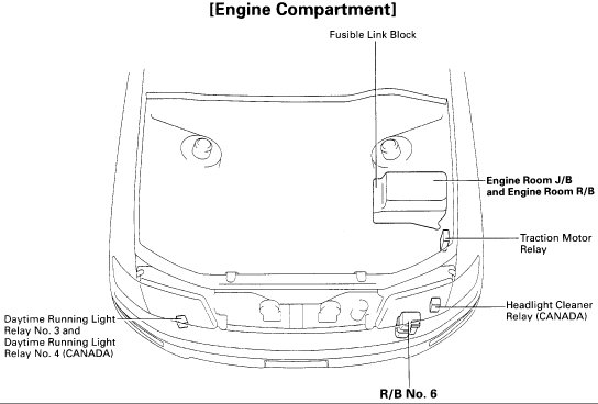

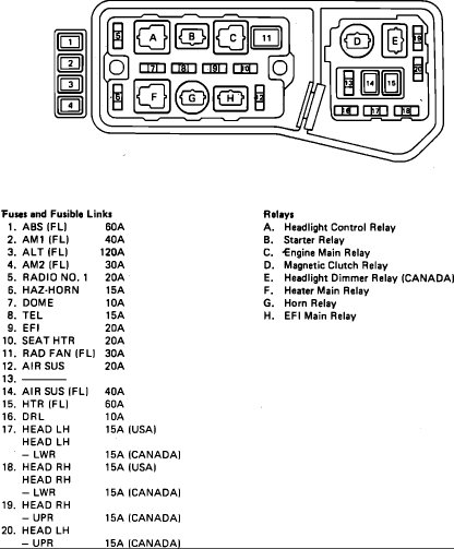

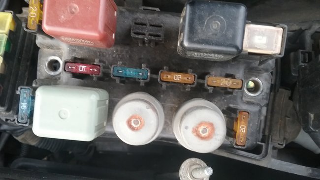

I believe there is a short in my fuse box. I have power to the starter from the big wire but none from the little wire. I have tested the fuse box and when I turn my car to the start position my test light does not lite up.

First, I am not 100% sure I know where you are checking for power. Chances are there is a problem with the relay or the starter solenoid itself. On the starter, the big wire goes directly to the battery, so it will be hot all the time. The smaller wire should get 12 volts only when the key is in the start position. Test that first. If there is power present at the solenoid and the starter does not engage, the starter is most likely bad.
Next, the starter relay should be tested. The first two pictures are of its location and the third pic is testing the relay.
Here are the directions for testing:
Using an ohmmeter, check for continuity between terminals 1 and 3, Fig 5.
Ensure there is no continuity between terminals 2 and 4.
If either test fails, replace relay.

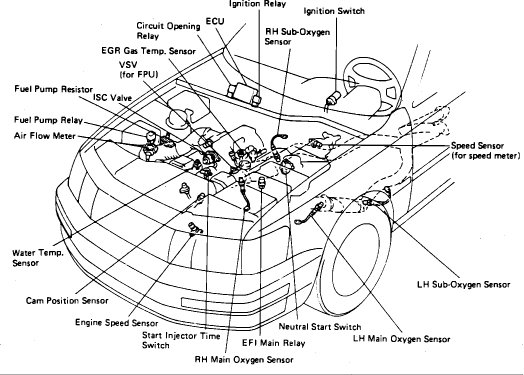

Another item that can cause this type of issue is the neutral safety switch. If that is the case, often times the vehicle will start in neutral but not park, so try that. If you find the switch is an issue, it is adjustable. Pics 5 and 6 relate to location and adjustment.
Here are adjustment directions.
If the vehicle starts at any position other then N or P range, loosen neutral start switch attaching bolt and position shift lever in N range.
Align groove and neutral basic line, Fig. 10 then torque switch attaching bolt to 9 ft. lbs.
