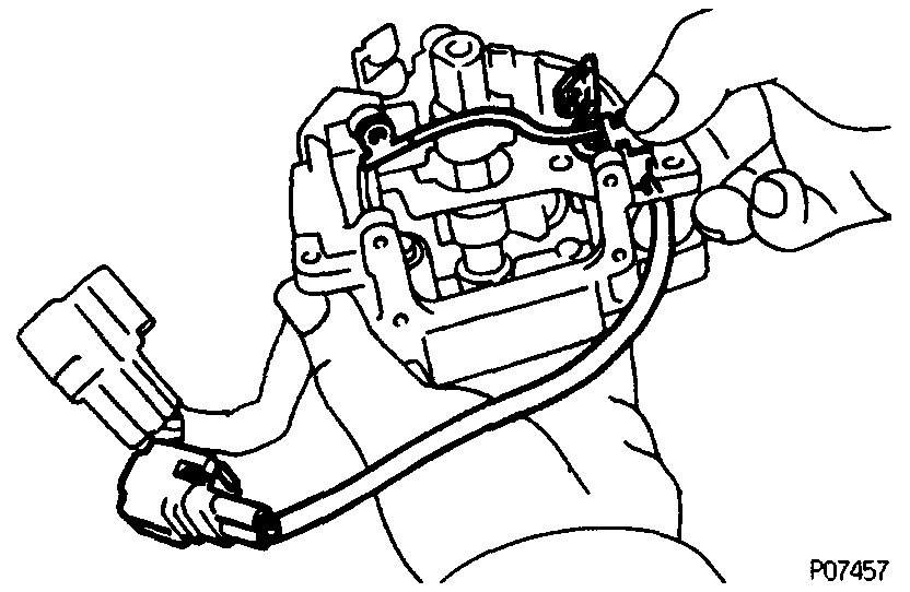

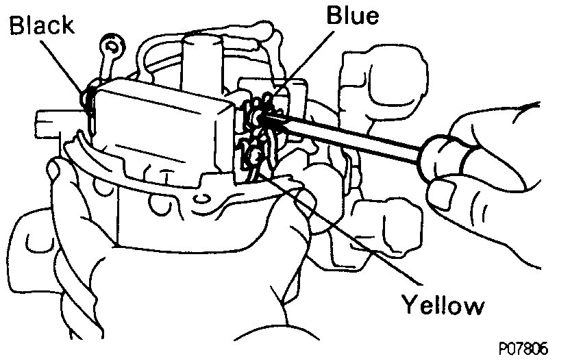

Hello. My car does not want to start, the starter motor does not turn, the battery charge indicator on the dashboard does not turn on when putting contact, everything else works (lights, horn, radio, rocker). Checking the fuse box of AM2 (15A) is burned. An amateur electricity friend suggested removing the condenser from the distributor (his insulator was blown), after removing it, the car started without problems. Should I check a short-circuited cable in the distributor?

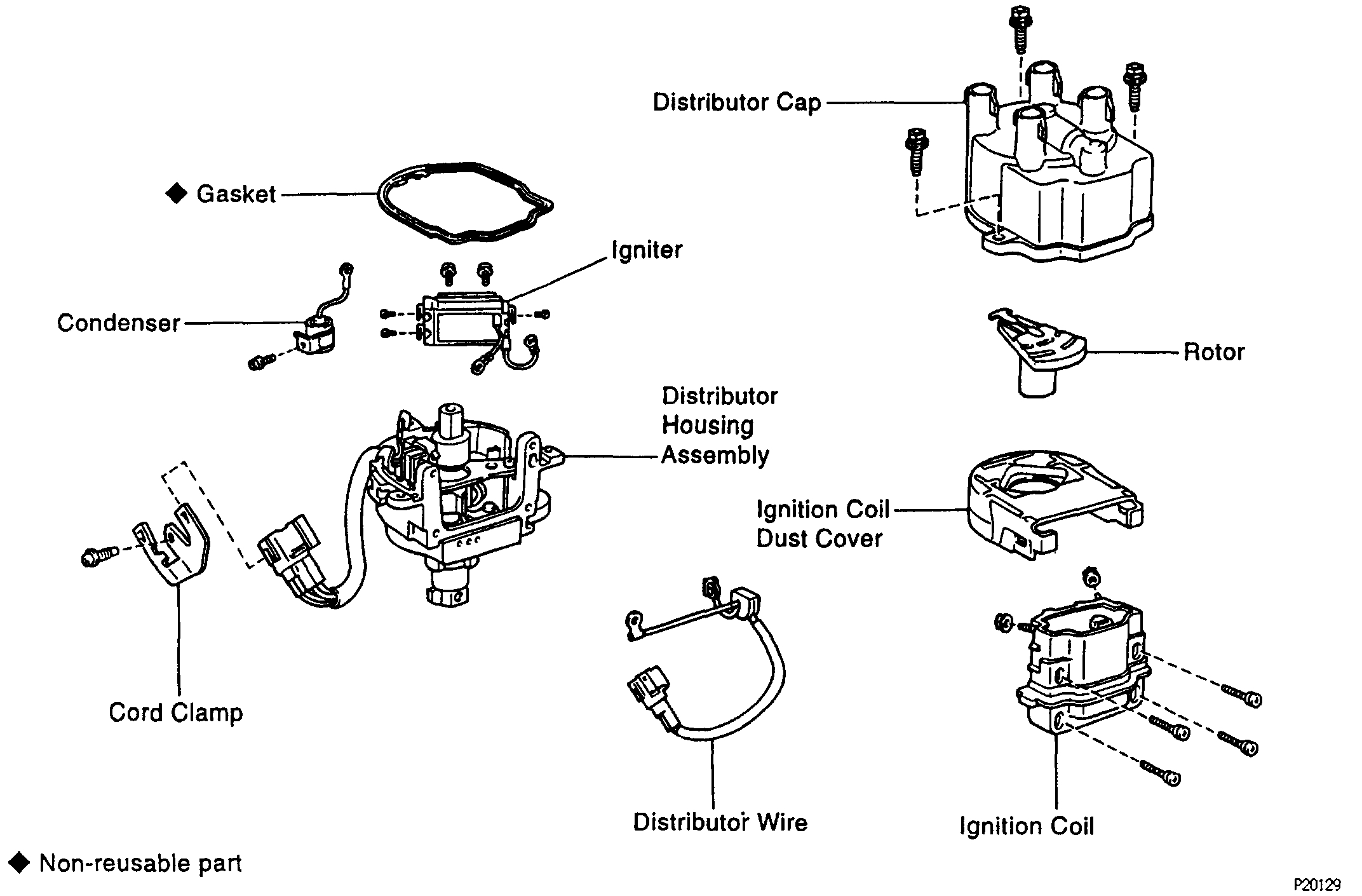

The condenser in the distributor is a sponge for electricity. You need to have that in the distributor. Have you replaced it?
Here are directions for taking the distributor apart. What I suggest is to replace the condenser if you haven't, and make sure none of the wires are shorted in it. Often times, a wire will break internally from constant movement. Take a look through these directions and confirm everything looks good.

DISASSEMBLY AND ASSEMBLY
see pic 1
DISTRIBUTOR DISASSEMBLY
1. REMOVE DISTRIBUTOR CAP.
- Remove the 3 bolts and distributor cap.
2. REMOVE ROTOR.
3. REMOVE IGNITION COIL DUST COVER.
- Remove the dust cover.
- Remove the gasket.

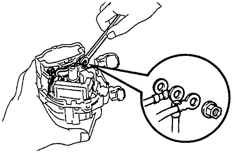

4. REMOVE IGNITION COIL.
See picture 2
- Remove the 2 nuts, and disconnect the 4 wires from the ignition coil terminals.

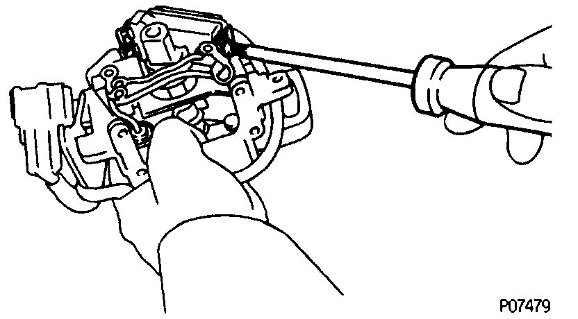

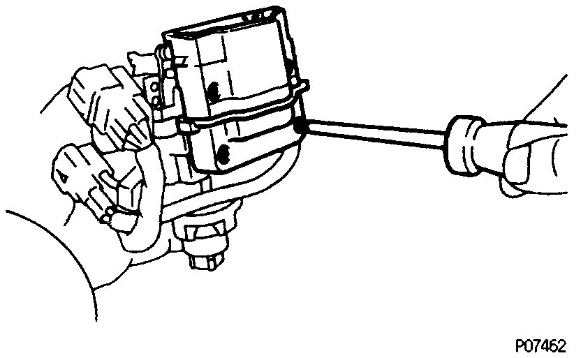

See picture 3
- Remove the 4 screws and ignition coil.

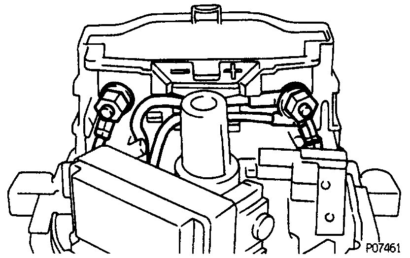

5. REMOVE IGNITER.
see pic 4
- Remove the 3 screws, and disconnect the 3 wires from the igniter terminals.

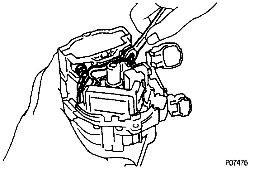

See picture 5
- Remove the 2 screws and igniter.

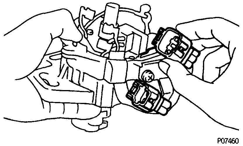

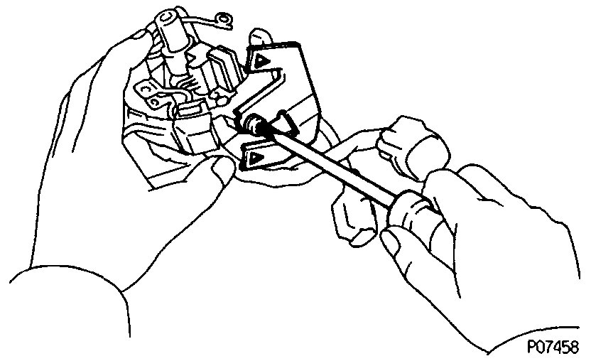

6. REMOVE CORD CLAMP AND DISTRIBUTOR WIRE.
See picture 6
- Disconnect the 2 connectors from the cord clamp.
See picture 7
- Remove the screw and cord clamp.
See picture 8
- Remove the distributor wire from the distributor housing.

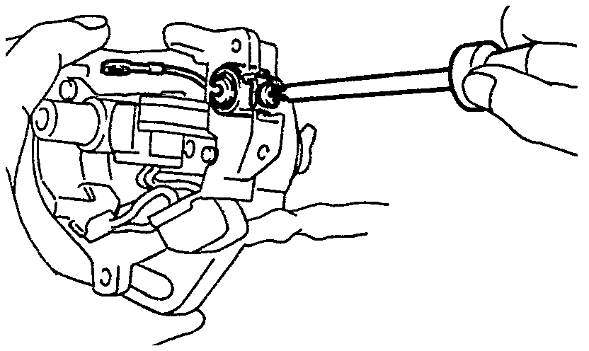

7. REMOVE CONDENSER.
See picture 9
- Remove the screw and condenser.

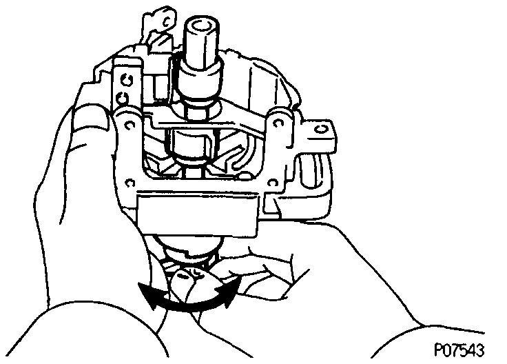

DISTRIBUTOR INSPECTION
1. INSPECT SHAFT.
See picture 10
- Turn the shaft and check that it is not rough or worn.
- If it feels rough or worn, replace the distributor during assembly.

2. INSTALL DISTRIBUTOR WIRE AND CORD CLAMP
- Install the grommet of the wire to the distributor housing.
- Install the cord clamp with the screw.
- Install the 2 connectors to the cord clamp.

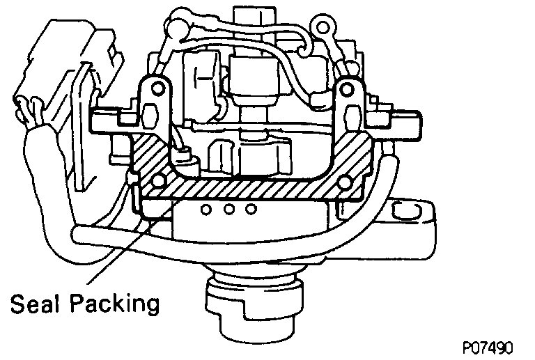

4. INSTALL IGNITION COIL.
- Remove any old packing (FIPG) material.
See picture 12
- Apply seal packing to the ignition coil installing surface of the housing as shown in the illustration.
- Seal packing: Part No. 08826-00080 or equivalent

- Connect the 4 wires to the ignition coil terminals with the 2 nuts as shown in the illustration.
See picture 14
NOTICE:
- When connecting the wires to the ignition coil, insert both properly into their grooves found on the side of the ignition coil.
- Be sure the wires do not contact with signal rotor or distributor housing.

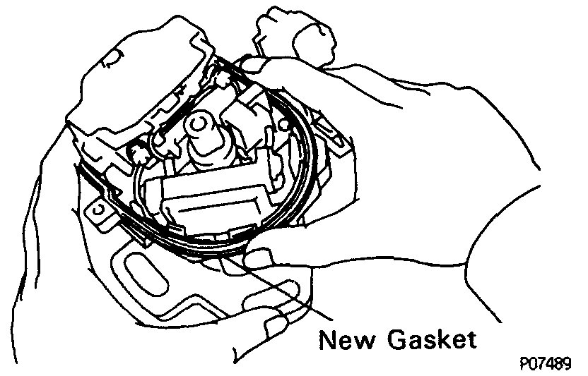

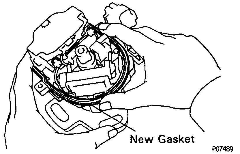

5. INSTALL IGNITION COIL DUST COVER.
See picture 15
- Install a new gasket to the distributor housing.
- Install the dust cover.

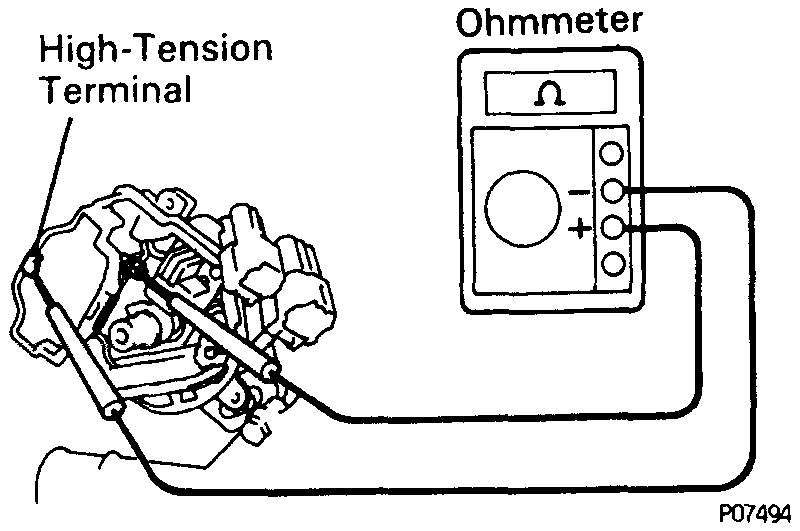

I placed another condenser, lasted approximately three days driving well, until again the same failure occurred. Apparently there is a cable shorted. How to test the conditions of a capacitor? I tried it in the following way: a good capacitor has no conductivity between the central cable and the frame of the latter; but the damaged one if there was conductivity.
Jan 13, 2019 at 7:27 AM
  • 110,244 POSTS
Welcome back.
What you described is a good way to determine if the condenser is bad. However, it doesn't tell us why. I have a feeling the igniter / coil is causing the problem. Take a look through this test and let me know the results.

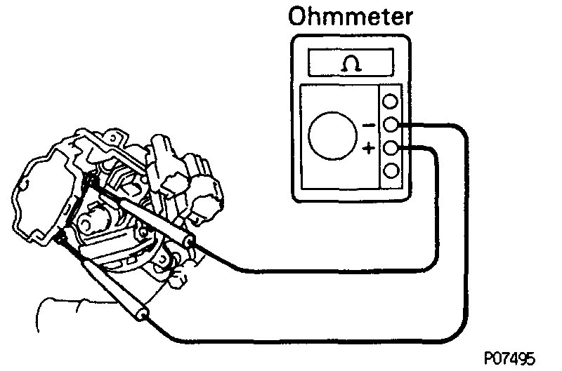

5. INSPECT PRIMARY COIL RESISTANCE.
Picture 1
- Using an ohmmeter, measure the resistance between the positive (+) and negative (-) terminals.
Primary coil resistance (Cold): 1.11 - 1.75 Ohms
Primary coil resistance (Hot): 1.41 - 2.05 Ohms
- If the resistance is not as specified, replace the ignition coil.
6. INSPECT SECONDARY COIL RESISTANCE.
Picture 2
- Using an ohmmeter, measure the resistance between the positive (+) and high-tension terminals.
Secondary coil resistance (Cold): 9.0 - 16.7 k Ohms
Secondary coil resistance (Hot): 11.4 - 18.4 kOhms

This are my results:
Primary coil resistance (Cold): 1.7 Ohm
Primary coil resistance (Hot): 2.05 Ohm
Secondary coil resistance (Cold): 13.33 kOhm
Secondary coil resistance (Hot):14.71 kOhm
Jan 14, 2019 at 9:35 PM
  • 110,244 POSTS
That's right where it should be. The only think I can think of is a short in one of the wires. Or you got a bad condenser. Have you replaced it again?
