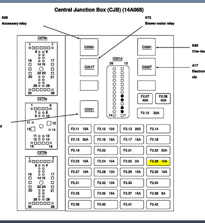

Exterior door mirror light fuse location
2002 FORD TAURUS
145,000 MILES • V8 • 2WD • AUTOMATIC
WESBURCH
which fuse is for the dome light and exterior door mirror light?
Apr 28, 2020 at 2:04 PM
  • 110,194 POSTS

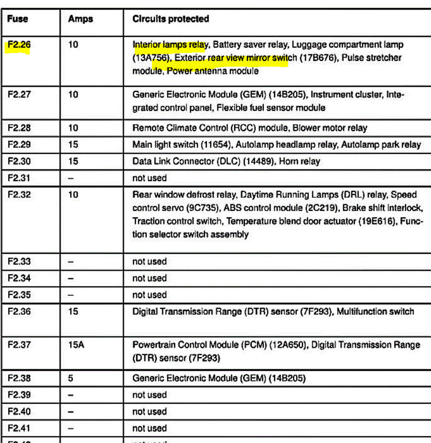

The fuse is located in the central junction box fuse panel. The fuse panel is located below and to the left of the steering wheel by the brake pedal.
I attached two pictures below. The first indicates fuse 2.26 is the one you are looking for. The second shows its location in the fuse box.
