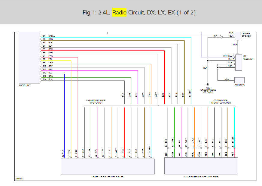

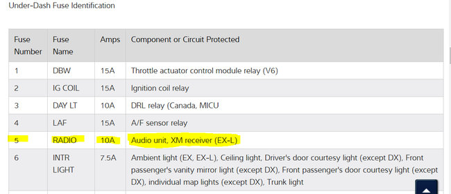

Hi, my CD changer doesn't work. it seems like it's not getting any power. I tried disconnecting battery, replacing fuse to the radio and it still isn't working. so I was wondering if there's another fuse that just controls CD changer? it's a 6 disc CD changer that is located in the dash of the car. any help would be appreciated. thank you

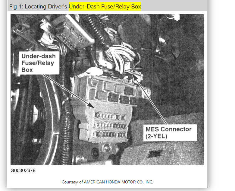

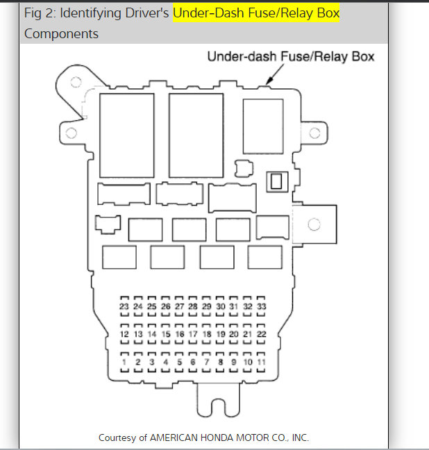

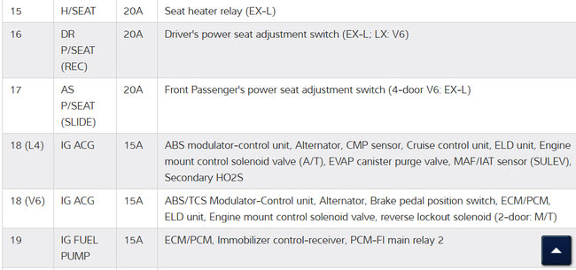

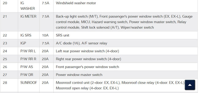

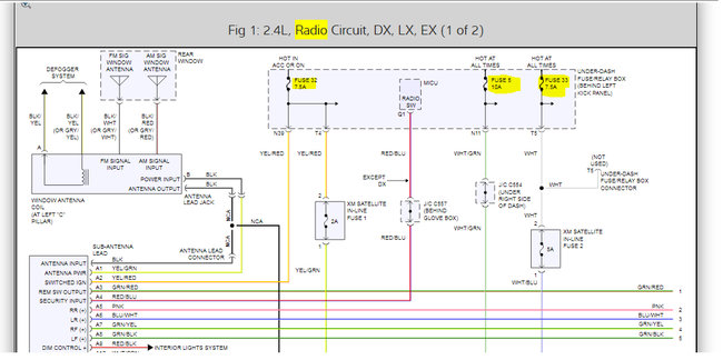

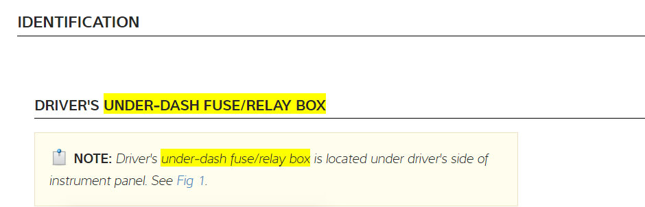

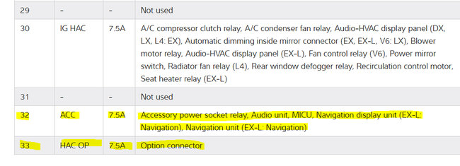

There are 3 fuses that are used in your vehicle's audio system. They are all located in the Under dash Fuse Panel. They are fuse #5,32, and 33. I have included in the diagrams down below a wiring diagram of your vehicle's radio CD/changer unit, and a diagram and callout of the Under dash Fuse Panel. Please go through this guide and get back to us with what you are able to find out.
