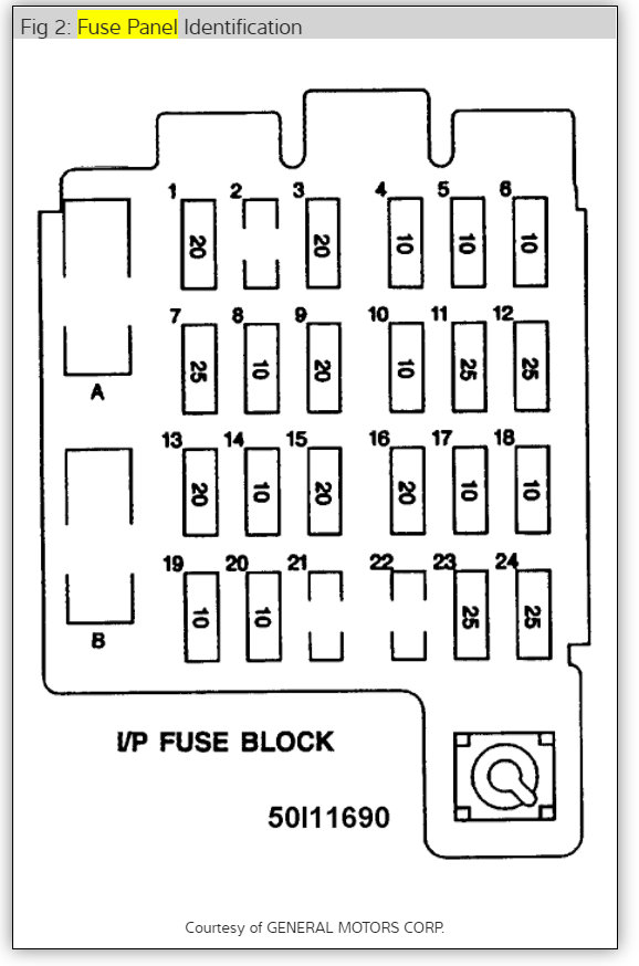

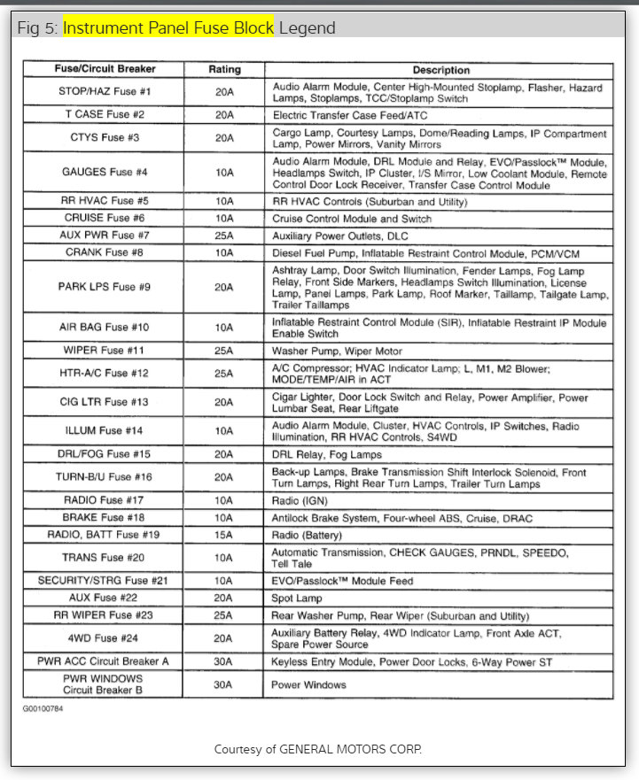

What is the #7 aux/pwr fuse for?
Nov 23, 2017 at 4:25 PM
  • 54,832 POSTS
The #7 fuse is used for the AUX ports which is the cigarette lighter in the back someone probably put a penny or dime in there (it happens)
Here is a guide and some diagrams to help you. (below)
