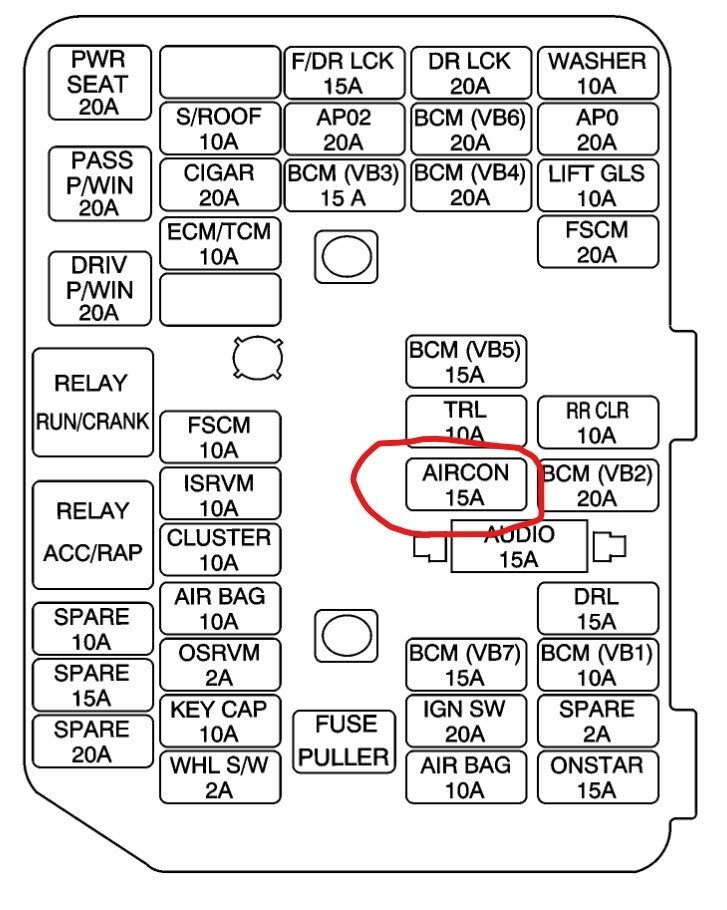

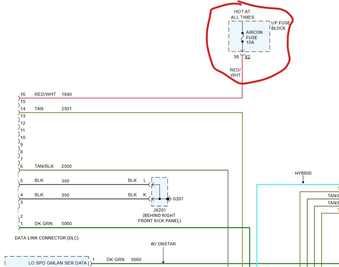

I have no power to my OBD2 port? My Cig and Apo 1,2 Fuses are okay. Is there another fuse that operates the OBD2 port?

The OBD II fuse is also the 15-amp aircon fuse.
