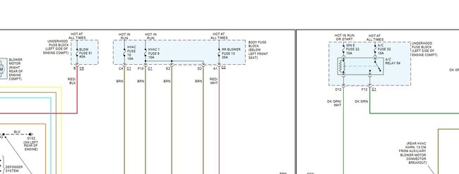

Which fuse controls the HVAC?
2003 CHEVROLET EXPRESS
186,000 MILES • 4.3L • 6 CYL • 2WD • AUTOMATIC
JACOB1989
Which fuse controls the hvac?
Dec 24, 2024 at 8:32 AM
STEVE W.
  • 15,345 POSTS

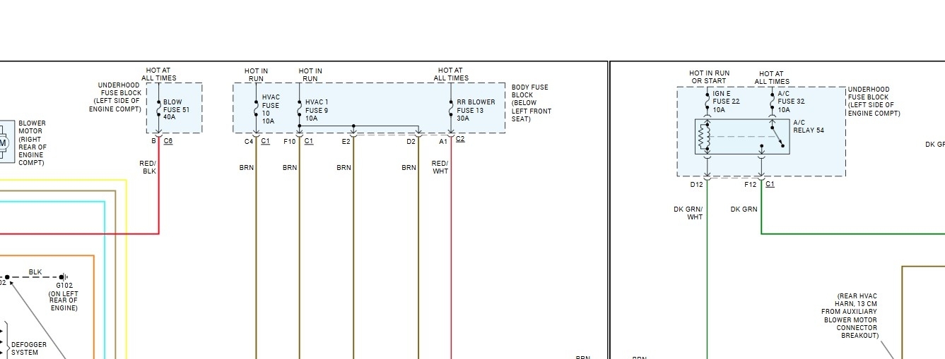

There are 6 fuses in the HVAC system. Each operates a different part of the system. In the fuse block under the hood are 3 of them, the blower motor fuse #51 the AC fuse #32 and Ignition E fuse #22. Then you have the 3 fuses in the fuse box under the left seat. HVAC fuse #10, HVAC fuse #9 and blower fuse #13. To see if a fuse is the problem grab a cheap test light and test them with the key on. What is the problem you have?
