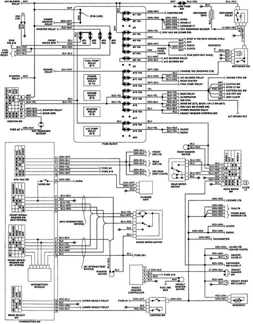

Fuse 7 intermittently blows, all zones ok?
ROYENGLE
  • 1994 ISUZU RODEO
  • 3.0L
  • V6
  • 4WD
  • 180,000 MILES
Start/Run Ignition Switch ok. Zones connected to fuse 7 (dashboard) works. While driving fuse 7 intermittently blows for no reason. Test Hazard Lights work ok. Test Heater blower relay ok. Swapped Start Relay ok. Dash gages all works ok. Check Engine lights ok. Replaced Alternator, gets 12.5 volts ok. Power goes to 5A at ECM, but where does it come out? Replace with new fuse 10/15 A, sometimes immediately blows, sometimes not. 8 Amps tested at fuse. I then connected a test light across blown fuse 7 and it resets circuit so new fuse doesn't blow it. I give up?

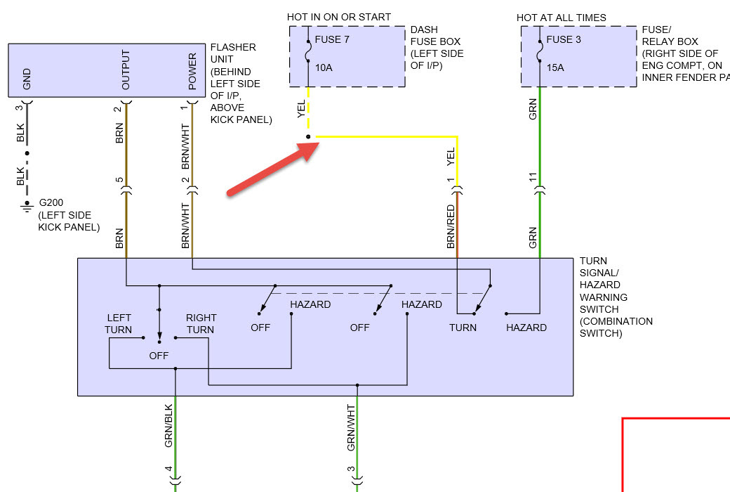

ROYENGLE
  • 9 POSTS
Wire schematic saysTurn Signal Flasher Unit's Brn/Wht wire gets power from Turn Signal Brn/Red wire to fuse 7 OR Hazard switch Grn wire to fuse 3. Therefore, when fuse 7 blows, no power to Turn signals, but if Hazard switch works Turn Signals, then there is NO fault in Turn Signal circuit, but the Brn/Red wire could be at fault.

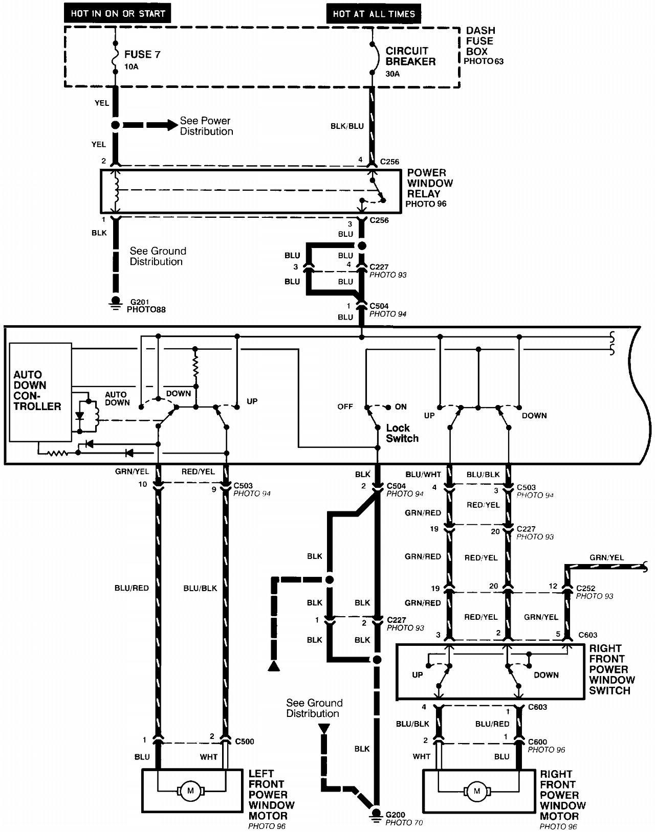

ROYENGLE
  • 9 POSTS

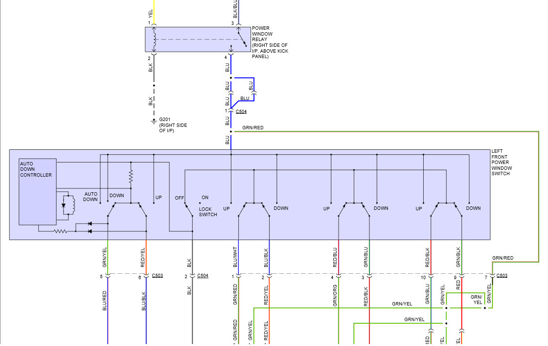

Also, the power window's master control console by the driver's side has two broken switches. This console is hard to find, and very expensive to replace. I cannot find the Power Window's circuit on the schematics, are they connected to fuse 7, as you said to check it?
Thursday, December 10th, 2015 AT 11:40 AM
ROYENGLE
  • 9 POSTS
Power window Relay schematic
Thursday, December 10th, 2015 AT 11:52 AM
ROYENGLE
  • 9 POSTS
Power windows schematic
Thursday, December 10th, 2015 AT 11:58 AM
ROYENGLE
  • 9 POSTS
I found the Power Window's Relay schematic, yes it is connected to Fuse 7.
Thursday, December 10th, 2015 AT 12:10 PM
HMAC300
  • 48,601 POSTS
Fuse 7 goes directly to power window relay via a yellow wire see pic. If you have two broken switches I would imagine that is the problem. Pull the relay out and drive it see if fuse blows. If not you probably found your problem. Just like I said in previous reply to check or disconnect areas fuse 7 was connected to one at a time to locate where the problem is. You might try junkyard dog. Com for a used part, enter your stuff then they will contact you by email if they have it and how much.
