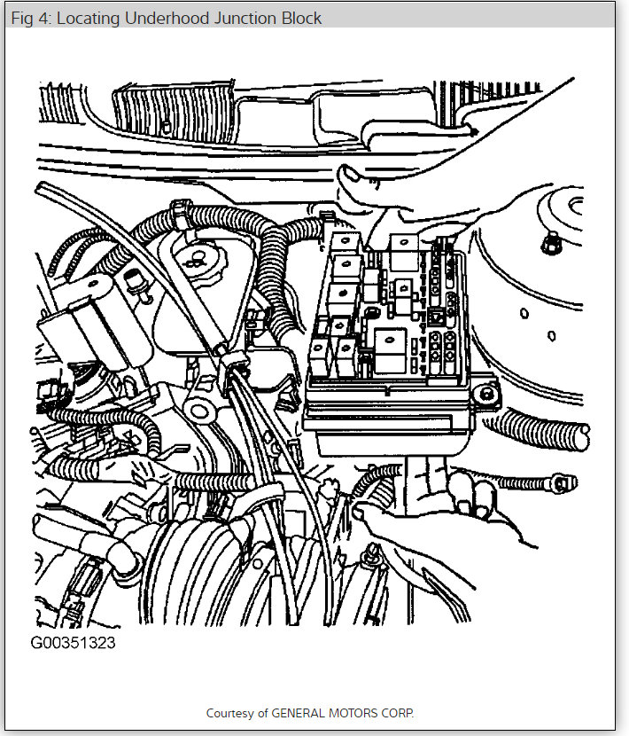

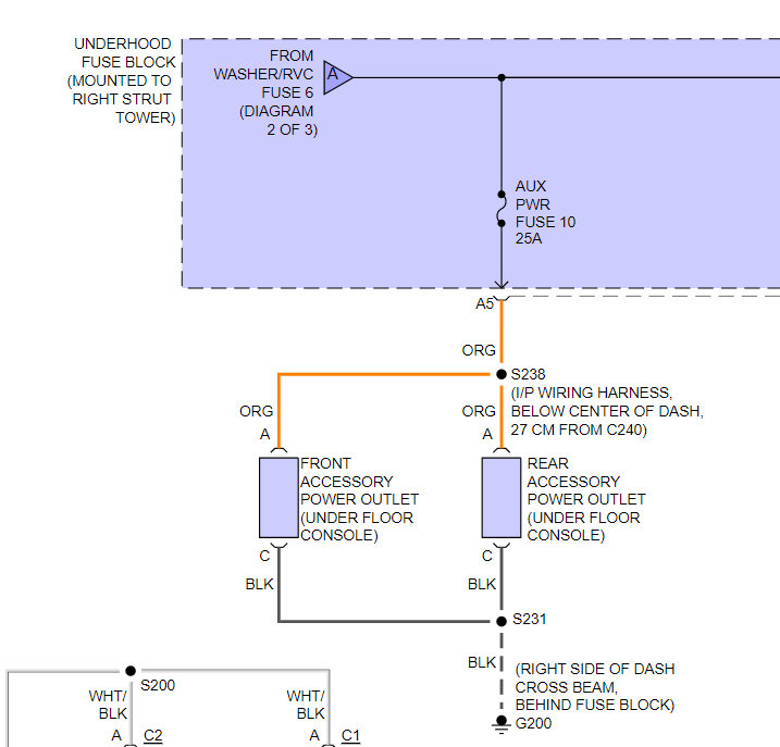

I can find the fuse for both cigarettes lighter?
Jun 24, 2022 at 5:25 PM
  • 55,433 POSTS

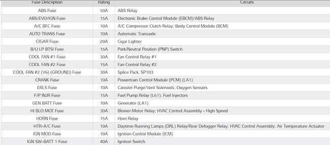

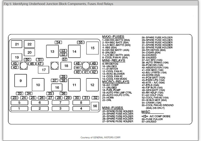

It is the AUX PWR fuse in the power distribution center under the hood. Here is a wiring diagram to show you how it works with a guide to help you test the fuse and the fuse locations as well:
