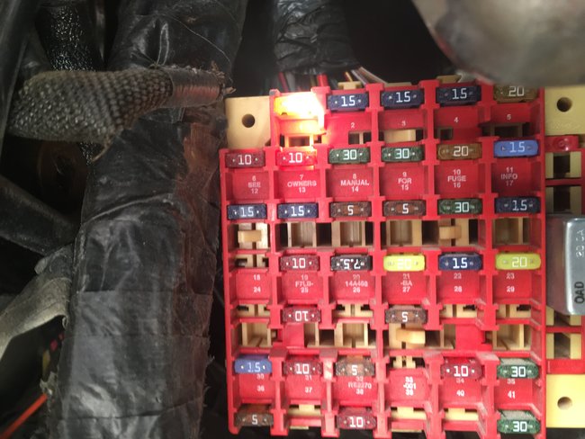

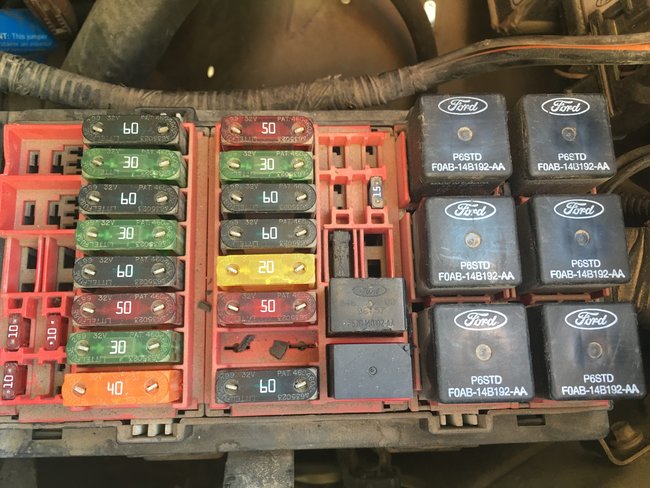

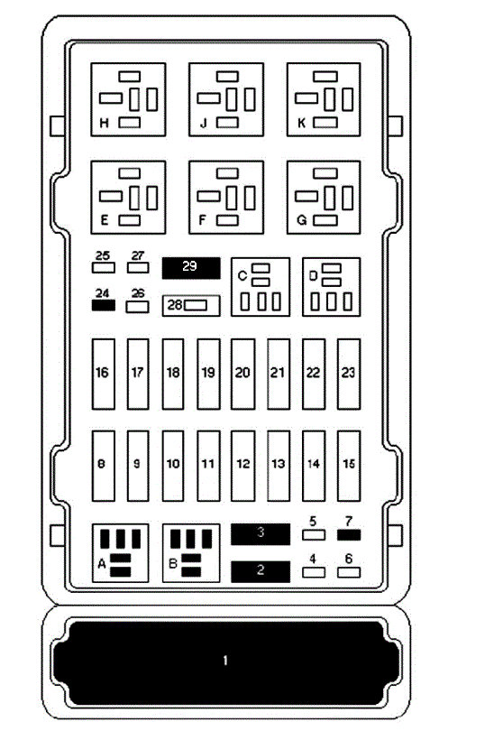

Under the hood are the relay switches with two fuses in the same box, one fuse controls the left running light and the other controls the right running lights.
The right fuse has no power to it. I do not know why.

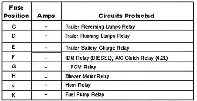

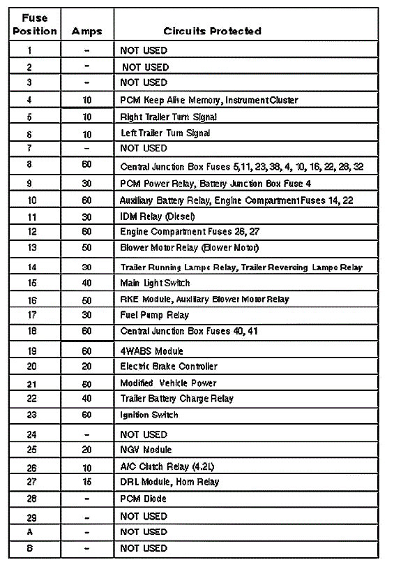

I'm looking in my manual and can't figure out which fuses you are referring to. I attached what I have below. Additionally, I attached the legend for the fuse box.
Take a look at it and let me know if that is what you have and if you can identify the fuses. Once I get that info, I can go to the power distribution schematics and see if there is a fuse upstream from the affected one that may have failed.
Also, just to confirm. Is this an E350 and does it have an aftermarket body or changes from the manufacturer's design?

Modification, yes, the van went from Ford to Quigley, Custom ordered, Ford only made one of this type of van. In my Schem it is 4 and 5, not 5 and 6, I am trying to send you a copy of my Schematic.
