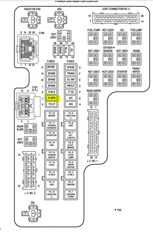

Rear wiper fuse location needed

Fuse location for rear wiper.

The rear wiper fuse is located under the hood in the power distribution box. If you look at the attached pic, I highlighted the fuse. Remember, when checking a fuse, first confirm the fuse is good and then determine if there is power to it and from it.
