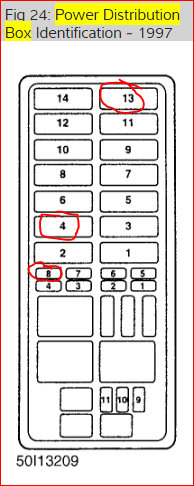

Where is the fuse for running lights?

It is located in the power distribution box (under hood). I have attached a picture and circled the fuses to check for the running lights. Number 4 and 13 are maxi fuses 30 and 60 Amp and number 8 is a mini fuse 15 Amp. Hope this helps and feel free to ask any further questions. Thanks for using 2CarPros.
