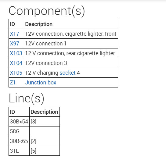

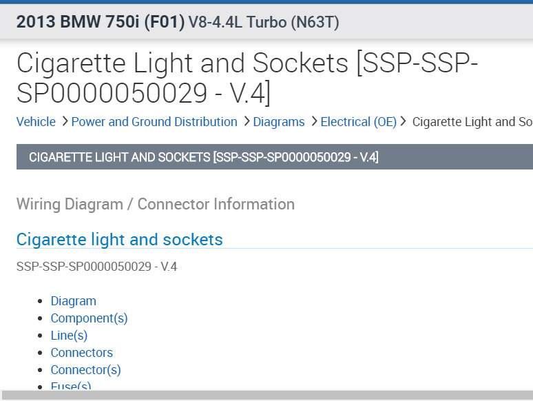

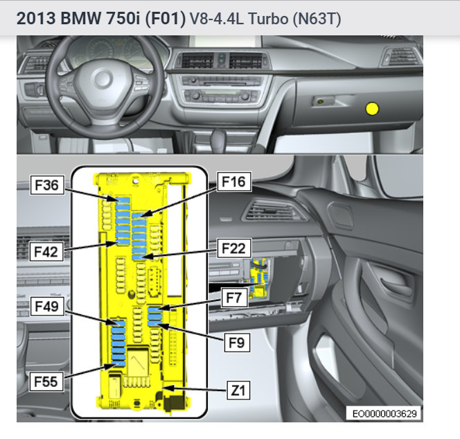

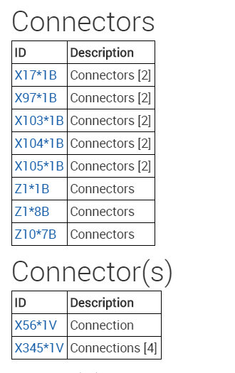

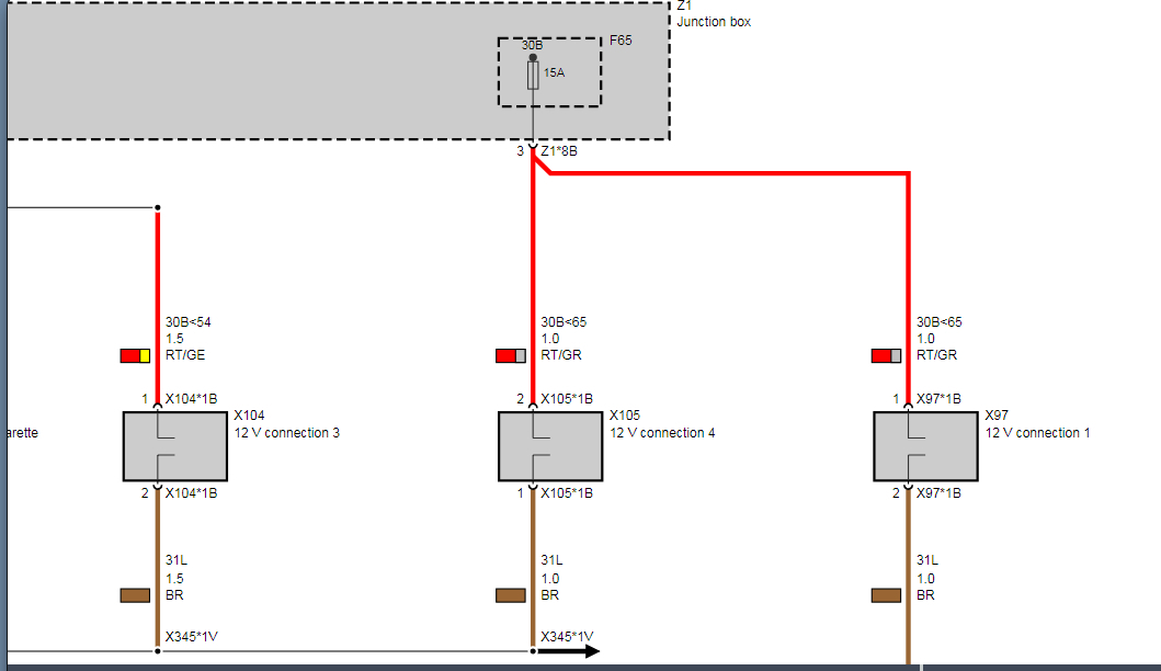

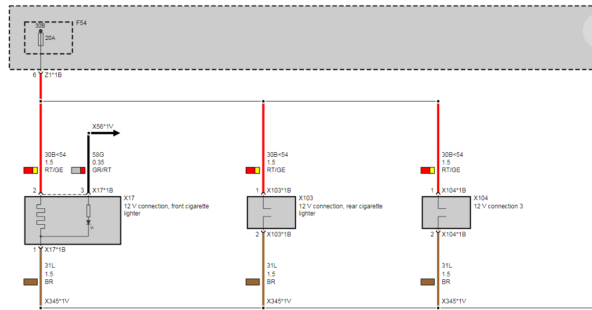

Where is the fuse location for the cigarette lighter and what amp is it?
Mar 31, 2019 at 3:00 PM
SCGRANTURISMO
  • CAR REPAIR CONTRIBUTOR
  • 4,897 POSTS
I have included the information that requested in the diagrams down below. Please let us know if there is anything else that we can help you with. We are always happy to help.
