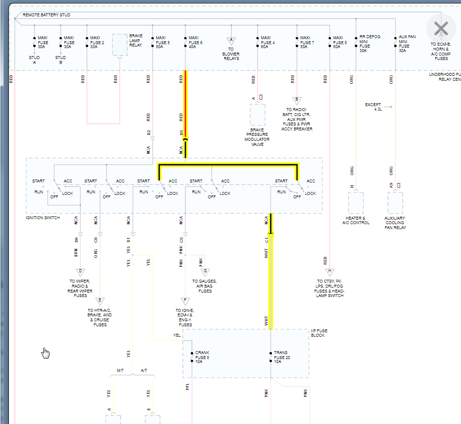

Could the ignition switch cause this? how would I know?
Oct 9, 2020 at 5:07 AM
  • 110,244 POSTS

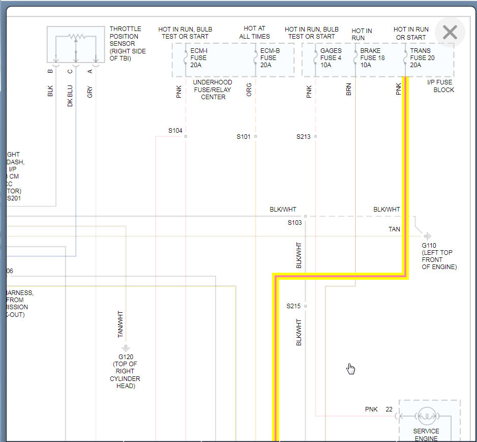

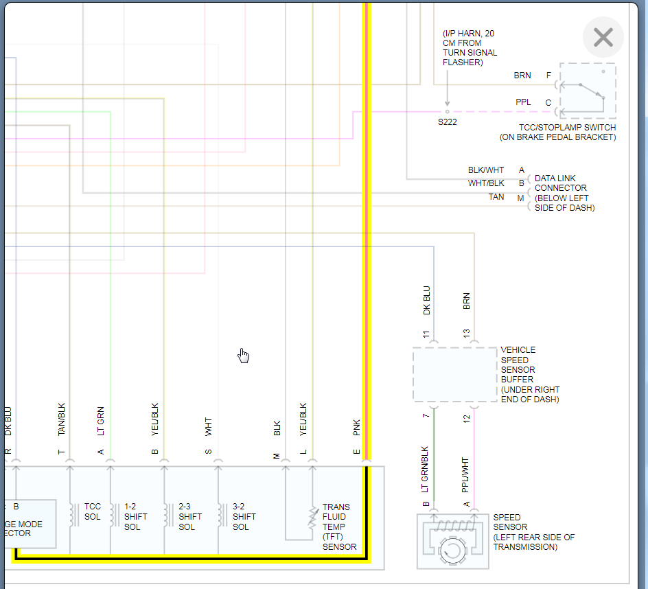

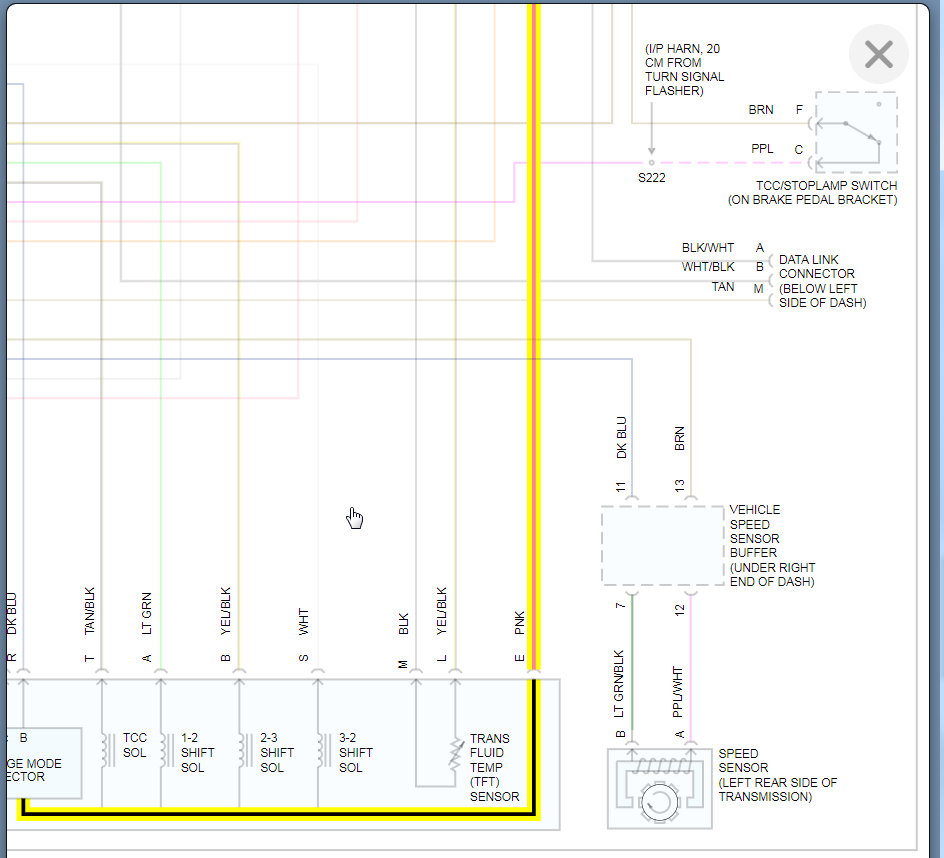

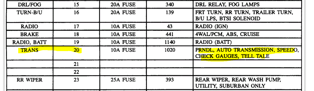

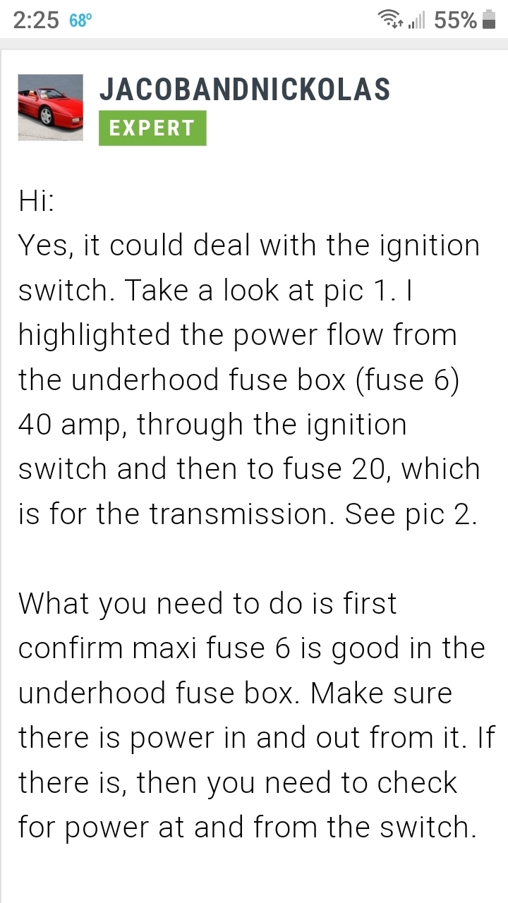

Yes, it could deal with the ignition switch. Take a look at pic 1. I highlighted the power flow from the under hood fuse box (fuse 6) 40 amp, through the ignition switch and then to fuse 20, which is for the transmission. See pic 2.
What you need to do is first confirm maxi fuse 6 is good in the under hood fuse box. Make sure there is power in and out from it. If there is, then you need to check for power at and from the switch.

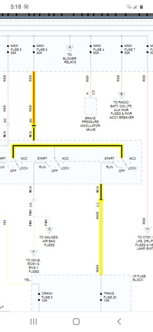

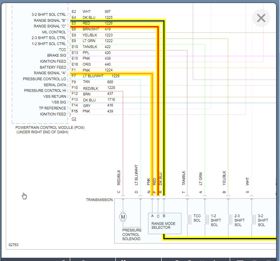

This fuse is for the range selector in the transmission. This means we have a short in the wiring most likely or the range selector switch.
We need to test the wiring that is highlighted for short to power or ground. I would do it in sections by going from the fuse to the transmission. Then from the selector to the PCM. I suspect the feed wire from the fuse to the transmission is the issue but clearly we need to check them to find it.
If you want to, you can just clip the wires and run jumpers until the fuse doesn't blow then make the wiring permanent.
Let's run through this and let me know what questions you have. Thanks

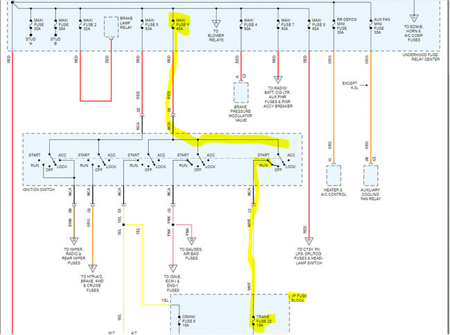

Okay. Maybe I misunderstood. When you say you have no power coming into the fuse, then Joe would be correct with what he told you. I read this as you had no power on that circuit and the lights would not work.
Do you have power on both sides of the fuse? Put your test light or meter on the little metal test locations of the fuse and make sure you have voltage on both sides.
The reason I did not take this as not having power "to the fuse", is because if that was the case, the ignition switch would not work if the Fuse 6 was blown and you didn't mention that. So I just assumed we had an issue on this circuit.
Here is the diagram for this Fuse 6 that we need to check and go from there. Thanks

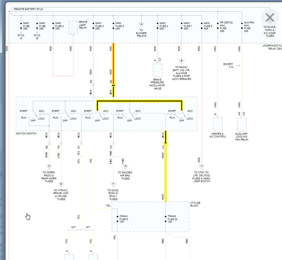

If you have power to the white wire, fuse 20 should have power unless there is an open in that wire. Where did you check it, at the switch or at the box?

Under the ignition switch red and white hot.
I'm getting no power to transmission fuse.
Oct 12, 2020 at 2:38 AM
  • 110,244 POSTS
If there is power at the white wire at the switch and nothing at the opposite end (fuse 20) the wire is either broken or damaged at some point. Have you checked continuity in that wire?
