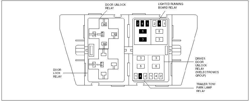

The fuse for the all doors relays keeps on blowing. That is fuse #18 in the fuse box next to the steering wheel. I have not done any work on my vehicle lately so I do not know why the door fuse keeps on blowing every time I use my alarm remote or the door buttons.
Feb 2, 2018 at 5:23 AM
PATENTED_REPAIR_PRO
  • 1,853 POSTS
remove all three of those door relays and see if the fuse stops blowing, they are the "drivers door unlock", "door lock" and "door unlock" relays. then if the fuse no longer blows, put them back in one at a time until you find out which one is blowing the fuse, then try a new relay for that one.
Those relays are in the auxiliary relay box #2 shown below. That auxiliary relay box #2 should be located under the hood.

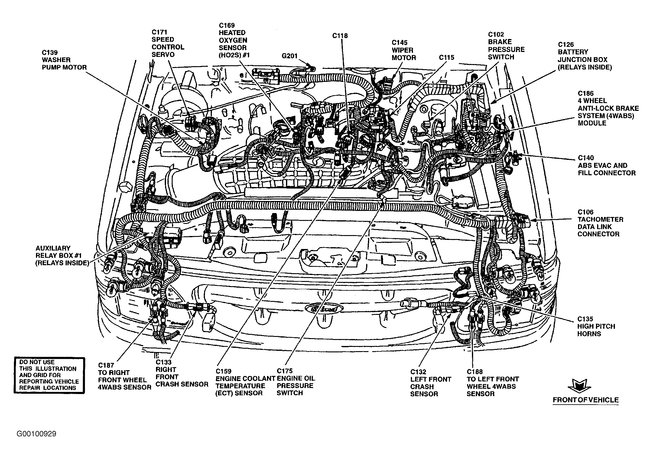

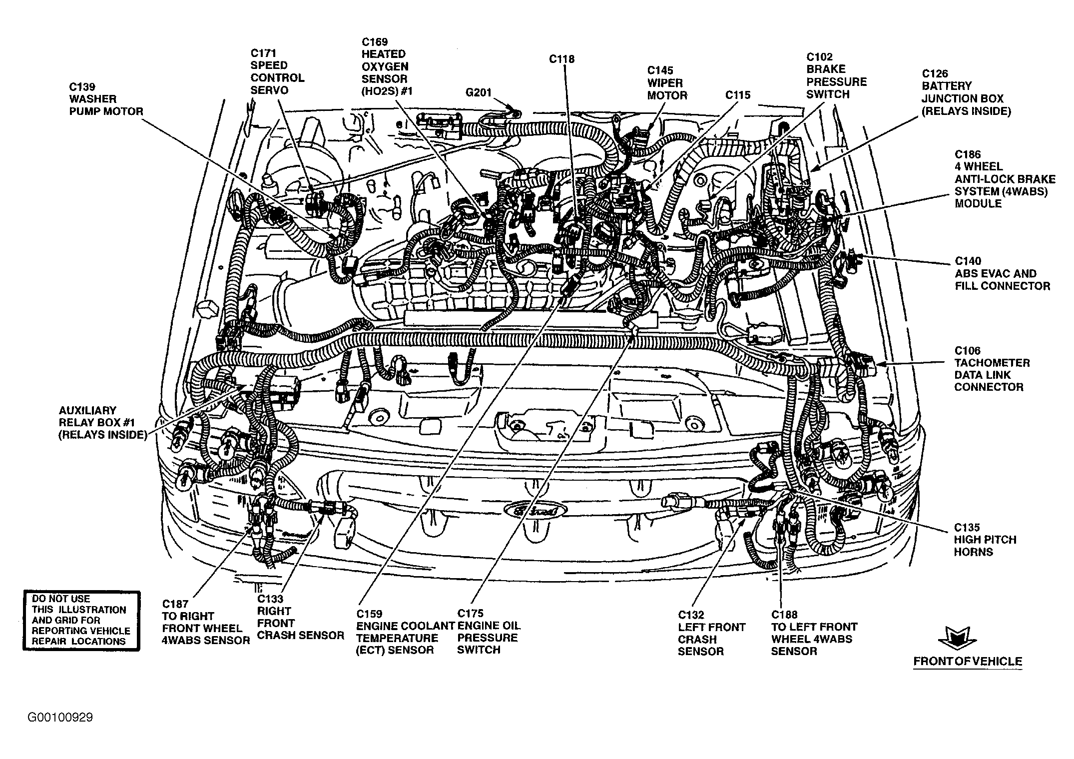

Where are those three relays located? Are they the same ones located in the car jack storage area in the rear of the car?
Feb 2, 2018 at 6:17 AM
PATENTED_REPAIR_PRO
  • 1,853 POSTS
I see a auxiliary relay box #1 located under the hood at the right front corner, check next to or near it for the box #2.
Correction it does say auxiliary relay box number two left rear of vehicle, above wheel well.
Feb 2, 2018 at 6:21 AM
CODE6GEORGE
  • 7 POSTS
I cannot locate the auxiliary relay box #2 in the engine bay. All I see is the power distribution box.
Feb 2, 2018 at 7:02 AM
PATENTED_REPAIR_PRO
  • 1,853 POSTS
I edited that last response to say you were correct, it does say auxiliary relay box #2 left rear of vehicle, above wheel well.

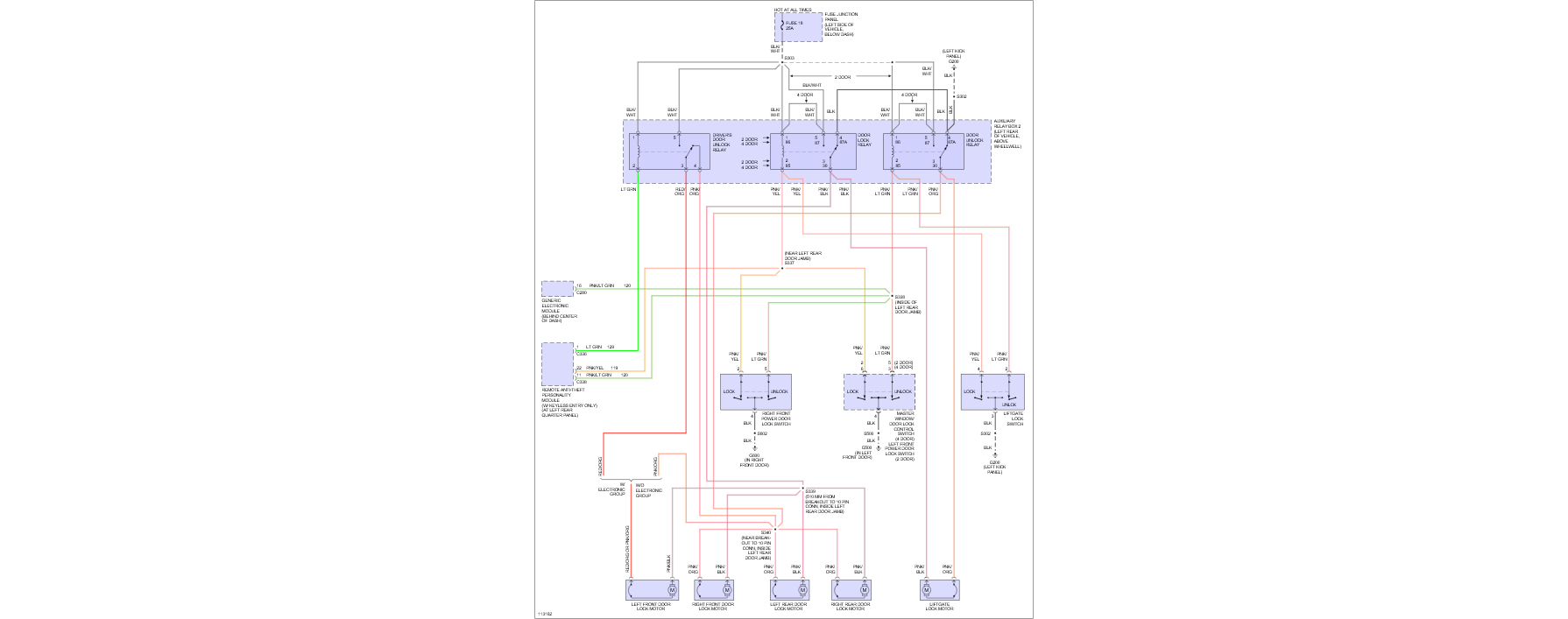

Okay, I removed the relays and put them back one at a time. The fuse blew every time I put the “drivers doors unlock” relay in. I bought a new relay and installed it but the fuse kept on blowing again. Any other suggestions on what it my be in connection with the “drivers doors unlock” relay?
Feb 2, 2018 at 8:39 AM
PATENTED_REPAIR_PRO
  • 1,853 POSTS
Okay, looking at the wiring diagram, it appears it could be either a short in the remote anti-theft personality module and any of the door lock/motors. so try disconnecting all of them then put the fuse and relay in and when the fuse stops blowing, hook back up each individual item until again you narrow it down to which it is.
