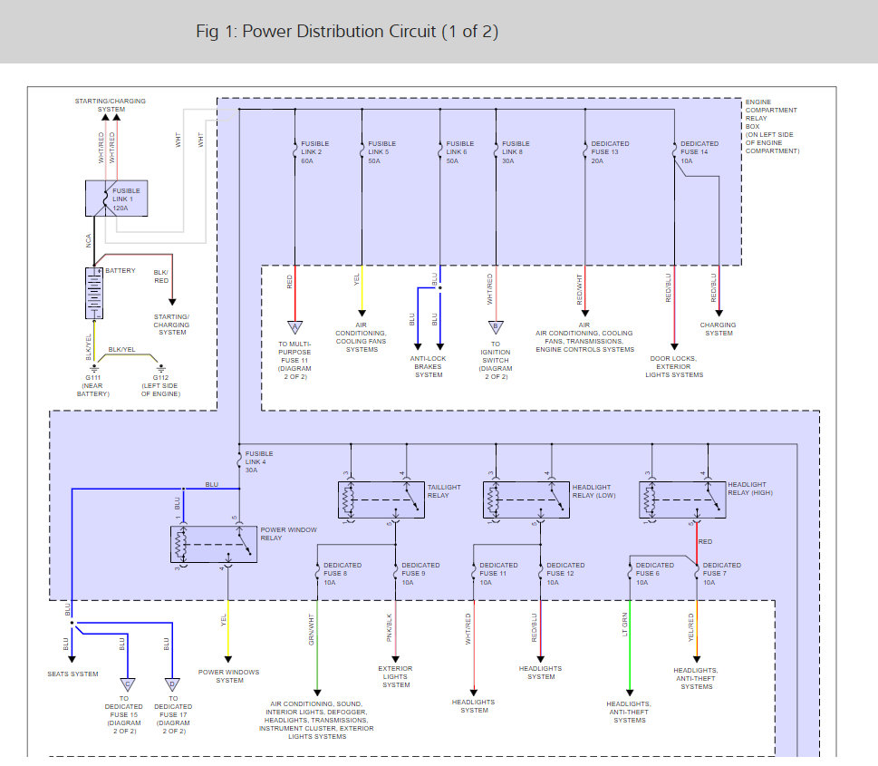

The #13 fuse goes to the cooling fans engine controls and air conditioner. The first thing I would check is the cooling fan, with the engine off open the hood and see if you can rotate the cooling fan it should turn freely.

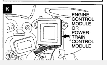

good evening i check the fan and its ok i disconnected and put a new fuse try to star the car and it blew up the fuse again. I try connect the scanner to diagnose the car but it shows an error. Could you send me images of were the ecm is located please?
Feb 28, 2018 at 6:12 AM
  • 55,214 POSTS
It looks like the ECM is under the hood on the drivers side here is a diagrams of its location (below). I would test the ignition coils and fuel injectors.

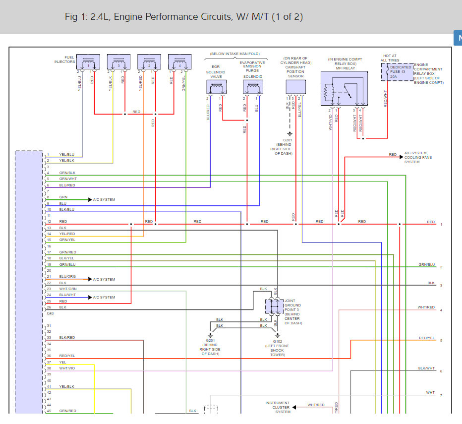

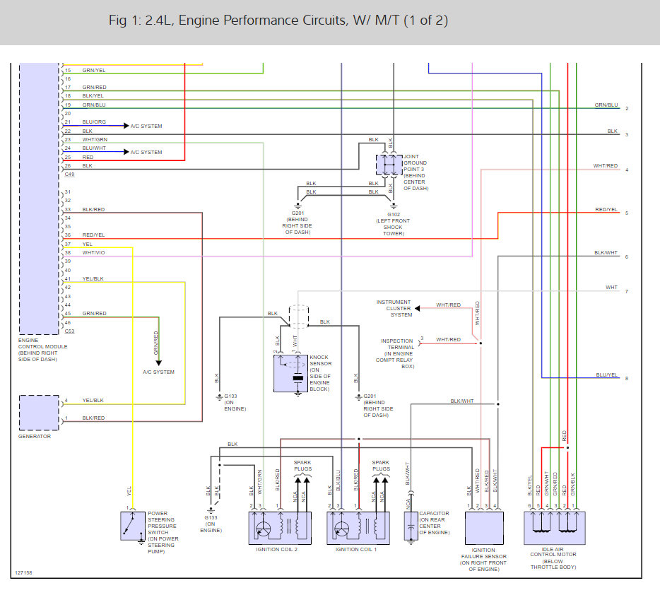

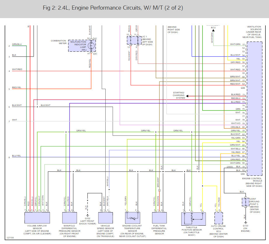

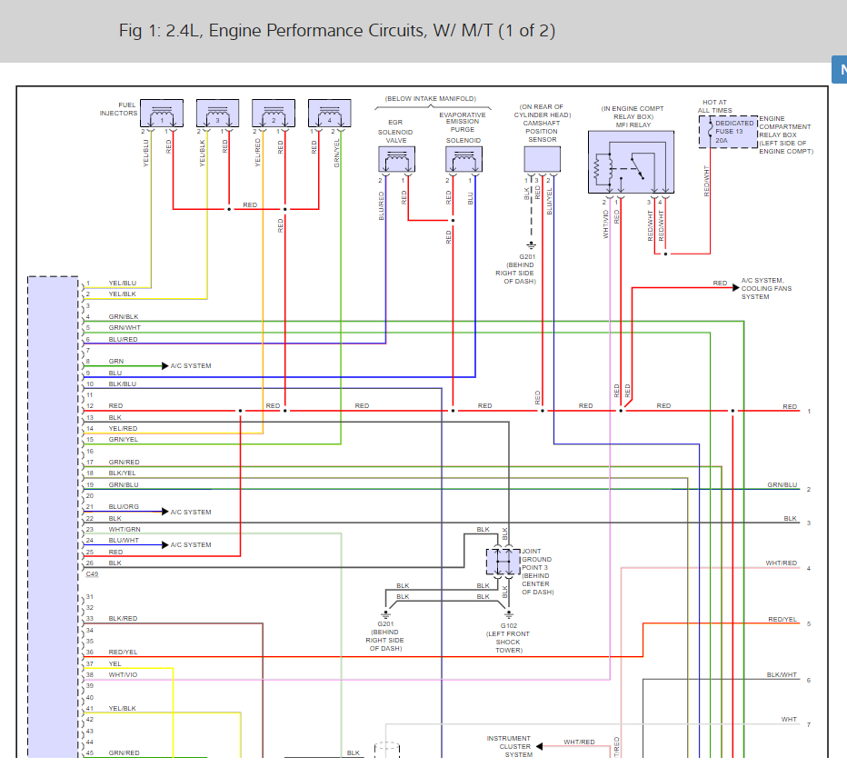

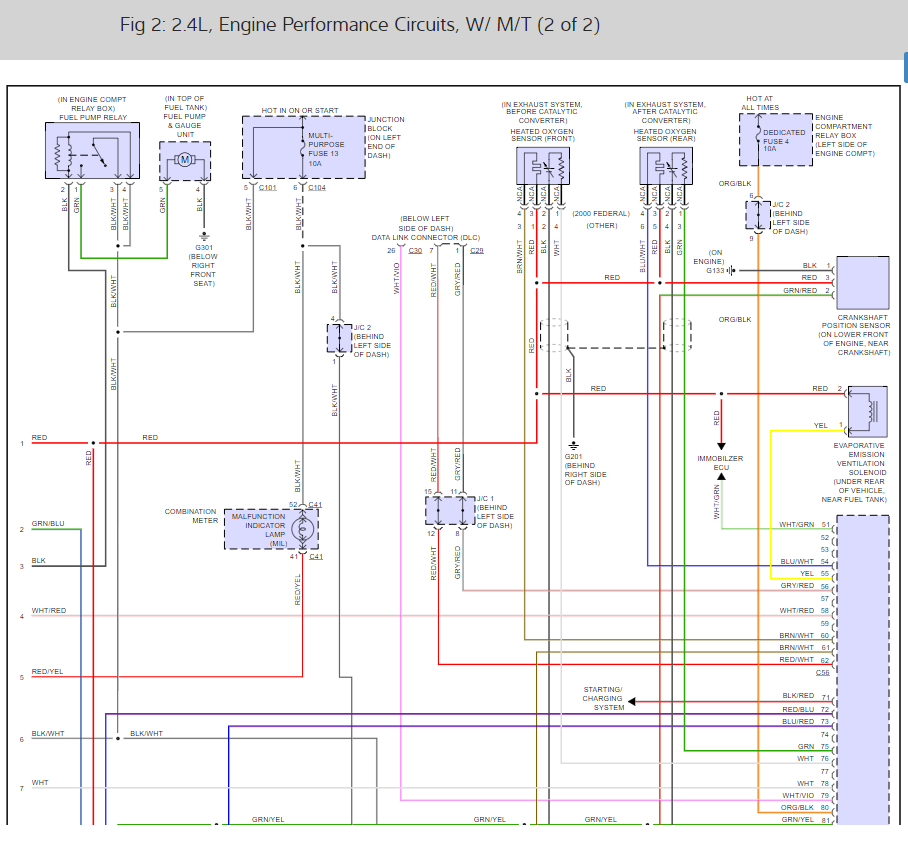

Could any one send me wiring diagrams for the ecm 2000 eclipse
Mar 6, 2018 at 2:26 AM
  • 55,214 POSTS

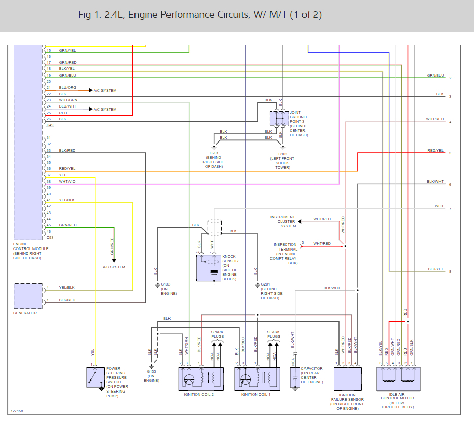

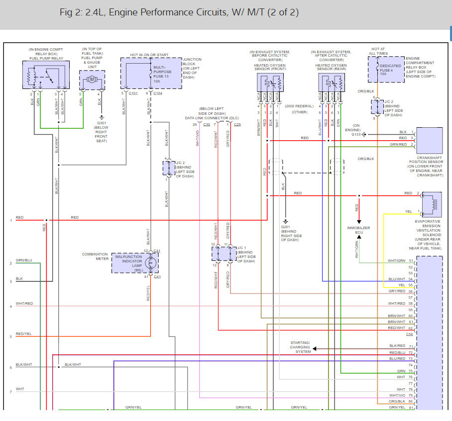

Yep got you covered, here are the full wiring diagrams for the engine and a guider to help you do some testing.
Did you try the oxygen sensors?
