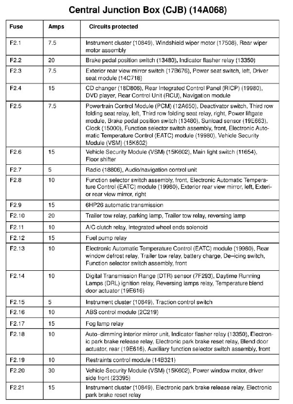

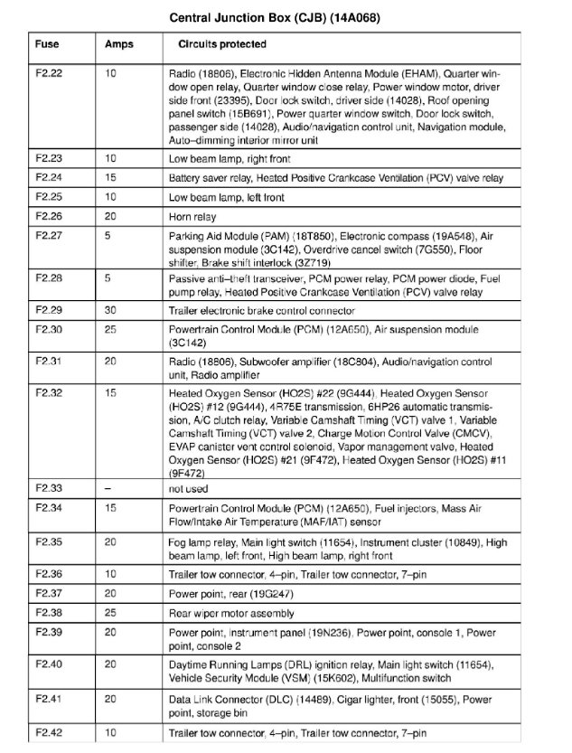

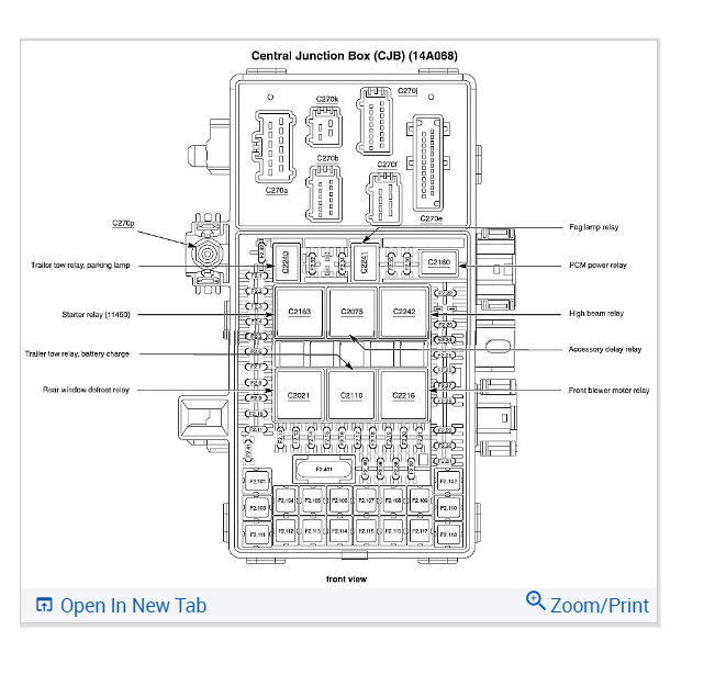

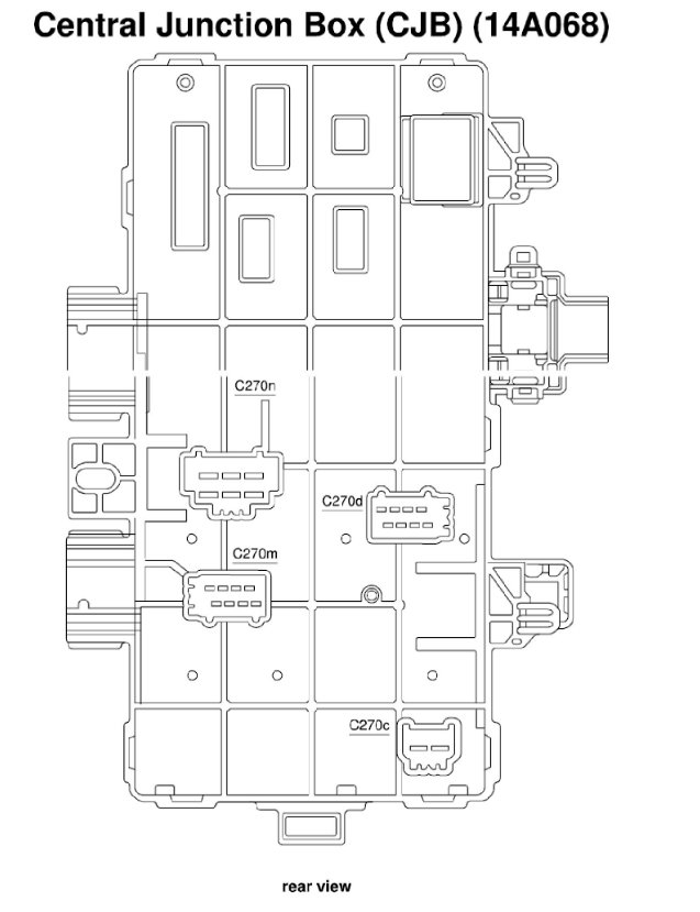

Fuse #12 goes to the fuel pump relay which I would change out first, the fuel pump relay is located in the Central Junction Box (CJB) and is Not Serviceable so you will need to change out the CJB.
If that doesn't fix it the fuel pump module is having a problem or you have a shorted wire to the fuel pump. Please inspect the wiring harness headed to the fuel tank. Here is the location of the fuel pump relay so you can change it out. Check out the diagrams (below). Please let us know what you find. We are interested to see what it is.
