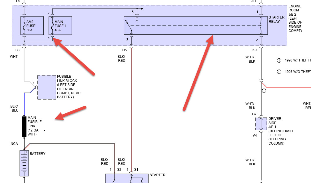

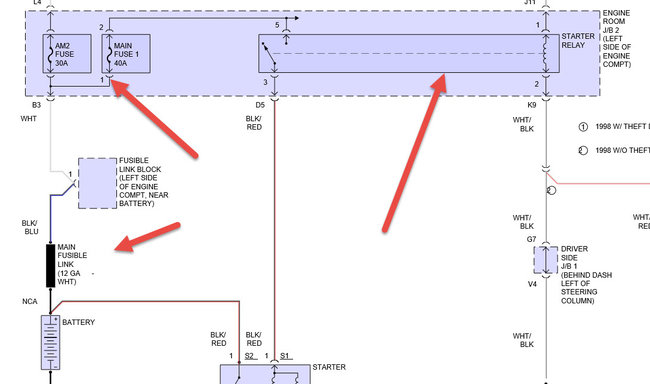

Put jump leads the wrong way on my vehicle and now have no power is there a fusible link somewhere or have I took check anything else?

see picture it is out of a Sienna, but yours should be similar.
