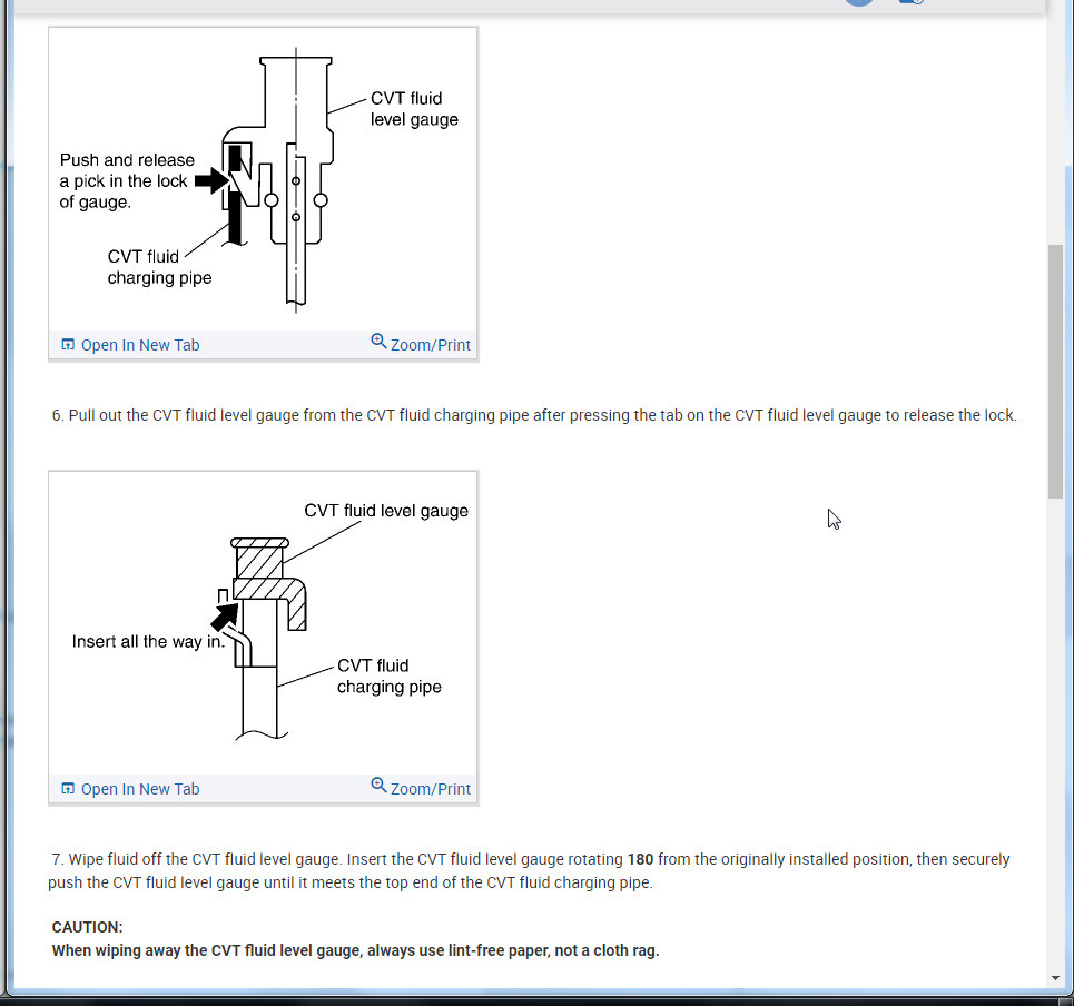

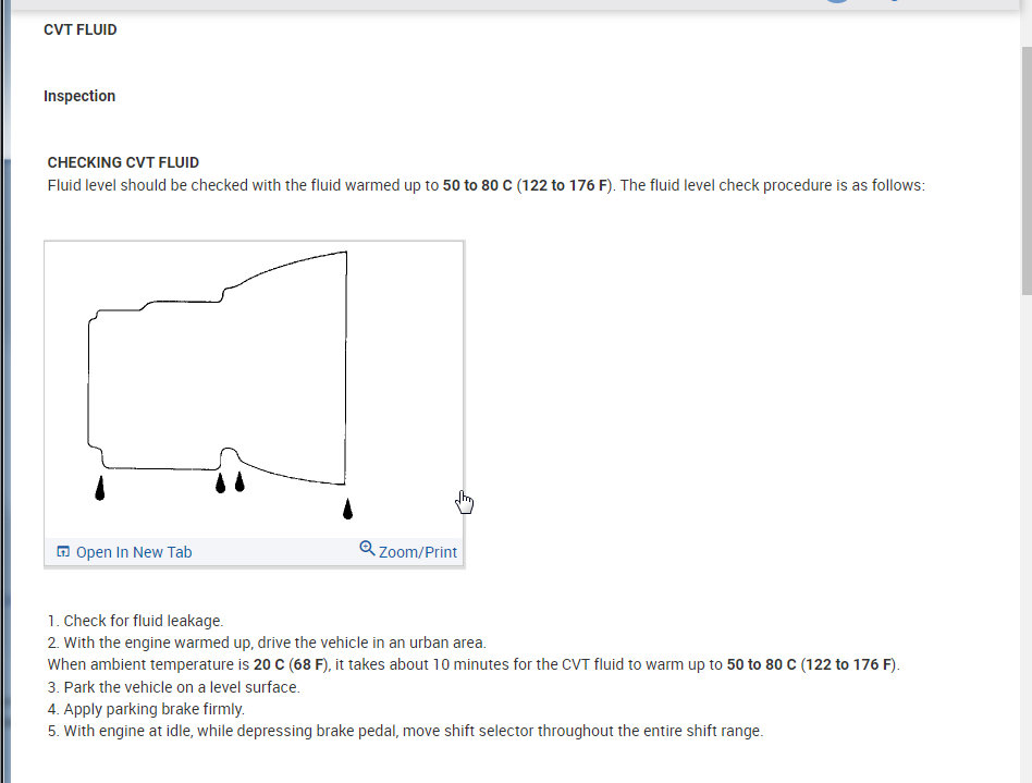

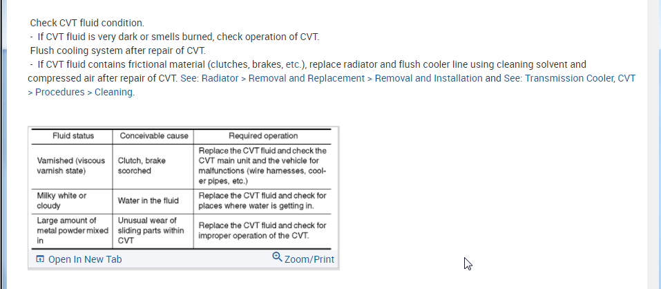

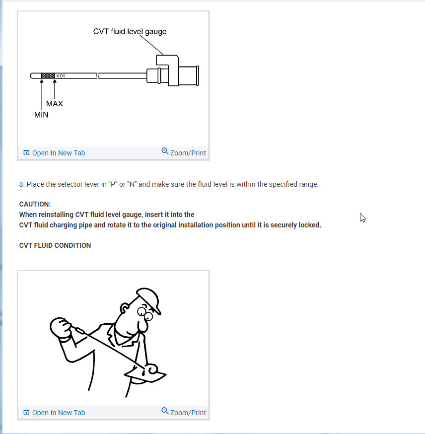

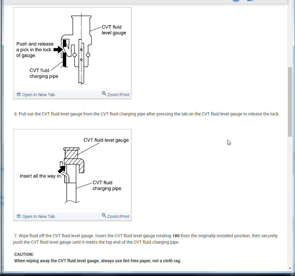

Any assistance would be greatly appreciated. I need to service the transmission
May 23, 2018 at 3:25 AM
Experienced Mechanic
18,907 POSTS
Here is a guide that will help with this:
Plus I attached the process below from the manual on how to replace this fluid.
Please run through this material and let us know what questions you have. Thanks
