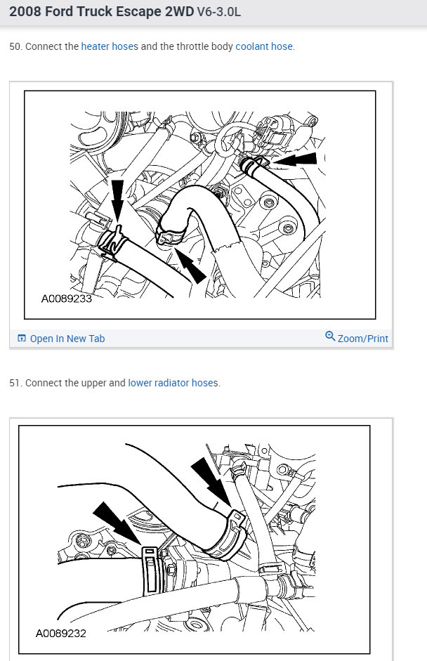

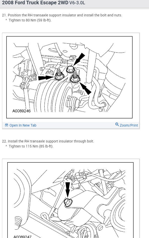

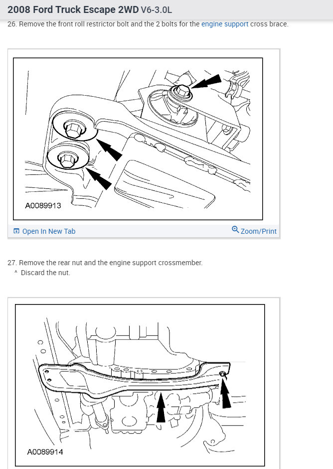

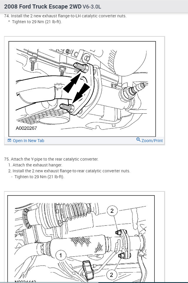

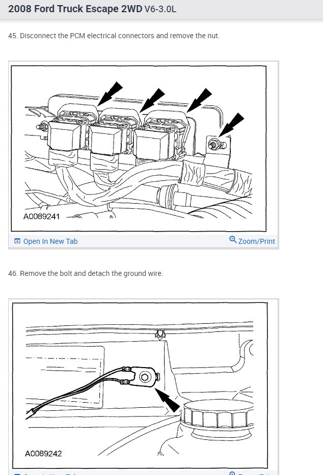

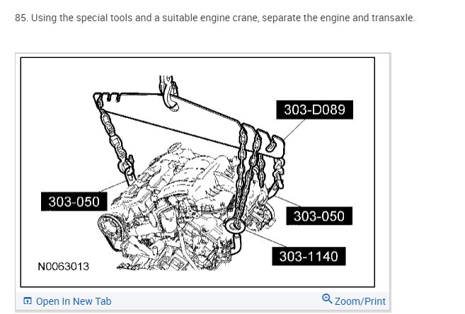

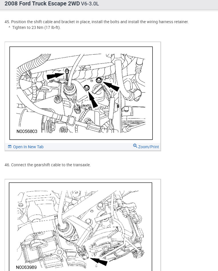

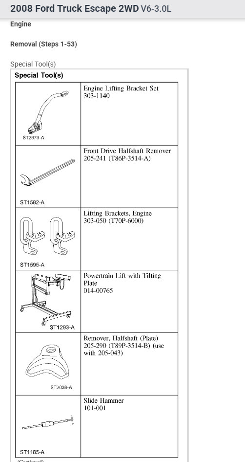

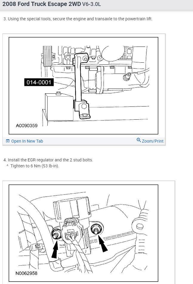

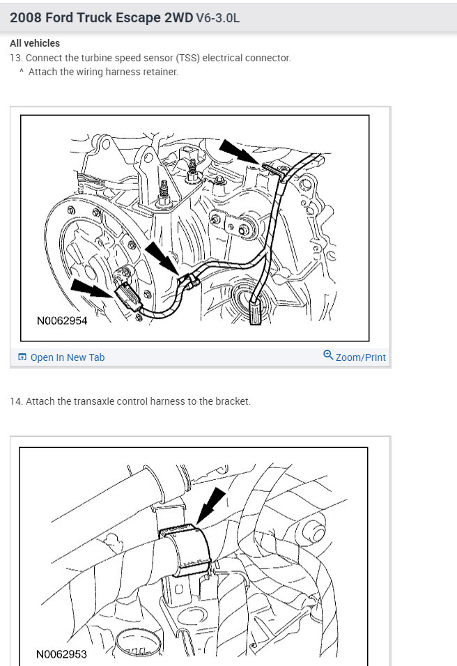

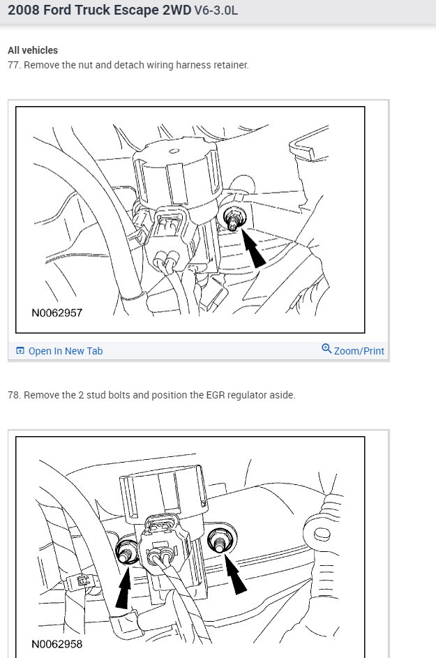

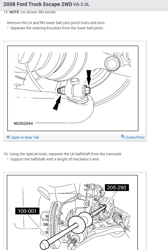

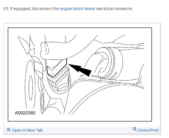

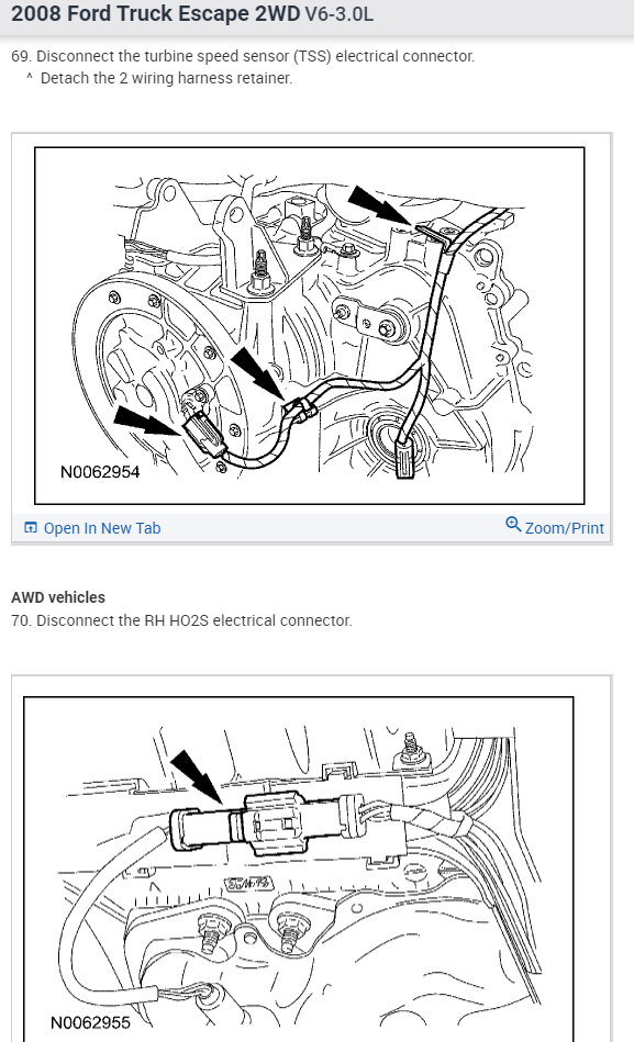

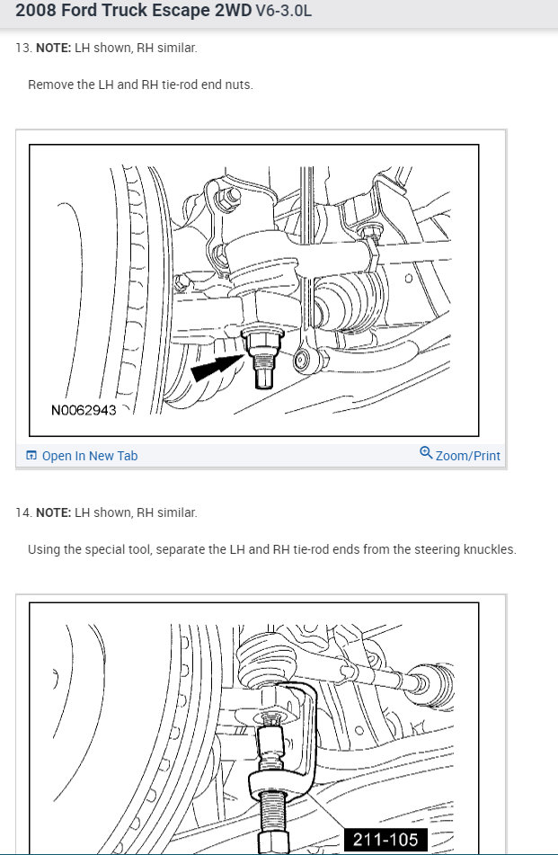

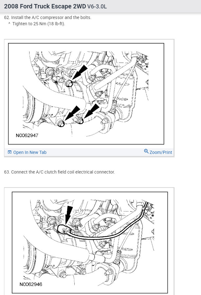

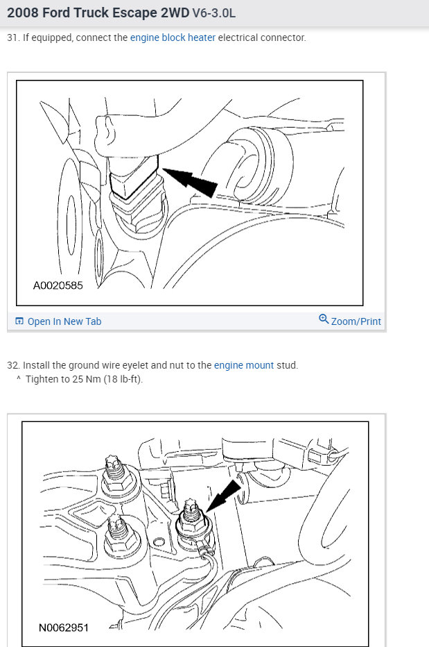

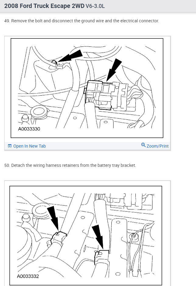

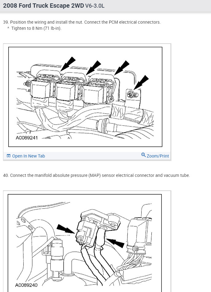

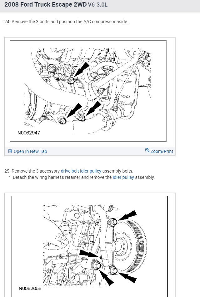

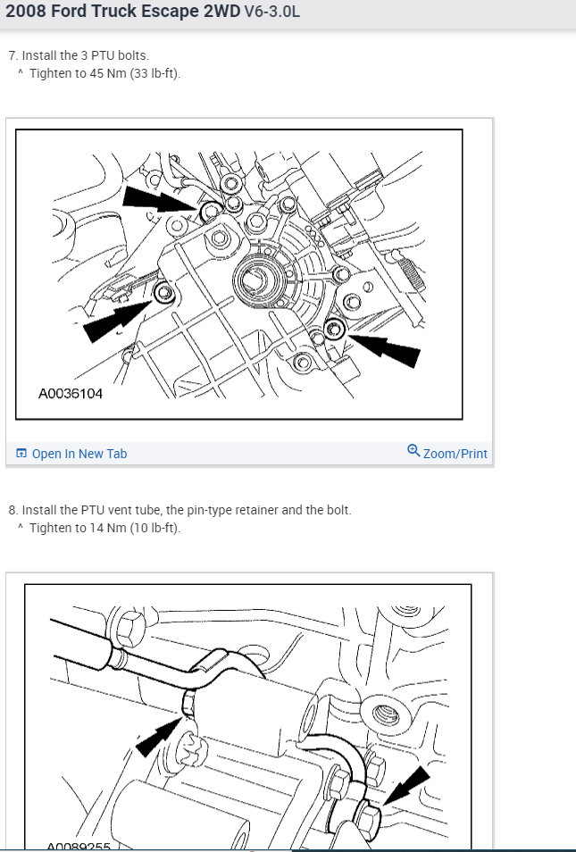

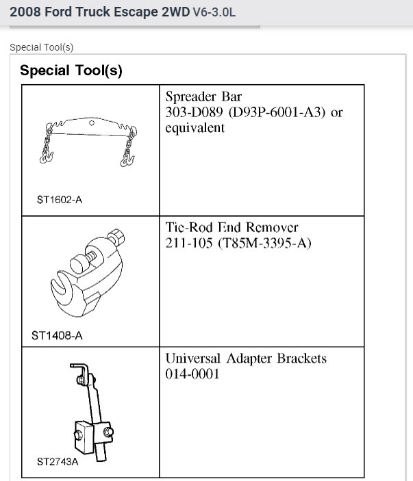

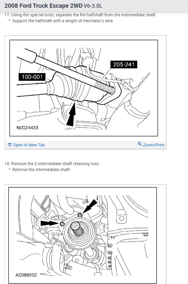

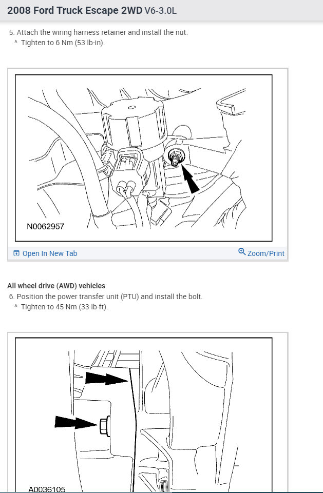

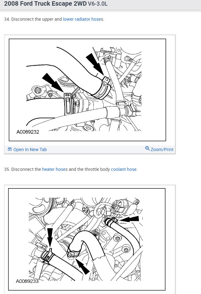

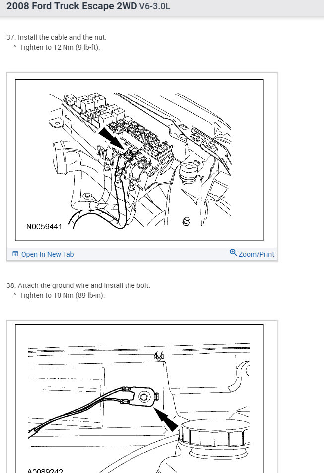

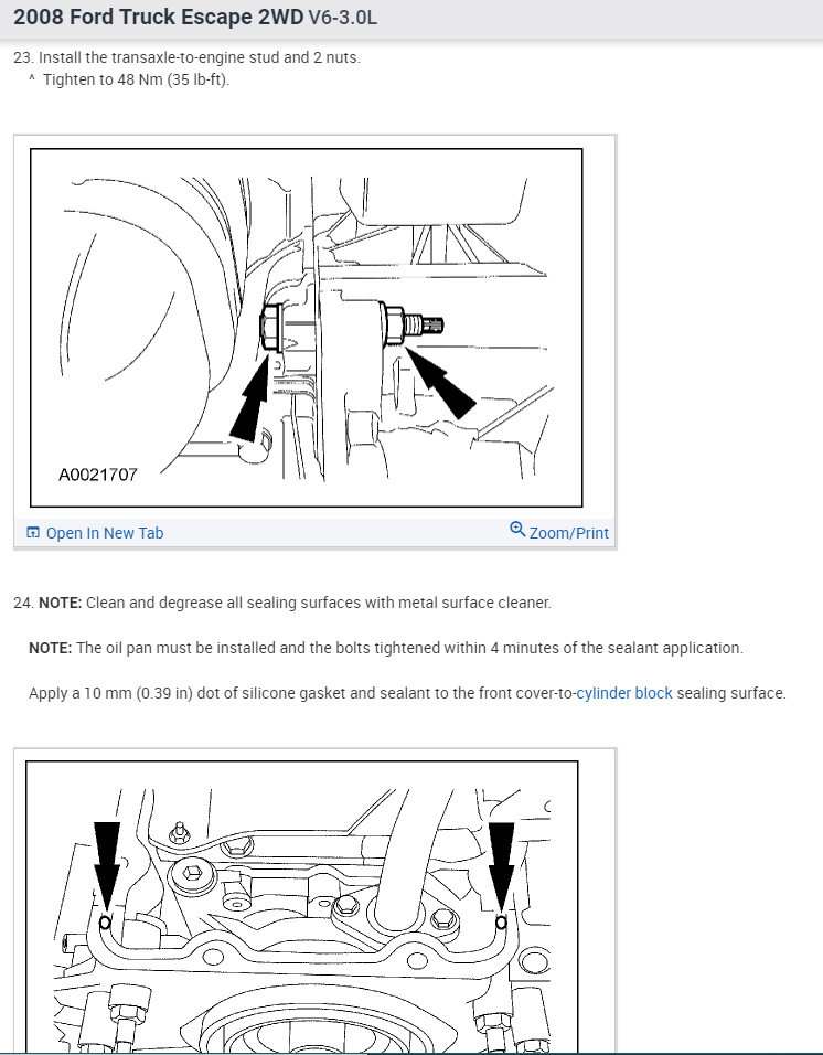

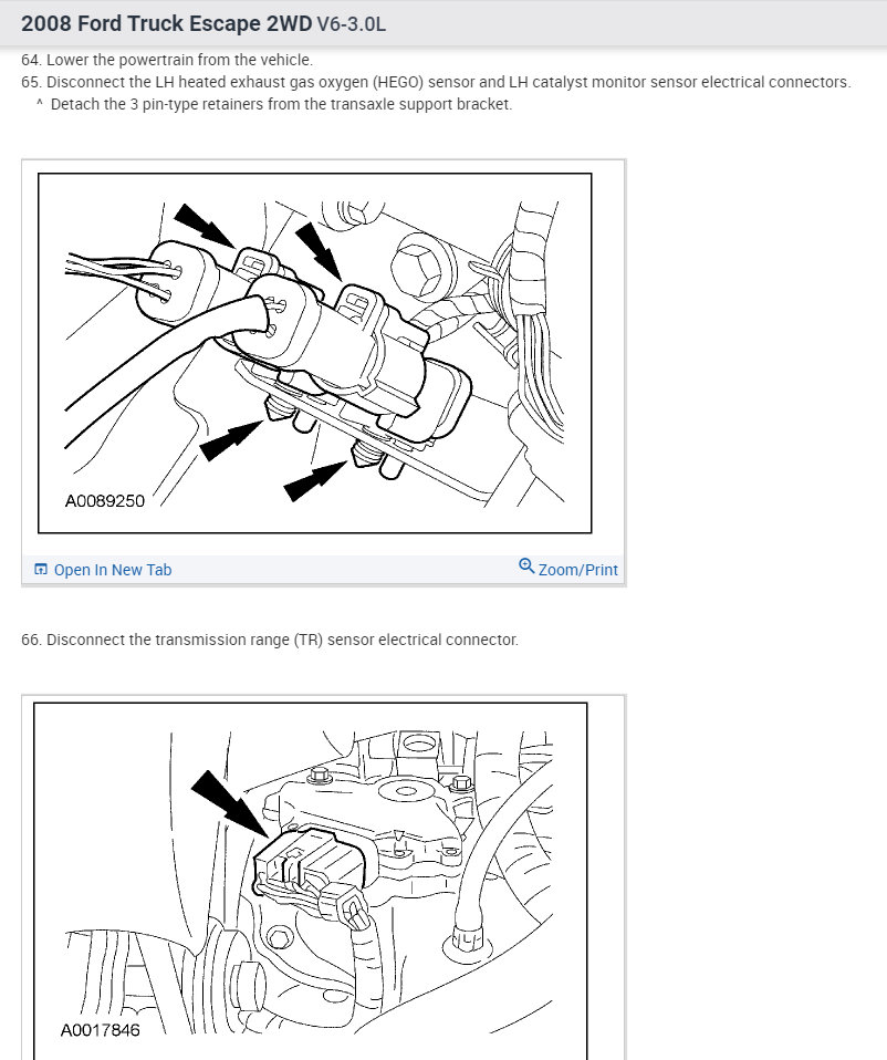

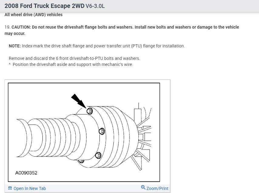

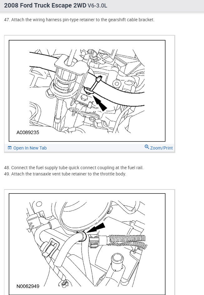

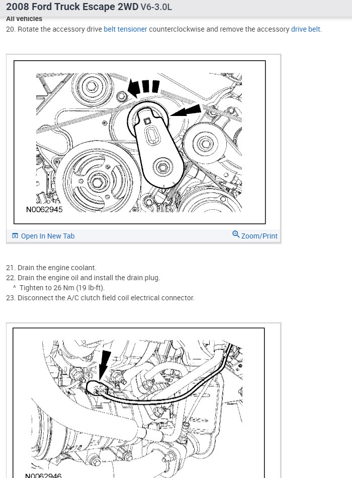

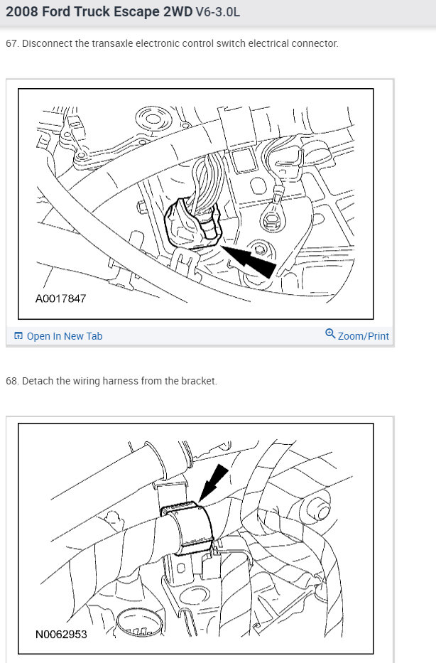

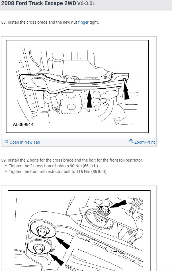

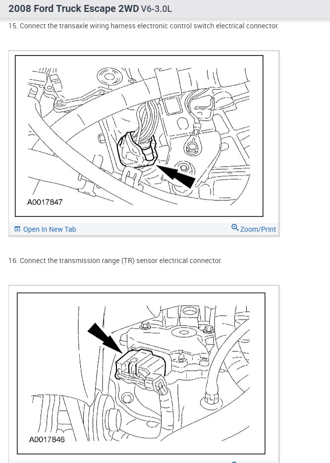

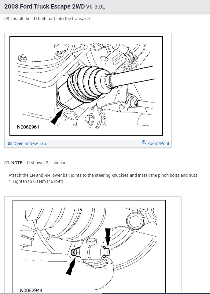

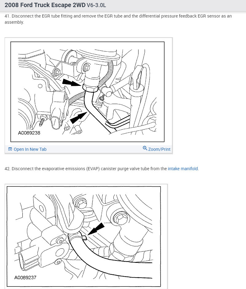

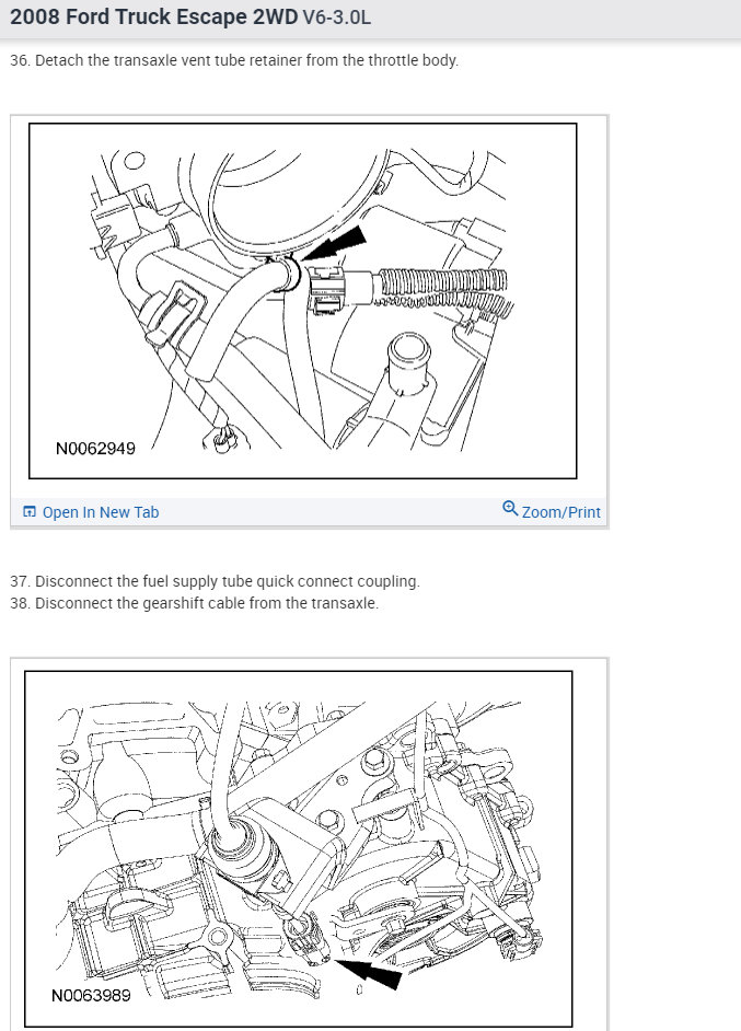

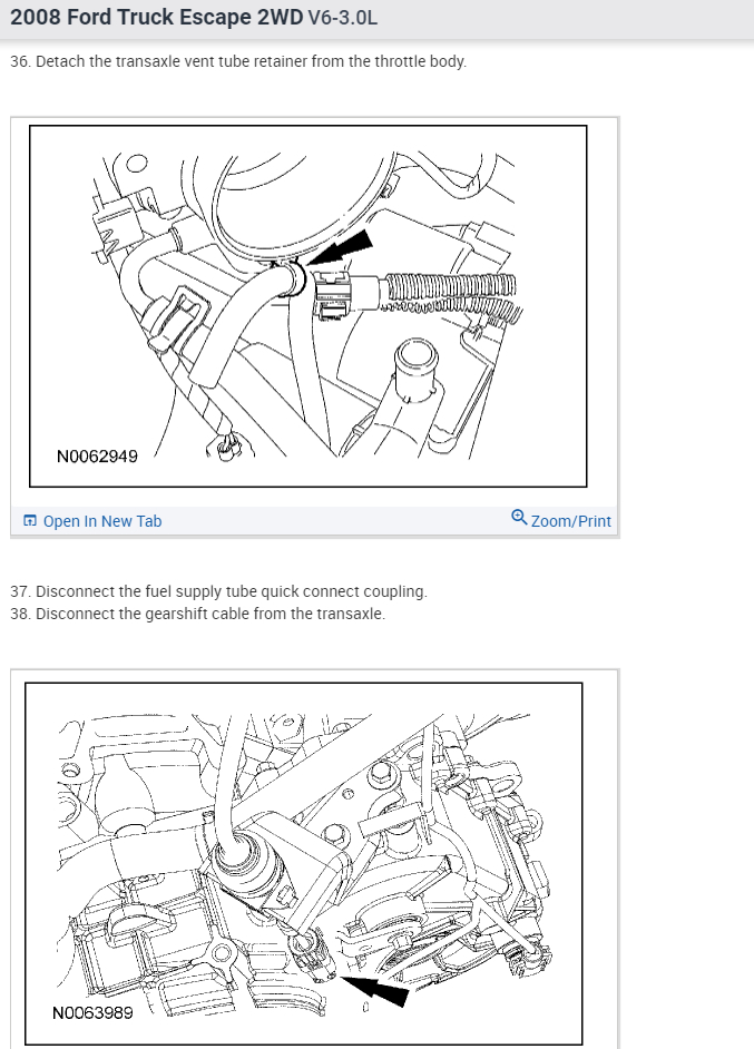

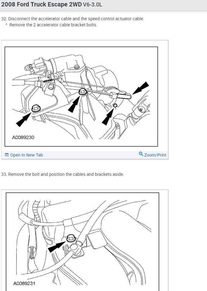

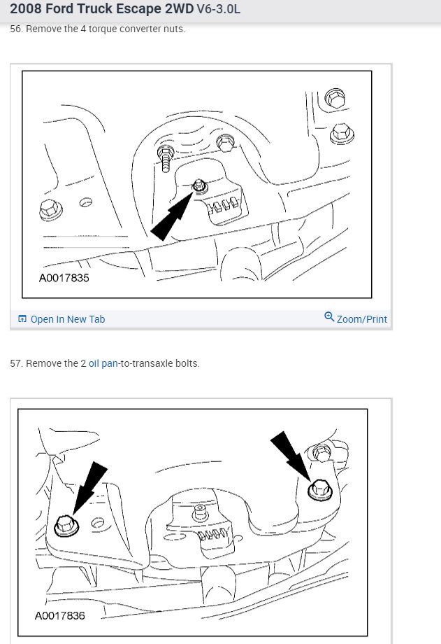

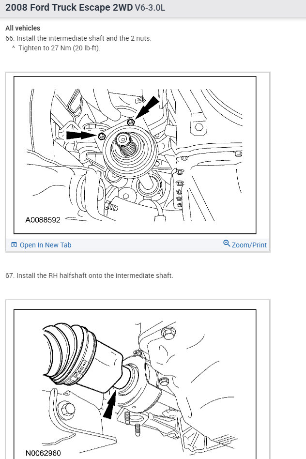

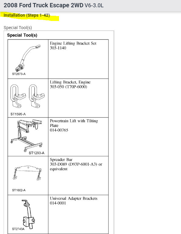

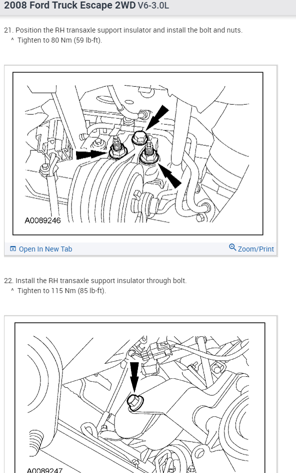

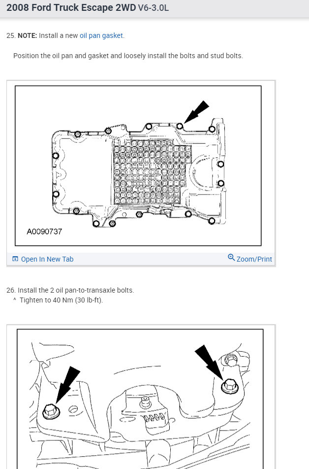

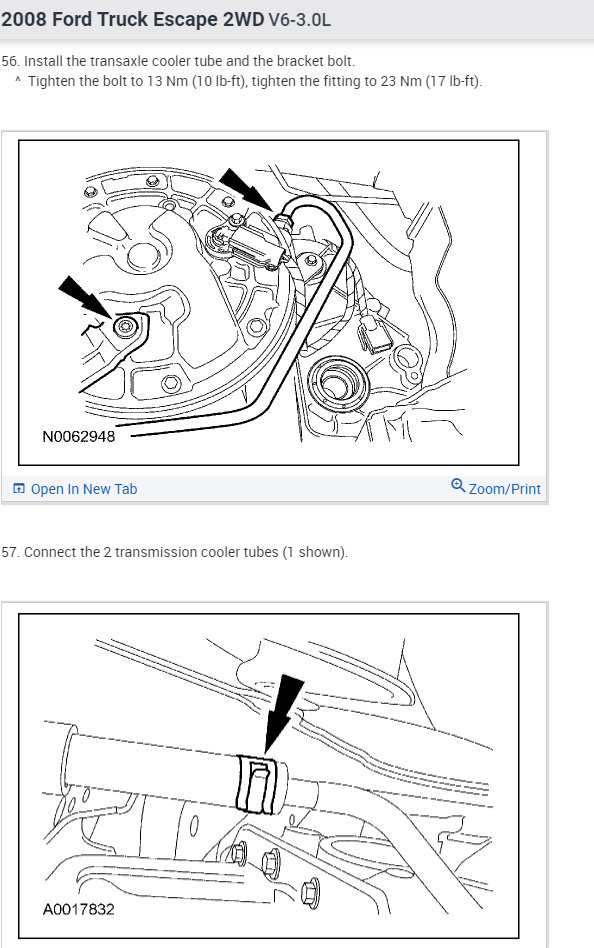

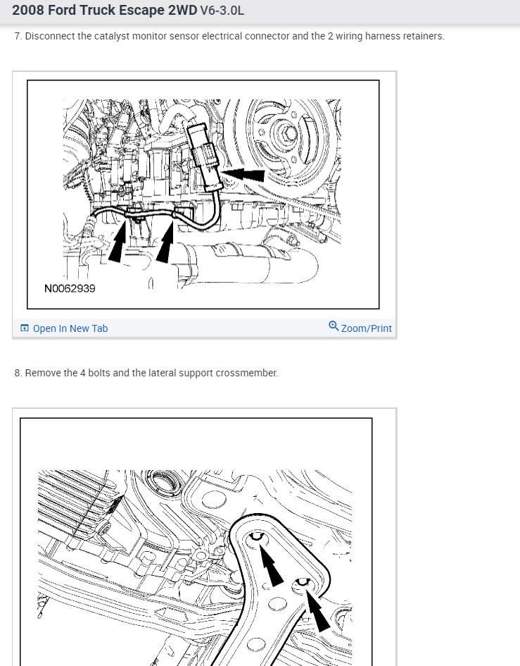

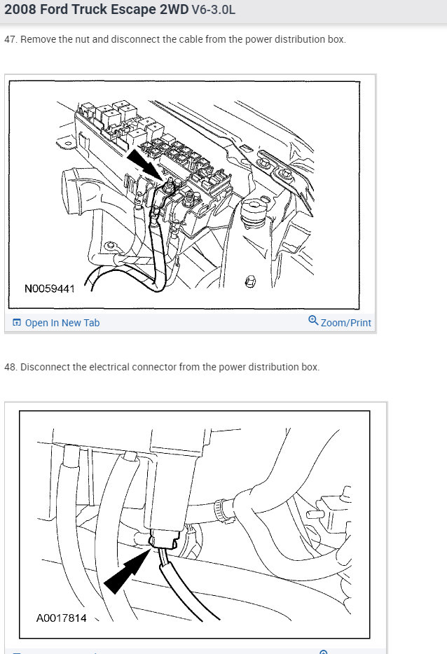

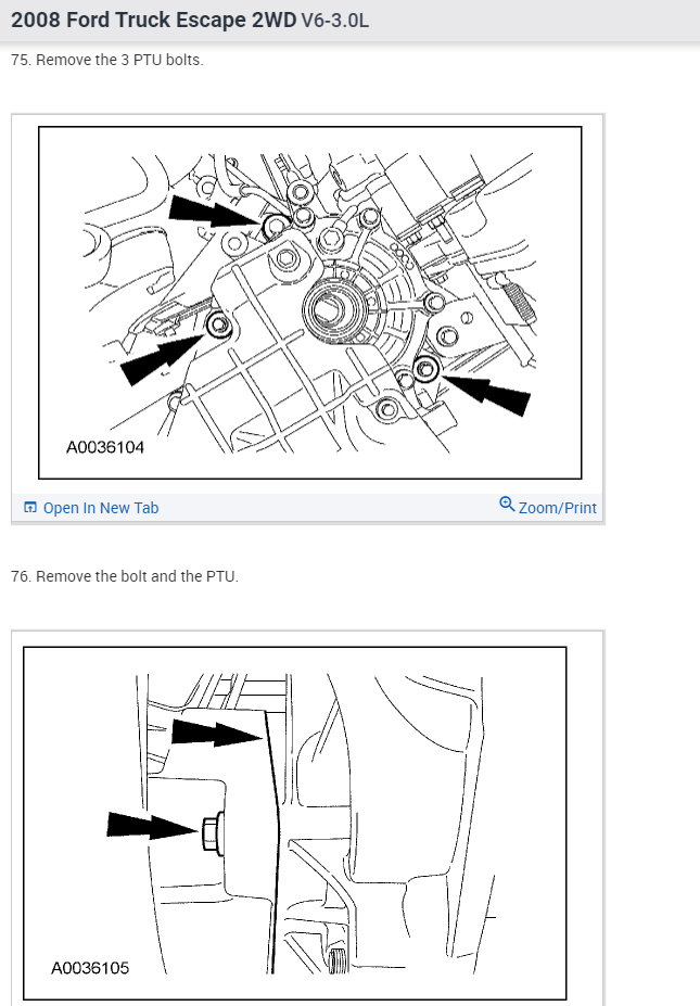

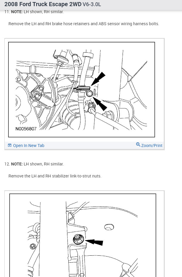

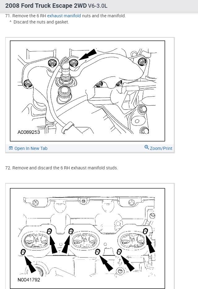

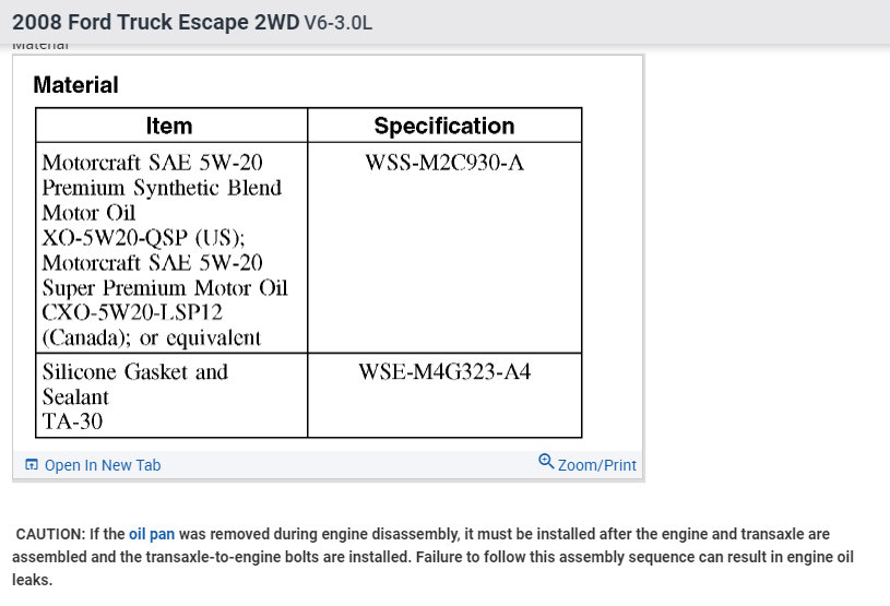

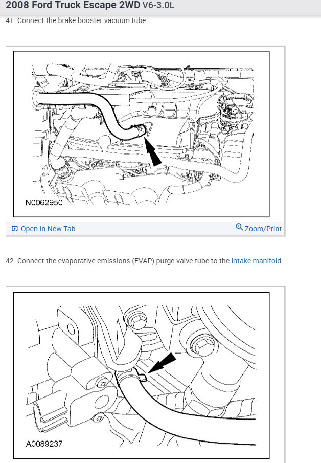

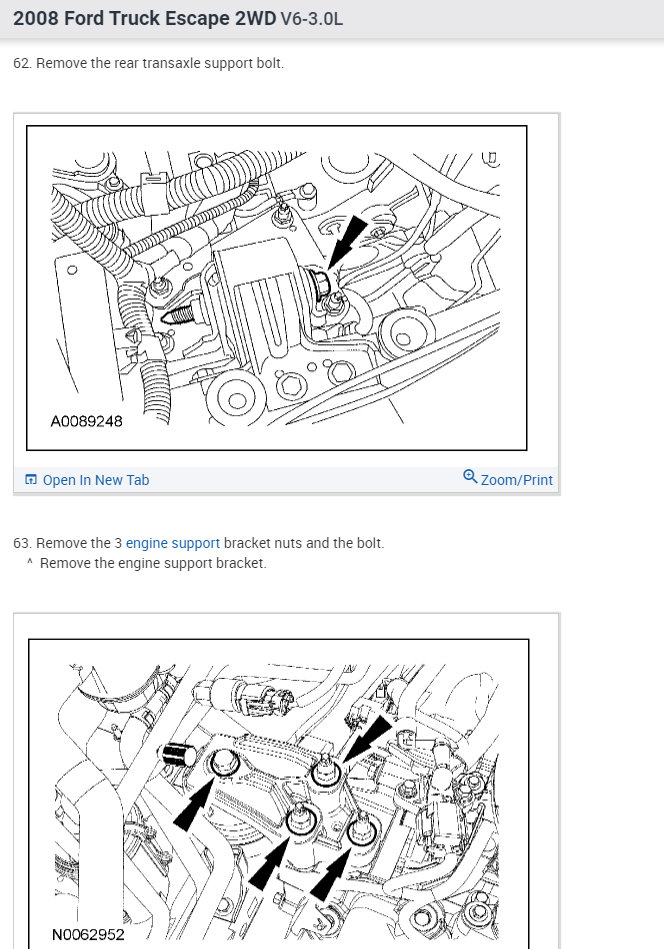

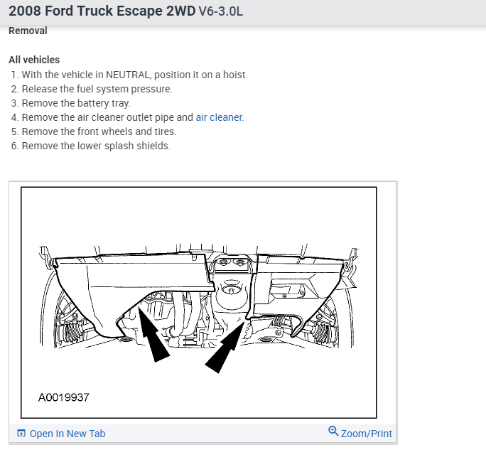

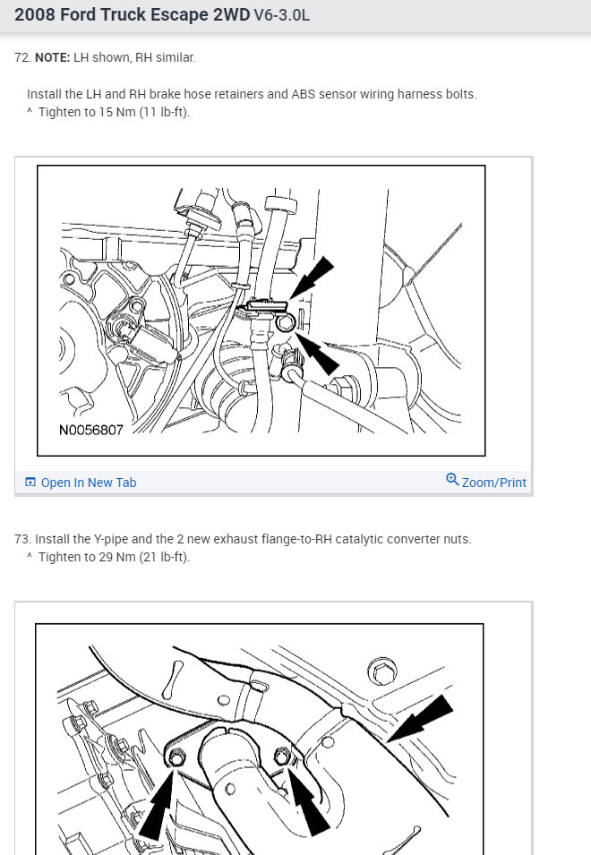

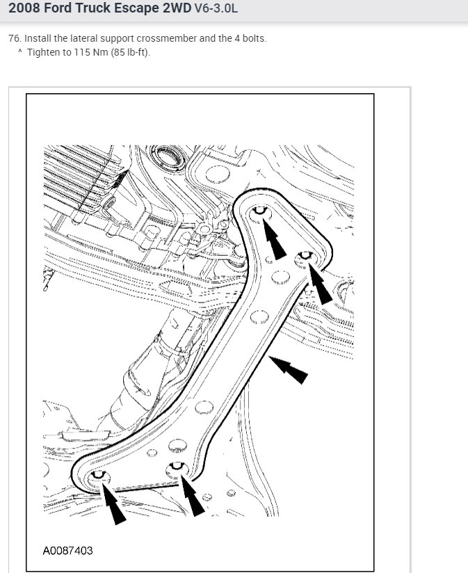

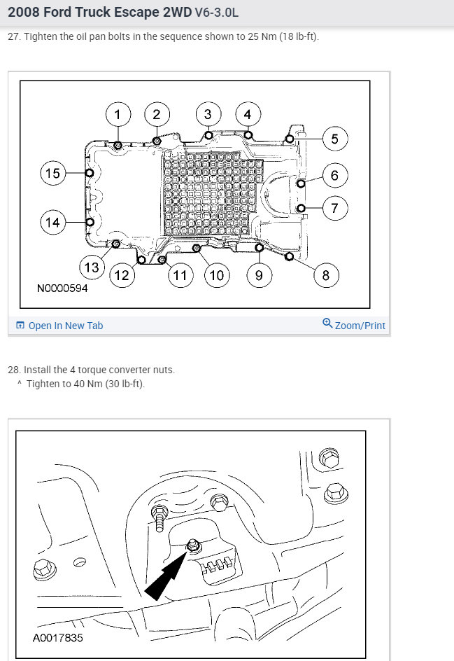

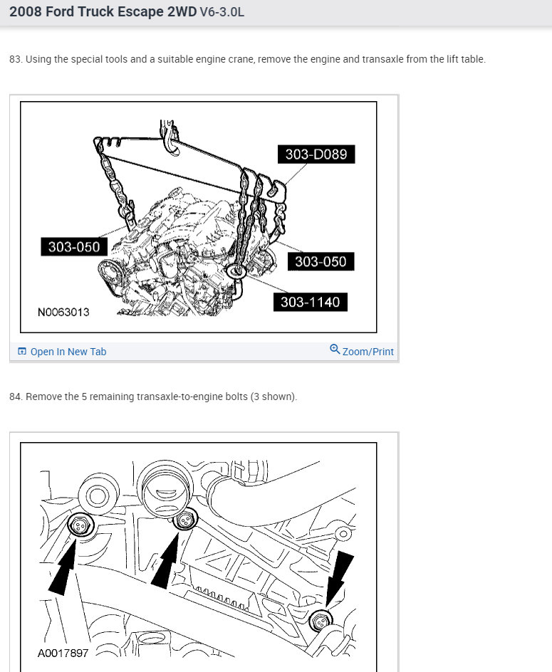

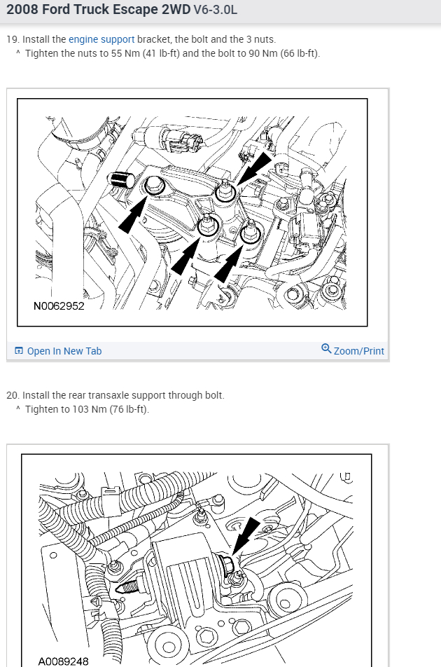

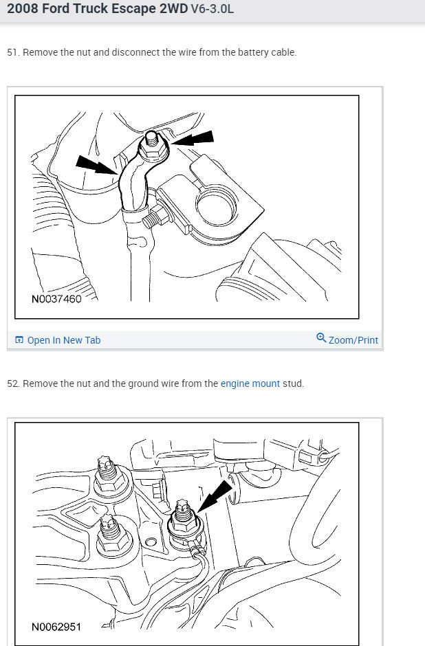

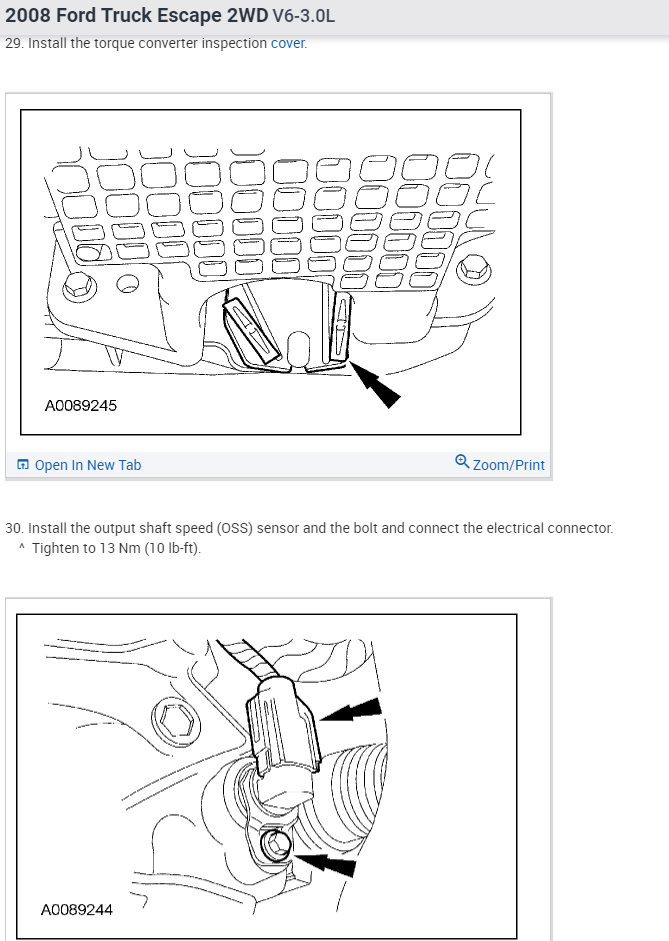

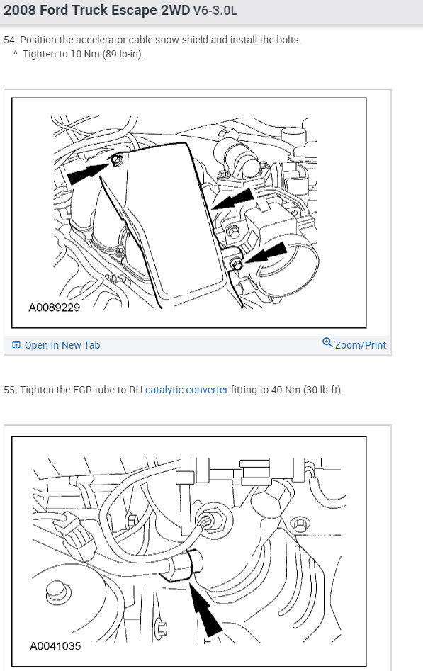

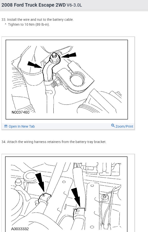

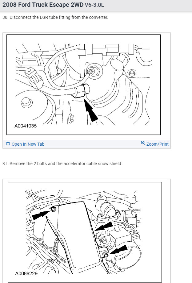

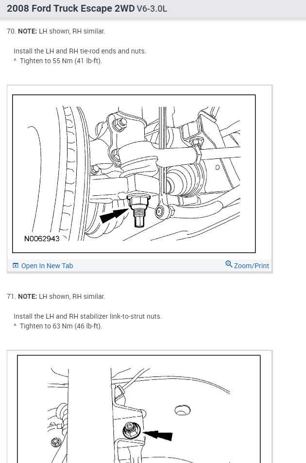

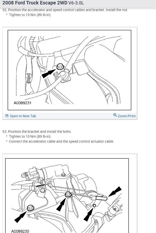

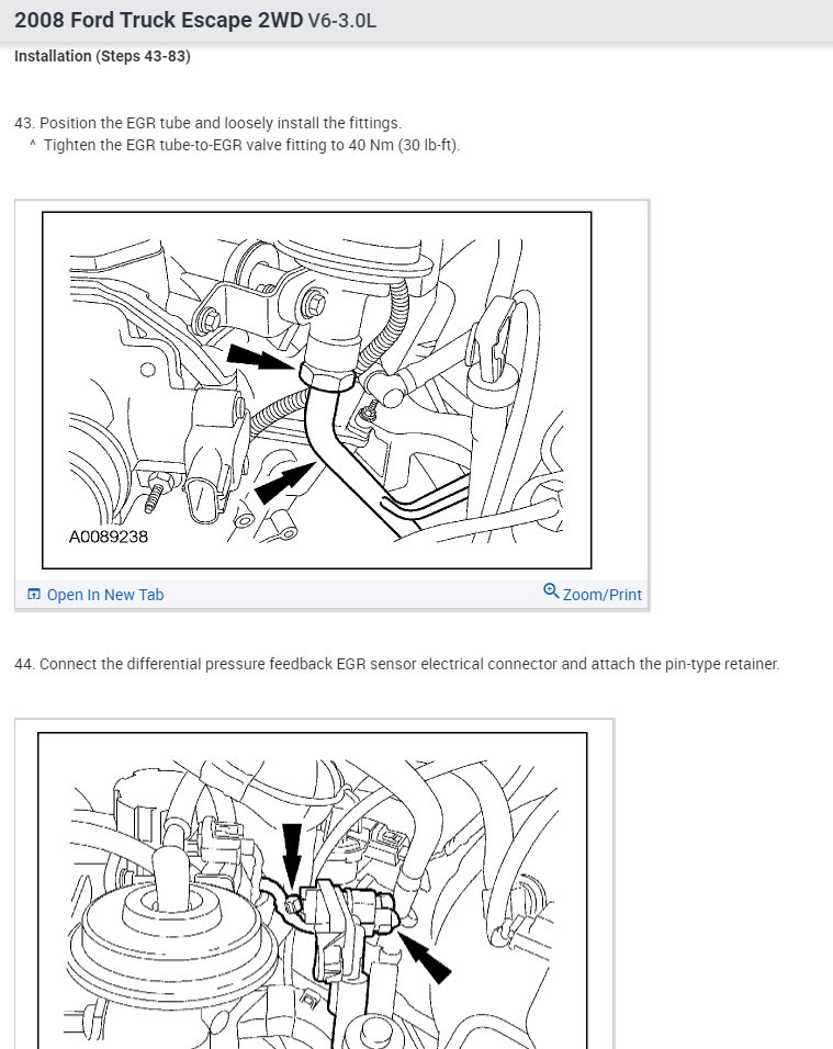

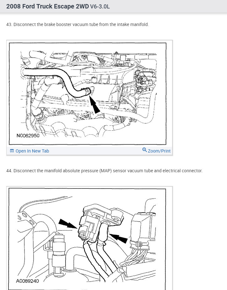

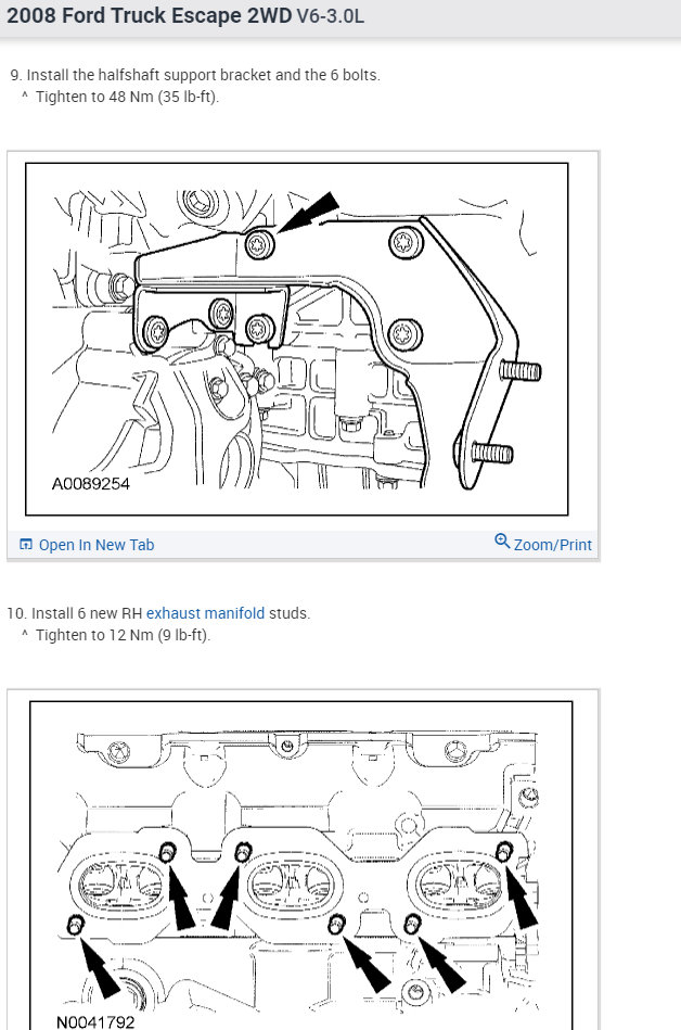

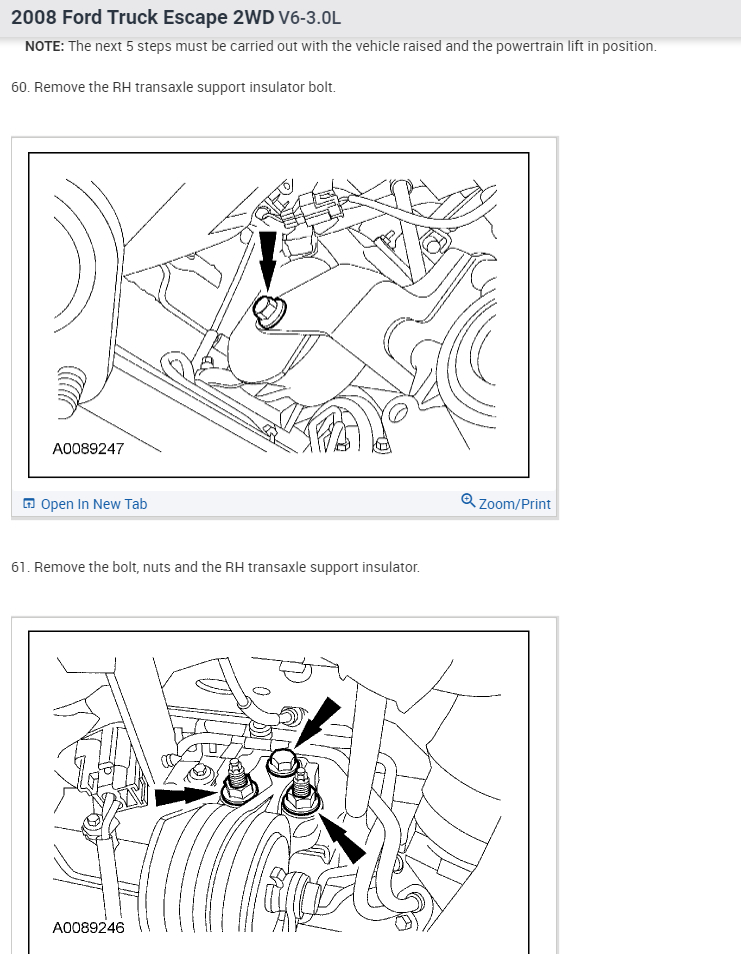

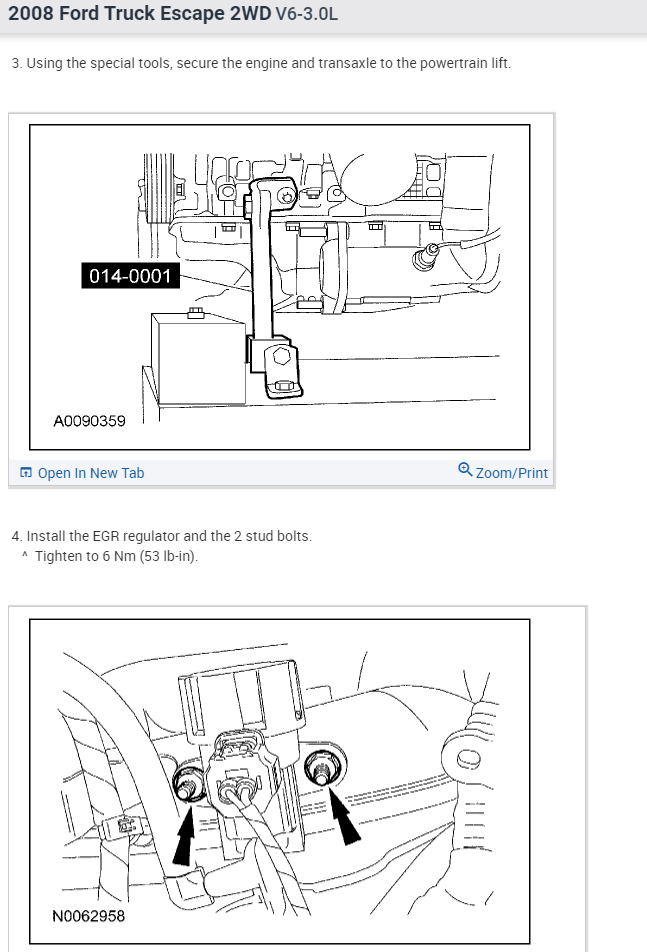

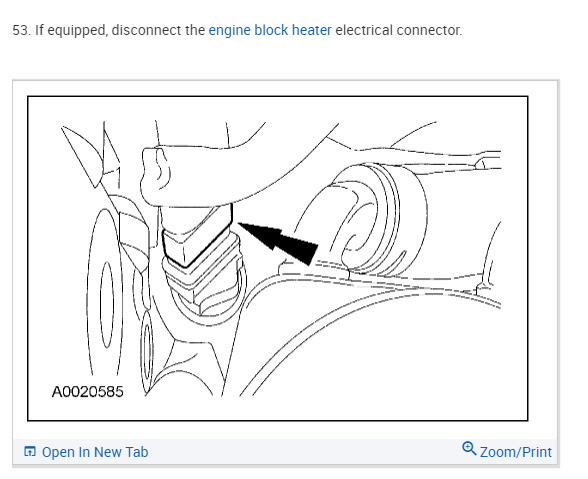

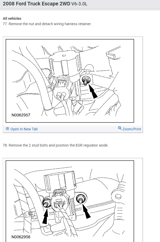

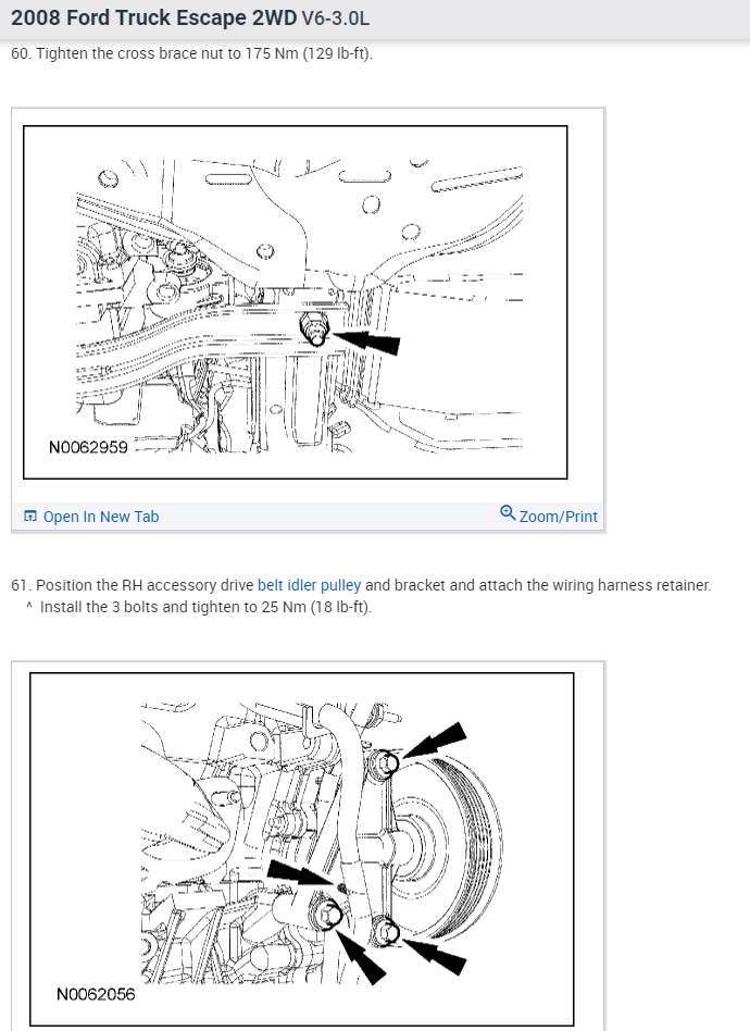

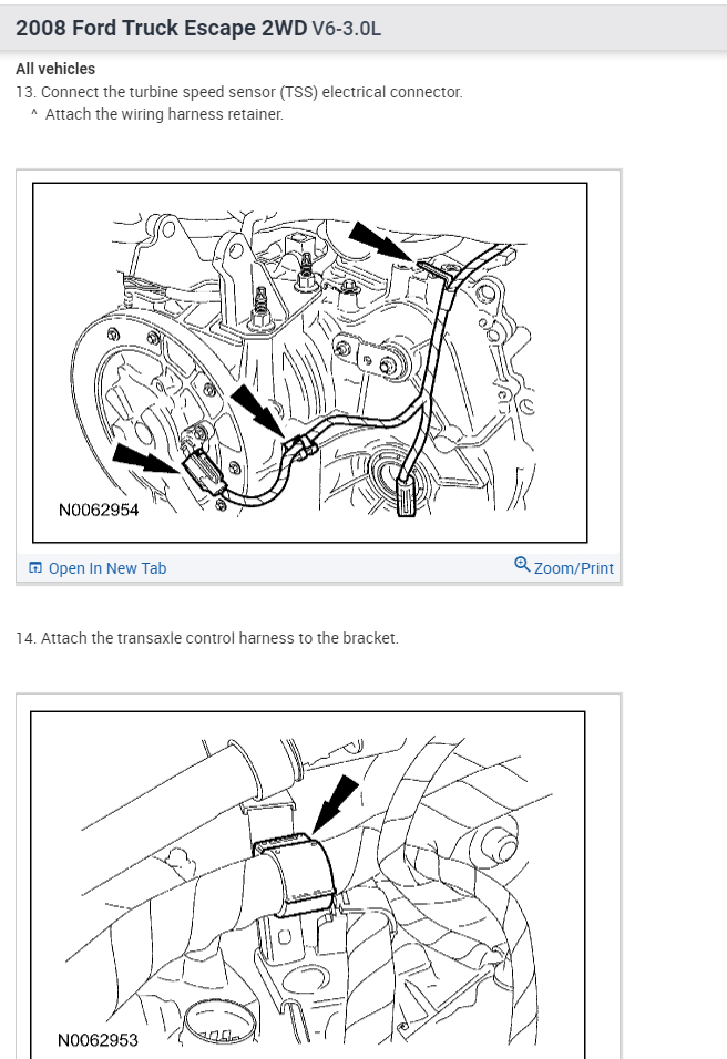

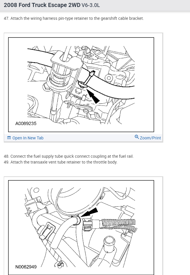

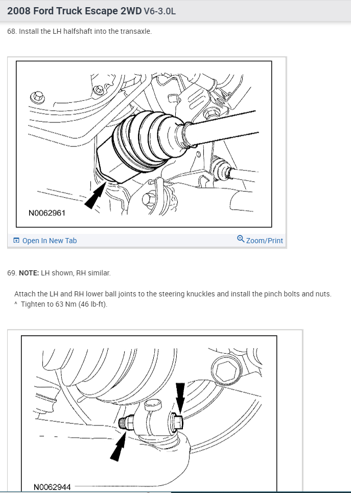

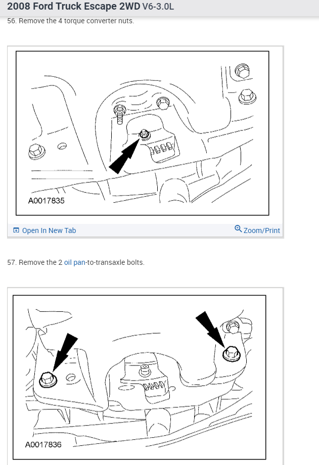

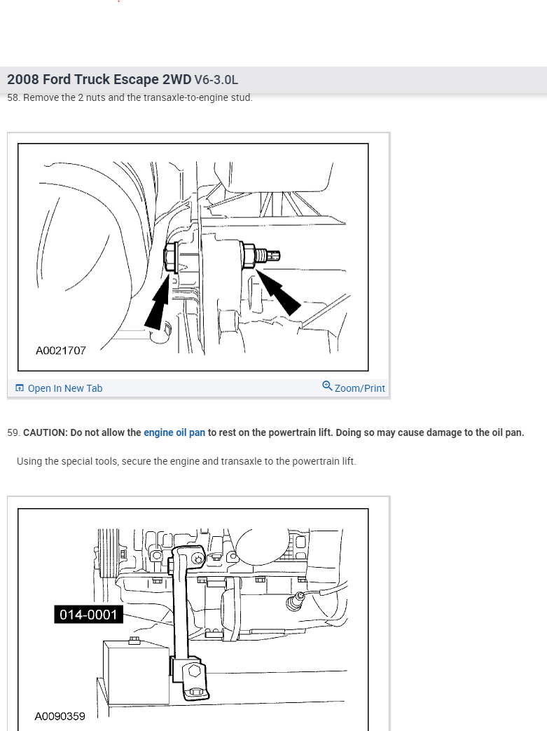

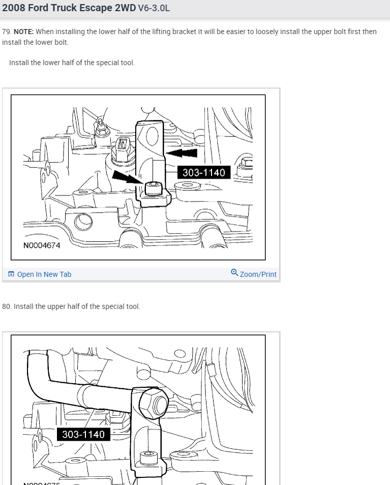

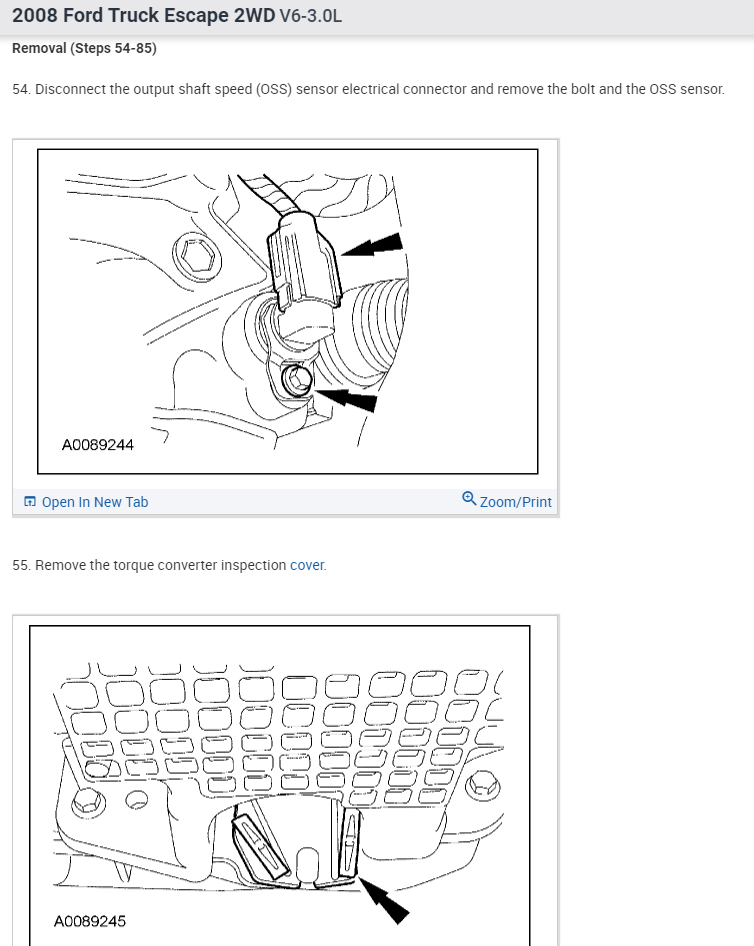

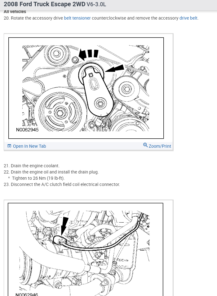

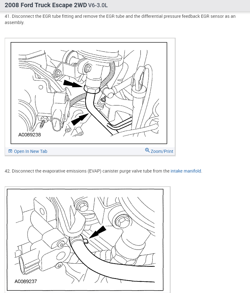

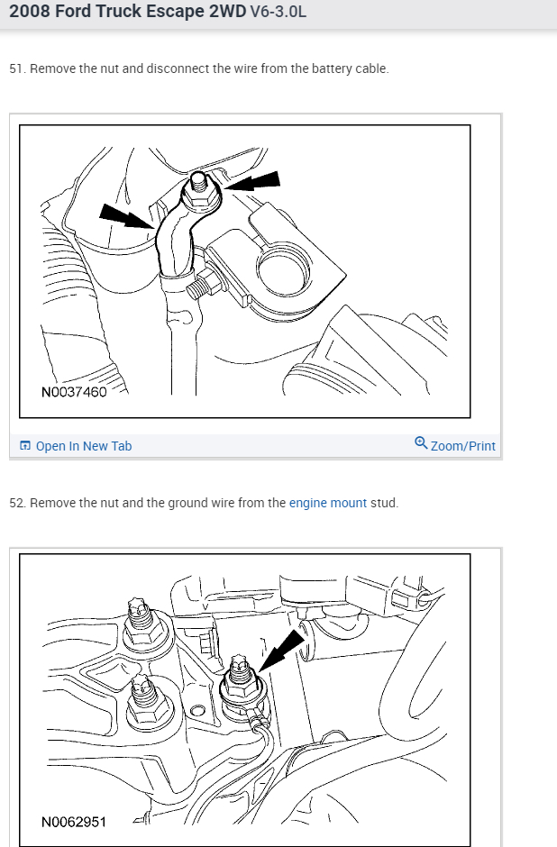

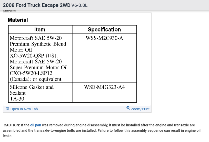

I'm removing my engine from my vehicle listed above. How do I get step by step instructions?
Sep 24, 2022 at 1:28 PM
SQM
Experienced Mechanic
6,383 POSTS

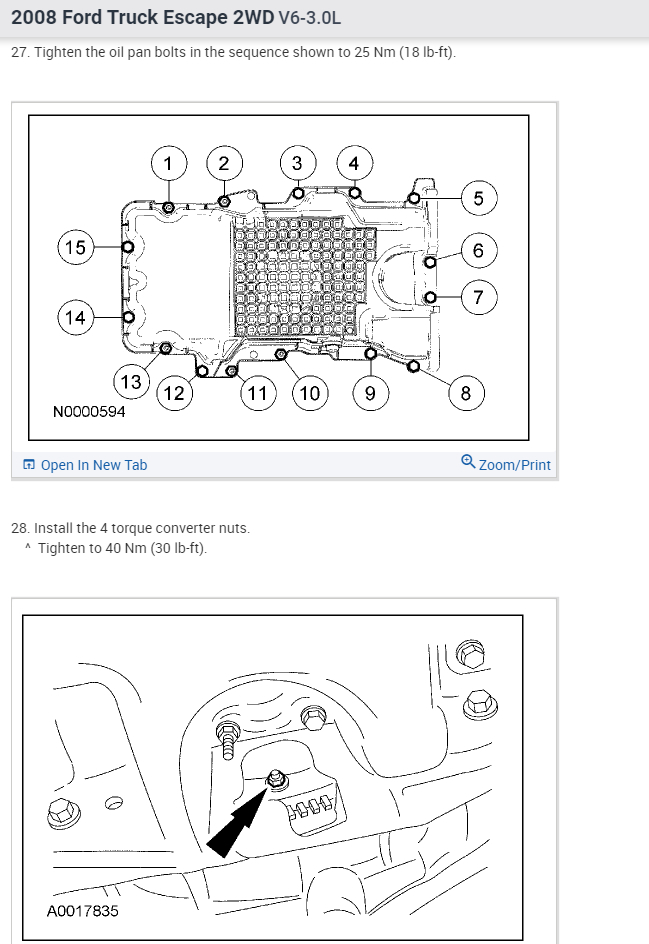

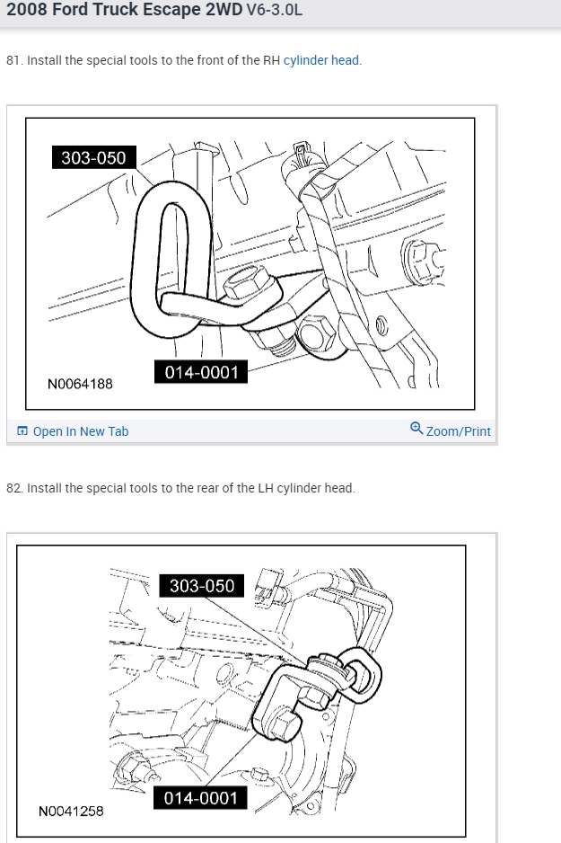

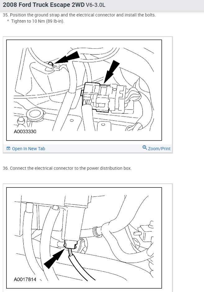

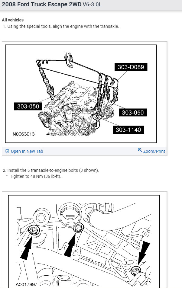

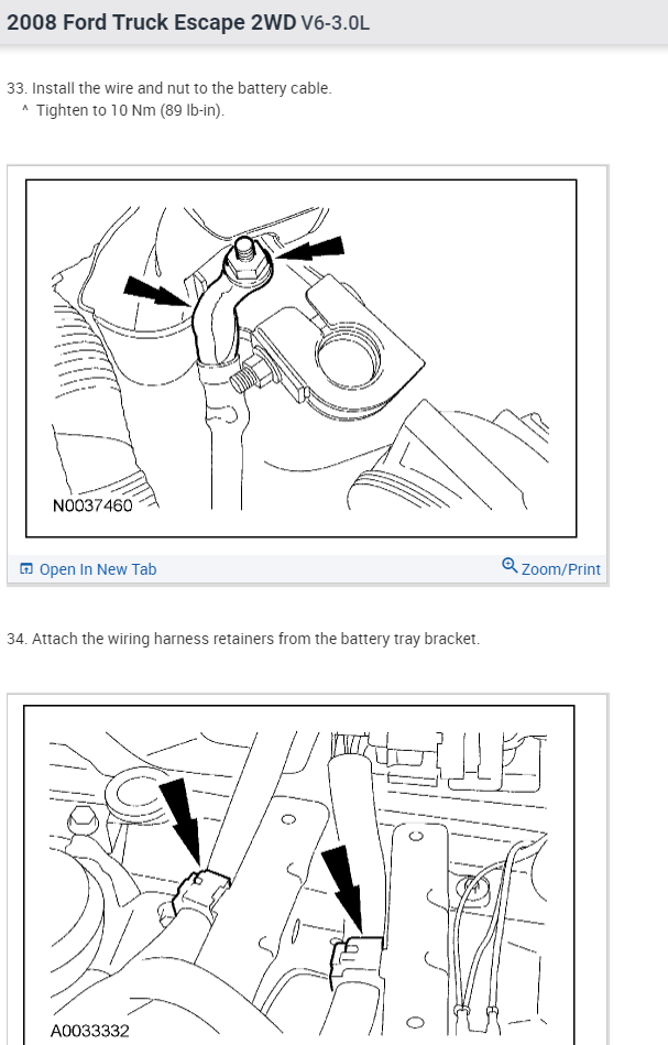

See attached for the complete engine removal and installation.
Let me know of any questions.
Images (Click to enlarge)
