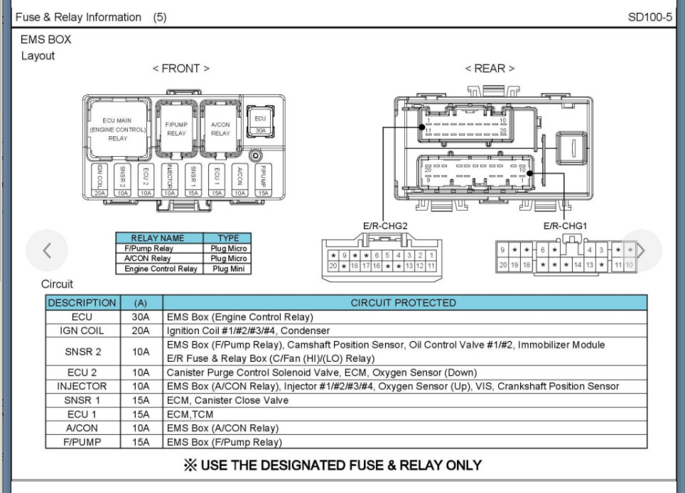

no lights on the dash where are the fuse panels?
2011 KIA CERATO
34,000 MILES • 1.6L • FWD • AUTOMATIC
KO ALL
Car has no lights on the dash where are the fuse panels?
Nov 25, 2016 at 3:55 PM

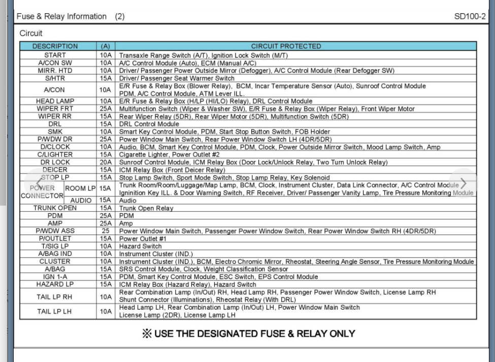

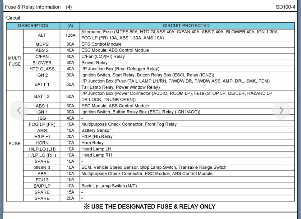

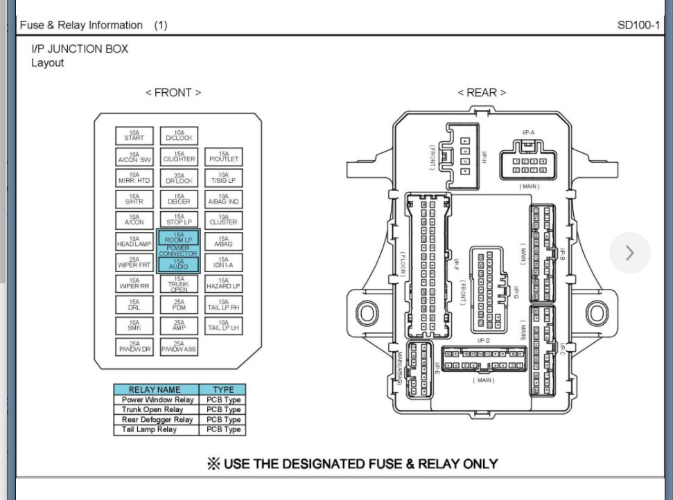

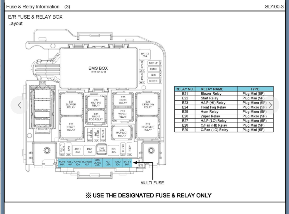

Unfortunately we don't have a manual on this vehicle as it is not offered here in the USA but I am attaching the information from the sister vehicle that is offered here in the USA.
Also, here is a guide that will help with this type of testing:
Below is the information on these fuses. Please run through this info and let us know if you have other questions. Thanks
