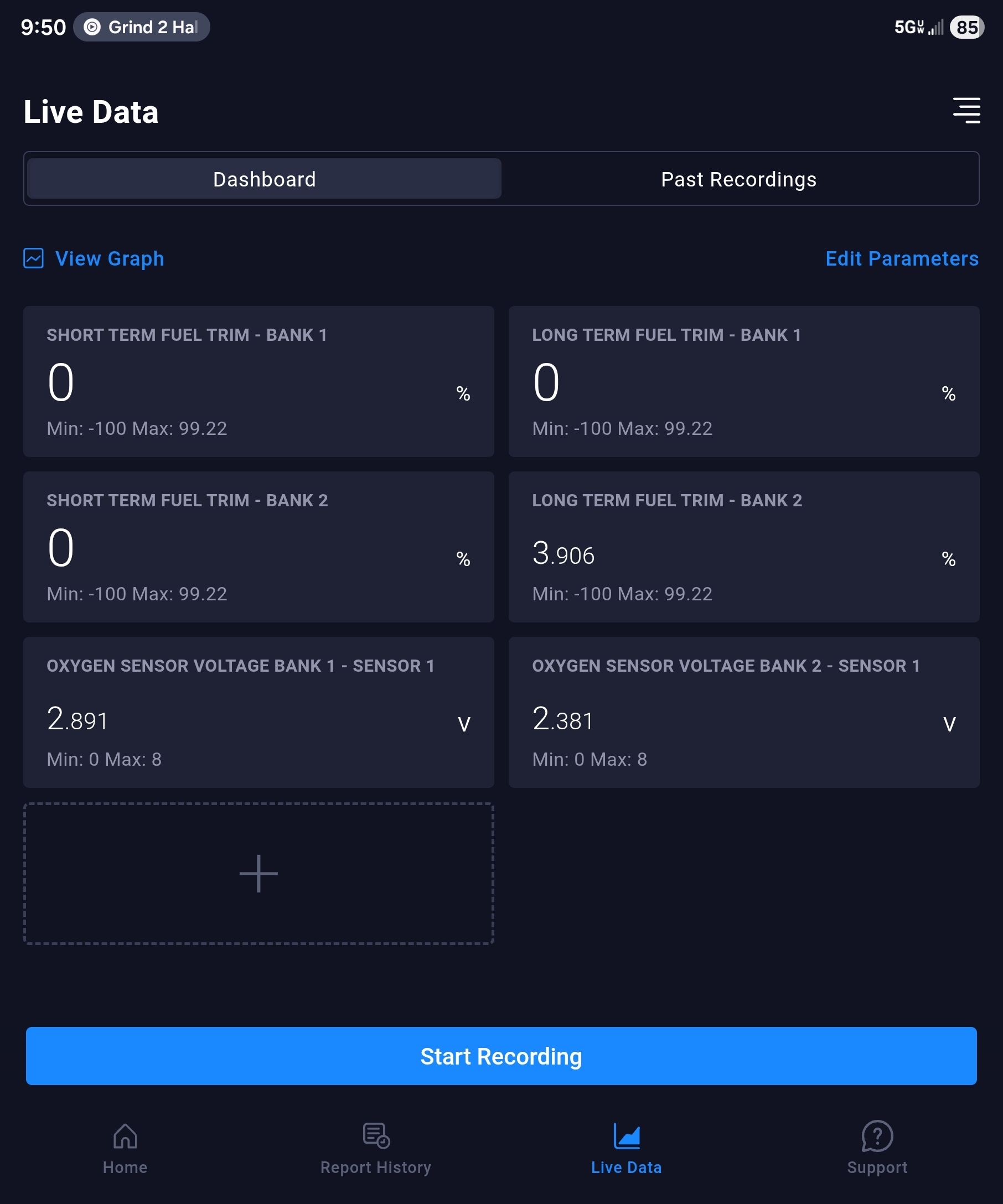

Thank you for the prompt reply. I have not had the time to pull the plugs yet, however, I was watching some more live data and now the STFT for B1 and B2 hover around +5 at idle, fluctuating from anywhere between -10 and +15. LTFT B1 is now +4.x and B2 is +11.x. A/F Alpha B1/B2 ranges from 97% - 120% and both downstream sensors are a constant 0.28V (HO2S2 MNTR B1/B2 = LEAN with no change). The car runs fine, other than the aforementioned hesitation and I don't hear an exhaust leak, plus, there are no DTCs present. I'll check for vacuum leaks in the intake system this weekend.
So that we're on the same page, the car is my daily but doesn't get driven very far as I work from home. I've had it 6 years and have put 20k mi on it. It has Stillen long tube cold air intakes that put the filters in front to the radiator, Concept Z Performance PCV delete kit, throttle bodies from a 2017 QX50, deleted throttle body coolant lines, new upper plenum gasket, valve cover gaskets, spark plugs, spark plug tube seals and, as mentioned in my original post, B2S1 A/F sensor, high flow cats and cat-back. All the work has been done by me within the last 10k mi.
Nov 14, 2025 at 9:22 PM
  • 55,433 POSTS
That fact that bank 2 is at +11 is tell us you have one or more fuel injectors and can be leaking or there is an exhaust leak on bank 2 which will fool the computer into thinking the bank is lean and it will richen up the fuel mixture. I would remove the spark plugs on bank two to see if one or all are dark compared to bank 1. If you find one that is dark you found the problem cylinder. Please do the compression test as well as long as the spark plugs or removed. This is so we don't chase our tail when the engine is having a problem, (low compression). Let me know what you find.

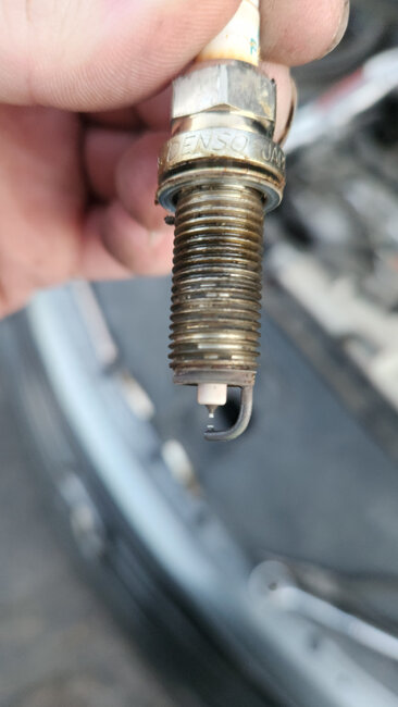

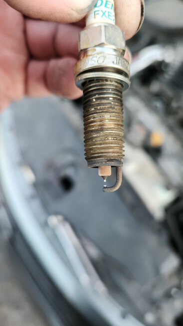

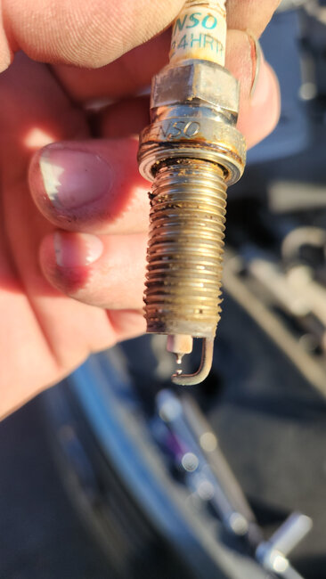

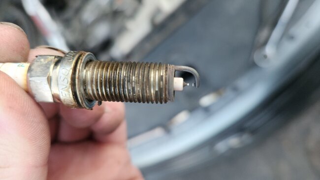

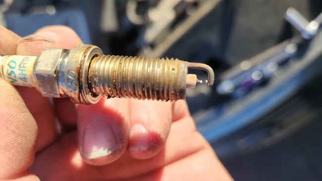

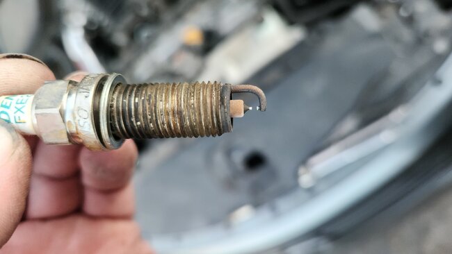

I removed the plugs on bank 2, but they look fine to me (see images). I tried doing a compression test, but the kit I have is the thread type and it doesn't fit down into the spark plug tube. Apparently, I need some sort of adapter rod with a rubber tip that goes into the tube. I don't see how that would hold the pressure if it doesn't screw in. I forgot to mention that I've also replaced the fuel damper assembly a while back due to it leaking (this car actually uses 3 of them. 1 before the rail and 1 on each bank's rail directly above the injectors. I replaced the one before the rail.)

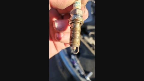

I just made a short video clip of the images of the plugs.
Nov 18, 2025 at 5:05 AM
  • 55,433 POSTS
Nice, thank you for the video, so the last spark plug looks lean, no or little fuel this will be he cylinder having the issue. This is why the system is trying to richen the mixture, if the compression is good I would replace the fuel injector on that cylinder. Clear the codes and see what happens.

Is that because the tip isn't brown like the other 2? Do you know what adapter I need to do the compression test?
Nov 19, 2025 at 2:52 AM
  • 55,433 POSTS
Yes, do you see how the others are darker? This means they are burning fuel. This video will show you how and what adapter you need.

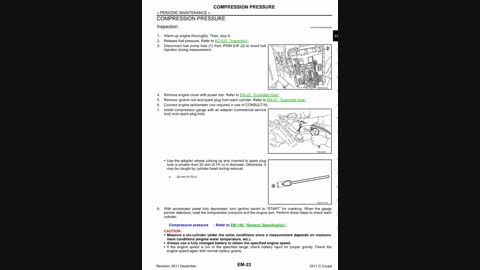

I have a similar kit as in the video, but the FSM says I need one of these
Nov 20, 2025 at 8:35 AM
BILL MARSHALL
  • 40 POSTS
I figured it out. Compression numbers on C2, C4 and C6 were all between 240 - 245 psi. The last plug in the video was C6. I should just replace the injector then? The book says the only way to test the injectors, other than listening for an energized click, is to pull them out, put them in a container, still connected to the rail, and fire them to make sure they all flow the same.
Btw, LTFT B2 is now +16.
Nov 20, 2025 at 11:43 AM
  • 55,433 POSTS
Yep, that is a good way to compare the spray pattern, but it looks like from this LTFT B2 reading the injector is clogged, here is a guide that can help you test the injector as well.

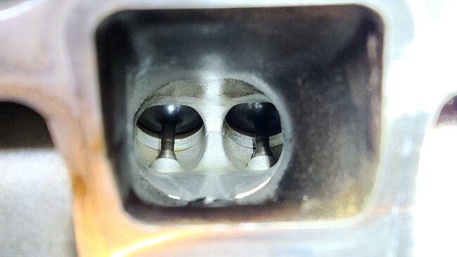

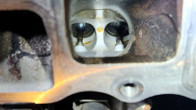

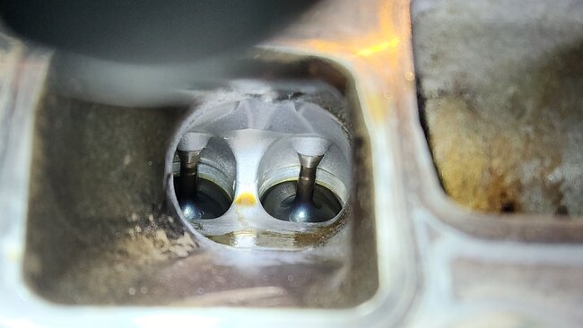

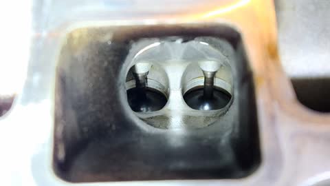

My apologies for the delayed response. Holidays, family, etc. I do hear a click from each injector with the engine running. Connecting a test light to battery neg and probing the injector wires causes the test light to light up on all 3 injectors on bank 2. When probed, each injector fired every time the light turned on with what little pressure remained in the line. I was unable to do the PCM pulse test since the upper plenum has to be removed to access the injectors. C2 and C4 showed 13.2 ohms and C6 showed 12.9 ohms. I've included a photo of each port, taken after probing. I did not have time to remove the injectors, but I noticed the drive side valve cover gasket is leaking so I will be taking it apart again very soon to replace the gasket (it's the same steps to get to the injectors).
I did get under the car with it idling to see if I could find an exhaust leak, but I could not see, hear or smell one.

In case the photos don't load.
Dec 28, 2025 at 1:35 PM
  • 55,433 POSTS
Okay, yep, those intake ports look okay, and the Ohm reading are good but that is only one test for the injector, you can have a clogged nozzle which will lean the cylinder out which is what you are fighting. I would remove the injector and test it as in the guide.

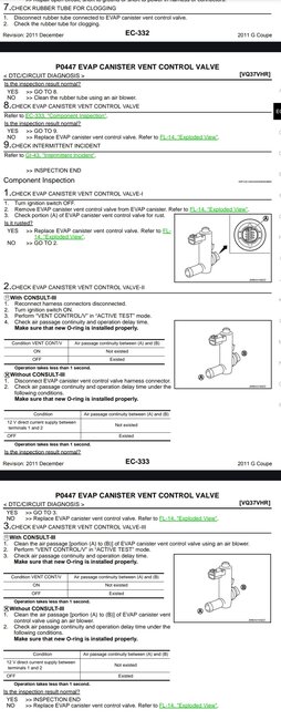

I was/am having an issue with a P0447 evap can vent control valve returning incorrect voltage to ECM, but I checked the voltage to the valve, it's battery voltage, I checked continuity between the valve and the ECM, it exists, the hose is not clogged, I can blow through the valve when it's not energized and it seals off when it is. I erased the code to see if it will come back so, there are currently no codes. I did notice when I tested the wrong wire in the valve connector at first that the wire going to the ECM from the valve showed 3 volts when put to ground. Is that a reference voltage or is that a problem?

Hmm, I think the valve is suppose to be shut/closed when the valve is removed and then open when energized is this what you mean?
May 17, 2026 at 9:15 AM
BILL MARSHALL
  • 40 POSTS
The FSM says the valve is typically open and it closes when 12V is applied across the terminals
May 17, 2026 at 9:48 AM
  • 55,433 POSTS
Yep that is my bad I was thinking of the purge valve, not the canister valve. So that is normal. The purge valve up by the engine is the one you are talking about correct?

No, sir. I am talking about the canister vent control valve, not the purge valve. The code is P0447 incorrect return voltage to ECM from vent control valve.

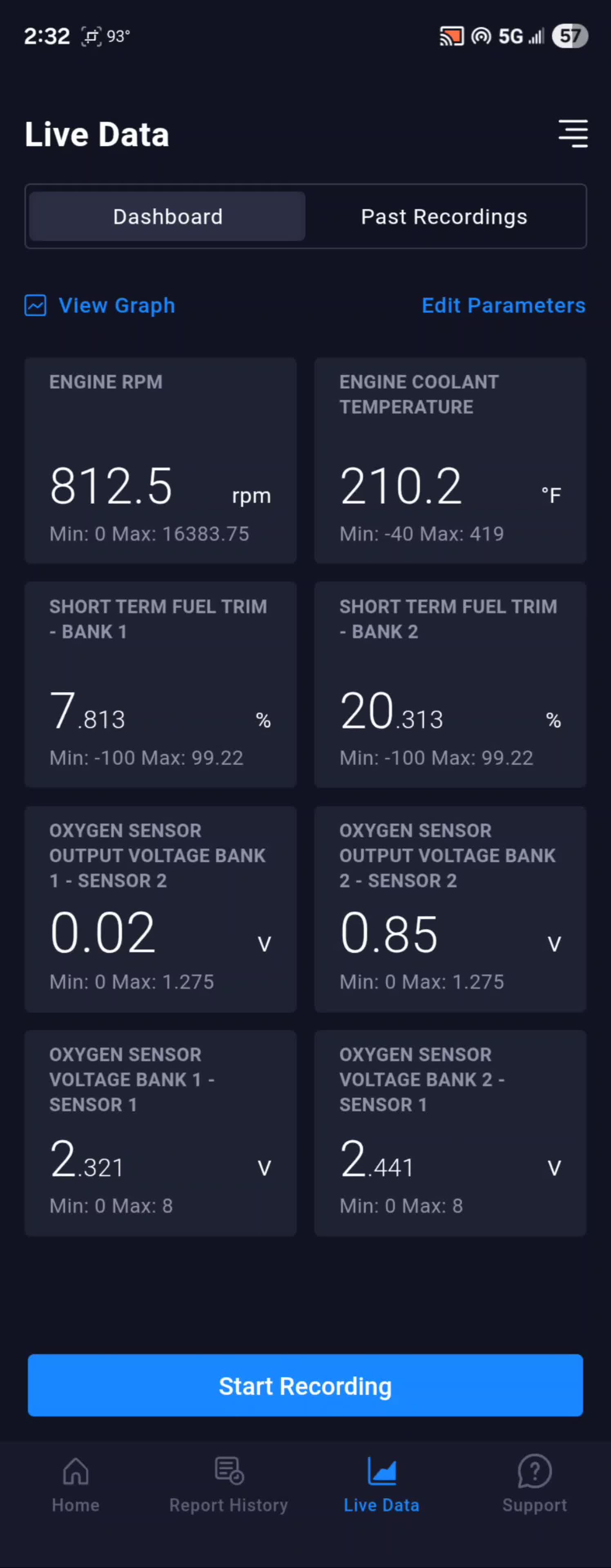

If the computer is compensating, for whatever issue is happening, to keep the front AFSs in the middle, why would both rear o2 sensors be reading lean?
May 21, 2026 at 4:28 AM
BILL MARSHALL
  • 40 POSTS
I meant rich. High voltage is low oxygen, right?
May 21, 2026 at 5:15 AM
  • 55,433 POSTS
Not really, anytime there is a misfire the system will be lean. There is more air than exhaust gasses when misfires occur. Please go over this guide which explains is better.

But I'm not getting a misfire. My scan tool shows real time misfire counts and they're all 0.

No sir, it does not idle rough. It does not misfire. There is no vacuum leak that I could find. I fixed the small exhaust leaks I did find. The issues are very high fuel trims (I reset the long term learned values and within a few drive cycles, bank 2 LTFT is at +20) and both rear oxygen sensors reading constant high voltages. I'm working on checking the injector spray patterns.
May 21, 2026 at 8:36 PM
  • 55,433 POSTS
Yep at +20 the system is trying to lean down, check the injectors and if that checks out I am leaning towards a bad ECU

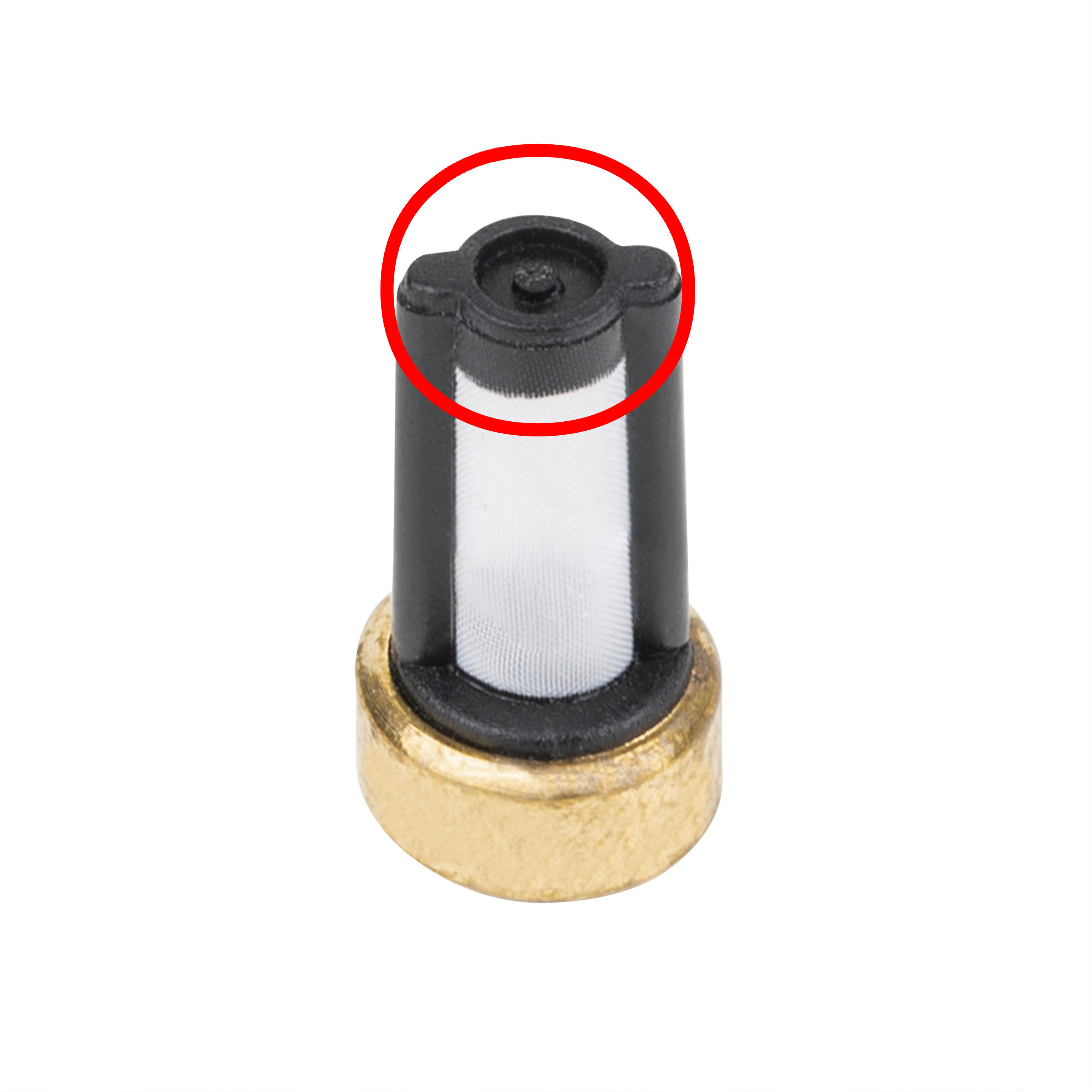

I removed the injectors. The filters in all 3 on bank 2 have separated and the plastic plates/tips/caps (see image, generic not actual) are floating around inside them. I haven't checked bank 1 yet. Is it worth trying to get them rebuilt or should I just buy new ones? Unfortunately, an OEM set is about $1000.
May 23, 2026 at 5:25 AM
  • 55,433 POSTS
Yep, most injectors have these filters, I would check the spray pattern as in the guide before replacing them.

Right, but like I said, the filters have come apart inside the injectors and pieces of the filters are floating around inside the injectors, I'm assuming causing blockages and the related issues.
May 23, 2026 at 11:09 AM
  • 55,433 POSTS
Yep, sorry about that, you have found the problem, the injectors are bad.
