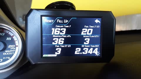

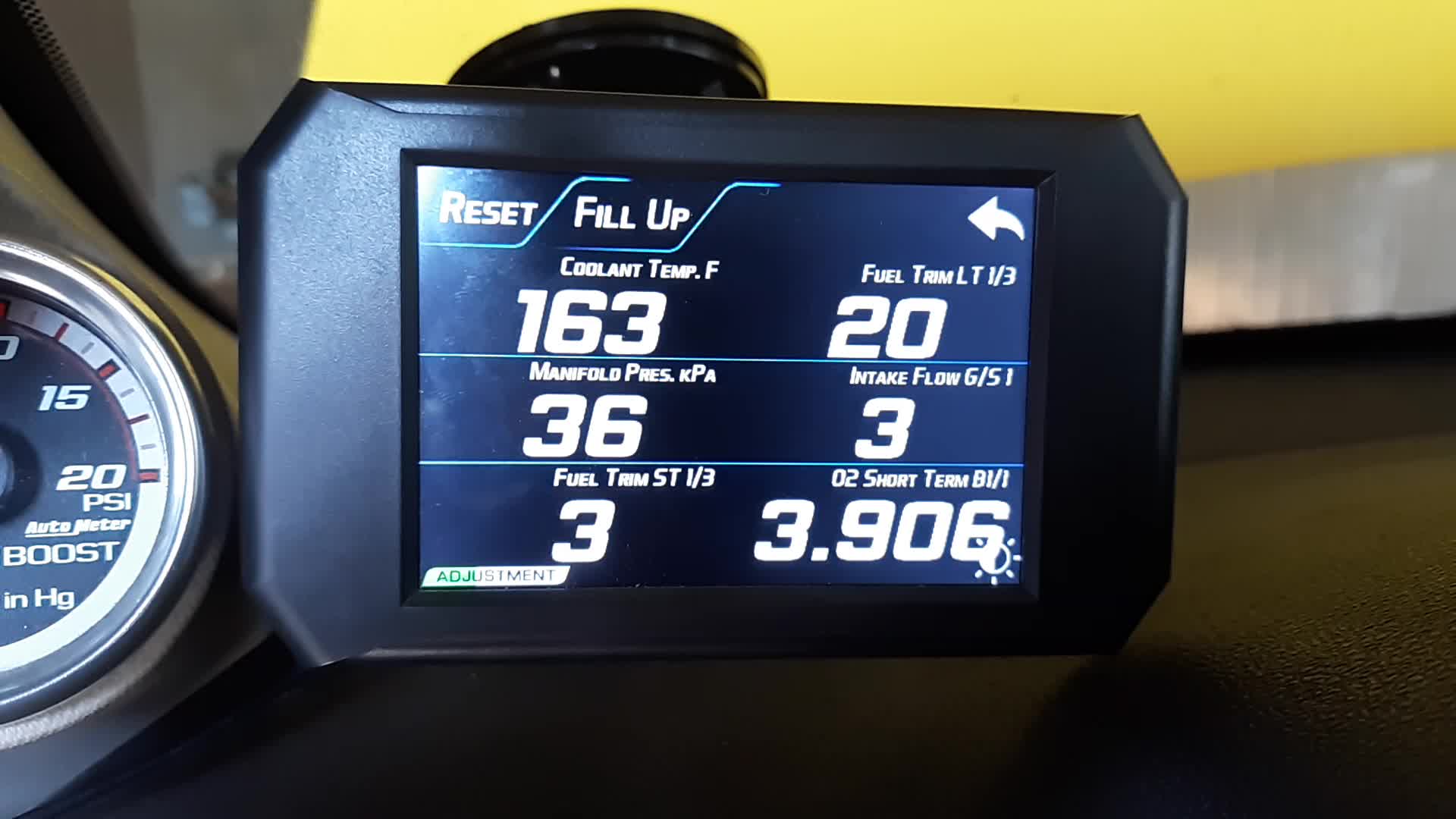

Now it's running lean after I put stock air box back in. Here is a video of what it's doing now with stock airbox. i have checked for vacuum leaks 3 times and can't find one. Yes, I have a tuner.

I've checked for vacuum leaks 3 times and can't find it. It was running rich until I took the cai out and out stock airlock back in. Now running lean. Is it a vacuum leak or something else? Under load the ltft will drop to about normal. Has a long tube header. Little more aggressive exhaust cam. Everything seems to be reading correctly. Runs alright but seems to fall on its face off the line until about 2,000 rpm's then picks up.

Okay. Let me just confirm that if the engine is now running lean that your fuel trims should be positive. I thought you said they were around -12 and you wanted them to -5.
Lean is high oxygen content in the exhaust so the number is positive so it wants to add fuel. If they are positive with the stock intake on, that would indicate that the stock air system flows more air then your aftermarket one. I know this is counter intuitive but it is not uncommon.
If it is supercharged and not a turbo, then clearly you don't have the turbo lag. So if it is lean and is lagging at take off then I would think we need to add fuel at take off. Does your tuner have the ability to pull data recordings from the tool? If so, can you upload one so we can see what is happening at take off? Also, you may want to contact the company of the tuner and ask if they have a program that will help with this. Or they may be able to write one for you.
