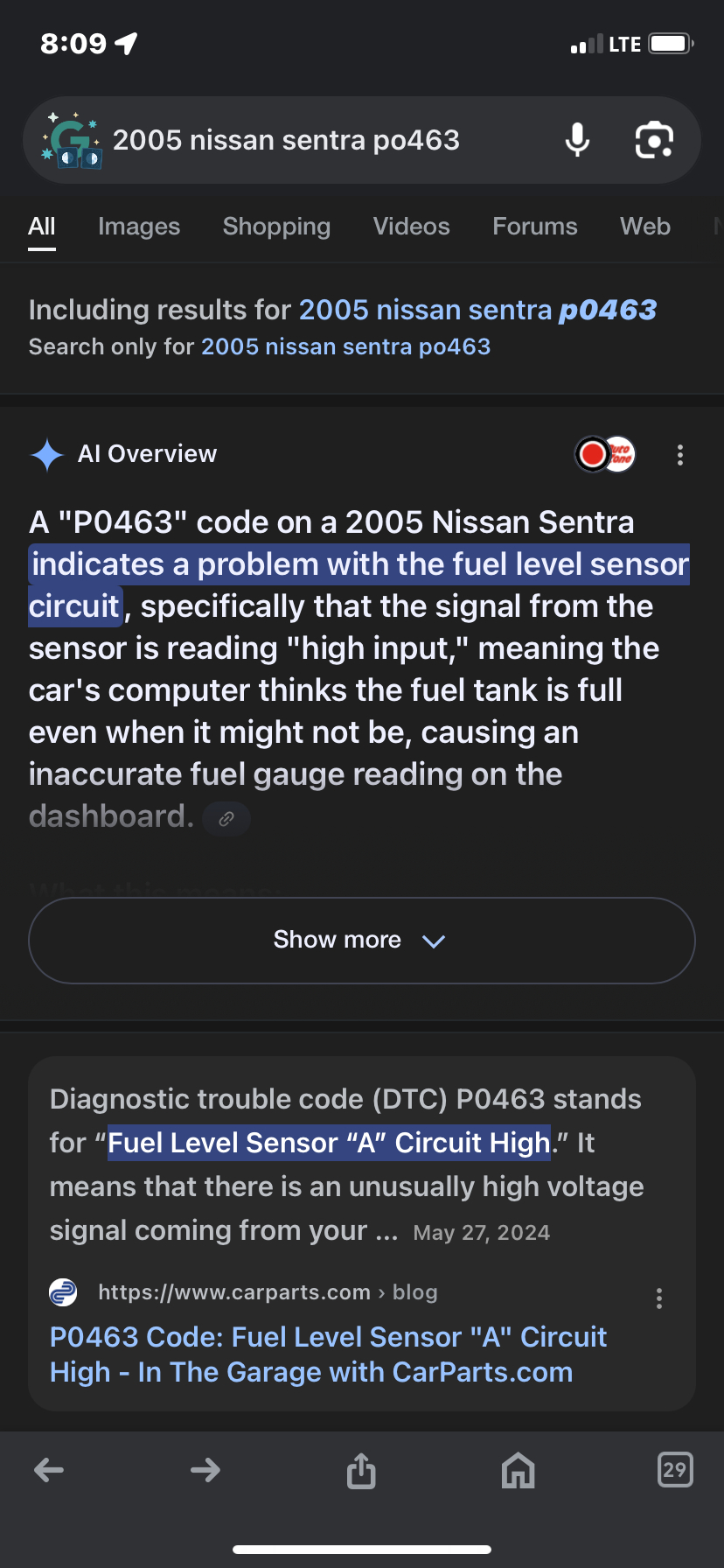

My check engine light was on for fuel to lean. The mass airflow sensor got changed and it worked a little better than acted up again. Fuel pump got changed and now the car won’t turn on, but you hear the fuel pump turn on and gas was coming out of it.

GABBY CANCASCI

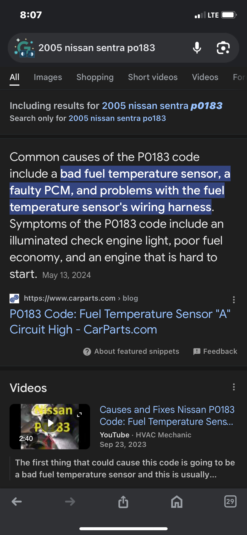

Those are the 2 codes that popped up after changing the motor in the fuel pump.

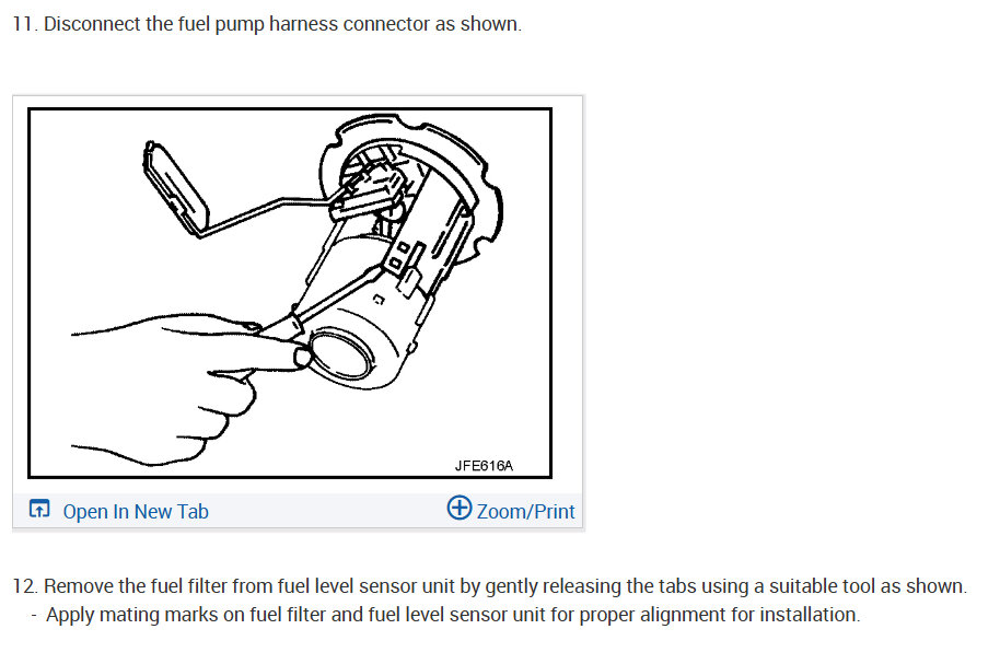

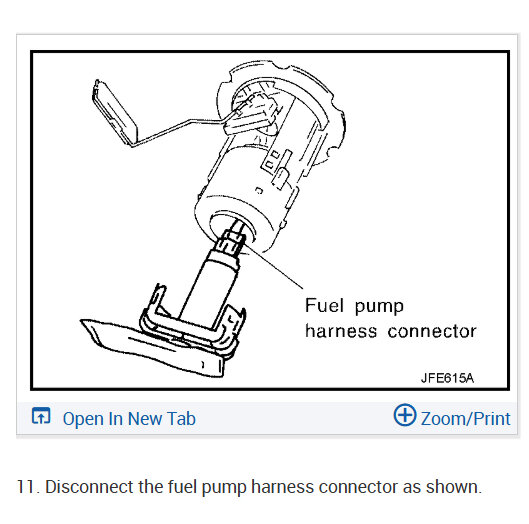

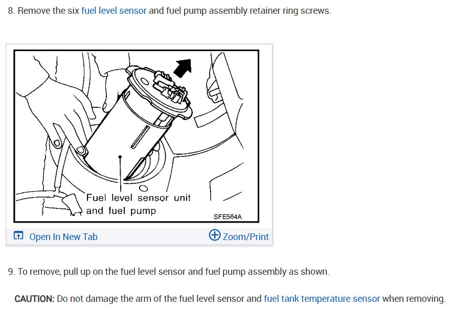

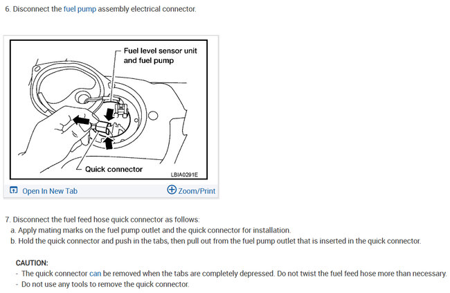

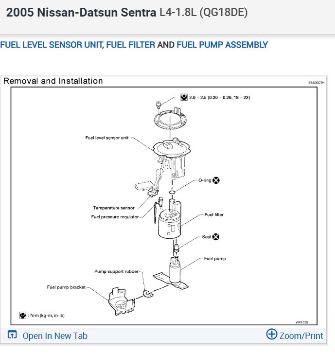

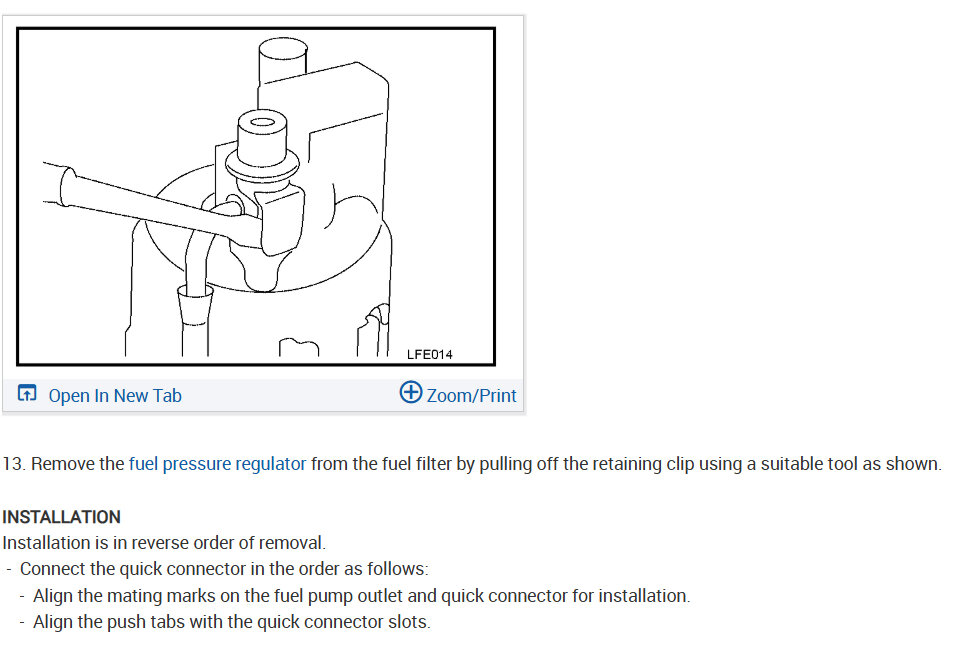

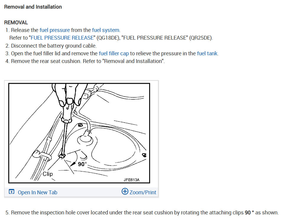

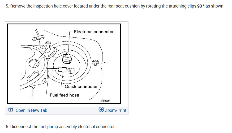

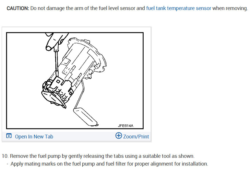

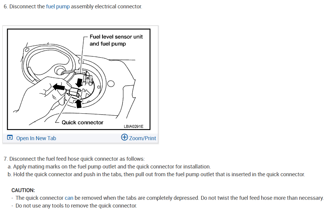

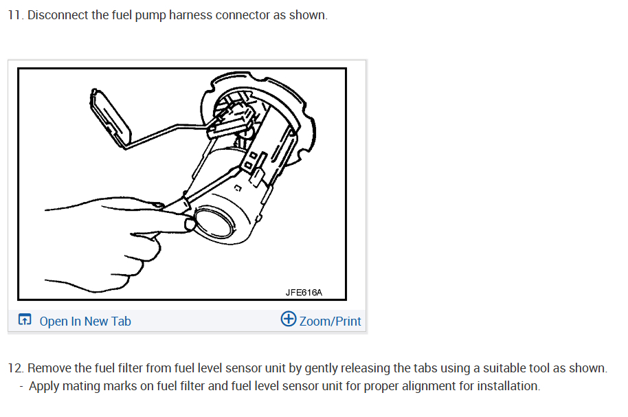

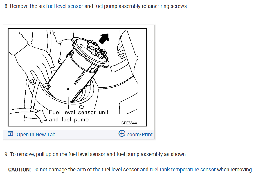

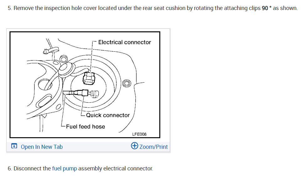

Yep, both of these codes have to do with the fuel pump module so it must be defective. Here is the correct way to change out the fuel pump in case you need it. Check out the images (below). Please upload pictures or videos in your response of any problems so we can see what to help you with.
