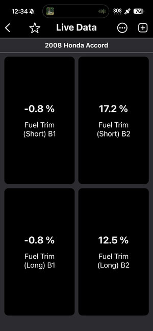

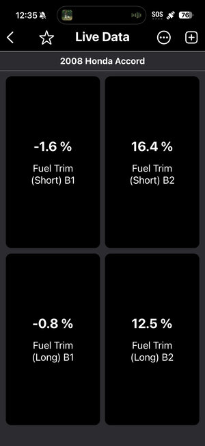

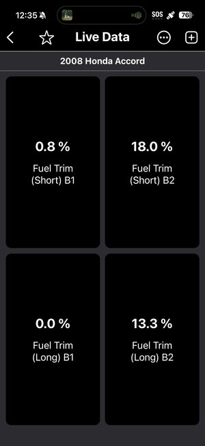

I did a live data scan of the fuel trim with my FIXD scanner, didn’t even know I could do that, but here the average numbers. Not sure if that helps you at all
Nov 4, 2025 at 3:44 AM
STEVE W.
  • 15,423 POSTS
They might except they don't show up. Do you see anything other than a logo on your end?
Nov 4, 2025 at 4:26 AM
JGONZO2398
  • 375 POSTS
Short-Term Fuel Trim (STFT):
Bank 1 = 0 % to -1.6 %
Bank 2 = +16 % to +18 %
Long-Term Fuel Trim (LTFT):
Bank 1 = -0.8 % to 0 %
Bank 2 = +12.5 % to +13.3 %
Nov 4, 2025 at 5:07 AM

Thanks for the response on the images. Those numbers are showing it adding fuel. Try this watch them and then rev the engine up to 2500-3000 and hold it there for a bit. If the bank 2 starts to go down then you have a vacuum leak somewhere that is letting in air after the MAF
