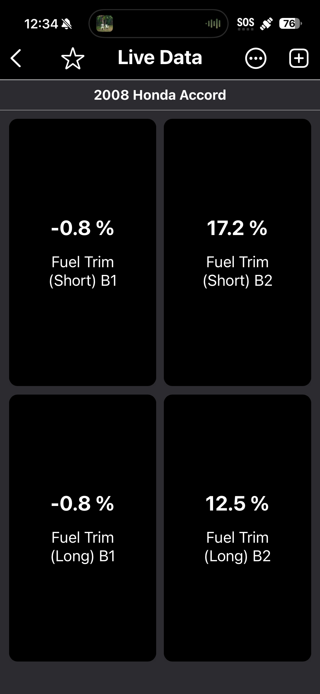

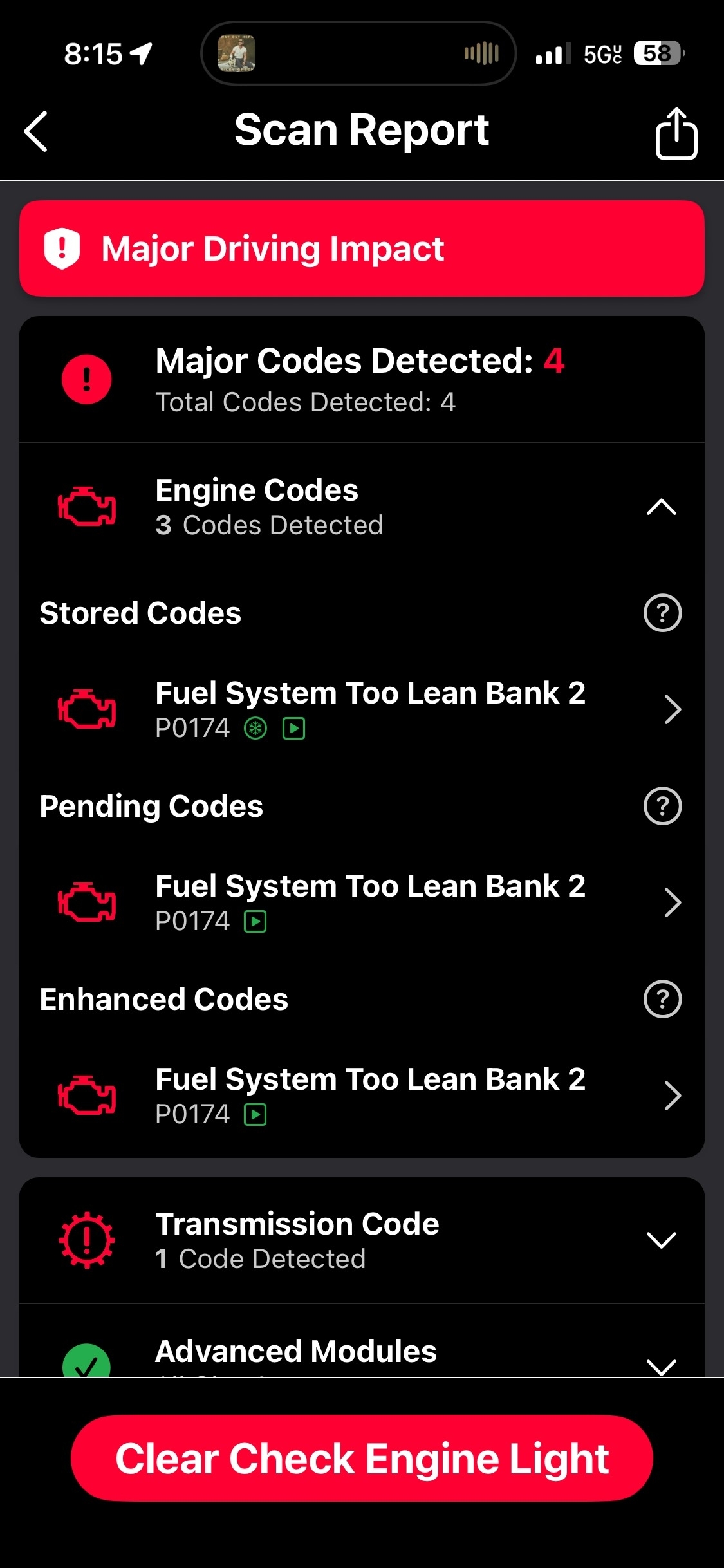

So I’ve been stressing about this issue for over a week now. I had both valve cover gaskets replaced along with the plenum gasket, I also replaced my engine air filter. Later that same day when I drove my car, the CEL came on and I got that P0174 code for bank 2. I’ve been researching online and have cleaned the MAF sensor, checked for any loose or ripped hoses but everything seems solid. The RPMs at idle seem to be pretty normal but I’m nervous because I plan to take this car on a trip to California next week. The CEL with the same code has turned off on its own a couple times now then comes back on. Any guesses??

As it has come on before for the same code then went away I might look at an injector flow test, one might be dirty or sticking, or it might be that bank one is running rich and the ECU thinks that means B2 is running lean. You might look at the fuel trims with a scan tool to see what they are doing, if it is adding fuel on B2 and B1 is normal then I would check for leakage, just spray around the plenum and manifold with starting fluid and see if anything changes. Check the EVAP purge as well, The hoses can come off and then you get a vacuum leak when it triggers the purge on.

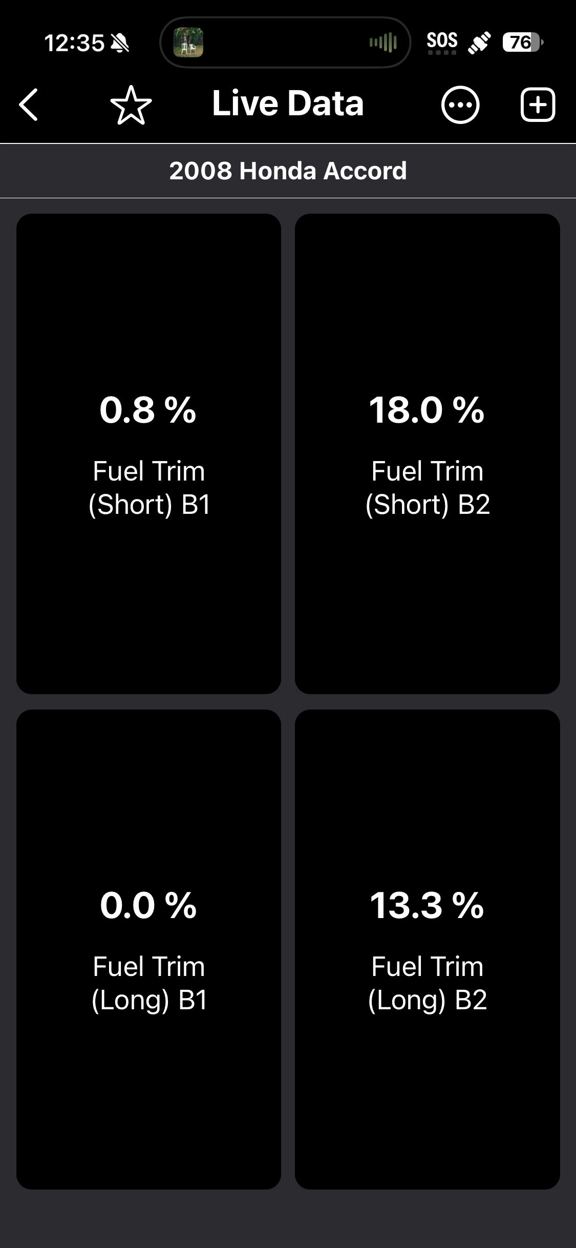

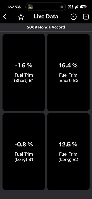

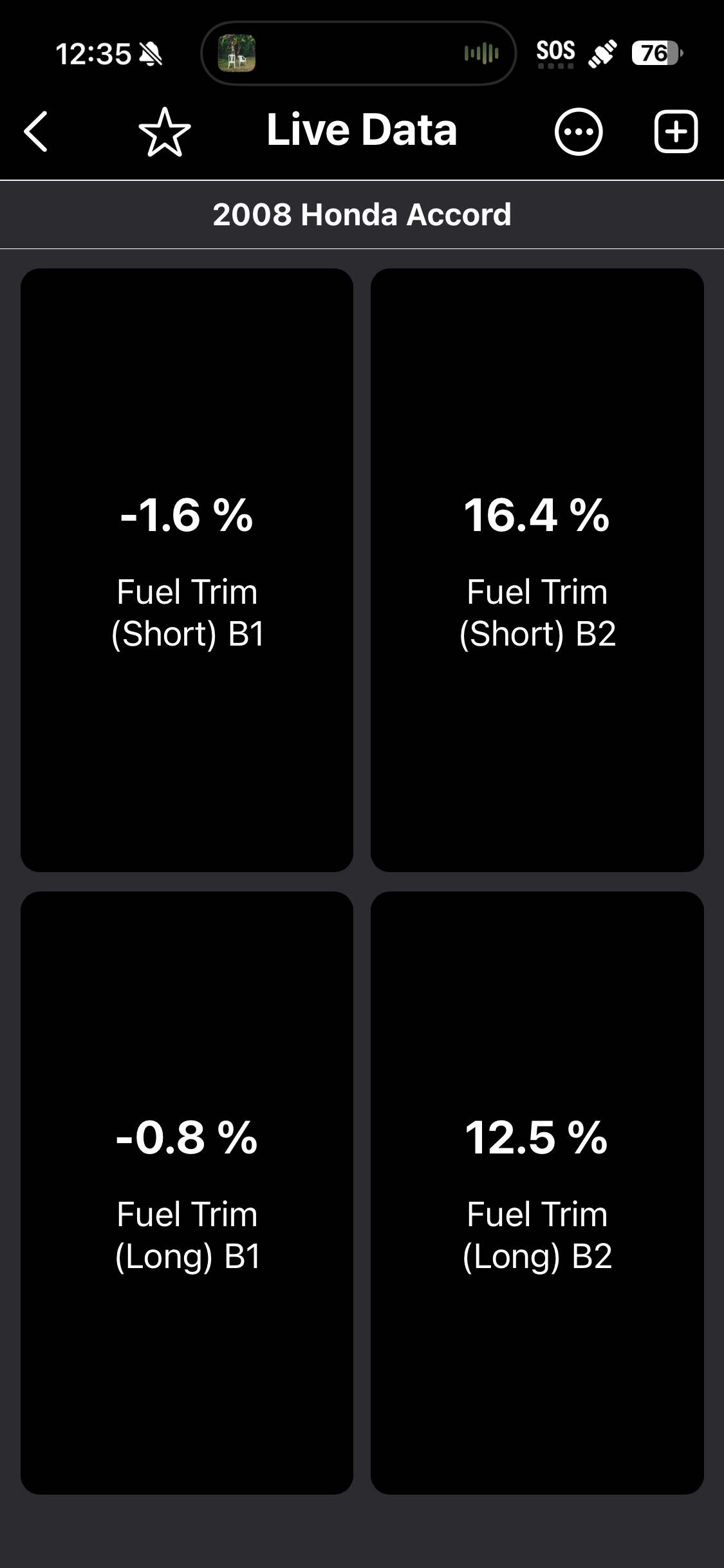

I did a live data scan of the fuel trim with my FIXD scanner, didn’t even know I could do that, but here the average numbers. Not sure if that helps you at all

They might except they don't show up. Do you see anything other than a logo on your end?
Nov 4, 2025 at 4:26 AM
JGONZO2398
  • 372 POSTS
Short-Term Fuel Trim (STFT):
Bank 1 = 0 % to -1.6 %
Bank 2 = +16 % to +18 %
Long-Term Fuel Trim (LTFT):
Bank 1 = -0.8 % to 0 %
Bank 2 = +12.5 % to +13.3 %
Nov 4, 2025 at 5:07 AM

STEVE W.
  • 15,239 POSTS
Thanks for the response on the images. Those numbers are showing it adding fuel. Try this watch them and then rev the engine up to 2500-3000 and hold it there for a bit. If the bank 2 starts to go down then you have a vacuum leak somewhere that is letting in air after the MAF

New update! So the CEL just came back on yesterday, after being off since 12/28/25, this is the longest it’s gone before turning back on so I thought the problem was gone for good. Just to refresh you, ever since the valve cover gasket job back in late October last year, I’ve replaced the MAF sensor, the purge valve, PCV valve and intake hose/boot. I also put some Seafoam in the fuel tank around November. There are no noticeable issues with the engine such as rough idling or trouble starting, nothing like that, in my opinion it’s operating perfectly. I also checked live trim readings today while idle, Bank 1 showed STFT around +2.3% and LTFT about -0.8%. Bank 2 read STFT around +25.8% and LTFT around +12.5%. I then revved it to around 2,000rpm, and Bank 2 STFT dropped to around +10.9% while LTFT stayed around +14.1%. Bank 1 STFT about -5.5% and LTFT around 0%. What do you guess it could be based on this information?

Those numbers and the reaction to the engine rpm now with the bank 2 coming down as opposed to staying the same says you have an air leak on bank 2 or there is an overachieving injector on bank 1 that is causing the PCM to try to balance it, put I would look at the leak first. Pull the pcv and block it off, what do the trims do? It's possible that one of the valve cover gaskets is letting air in, that would bypass the PCV system and the MAF. I would expect a leak there though to affect both sides. Could also be an intake gasket.
