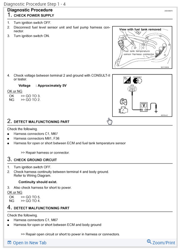

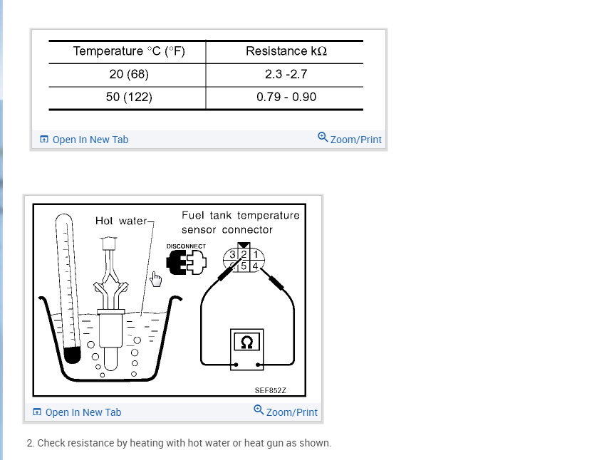

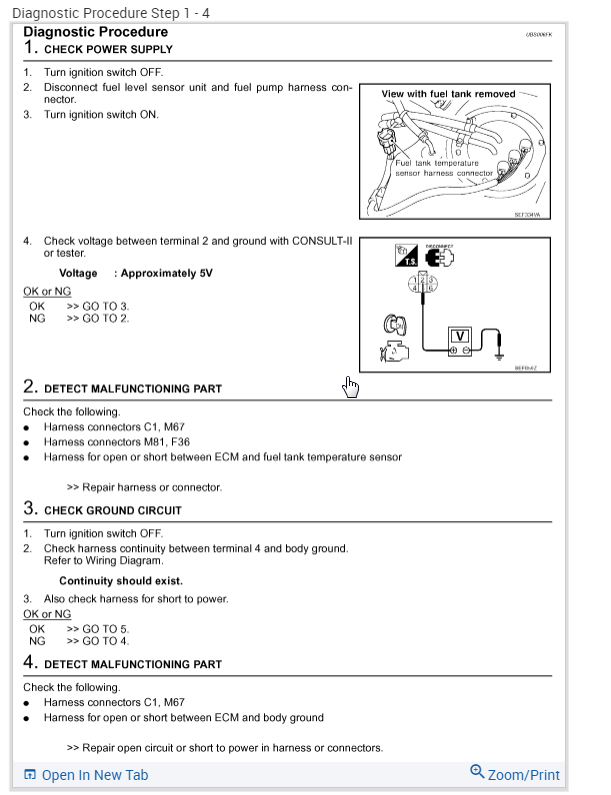

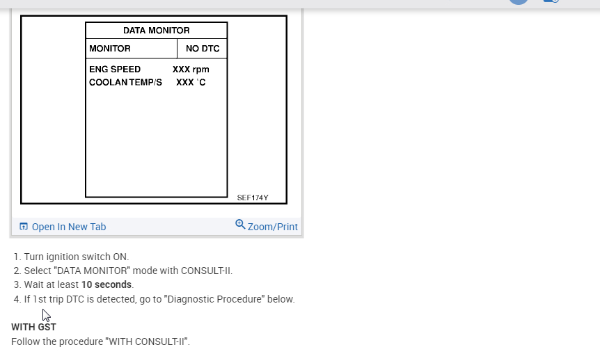

I was wondering where this is located on the truck. I'm getting an P0183 code.
Thanks in advance.
Aug 5, 2019 at 11:11 AM

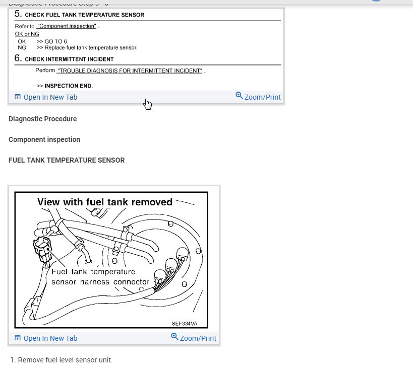

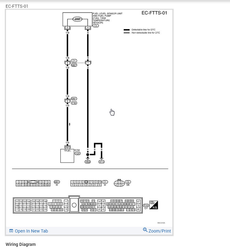

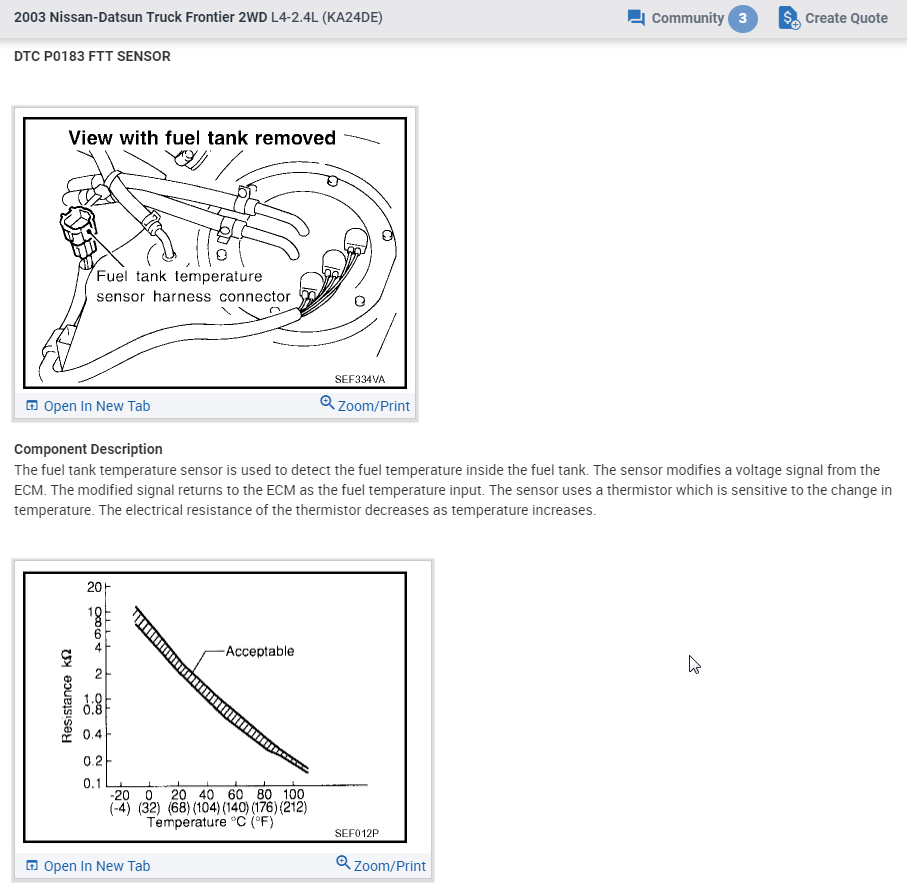

Hi Darrell,
Attached is the entire testing for this code. To answer your question, it is in the fuel tank. The detail is attached. Let me know if you need any more information.
Aug 5, 2019 at 12:13 PM
DARRELLPWLL
Thanks. last question. I will need to drop the tank to access the harness?
Aug 5, 2019 at 8:41 PM
I don't see that it requires that but you may have to just loosen it in order to gain access to the top of it. That is pretty standard on trucks.
