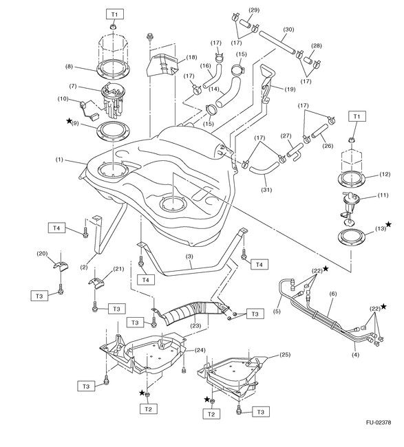

Fuel tank sending unit erratic

I recall a way to clean contacts and/or add jumper wire from the cargo area without dropping the tank.

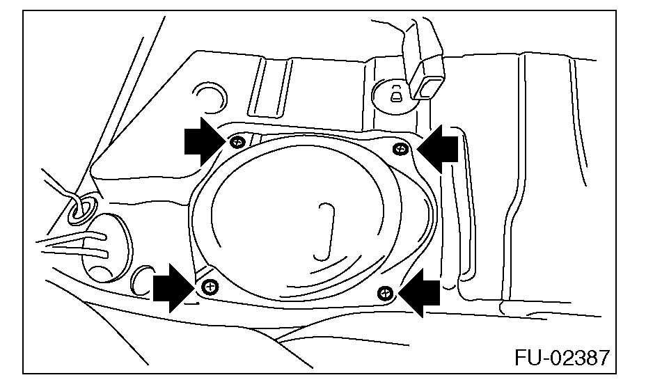

I'm not 100% sure I understand. There is a service port under the rear seat (See picture 1) which gives access to the pump. But, the level sensor is on the opposite side of the tank. (see picture 2). I don't recall there being a separate service port, but there could be.
You can inspect and clean the electrical connectors, but I know nothing about a jumper.
