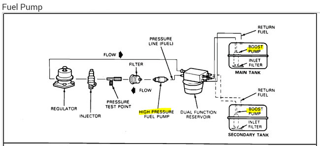

It has been a while, but if I recall correctly, this vehicle has three fuel pumps. Each tank has a pickup pump (low pressure) and then a high-pressure pump (booster pump) located on the left side frame rail.
It sounds like the booster pump works. However, I'm questioning of both of the low-pressure pumps in the tanks are working.
If possible, check fuel pressure. See if there is a variation between the two tanks. Here is a link that explains in general how it's done:
Let me know what you find or if you have other questions. Also, take a look at the pic below. This is how it's set up with the pumps.
See pic below.

Thanks for getting back to me. Here's what I found out: The Fuel Tank Selector Valve poses many frustrating problems. It's really a problem waiting to happen. It was a terrible mistake for Ford to make dual tank vehicles. In my case, the new OEM selector valve that the Ford dealership put in my van turned out to be faulty. These valves have O-rings and some of these "new" OEM valves in vendor's inventory were probably manufactured 25 years ago. So, these O-Rings have probably oxidized and dried out. My van runs like crap on the front tank and runs much better on the rear tank. Also, the selector valve really constricts the gas flow. So, to use an analogy, if an artery to your heart is constricted, then you just might need bypass surgery. Therefore, the best solution to my problem is to bypass the selector valve. And many people have done just that. So, I told the dealer to take two metal fuel connector tubes and connect them to the main and return fuel lines from my rear tank and connect the other ends leading to the main fuel pump bypassing the selector valve. I'll just have one working fuel tank - my rear tank. But the good news is I won't have to deal with this stupid selector valve anymore!

Thanks for the update. And yes, I agree with your theory about the valve being an issue and I feel you made the best decision. Over the years, I have seen so many problems with these.
